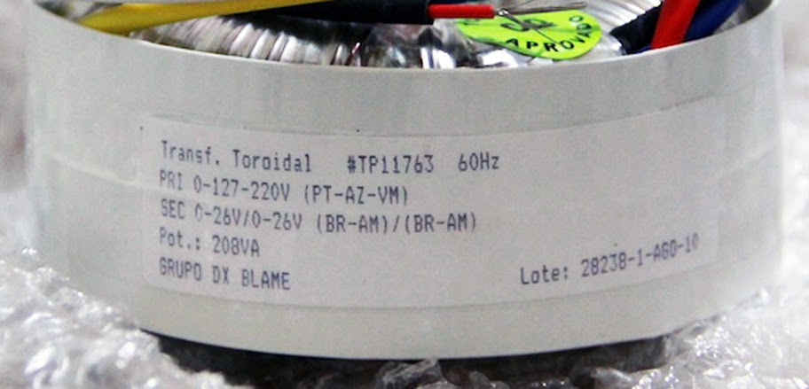

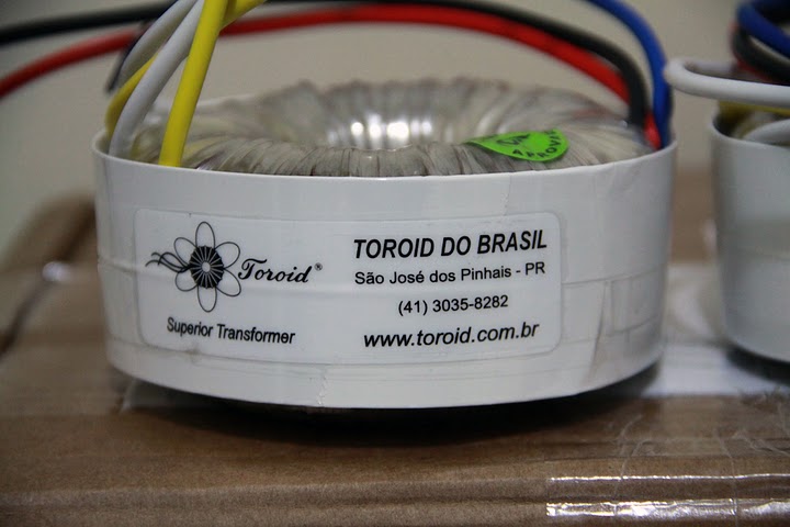

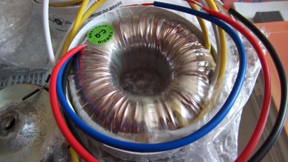

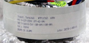

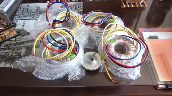

My people made even better...the group buy for the Dx Blame ST
in Brazil, includes 7 boards as a kit, 2 transformers, one to each channel and relay for protection.
Transformers already arrived, in a couple of days the boards will arrive too..and then the real fun will start there....i will be in the hospital, but i left 5 guys to take care of that for me while i'm out.

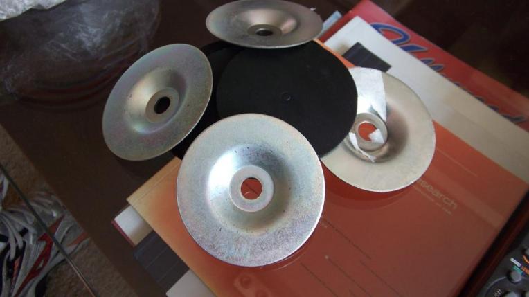

Mine amplifier. In stage of building yet.
This I gonna use in a concrete subwoofer that i'm building too.

Nice your aluminium adaptor..the "L" profile...the bracket...i hope it is not duralumium ...that non flexible metal produced using aluminium and used to windows..because that one (Esquadrias de aluminio) is very bad to heat transference... yours seems thick..maybe not duraluminium.... i hope i am wrong about the material, as it is bad heat conductor...it is good to frames, chassis, to hold antenas in place and to assemble ligthweigth aircraft frames.
Duraluminium was made for aircraft use. and in our country we use to doors and windows (parapeito de terraços e varandas)...it is often used as scalator, stair case (escada rolante) because very strong mechanically and ligthweigth...less weigth than the aluminium..it is a combination of metals..that brokes in the place to bend.
That material, the duraluminium is not found in cooking pots, as does not transfer heat well from the fire to the food.
The area we normally use to the transistor should be small because the board...and because the transistor size..but the other "leg"..the other part of the adaptor needed to be bigger to allow good head transference having bigger contact area..... i suggest you to use thermal compound... to compensate this...i would like to remember that "L" letter shape has diferent dimensions to each part (A letra L tem um perna maior que a outra)
If you're using these aluminum blades used to windows and doors..please, remove them and substitute because i am sure you gonna have troubles...the transistor will be overheated (hot spot) while the "L" bracket will not be overheated..the heat transference will be very bad...your nice and huge heatsink will serve for nothing with a wrong "L" bracket... wrong material and size.... surface in contact with the main heatsink..contact area.

Carlos,
It's true aluminium. I use thermal compound for everything that you see transfering the heat. The transistors and the L piece. The big block of aluminium is Aluminium too
I choose the DX Blame cause my subwoofer will support only 150w at 4ohms. The DX Troyan is 640W at 4ohm!
I can replace the amplifier later and make a new one. It's will be more fun make more DX amplifiers. Is there some modification that you reccomend that I can do to have a better bass with the Blame ES ou ST?

Dx Blame group in Brazil, had received transformers from Toroid from Brazil
more than 200 transformers to the brazilian group buy...the transformers arrived customized...... you can see printed the group name...special order with special specifications.
Each amplifier will have two transformers, one to each channel, two protectors, one to each channel, one surge protector and two boards, one to each channel, having rectifiers and filters..the Dx supply.
regards,
Carlos
regards,
Carlos
Sorry for this question, but was the choice for 0-127-220VAC for primary voltages due to our brazilian 127V instead of 115? IMHO a dual 115VAC input with 127V tap would be smarter (mean more efficient).
I only noticed this issue today, when they arrived here.
Any input?
Max.
Any input?
Max.
I can't imagine how would be possible to have a dual 115V primary, and a 127V tap. The fact of being dual 115V is incompatible with a center tap.
Exactly Metal, I'm with you.
Toroid is used to making transformers with two separate primary windings, instead of a single winding with a center tap. In Brazilian's case it's differente, because we have two mains voltages here, depending on the city - some cities have 127V mains (majority) and some cities have 220V mains.
So, it's not possible to do a dual winding primary that would fit both voltages. 115V is too low for our 127V standard.
Sirs, I meant 2x0-115 windings, to be used in series under 220V, and in parallel under 115V, with a correction (not center) tap for 127V. I think that would be more efficient than this old fashioned 0-127-220 way, but I am no engineer at all. Thus I would like to hear from EE which had been the best choice.
Thanks for the inputs, anyway.
Max.
Max.
The reason is...
This picture from Toroid's website (TOROID DO BRASIL) is the reason for my question, since I expected this kind of transformer, not the one shipped (although it will make no difference to me, since mains voltage here is 220V!).
All the best,
Max.
All the best,
Max.
