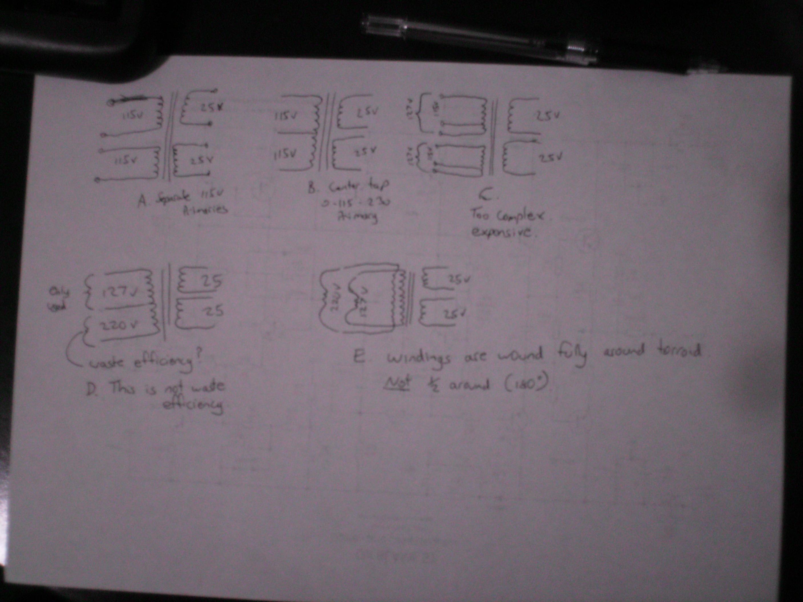

What happens is that it's not possible to make the correction you mentioned.
And if you had two separete 115V windings, it wouldn't "fit" the two voltages: 127V applied to 115V primary would be saturating the primary (not critical, but not adequate use), and 220V aplied to 230V primary would result in a voltage in the secondaries lower than expected.
Since there's no way to accurately make a two winding primary transformer for both 127V and 220V, the solution is to use a center-tapped one, as used by Toroid on this groupbuy.

Sirs, I meant 2x0-115 windings, to be used in series under 220V, and in parallel under 115V, with a correction (not center) tap for 127V. I think that would be more efficient than this old fashioned 0-127-220 way, but I am no engineer at all. Thus I would like to hear from EE which had been the best choice.
Thanks for the inputs, anyway.
Max.
Hi smartx21. Quite a disscussion has occured because of this topic. A bit like the ipod/volume control topic. I think you may be getting confused by the diagrams. Are you thinking that if I connect to 127v tap, then the windings will only physically go half way arround the torroid wasting half the input energy? (diagram D)This is incorrect as if you connect to the center 127v the turns would have physically gone around the torroid at least 1 time or more(diagram e). If you connect to the 220v then the turns of wire would have been around the torroid at least 2 times.
Maybe you were thinking something like diagram C. Even if you were to have the primary windings wired in parralel 127v all this means is that the primary windings would be able to handle double the current. This means nothing if the secondary windings are still in series as the secondary current will still be the same. Doubling up of the windings is only used if one wants to double the current ability. I don't think it would make much of a difference to the efficiency.
If you were using 115v windings on 127v supply then your output voltage will be slightly higher. If you use those 2x115v or 230v in series on your Brazil 220v then you will see less voltage on the output then is rated on the transformer. As far as I can see you have custom made transformers for your weird 127v-220v Brazil electricity supply. These are made for your specific country and purpose so you couldn't ask for a better transformer.
The main thing to be looking at is the VA (power) rating of your transformers and not transformer efficiency. If the VA rating is up for the job then you have no problems.
Regards
niss_man
Thanks metal, Mitchel, Carlos, Andrew and niss_man. Andrew told what I was thinking would happen: only 58% of the copper been used when under "weird" 127V (you know, they can get exact 220V out of two phases, no neutral, that is the reason for 127V).
Niss_man explained that there is no efficiency problem. So, it is only a waste of copper, waste of money. Hence, no problem at all.

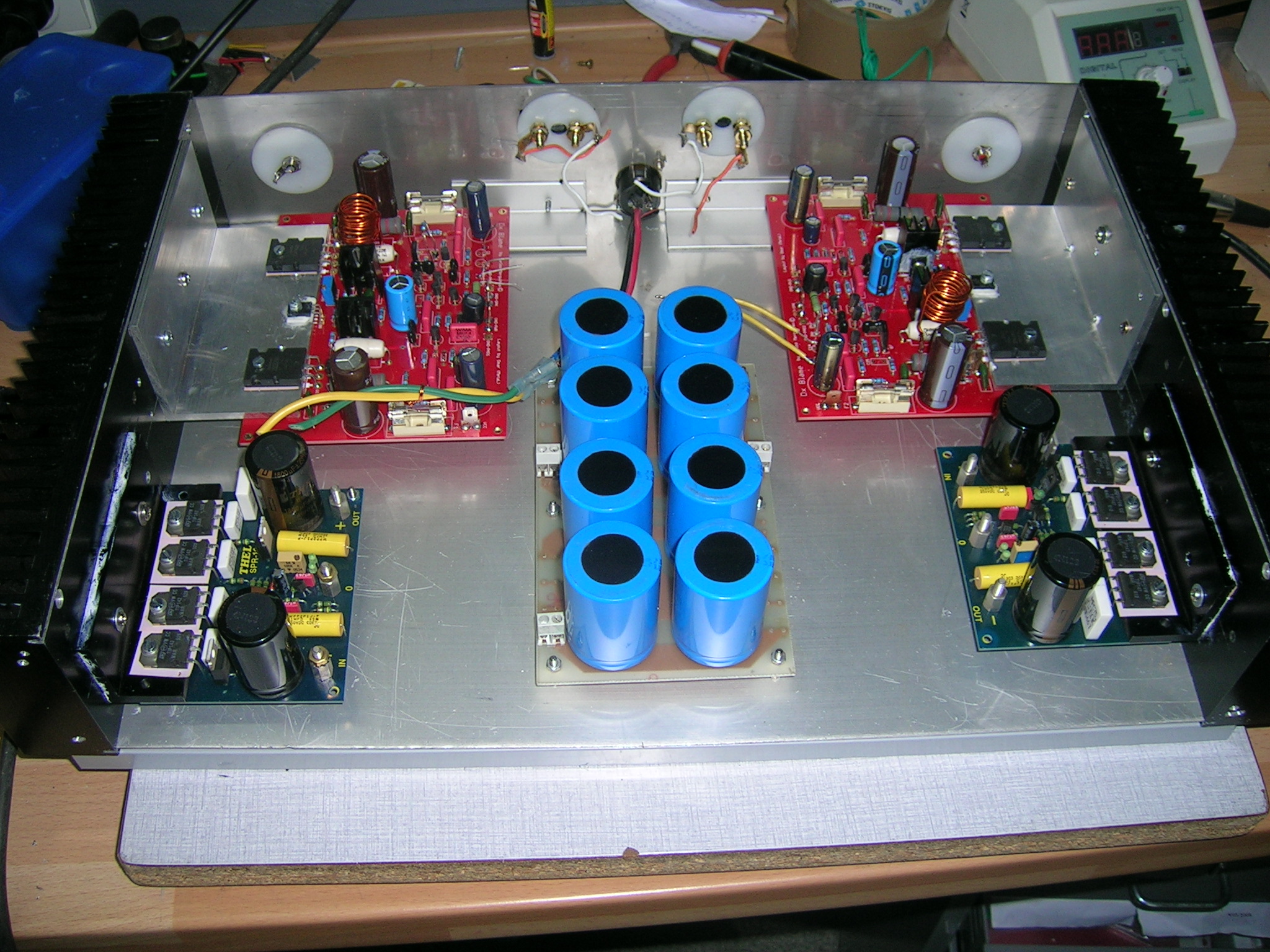

As Carlos says, let´s go on and build the amps. Cases have arrived from Naoko, transformers from Toroid do Brasil, 5600x63 electrolytics from the USA, parts from Hayamax. Only one piece is missing. And we will keep waiting till the end!
Photos to come.
All the best for you all.
Max.

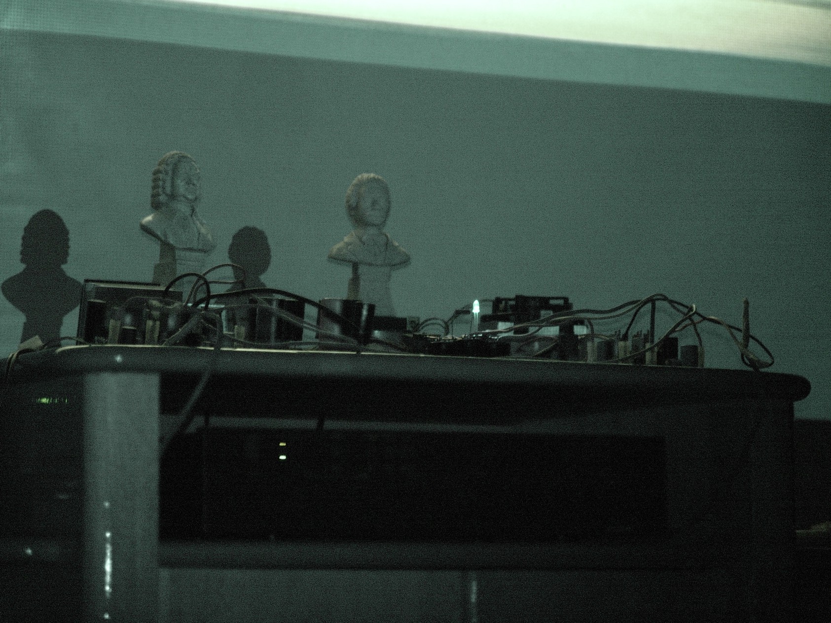

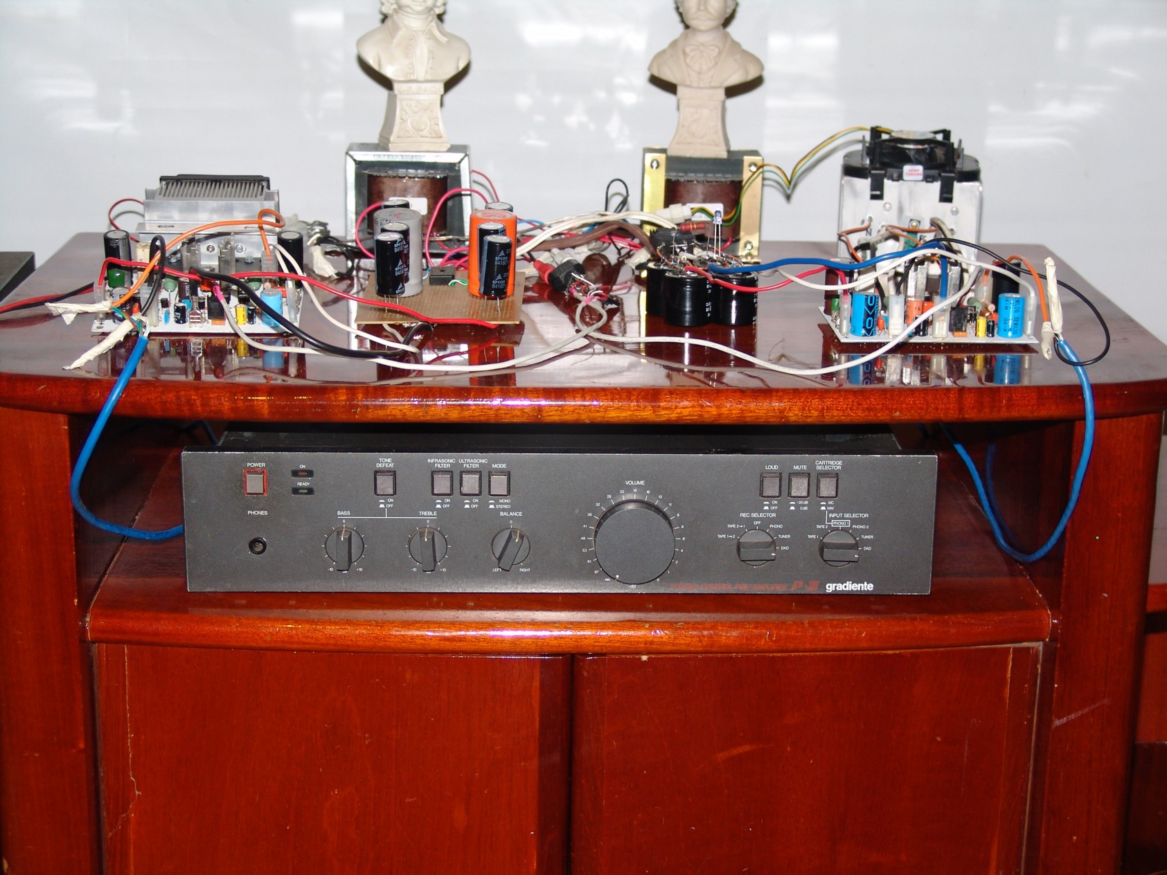

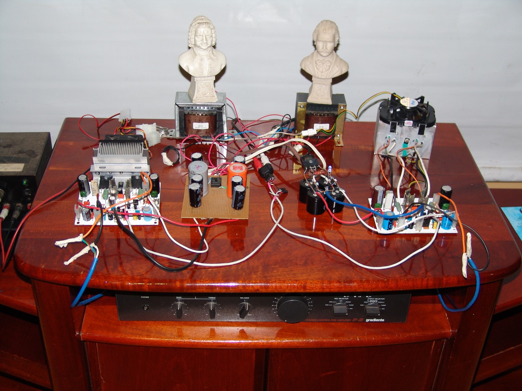

DX Blame show last saturday!
DX Blame ST has done a great job, playing 2 hours of good classical music, with crisp sound, outstanding performance, even with not proper PSU.
Some pictures attached (it was my birthday, there were 19 persons inside the living room!). Last photo: me and friends. Youtube videos being uploaded right now.
This week it will meet the case.
All the best,
Max.
All the best,
Max.

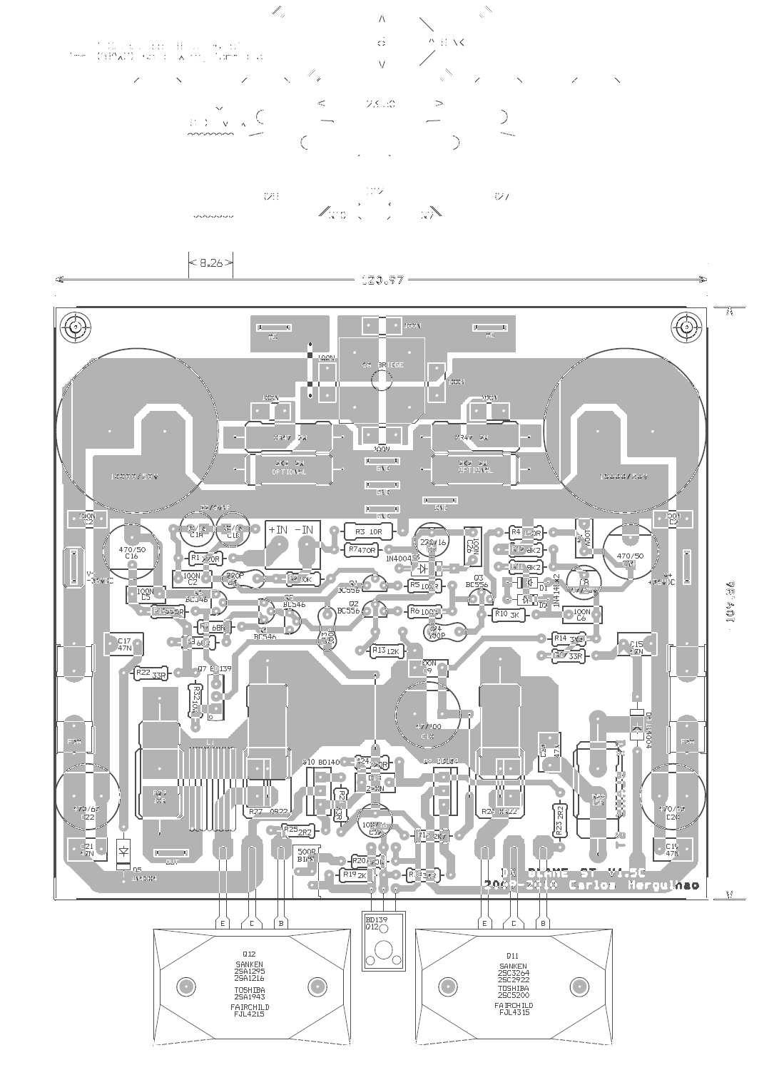

The PSU-filter should consist of 0R47 / 1n5 in accordance with Carlos' DX PSU.
Best regards - Rudi_Ratlos
your right, thanks for pointing it... it was copy n' paste i forgot to change the values... and as you said the star connection was omitted is it nescessary to use fast diodes?
here is a revised pcb...
