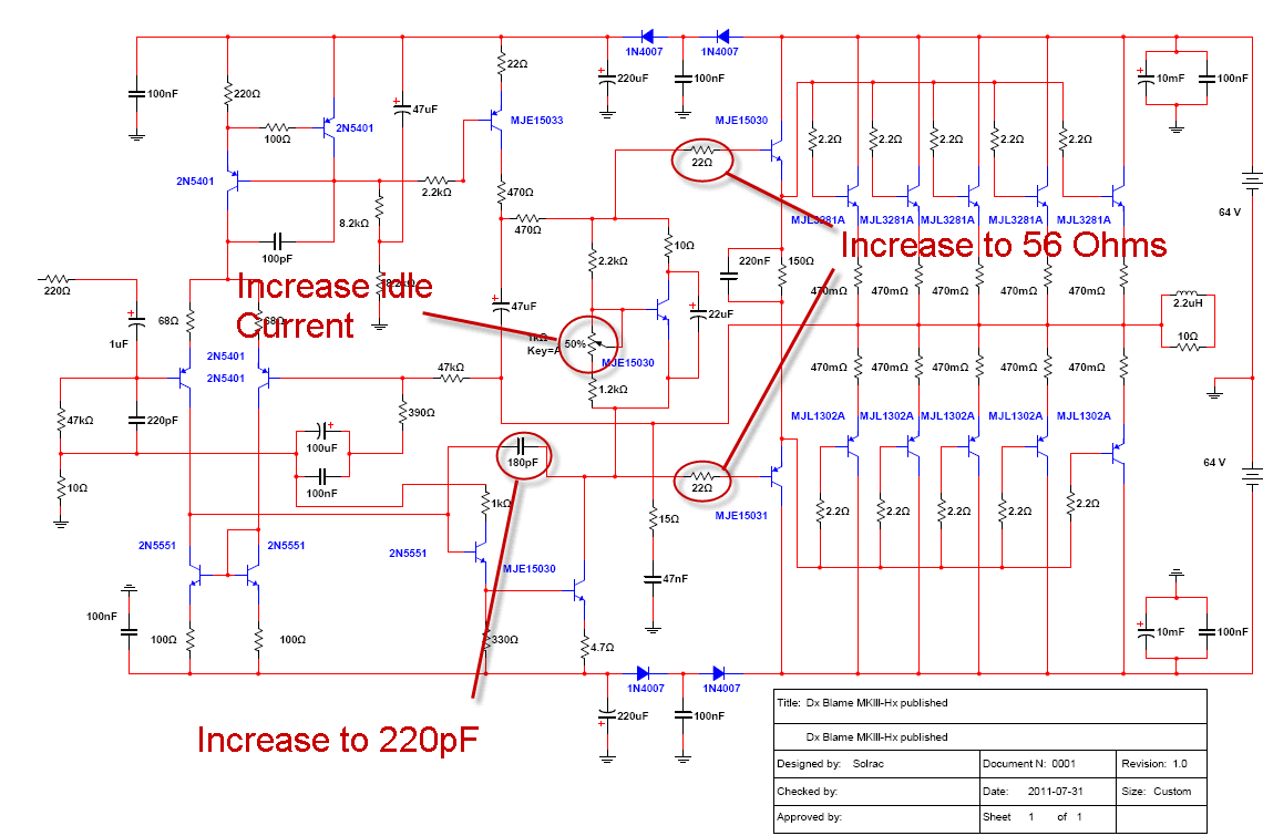

I may investigate in the modifications Bonfis did as I'd like to increase idle current. But I'll need a scope to identify any sign of oscillations...
Will a 20MHz scope do it, I mean in the audio world? Will it show me any high-speed oscillations, or do I need to go 60MHz+

It can actually be tuned to result in a different performance
we can do that using simulator, but the best results happens when we do that listening.
The idea is to adjust some components to reduce third harmonic compared to the second... this will give you something people called "tube" alike sonics, because tubes measure very badly but sounds very good to human ears... these harmonics are pleasant and do not bother us..the ones we hate are the third, fifth and seventh harmonics...these ones we hate..but they should be present too, because if they are not present...sound becomes stérile...lifeless.
There's a consequence when we do that... the sound opens in an extraordinary way... the brightness into the treble comes giving some "shine" into the treble as they become thinner compared to the previous, former, reproduction filled with harmonics till the top...this makes the sound fat and a little bit unprecise... timbre becames a little bit damaged because other frequencies (beatings, the harmonic results) goes together changing the pitch of the tone... so, a bell is not the bell sound.....it looks we have installed hundreds of very small loosen rivets on it that goes shacking and producing a sand grains sound when sand grains hits some aluminium can after you shake it...you now...the fundamental sound from the bell has added a sand noise.... could you get it..becames "fat" of harmonics.
We have this effect... i used to reduce "total" harmonic distortion without care with the "harmonic distribution" that means how much fifth compared to fourth...how much seventh compared to sixth...and how much third compared to second harmonic...that ratio is important.
But what was the result dear Cannonica.... the amplifier, the Dx Super A that has a highly superior tuned circuit...became sharp as a razor blade, cutting the air alike a supersonic whip... old tweeter ressurrect becoming alive and hitting our ears with celestial sonics from heaven.
But it becomes nearby the threshold of oscilation.... any foolish you make and your amplifier gonna drain all your power supply energy producing an astounding oscilation that may kill some transistors or may produce some kind of damage.... and this happened not because i am 52 years skilled...but because i was lazy... one more discovery by accident...that opposes and dennies the say that good results depends on 80 of perspiration and 20 percent of wisdom... sometimes depends on accident, the imponderable.
I was tweaking a Dx Blame ST, already transformed in Dx Super A (*) when i have faced the sublime moment of lazyness.... the Dx Blame ST is using a single pair in the output.... when the Dx Super A is using two pairs in the output.... then i felt myself lazy to install the second pair and i persuade, wrapped, cheated myself saying to myself that would be a good idea to compare a Dx Blame ST under the same conditions...so... left side Dx Blame ST, and rigth side Dx Super A and both with the same transistors, same supply, same enclosure, same speaker, same filters, same rectifier, same wiring...well.... totally and absolutely equal.... but simulator said to me that with two pairs in the output would be much easier to reduce third harmonics....i was stubborn and i decide to work into the simulator to get the result i wanted.... and i make it.... but when installed i found the amplifier dangerous... touching the input with my finger tip (AC from mains wiring irradiates electro magnetic energy in 60 hertz that travells into the space and hit my body.... and my body has hemoglobine that is full of iron, also we have water and salt inside our body, so, we are metal too, and antenna....my finger tip had developed a DDP of 60 hertz signal, a human tone generator).... then touching i have listened the hum (60 hertz) and a high pitch tone and the "devil's whip"... the sound of radiomagnetic propagation opened... and this only Radio Amateurs knows, the sound alike whip cutting the air... the "chirp" sound that seems oscilation...i had to revert some of my modifications because the sound resulted poor and stérile...i found that we need to dope, to pollute a little to become good to be listened...this was done listening and working hard.... fully perspiration stage.

Thank you..... but my last discoveries opposes a little
when compared to this schematic i sent you long time ago.....i imagine i did it.
Stop resistor is something you should decrease instead of increase.... try 10 ohms.
That capacitor should be reduced to 100pf and observe if you have oscilations.... it gonna be easy.... the protective resistors will show huge current and trimpot will not control the current under oscilation... a huge current will be drained and output transistors will become hot in a matter of seconds.....if happen, then increase the capacitor back again... i was very careful land i was working in the safe side...the value there is 120pf...i have increased to 180pf to 220pf for safety reasons..because scared.
When an amplifier enters oscilation, we face a very interesting effect..the rise of temperature is so fast the transistor has not time to transfer the heat to the heatsink, so the transistor case become very hot to be touched.
Well..this name, oscilation sounds terrible..but if we analise... an amplifers are oscilators that goes oscilating following (tracked) by the input signal....but only when tracking input signal...when it do that by itself, producing a tone or a carrier (high frequency) then it is abnormal and we use this terrible name....but the amplifier is also an oscilator....it oscilates all time long..oscilates from positive rail to negative rail...the audio swing.
The increase of current is a good idea too..but be prepared because it gonna work very hot because of that.... from these three suggestions, now a days the only one has my support is this last one, to increase (a little) the stand by current.... a little.... 35 percent maximum increase.

Sparking my interest again ... Interest + effort = DX MK3.2
I'm using 40 volt PSU , as i can use this for other projects , if used on the MK3 it will be for output stage , as i believe vas stage was best with 54 volt supply , is this true Carlos ..?
i would like to run sperate regulated supply for vas , would you be willing to post up a schematic to do so with the necessary mods to the main board to seperate supply , i will most likely use mods you sugested above 140 pf instead of 100 , 10 ohm resistors and of course up the bias and compare ..

I am now a days focused into the Dx Super A
So, i will not labour into this one... i am suggesting people to make their own efforts to upgrade it and update it.
To use separate supply you just remove the diode and install one supply into the power transistors colectors and the other one enters left side hole where you had the rail diodes.
I do not think this is needed... waste of time Wayne.
These things require global modification, almost a redesign...and the one i have redesign is the Dx Super A circuit...you can copy from the Dx Super A some ideas but you should simulate to check this stuff.
I am not "in" this project anymore...now i am taking care or other ones...this amplifier is finished for me...alike a complete mission...i am in other ones now a days.
