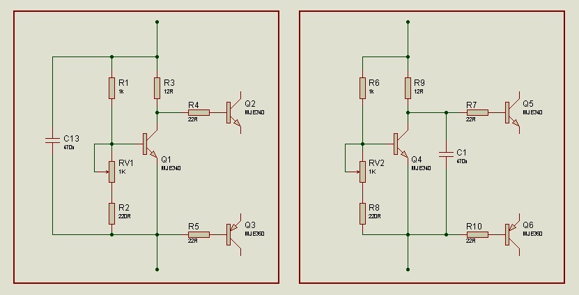

Just another question, does it make a difference if the '22uf' capacitor in drawing is over the the collector/emitter alone, or over both the ce and the 10R ?

I think the capacitor should be the AC link between the VAS and it's current source/sink. The left diagram.
But others have said the capacitor should be across the bases of the output stage. The right diagram.
Two viewpoints.
Maybe careful experimentation and/or simulation to discover what the experiment should be trying to reveal.
Two viewpoints.

I didnt know D. Self talks about this (I need to get his book), but here is an analysis on the same by Hawksford, thought you might enjoy it (if you havent seen it).
If the cap is intended to speed up the base charge removal then it should be closest to the drive transistors (the right) but since the resistor is only on the order of 10 ohms I dont think it matters signficantly.
-Antonio
