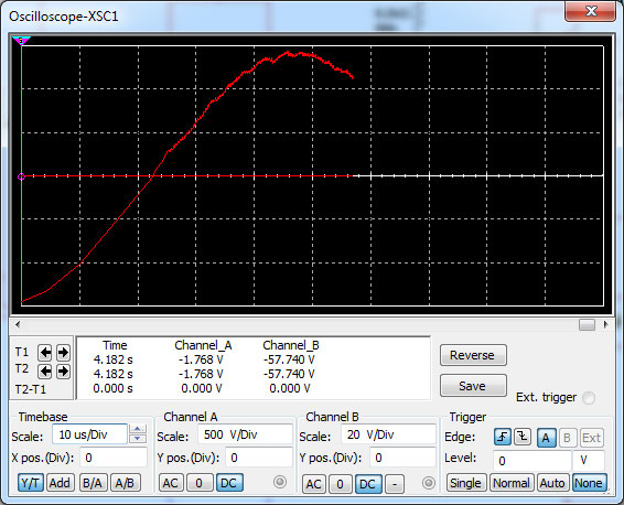

Decreasing the stop resistor would go on the opposite side of the solution I want to apply.
The first issue I had is explained in post 1172.
Bonfis had similar issues in his post 1241. He solved it his by increasing the stop resistor to 56 Ohms (post 1291).
In the simulator, I get instability as soon as I reach 3/4 the power with the 22 Ohms resistor. Increasing the stop resistor solves it, decreasing it to 10 Ohms get things worse.
Of course increasing Cdom a bit won't hurt.
There's a screenshot if simulator oscillations with stop resistor to 10 Ohms.

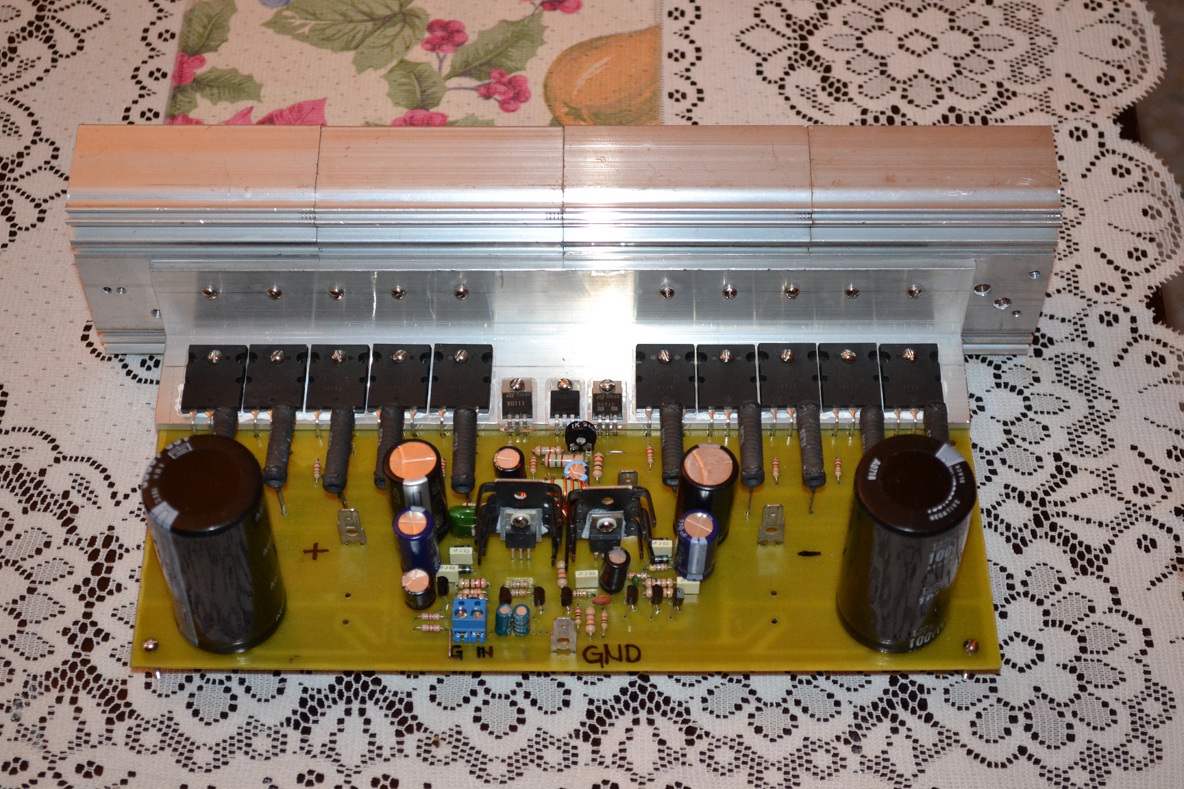

Uncle Charlie,
I would like to thank you for this Dx MKIII, been setup and tested this amp last night and bias was set on .23mV, Wow I really like the quality and very punchy amp... i'll take more update photo tonight and post it here.
Many thanks....

Thank you dear friend....yes...it is very good
I like it too..... was tuned for sonics, but mainly into the simulator...i have made small touches into the workbench searching for more and more stability because some novices have decided to build..then i was very carefull.
People, these old days, where addicted to simulators and numbers...some came to me because of small distortion numbers...this way i have made for them...with good numbers and special stability...at least i could find any issue in my home.
This last amplifiers was made mainly for sonics.....more close to the threshold of oscilation, tuned sharp as a razor's edge
Your pictures are very good...is it a Sony Camera?
regards,
Carlos

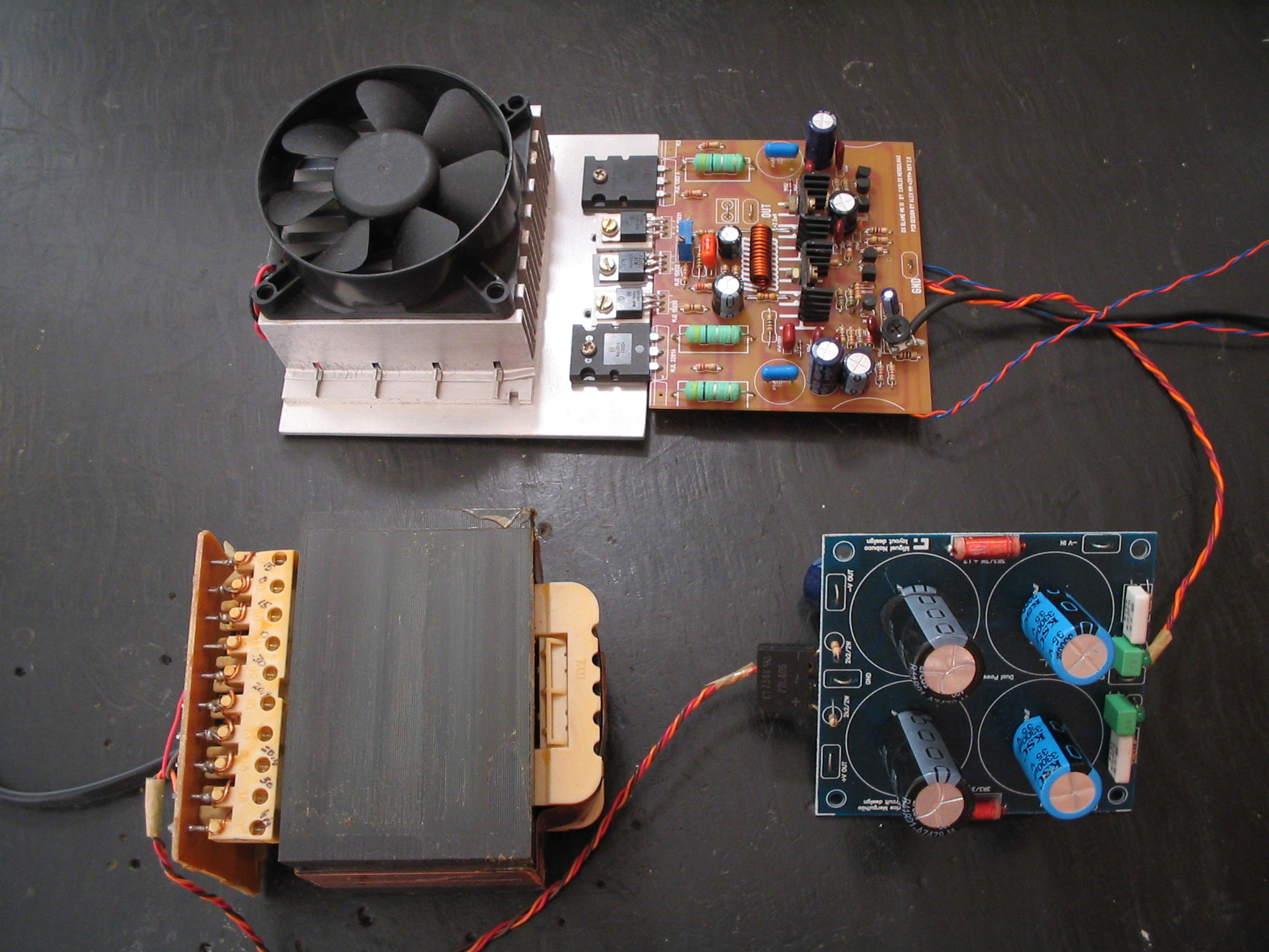

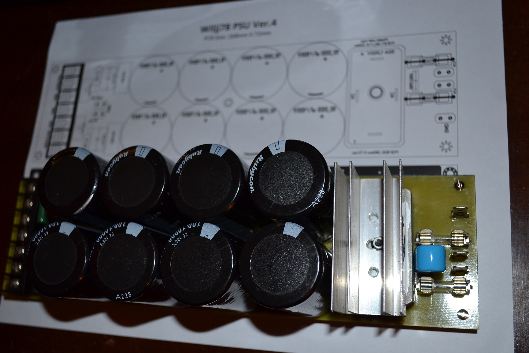

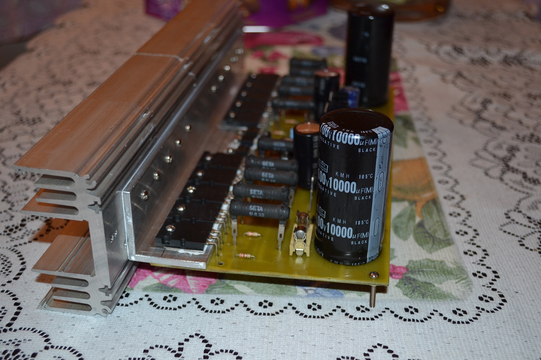

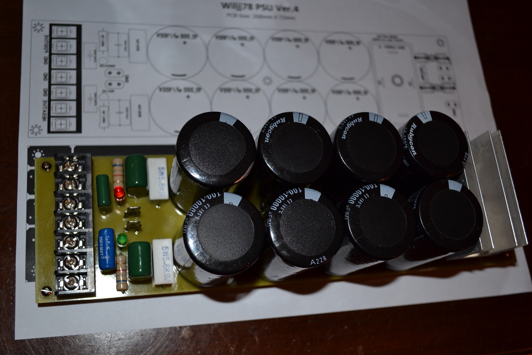

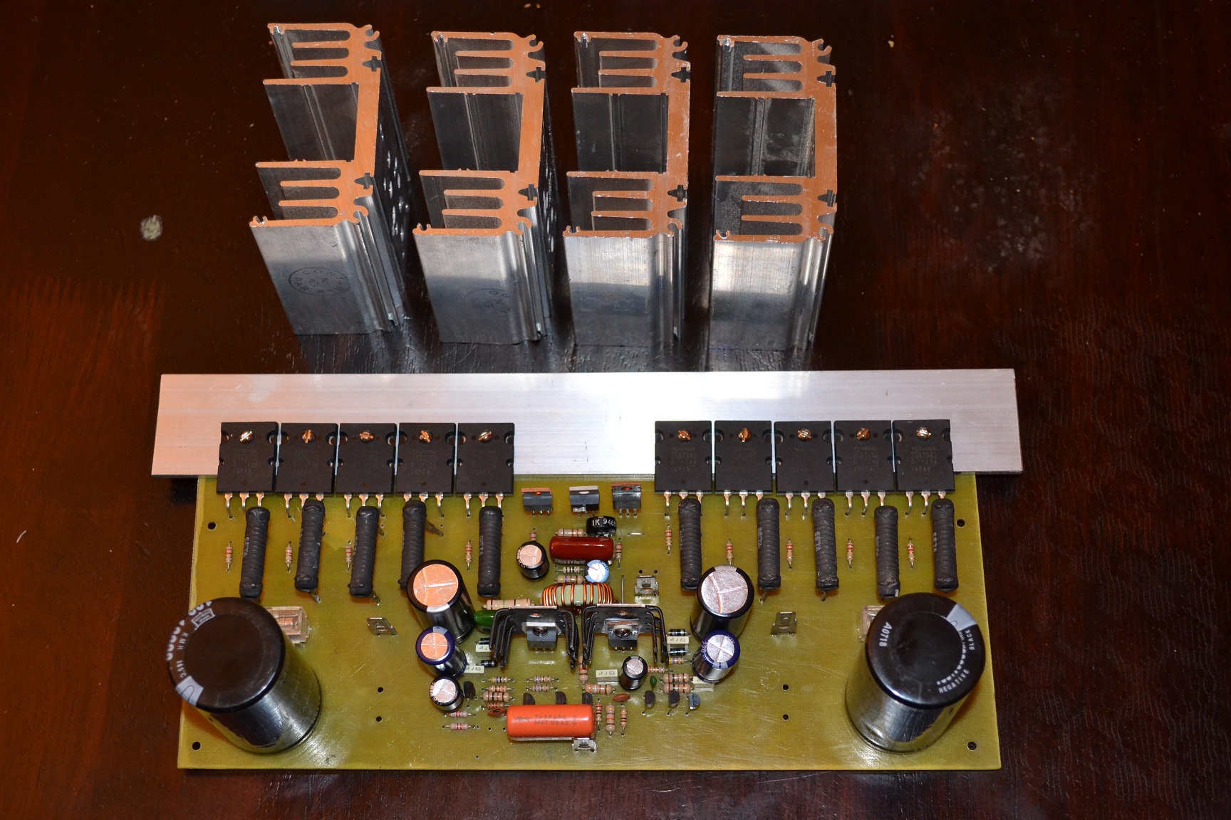

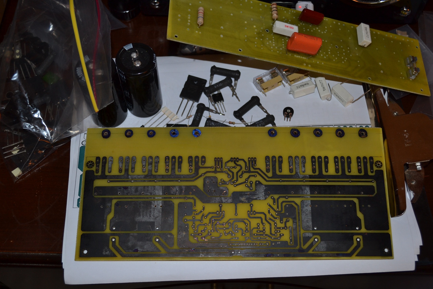

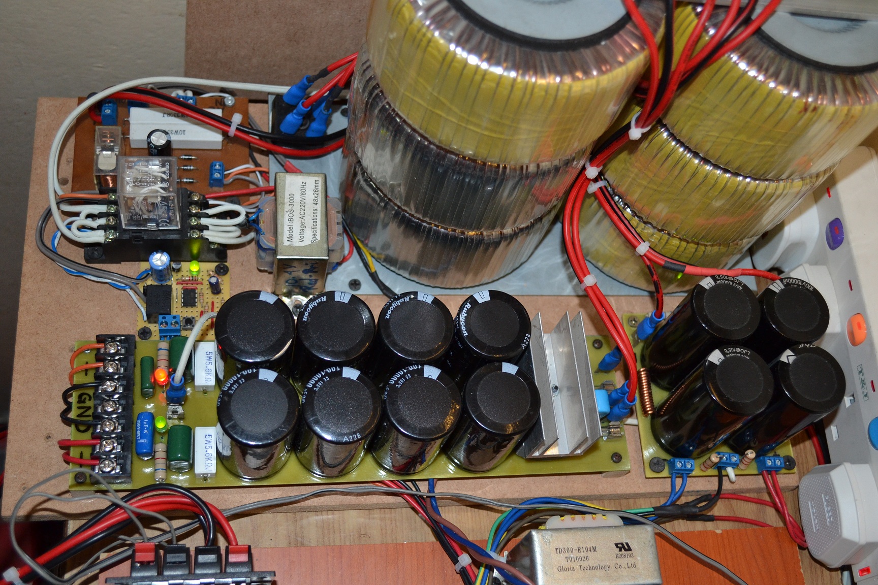

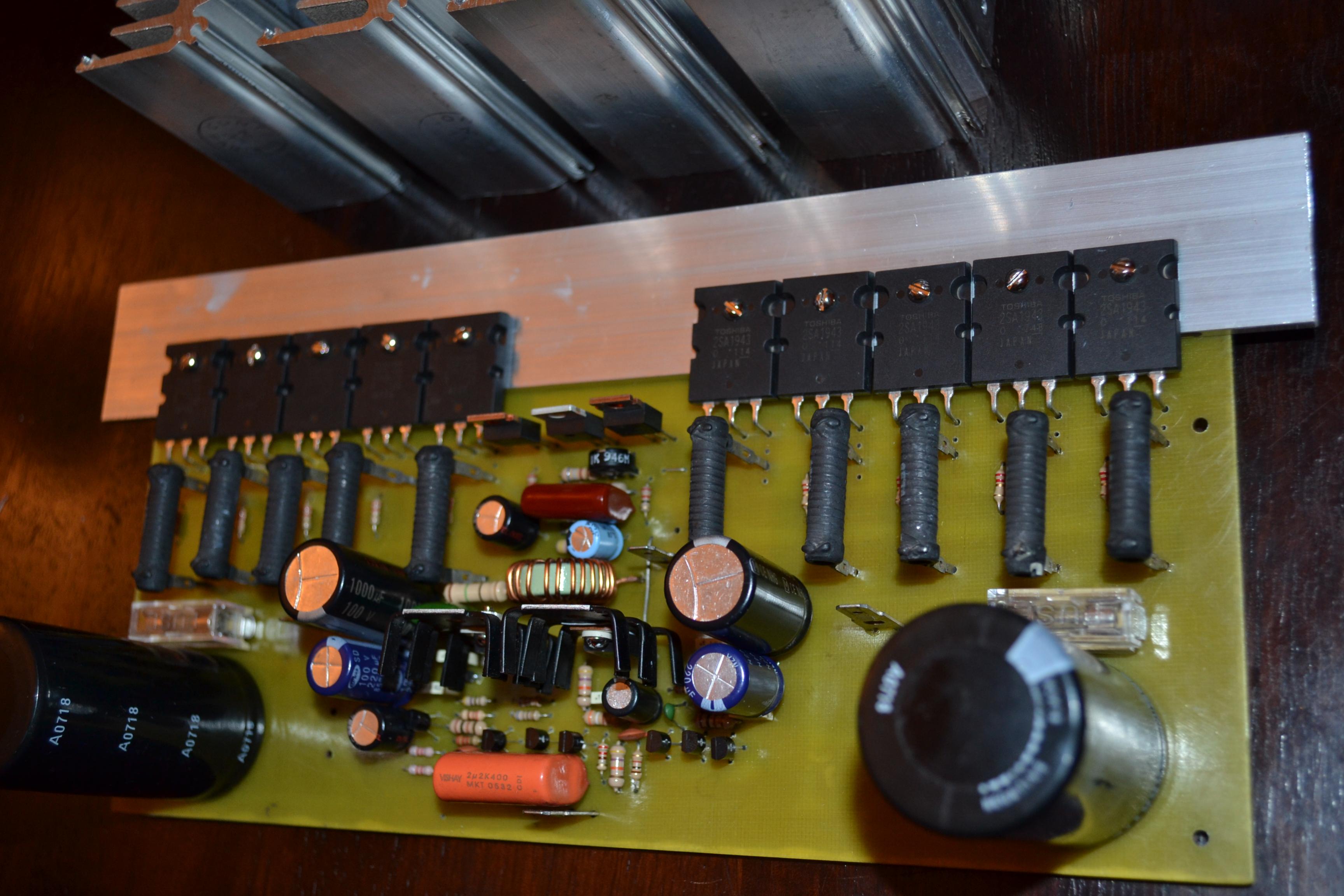

My MKIII and PSU

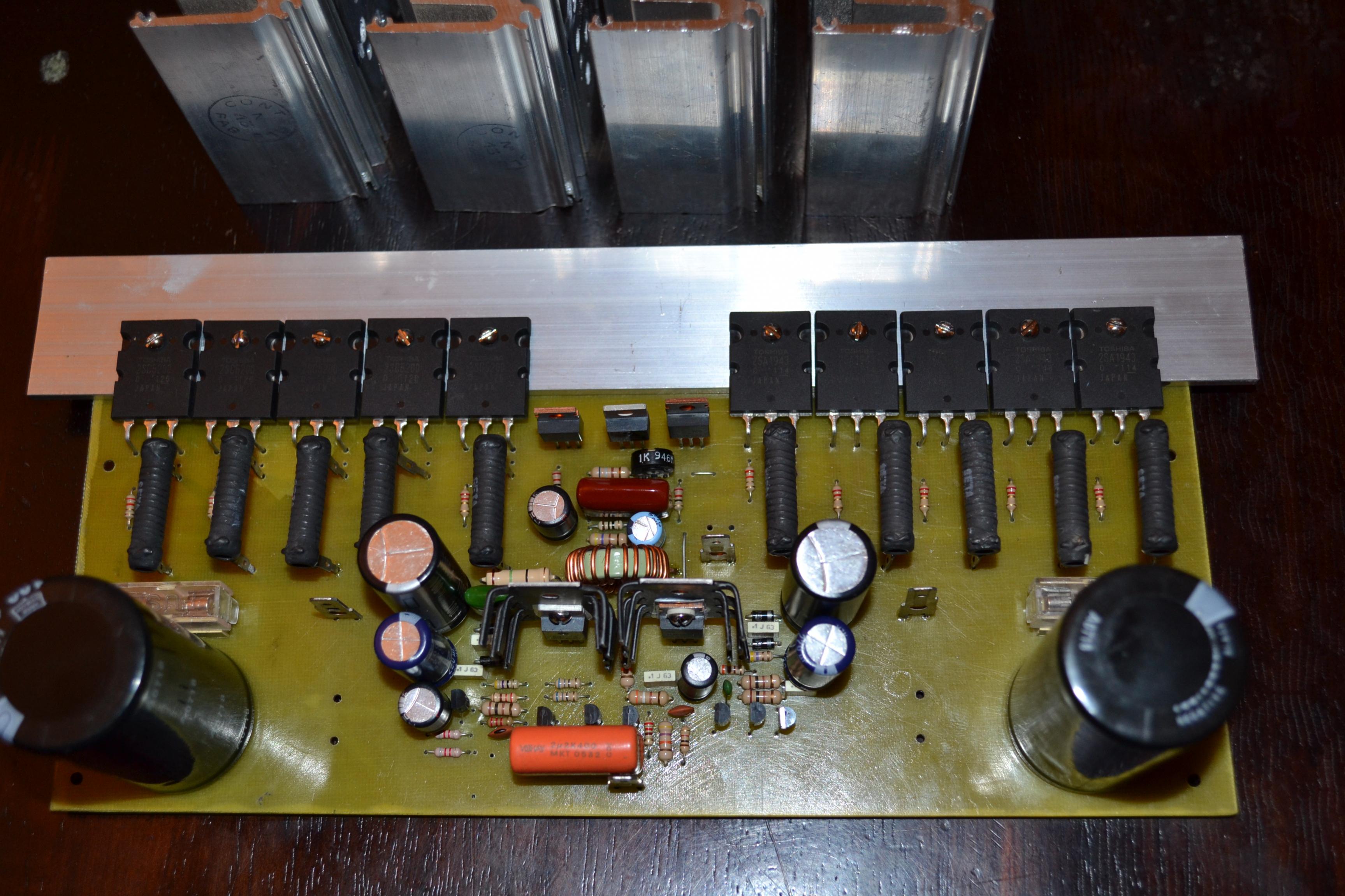

Uncle Charlie,
This is the update pictures of my build, driving my nano ipod the amp works perfect, but when i change my player to Asus notebook and adjust my media player equalizer i surprise after 3 minutes playing music my output tranies turns very very hot and when i check the bias is incresing to 185mV and so on...
hhmmmm... i wonder what could be the reason?
My supply is +/-80VDC using those 4 toroidal transformer.
I know uncle charlie your too much busy to answer but i'll just post my question and experience hoping anyone who experience the same can give their inputs and that would be much appreciated.

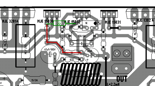

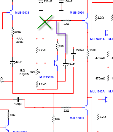

Watch out folks, I think i've found a mistake
Please someone confirm... If it's really a mistake, it's present both on the official schematic AND on the PCB...
Please refer to the attached pics...
I think the base-stopping resistor of the positive side driver is not connected properly to the biasing circuit.
I can't believe i didn't see this before (and that nobody did).
On the schematic: the purple line is what I think to be correct junction.
On the PCB: the red path shows that the connection to the biasing transistor's collector is made through both the 22R and the 10R. I think it should be done only through the 22R only.
Please friends verify and tell us!!
Martin.
