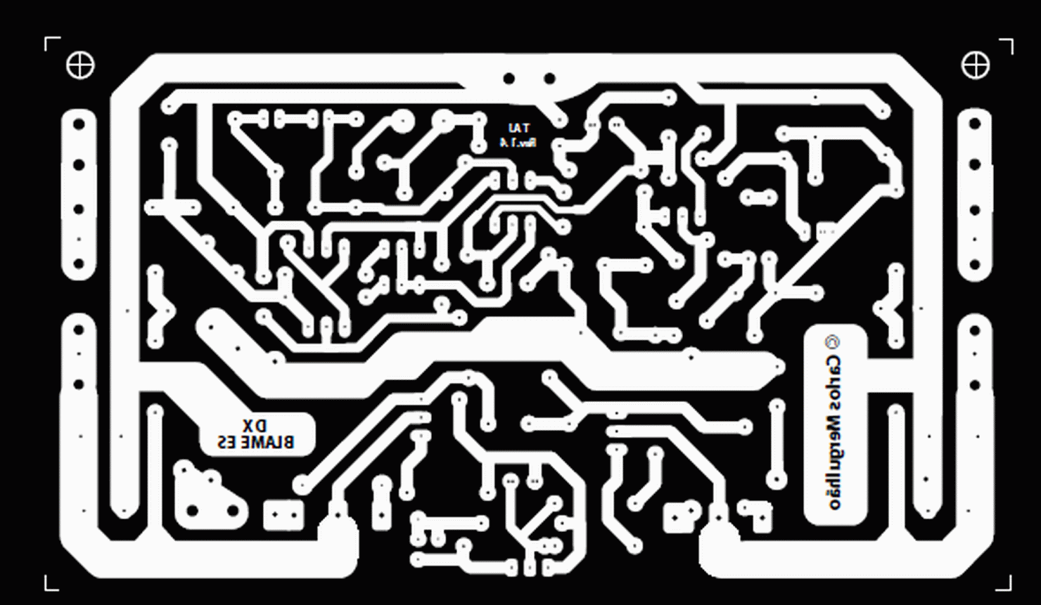

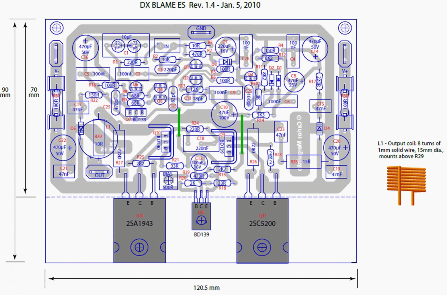

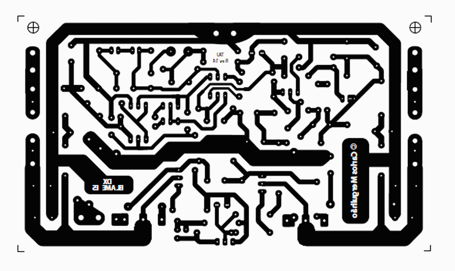

New PCB files: v1.4 attached.
- VAS connections fixed
- VBE multiplier resistor connection fixed
- More pad spacing for TO-92 and TO-126 transistors
- more track spacing in tight spots
- Added [optional] output coil footprint (and instructions)

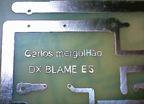

One more building, Danilo e building using his own eagle designed board
It is very popular to use hot iron transference of toner to the board here.
People prepare layout and then they produce laser printer copies, then they attach the toner image against the board, copper side touching the toner, last movement is to apply heat using hot iron, these ones we use to our pants and shirts when they come out from the washing machine.
The toner melt and is transfered to the copper board side alike a rubber track, this protects against the corroding acid we use (Percloreto de Ferro), the board can go to the corroding bath.
To remove the paper, we let it under the water and we use finger points to remove completely before go to the acid to corrosion.
Result is never very good, we also use to paint the board with photo sensitive material and to transfer the image using the layout printed in a transparency film, the tracks are transparent, them we apply strong light that crosses de transparent tracks and go to the photo sensing chemical material..this works better but is expensive and the chemical product is not easy to find.
We do not use to order boards in small numbers, the cost is too high for our brazilian standards.
I have tried to fix something in the left image, some letters were missed because the hard corrosion the board has suffered.

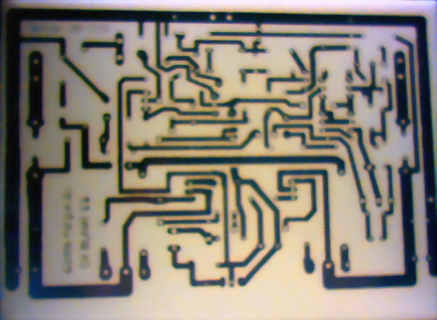

Marcisio, our Thai Box champion, has printed a very big image from the pcboard
to give it a triple check.

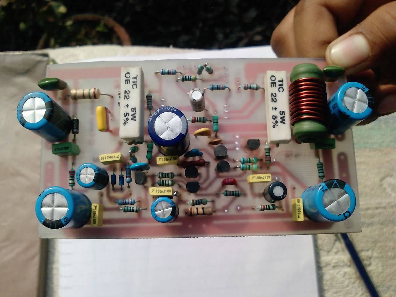

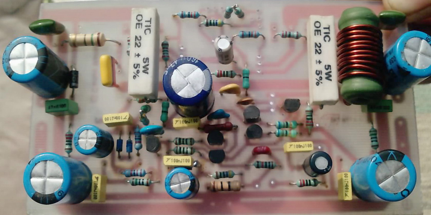

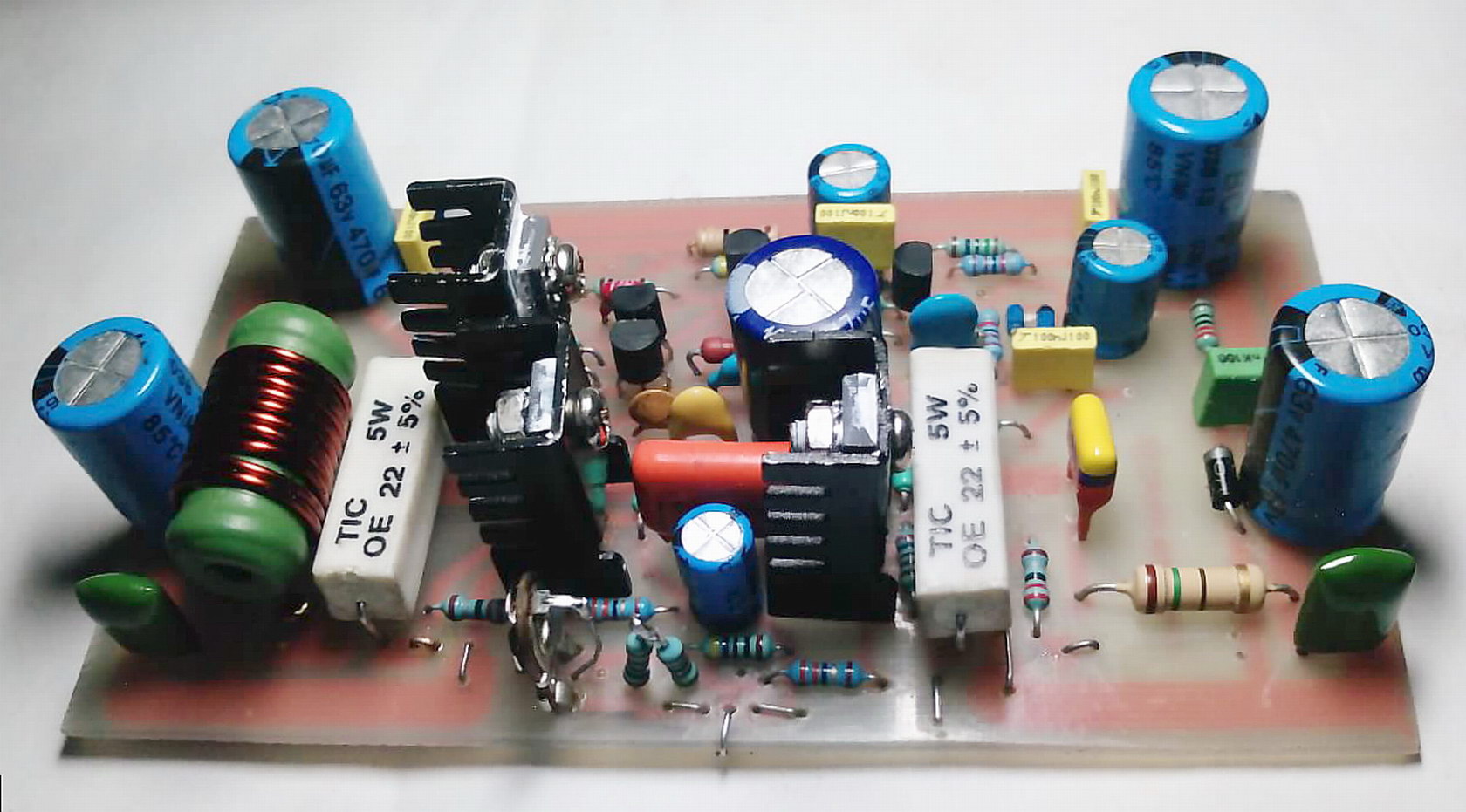

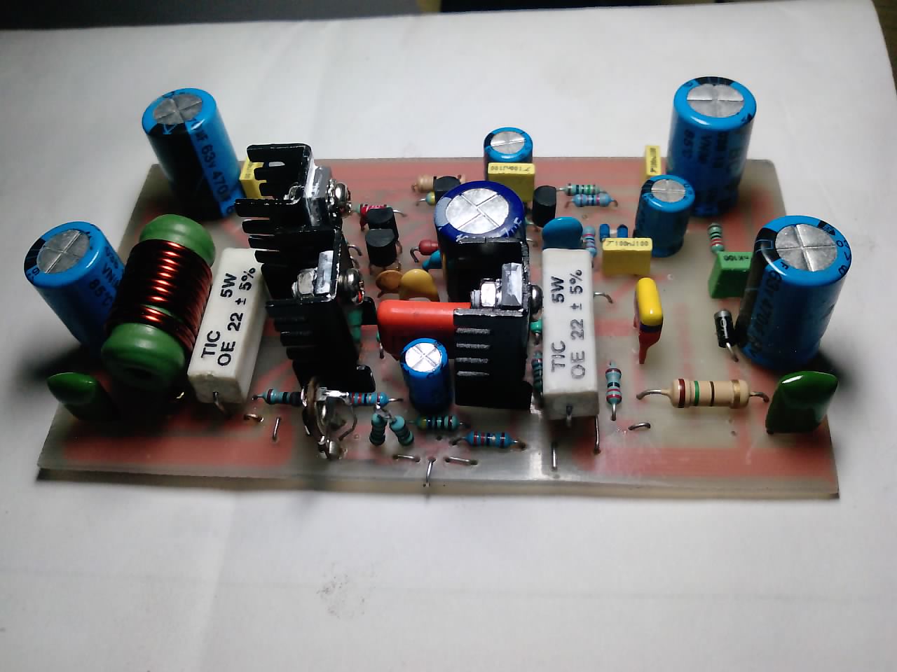

Great!.....nice!... thank you Andrewlebon
Nice pictures, good resolution, good light, nice focus, pretty boards and LOVELY amplifier.
I will be here to help, you know we have the pcboard version 1.4, also the layout version 1.4, several things found wrong, a friend using version 1.0 is having hard time searching for our mistakes, in the circuit, and also in the layout.
I suggest you, deeply, to INSPECT carefully your board, against strong light, and follow each copper trace and track, draw the checked lines into a schematic you have previously printed, then go painting, or drawing all lines in red to be sure everything is connected and no short or missed things are there.
Check your transistor leads several times, BC546 and BC556 have the base in the middle, it is different compared to the traditionally used 2N5401 sand 2N5551, these were not used as voltage is very small, simulators shows almost the same result with one or other, also listening tests have not show audible, listenable differences.
There's important capacitors, cannot forget these ones, the second VAS, the BD139 colector to ground (470pf), the CCS base to coletor (100pf) and the compensation capacitor (82 or 100pf) from second vas coletor to first Vas base.
Current, in stand by mode, must be adjusted from 30 to 100 miliamps, and 44 miliamps is what i am using with nice results and excelent simulation, this keep a good current crossing the power output transistors, each one of them will dissipate 1 watt.
Of set, usually goes to 14 miliamperes, the 1K resistance, or 1K2 resistance, in parallel with R68 should be used if really needed, you may tollerate off set till 25 miliamperes without bother with off set... good forum engineers told this is something may unstabilize, so, better not to use, unless hardly needed.
I am here to help, if needed.
regards,
Carlos

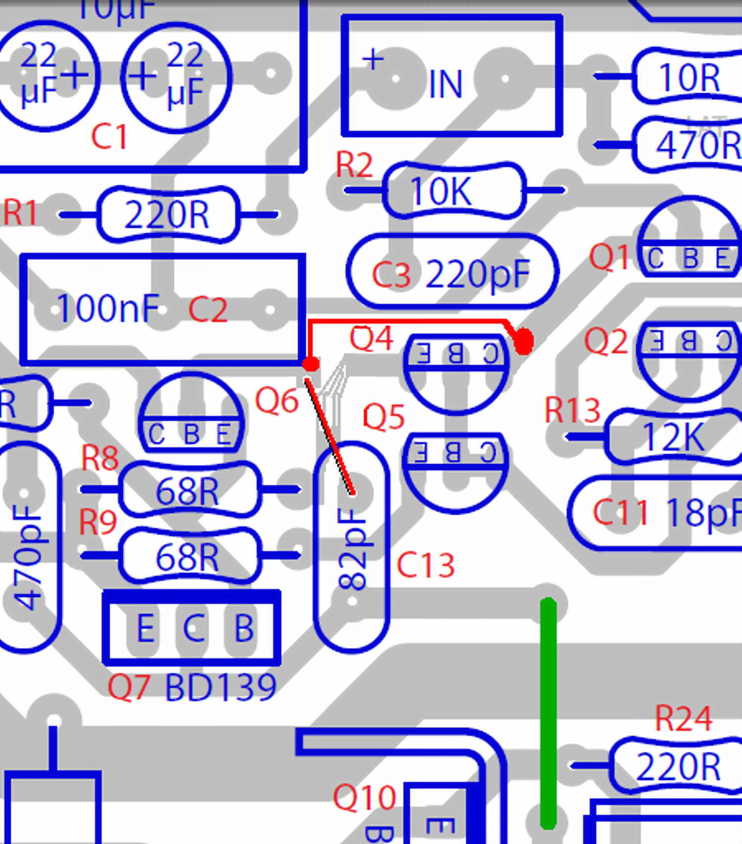

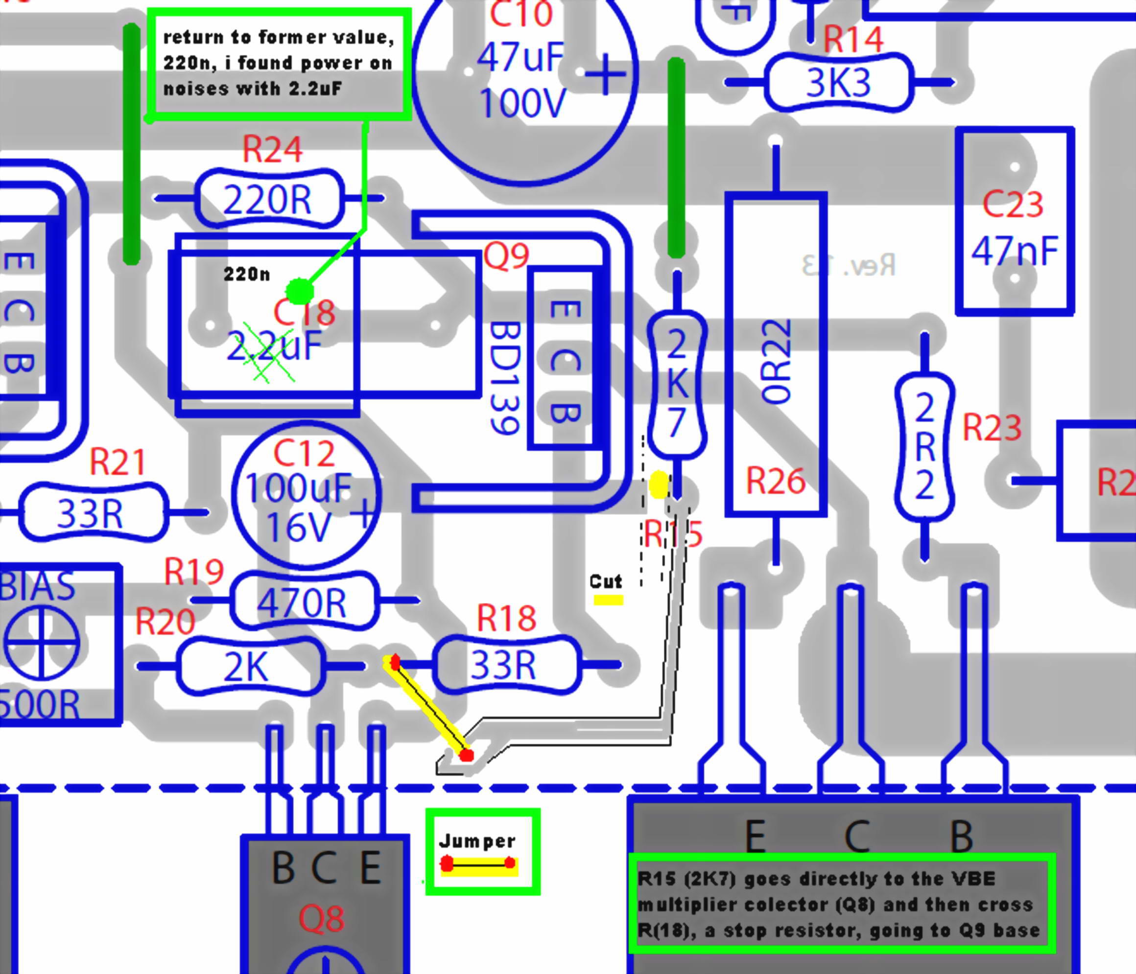

Attention Andrewlebon!
There are errors that were fixed in the version 1.4 layout
here the images used to inform Todd that we had these errors, they are now fixed, but i am afraid your board have these errors, as your boards seems to me not to be version 1.4.
So, you have tracks to cut and wire jumpers to solder.
regards,
Carlos
regards,
Carlos

Check everything before power the unit on, those former boards
1.0, 1.1, 1.2 and 1.3 have errors, so, you must check everything.
The one you do not need to check is 1.4, this one three friend and me have checked, the chance to have remaining errors are very small, but it is not impossible to have errors, ship happens!
Wait for a perfect ballanced sound, with the highest possible quality in the high frequencies, the best audio amplifier i have ever listened.
But, i think the bass is shy, yeah, not my boomy head taste, the Dx amplifier produces much more loosen deep hell bass.
Watch this video, the sound is more to Dx Amplifier than to Dx Blame ES.
A matter of taste, personnal preferences..the best is the Dx Blame ES, but the best bass to my taste goes to the Dx Standard.
