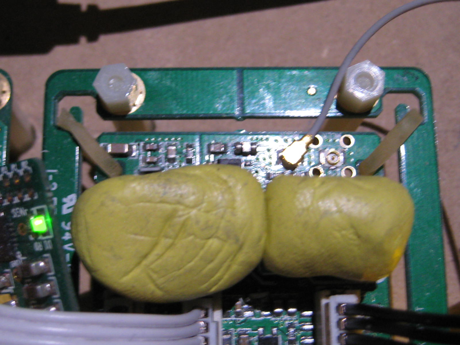

A bit off-topic but one recent tweak that I did made a noticeable difference in sound. I have all of my digital boards and power supplies mounted on a piece of MDF board (see previous posts), and there was some transformer hum.
Even though I have the clock board suspended with latex O-rings cut from surgical rubber tubing, I figured that the XOs on the clock board and on the WaveIO were being affected by the transformer vibration and hum. So I placed some adhesive putty (similar to Blu Tack) under all of the five transformers that are on the board to provide vibration isolation. That got rid of the transformer hum, and the sound, which was very open already, opened up some more.

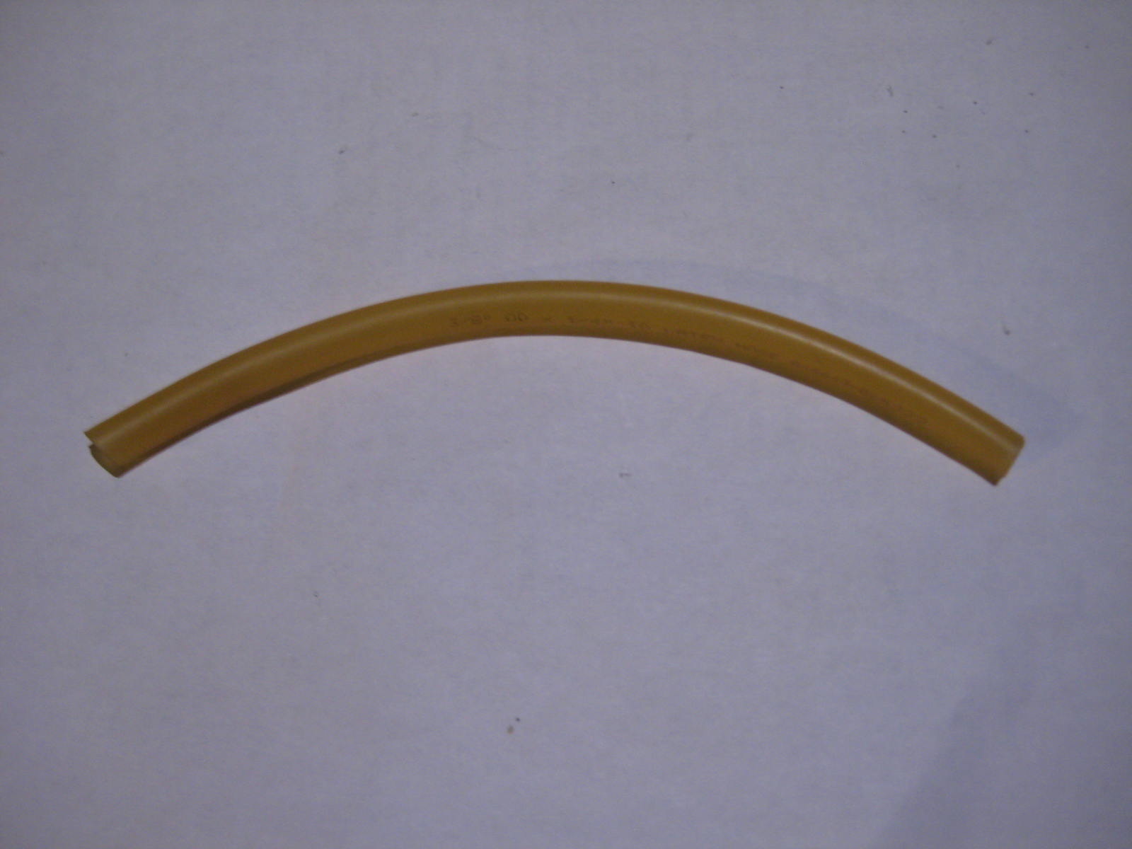

Very smart idea. Can I have your updated pictures? I'm interested in the "surgical rubber tubing". I gave up rubber ring suspension solution because I can not find suitable ones.

The surgical rubber (latex) tubing that I used is 3/8" diameter and I bought it at my local Home Hardware. I think Home Depot and other hardware stores also sell it. When I was a kid many, many years ago, we used to buy it for our diy slingshots.
You can vary the strength of the diy bands or O-rings by varying their width.

BTW, what are the two piece yellow material for the clock board?
Ian
Joined 2012
The yellow blobs on the XOs are more of the yellow tack for further damping and vibration control. I have also placed them on the XOs on the WaveIO.
