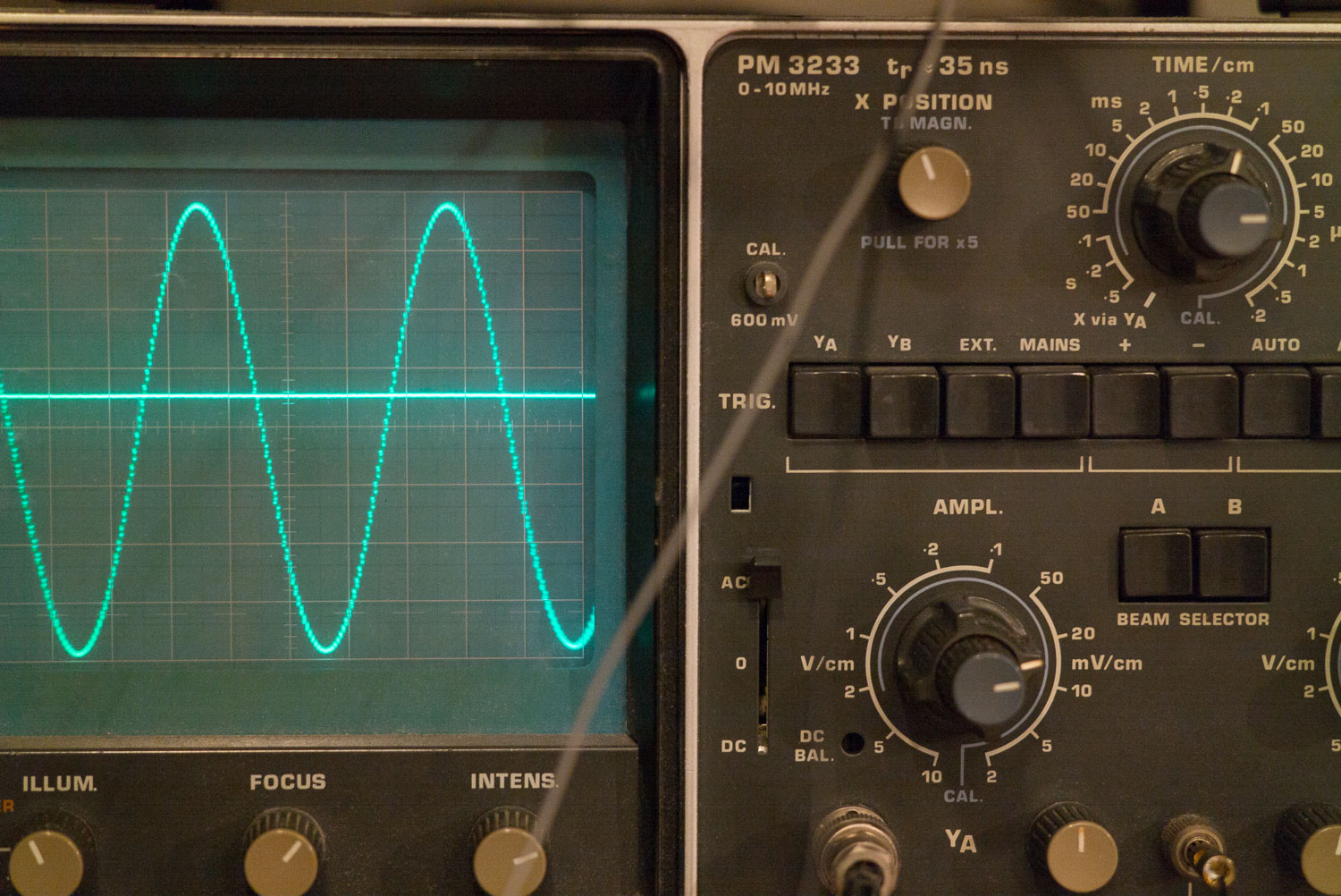

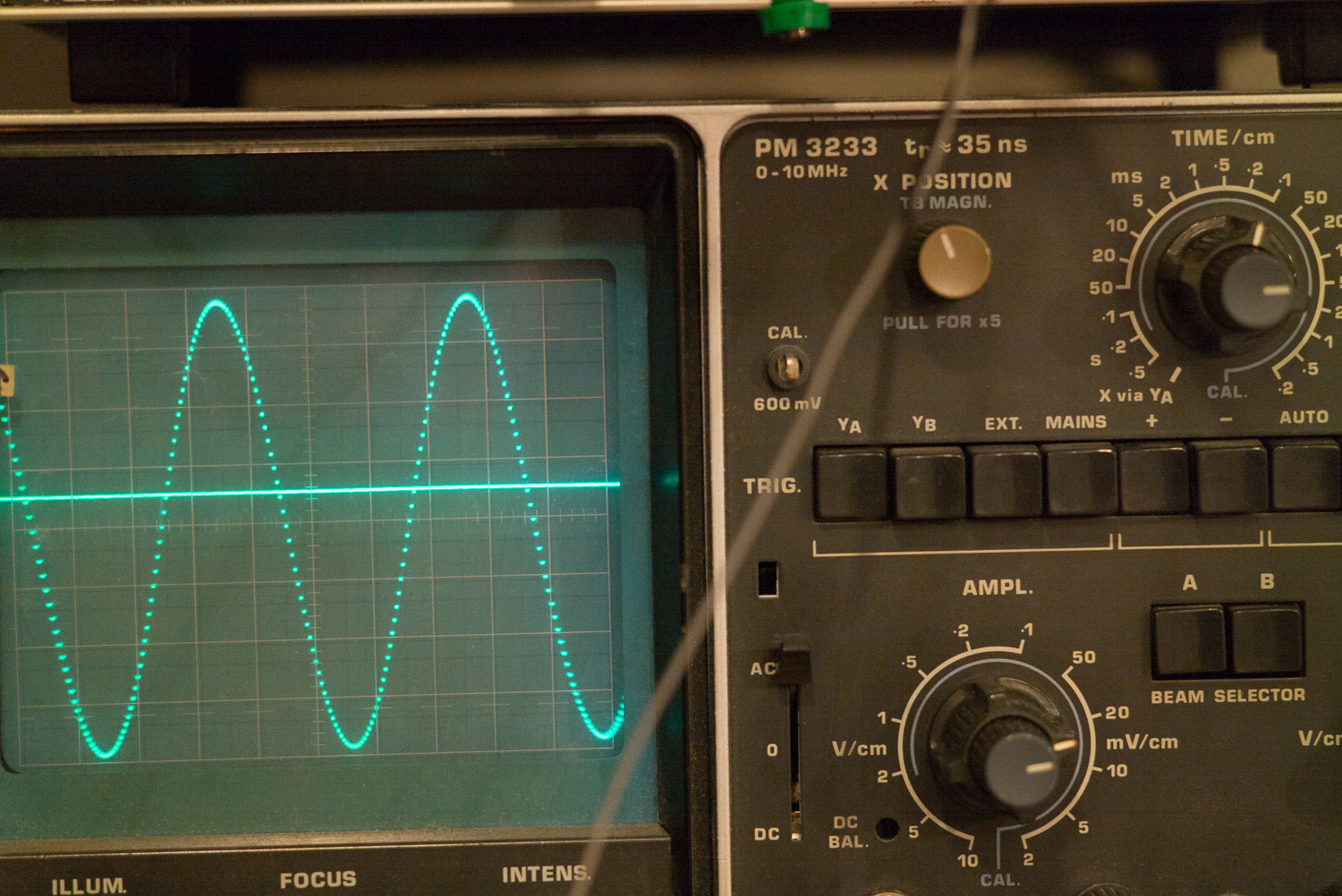

My 88kHz and 96 kHz sampling frequency in simultaneous mode:

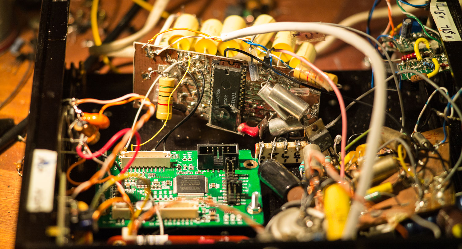

Ian, I shame myself for what I am going to post, but I have some consolation knowing many out there work like this :roll eyes:
One Ufl has a plug (i was only able to get one soldered, all others failed on me) while two have a uff cable only and one (the latch enable) has no shield.
Shields are connected both sides.
I thought the shielded cables were better than the one with the plug which is not shielded (black if I remember) , but I have been thinking of reverting to the plug you supplied with the attached cable.
Well, it gets to a mess once one starts fooling around

My layout and wiring:

If I understood your photograph, the yellow wire is TDA I2S pin 1. Is it shielded ?
In anaother way, I2S wires are very shorts which could not be bad even if the yellow wire LRCK is not a 50 ohms (?) at this length and not so high speeds (?). I say that because the yellow one looks like a 100 ohms network cable (?)....
maybe a Gnd pb of the TDA1541 pcb ? Mainly the MCLK connections between Wave I/O and PCM board and quality of BcK connection (and gnd layout) between PCM and dac chip board.

the yellow wire is single strand wire, for LE, not isolated at all, and I thought for this low speed it would be OK. Thinking about it, the rising edge is a timing edge and is fast of course. . will make a shielded one.

I suspect a problem here: everyone uses the isolated outs from WaveIO and then connects a non-isolated MCLKMainly the MCLK connections between Wave I/O and PCM board and quality of BcK connection (and gnd layout) between PCM and dac chip board.
How did you do it?
albert
How did you do it?
albert
I was wrong in this wild idea: the Mclock on WaveIO after isolator goes to Ians's card.
+ I now used an isolated cable for the LE.
+ I inserted inductors in all entering power lines (not just the earths).
+ and I added a parallel choke on the WaveIO power feed.
And my Macbook is always running from batteries.
Nothing helped.
