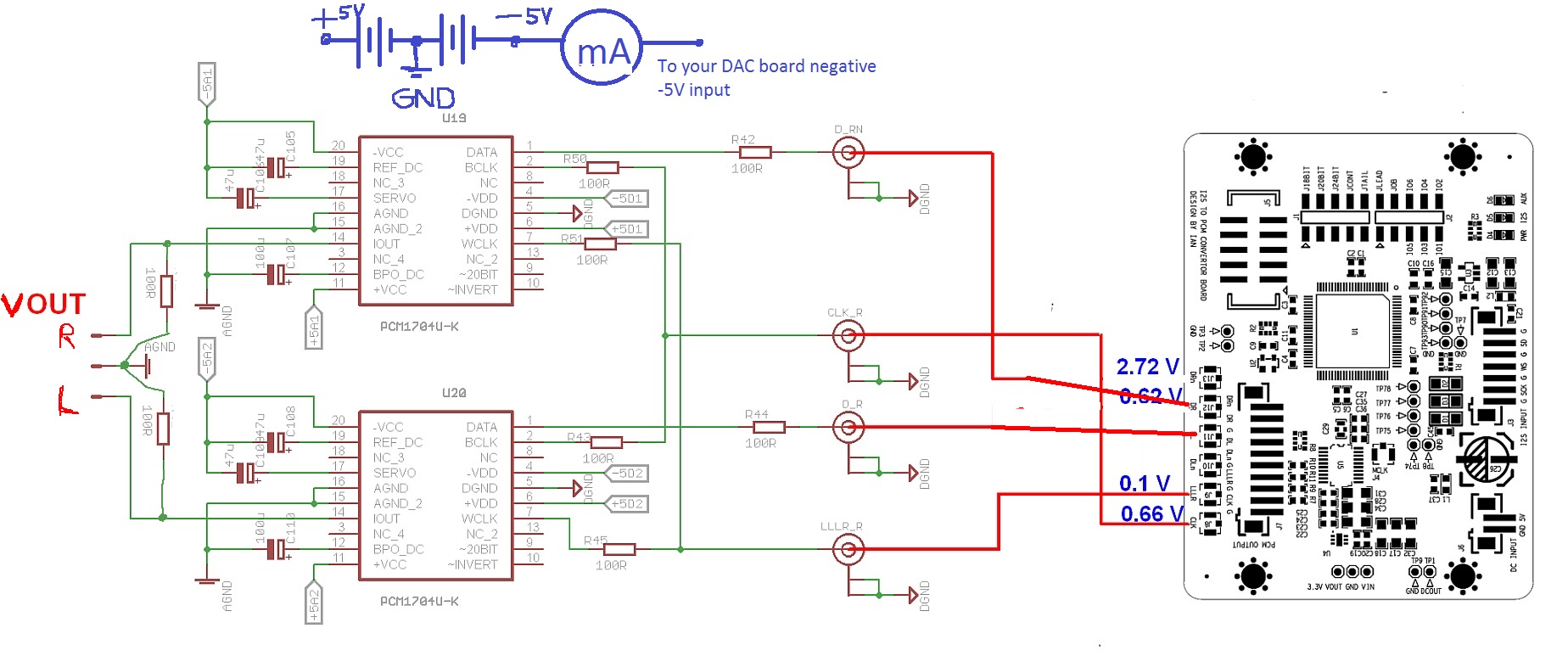

I am in the long process (limited time for my hobby) of building my DIY DAC based on balanced 4xPCM1704.
I've nearly finished digital part of the project. Analog output is still in progress.
Lately I have connected I2S converter to my DAC.
I measured voltages on PCM signals and there are significant differences between them e.g.:
DRn = 2.72 V
DR = 0.62V
LLR = 0.1V
CLK = 0.66V
Is it OK?
Is DRn and DR should not be more or less equal?
Is LLR = 0.1V not too small?
Is my schematic (below) right?

Do you have similar level of voltages on DRn , DR, LLR, CLK output?
I have:
DRn = 2.72 V
DR = 0.62V
LLR = 0.1V
CLK = 0.66V
Or maybe I have something broken in my I2S - PCM board?
Please confirm.

I'm not an expert, but i guess you can not compare active digital signal's by just use an meter. Also some digital outputs are floating if inactive, depending on chip and PCB design.

I just wanted to suggest to forget measuring voltages on these pins and try to measure frequency instead - several multimeters have this option.I've measured frequency during playing 24/192kHz FLAC file....
DL and DR frequencies does not matter here, you need a logic analyzer to see if the format is correct (which I suspect it is).

BTW. your schematic has a typo, the upper DAC is fed with DRn and its output is labeled as (+)... anyway, this is just a typo.

Is it possible to measure negative side current draw without unsoldered PCM chip and without cutting existing tracks?If no (new board) I would measure the negative side current draw of one or even both DACs, see figure 3 - datasheet page 8 of PCM1704.
What voltage level should I expect from PCM1706 analog output playing loud music?
You don't need to unsolder nor to cut tracks, simply measure current on the negative wire that goes to your board.Is it possible to measure negative side current draw without unsoldered PCM chip and without cutting existing tracks?
You could play an 1KHz 0db test tone and measure that.What voltage level should I expect from PCM1706 analog output playing loud music?
Example for single ended output: your (+) I-out over 100R:
Output is +-1.2mA, 2.4mA Vpp with a 100R you should get 240mV Vpp that is 85mV RMS (you need a True-RMS Voltage meter). If your voltmeter is not True-RMS (but AC average rectified) you should see about 76mV.

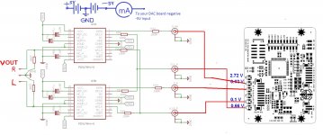

Your measurements are not correct.The results seem to be OK. What do you think?
The output I/U 100 Ohm resistor _must_ be there in order to have voltage output from your DAC.
You should measure mA on the negative rail that goes to your DAC -5V power supply.
See the ugly drawing I attached based on your schematics... its changed for stereo, L and R channels, if that is working you can modify it for balanced later.
See the output 100 Ohm resistors, you should measure ~ mV over there.
The mA meter should measure the negative power supply rail.
