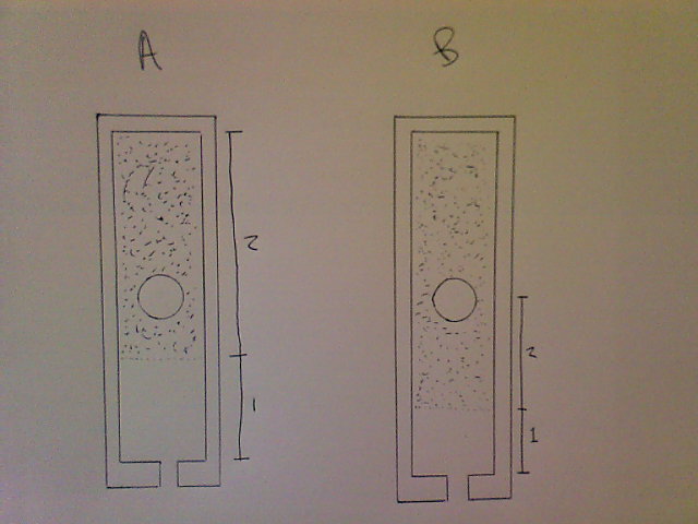

I am just completeing my MT-TL monopoles (finally).
I am going to line them with felt as per thread instructions.
I am not quite sure about the stuffing though. I have two packs of Monacor MDM2 300g/m2, but I am not sure how much to put in the cabinets. Each pack contains two 630mmx330mmx35mm sheets.
Also, I have read that only two thirds (2/3) of the transmission line should be filled. Is this 2/3 of the whole cabinet (A), or the whole of the top half and 2/3 of the bottom (B).
Please see photo for clarification. The photo shows a cross section of the cabinet. My port is built into the base.

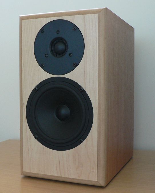

The box I use is the larger design and has a very small kick between 70-80Hz plus has a fuller sound than the 5.2 litre version. Vb=9.5 litres, Fb=66Hz, F3=60hz, 47x76 port.
I use a standard series xo 3.3uF, 0.68mH, 5R6, +ve polarity to tweeter.
The pic is mine and is used nearfield.
