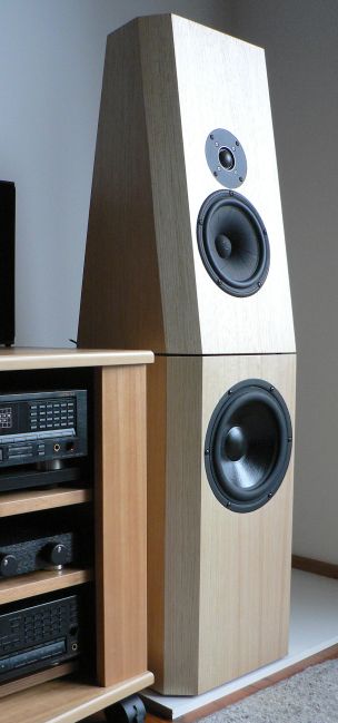

Yes, they don't produce too much bass. Which version are you building, the 5.2 litre or 9.5 litre. The design brief from the thread originator was a speaker that could be a good datum point that you could use as a comparison as you built more speakers. The other intent was a good newbie speaker that would sound good and could be built upon or tweaked. The reference title of the thread can be a bit misleading as it means a reference point.
They are designed for a small to medium sized room and I use mine in my office with great results, however, when I was building my new mains, they took on main duties with a sub each side using the Vifa 8" M22WR.... were not disgraced at all and beautiful sonics.
There are a few options.
Build the TLb using the drivers plus some more or with additional woofers as shown in this thread http://www.audiocircle.com/circles/index.php?topic=36363.0. BTW, he's very happy with the final result and worth a read to see what the TLb is capable of and how he's using them.
Build a 3-way using your existing parts but 3-ways can be a nightmare.
Build a 2.5-way using your existing parts but with a 6.5" or larger 0.5 woofer in it's own section of the box.... this is much easier than the 3-way and would only need the additional woofers and 2 inductors.
Add a subwoofer to each channel or 1 to start off with. I'm not talking about a Peerless XLS type sub driver but a 8"-10" music woofer that would be used in a 3-way such as the Vifa M22WR or Peerless 850146 style of drivers.
The last one is the path and evolution I took with my main speakers and have not regretted it.... no woofer xo problems as plate amps do the bottom and no high pass xo for the mid-woofer as it rolls of naturally at the bottom end due to the OB design. See the pic of the final speaker (Scan Speak not Vifa used).
As you can see, the minute D27/P13 combo can evolve into much bigger and better things. Don't give up on it and I'm sure other will have more suggestions.

Almost forgot another alternative which doesn't cost much and works a treat.... should get the bass into the high 40Hz.
http://www.diyaudio.com/forums/showthread.php?s=&threadid=94808

I think i will do this properly, do you have any further details as to how I might replicate the speakers in your picture?
Cheers, M
I'm not familiar with the 831709 but from the datasheet, should work OK with a plate amp and fill in the bass.... I don't think they are paper weights ...... how cruel.
The design of that speaker in the pic will be going up on my site next month (time permitting). A lot of the information will be able to be used (with some calcs and common sense) on other similar speakers using different drivers. BTW, this one was very expensive to build but I was lucky that I had most of the bits in various other speakers around the place. Had I had to buy it all in at once.... would have
Just keep an eye on this page every now and then as it will eventually pop up.
