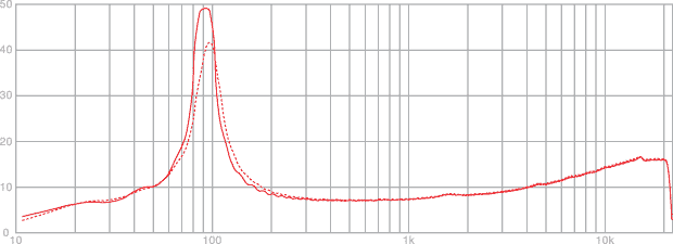

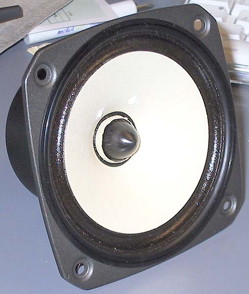

Today someone asked if my FE103/40-1197 phase plugs would fit into the FE127.
So i was oblidged to do a dustcapectomy... after a bit of a struggle getting some errant bits of dust cap out of the gap....
The FE127 has quite long voice coil that extends quite a bit beyond the apex of the cone. The 103/1197 phase plug is the right diameter but i think needs about 9-10mm more "shoulder".
It was interesting to see some ripples in the out-of-the-box impedance curve disappeared with the dust cap removal (some came back with the too short phase plug)...
dave

phase plug suggestion
Cool Work Dave: could you do a couple of other plugs for comparrison? I was thinking about a short cylinder with a large enough diameter to mostly fill the voice coil former and then mount a sphere on the end about the size of glass marble the kind we used to call "boulders" (smaller than a ping pong ball). Also could you go to your local hardware store and get one of those miniture spot lights with the mini base? They look kind of like a flat door knob. Don't know if you ever saw but Beauhorn use a shape like that in one of thier Lowther horns. Would be cool to see what they do to the plots as well as to the precieved quality of the drivers top end. The fe127e could use a bit more sparkle in the top end. Best regards Moray James.
