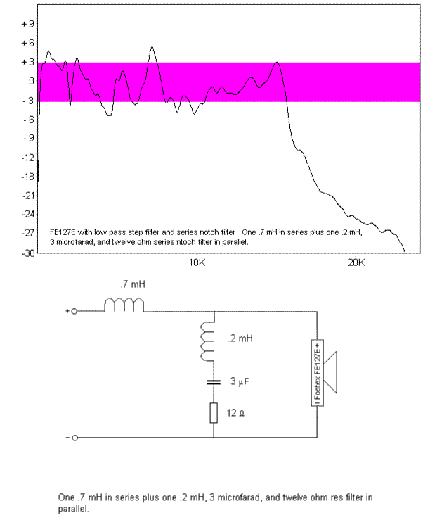

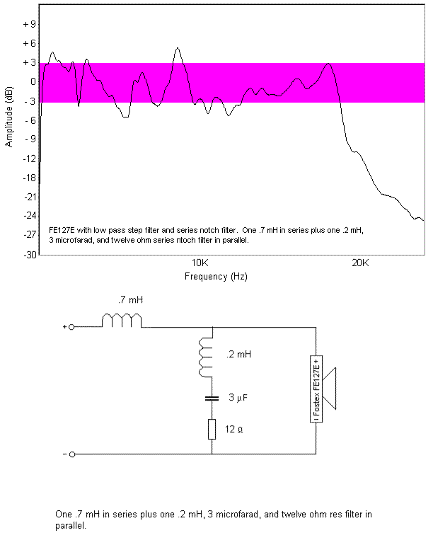

MarkMcK said:For those still pursuing the FE127E project, here is a prefilter. It is different, probably better, but still far less than hi-fi.
Mark

While I tested the drivers right out of the box, the response graphs for the FE127E were done after 24 hours of "conditioning" using a low frequency sine wave just under driver power limit. This is the standard break in conditioning in the literature. You can find a cab tuning experiment using this break in procedure in the Loudspeaker Cookbook, sixth edition. Except for the expected decrease in Fs and increase in Vas, there was no measurable difference in performance.
Also, a prefilter attempts to correct problems with a driver or loudspeaker by a complementary altering the signal fed to the driver. Baffle step correction is an example of a prefilter.
I am also attaching a corrected version of the driver with prefilter response plot to this post. When I plotted the data, I used the incorrect time base. The top end response of the FE127E begins to die just over 16kHz instead of just under 20 kHz as shown in the previous graph. All the other points of reference (the peaks dips in response) are slightly shifted up in frequency. Sorry for the confusion.
