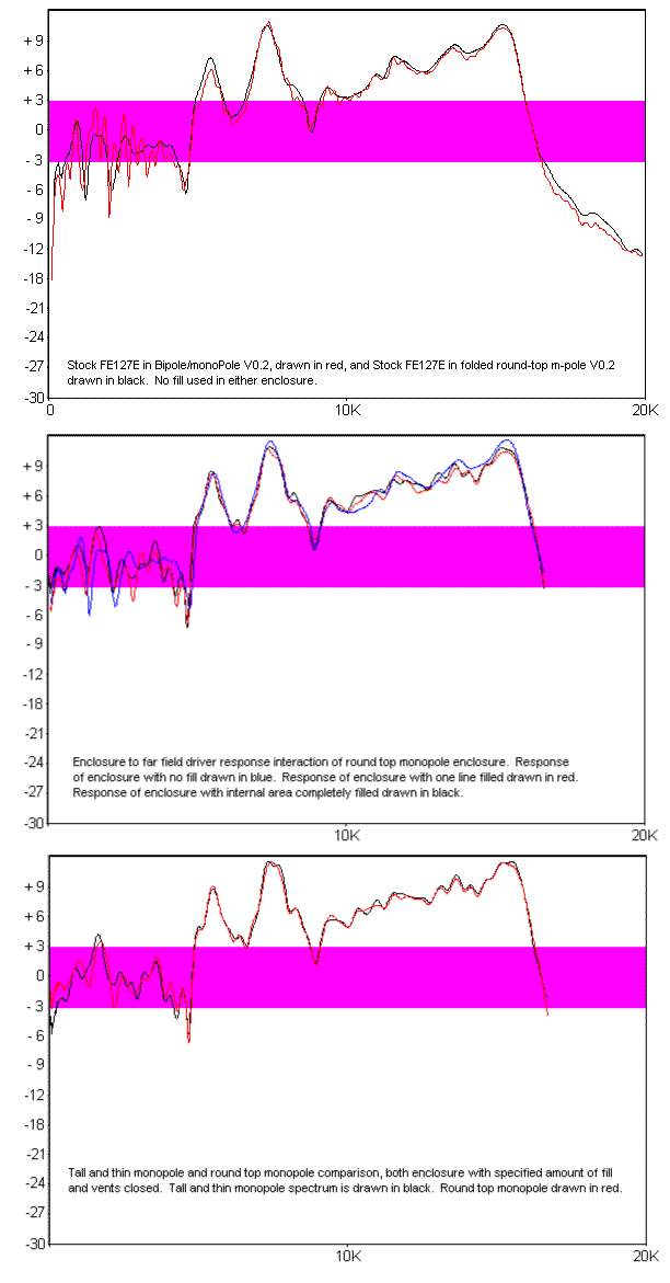

Here is the first of several posts about the test results.
The first set of graphs show the interaction of the enclosure with the driver. That interaction continues up until about 4. 5 kHz. Please do not overreact to the results. All enclosures interact, even open back baffles with wings will interact by backside loading the driver diaphragm.
I suppose one thing to take from these tests is that stuffed or not stuffed, the sound of the loudspeaker will be a combination of the driver and the enclosure. A lot of the interaction goes away with stuffing, but not all.
Good designing and good building,
Mark

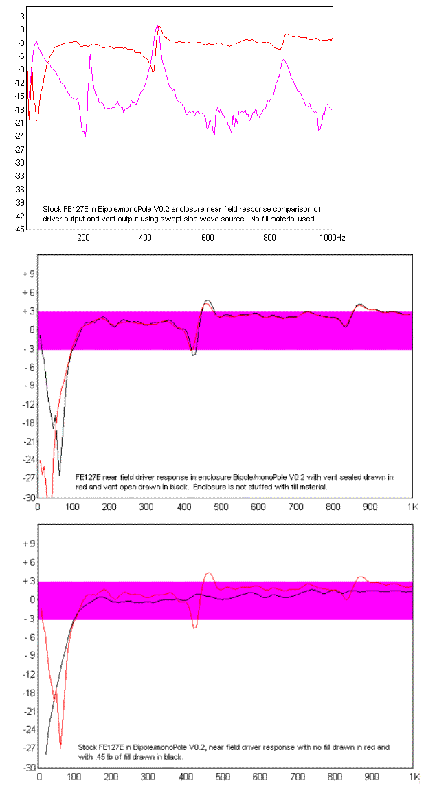

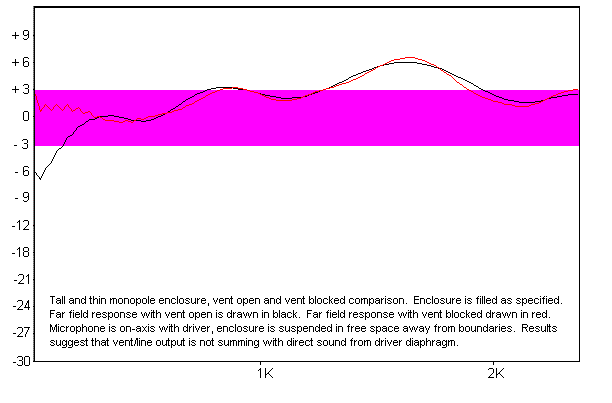

Today's last post shows the far field, free space response of the loudspeaker comparing vent closed with vent open. The results shown here are repeatable, yet the differences shown are at the low frequency resolution limit of my chamber. While I believe the loss of low frequency output is a function of the loudspeaker and not the test set up, I have little confidence that the amount of difference shown is an accurate reflection of the actual acoustic performance. It may be less or it may be more. The magnitude reduction seen with vent open is likely a notch or dip with the response rising again at even lower frequencies. Few testing labs have the far field low frequency resolution to get the desired detail on this phenomena.
Mark
Mark
Without fill, all the enclosures should be showing some ripple... did Tim ever give a specified amount of stuffing (i remember putting ??? in the drawings when i indicated it -- 0.25 to 0.5 lbs/ft^3 is fairly standard)
Unfortunately the linear scale charts make examing the LF results almost impossible and remove any easy way of seeing the periodic pattern any ripples make. Can you repost the results with a log scale?
dave
dave
IIRC, I used .25 lbs per cu. ft. I usually don't go much higher than that.
Dave included a fill spec for the tall and narrow enclosure.
I followed that for the tall and narrow and the round top. Now, while some claim that we hear log, multiples of frequency; quarter wave, half-wave, and so on are linear.
The multiplicity of frequency is much easier to see lin than log.
The enclosure interference is not particularly worse than it is for many other enclosure and driver combinations (and I suggested you not overreact to the ripple seen in the 20 kHz bandwidth testing). Most of it, however, is internal and not baffle step or baffle edge.

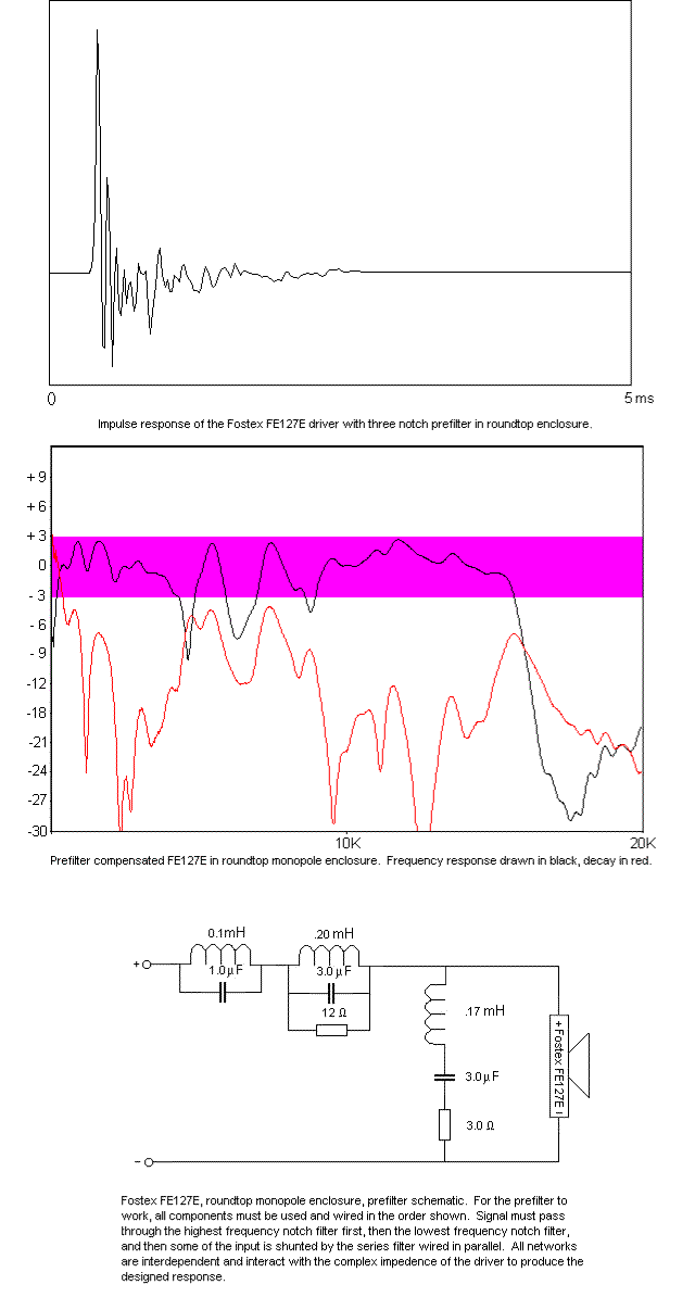

You can see that in this last post. This last set of graphs shows the response with the last prefilter design. This design is much more complicated than it looks since it takes advantage of filter interaction and prefilter to driver interaction to do more than the mere sum of its components. This is the best I can do. The better route is a new cone design, but that is best left to Fostex. Ask them for it and maybe they will provide.
I have a tendency to discount anything that does not come up to a fairly high standard of performance. I have to remind myself that this is a driver that costs less than $40 USD. No reason anyone should expect perfection for less than $40.
I am not going to break this driver in anymore. I have already put 26 hours at extremely high drive levels. If you compare the stress of my conditioning period to listening to classical music, it would come out to playing music at maximum driver levels at 10 hours for every one hour of conditioning. I will await those that believe in 200-hour break in periods to show us how the driver changes over that time.
Anyway, with this amount of break in, in the round top enclosure and divided body, I found the best bass sound was achieved stuffing one half of the body with the specified amount of fill and using 1/4 specified amount to loosely filling the half with the port.
Fully filled or filled as described above, the loudspeaker produces more of a suggestion of bass than actual bass. Whether fully filled or filled as described above, the speaker has a slight tubby sound. Often described as the oatmeal tube sound. I have heard worse, but it is audible. The upper mid bass and lower midrange is slightly dense, not open or airy. On complex music, it becomes a wall of sound noticeably lacking in detail and clarity. The upper midrange and treble has a dry edgy sound. I dread using this descriptor since it does use a paper cone, but it is a dry papery sound. This is especially noticeable on sibilance and second and third vocal overtones. High treble remains a little smeared or splashy.
With this prefilter, the response is tamed enough that you can actually hear the sound of the speaker. Since the component sizes are small, the cost of the prefilter is small. Whether you like the sound of it I will leave up to the listener. If you don't there is less lost on the cost of the prefilters than on the Madisound cost of the drivers.
All in all, it is an okay design. Well done people.
Mark

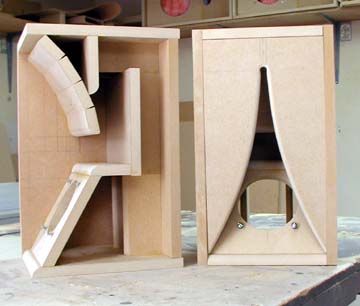

hybrid Karlson/Transmission Line cabinet
just a photo of a cabinet design (one of a series) which shows the general idea of a cabinet in which currently resides a fostex fe126e (has also run with fe127e). I am currently also running a fe166e in a larger version. Excellent results. The chief benefit of this design is that it effectively loads both the front side and the back side of the driver which yields excellent control of driver motion while permitting a good air impedance match between the driver and the air in the room. Size is compact bass response is superiour to a ML TL and dispersion is superb. Hope that this generates some thought. Best regards Moray James.
Re: hybrid Karlson/Transmission Line cabinet
Very interesting design Moray. Have you done any FR measurements for it? Interested in both how the TL improves the response at the bottom, and the effect of the Karlson coupler in the midbass and up.moray james said:just a photo of a cabinet design (one of a series) which shows the general idea of a cabinet in which currently resides a fostex fe126e (has also run with fe127e). I am currently also running a fe166e in a larger version. Excellent results. The chief benefit of this design is that it effectively loads both the front side and the back side of the driver which yields excellent control of driver motion while permitting a good air impedance match between the driver and the air in the room. Size is compact bass response is superiour to a ML TL and dispersion is superb. Hope that this generates some thought. Best regards Moray James.
Hi Dave/Brett: fine sunny day here on the Bow. As I said I do not have any measurement gear right now so only my opinions. I did build a ML TL (0ne for the fe177e and fe127e)for these drivers when I started this to have as a reference. The K-Lines have bass that is just as deep but with far more impact than the ML TL's. The sound stage and image is as good as I have ever had perhaps better. They can cast up the kind of stage which seems to superimpose the recording venue over top of your listening room which can be strange with a good recording as you find yourself feeling as if you are not listening in your own room. Well worth playing around with. Regards Moray James.
