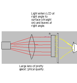

About image quality....
I have been reading an avsforums user's critique of our project, and according to him, one of the projects biggest hinderances is that light is passed through the LCD at different angles (ie. the outer part of the LCD light path angles in, where as the inner is dead on) and of course LCD's are very sensitive to viewing angles. Not sure how true all of this is, but it did serve to confuse me, when I thought I had this already figured out. I attached a little .bmp file of what I think should be going on in an ideal projector.
Basiclly I don't think the fensel lens be in the way of the lights path AFTER it has stuck the LCD. Somehow I think the fensel will have a poor image quality. Let me know what you think. I guess I'm confused on how OHP work, if it doesn't serve light straight up to and focus light straight from the LCD panel, I got a feeling with a 15in or 17in I will be heading for trouble.
But if LCD's have advanced far enough that there veiwing angle is wide enough, I guess its a mute point...

I have a uneasy ( and uninformed..) feeling that in our 'large' lcd displays, there is a significant amount of gap(to us) between the pixels that don't exist on on smaller (used by projectors) lcds of equal resolutions. Don't have any facts on this, so don't flame, just fishing to see if anyone know anything about this ( last poster called this pixel spacing)
Btw, any other place besides edmund optics ($$$ ~$80???) that sells decent quality fensels of large size ( to fit a 15 in LCD panel ~12 by 10) that are heat resistent??
Also on a side note I just bought bought an adjustable focas crt projector lens (atlas), not sure if its usefull for the project or not, just thought that it might be. Anyone one else have it, using it already??
And I am kinda hoing that someone will kindly explain to me how the fensels work in our lcd projector systems... and what a optimal system would look like ....
Seems that a few of you have at least SOMETHING going on, could you please post pics please (of the picture)? In particular I was wondering about what others are also asking about, the screen door effect. How bad is it? Not knowing too much about it, I would imagine that this would be countered by line doubling (I never understood this, for a dvd this would mean 720X480 = 1480 X 960, what lcd is capable of 1480 lines???)
