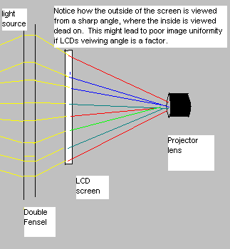

So I gather from Scot_lad's reply that in OHP projectors the light does not enter in though a straight line through the LCD panal ( as I suspected). So from what we know of LCD panals, viewing angle problem could lead to a problem where the image is very good dead center, but more dim and washed out at edges. At this point in game, many of us looking at least ~$450 costs for this project, is this qualtily acceptable? (please look at the reviews for panasonics new $1.5K projector, it looks very good for a low cost projector, and has low per hr costs).
I really wish there was more discussion about image quality, and what is reasonable and what is not. For those that already have theres running, please post pics so we know if the OHP + LCD panal combo needs to be improved on quality wise.
Secondly, if we are going to insist on using a large lense to converge the lcd panels parallels light (assuming non parrallel is unacceptable), is glass (could plastic suffice?) lense unreasonable at that size (15" across). And is a there a supplier for these large low cost lenses?
Attached is a little bitmap I made of the OHP + LCD with mspaint (as oppose to the more IDEAL situation I drew last time)
