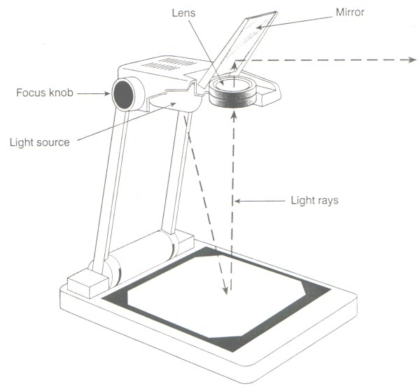

Axeman, well, they DO make OHPs where the light is on top (up with the lens assy) it shines down on a fresnel with a mirror behind it, then bounces back up through the lens to project an image of whatever "foil" you have placed on the stage.
Here's a like to show what this type looks like - http://www.dynadirect.com/bc-apovs3000.html (3000 lumens)
Putting the light up top solves a lot of cooling and noise problems, provided the bulb can operate being only convection cooled.
So its is logical that if you can sandwich a fresnel and a mirror just behind the LCD, that arrangement might - just might - be similar enough to a "foil" on top of the stage of the projector in the above link! The large aperature from the 15" LCD panel display might (again, just might) allow you to use a 3000 lumen unit with a satisfactory screen brightness.

Portable ohp:s (light at top, mirror or such reflecting the light back to the lens) don't work with LCDs. Although I have got no experience on this, I've read about it.

They dont work with an ordinary projection panel, because the panel puts some space between the bottom protective glass and the LCD - usually for air cooling. On top of that, the panel has feet which further lift the LCD up above and away from the reflective surface.
Axeman was thinking of putting the reflective part right up against (in physical contact with) the LCD element itself, which may or may not make all the difference.
Also on my panel there is a top glass, with another space between. Certainly all these glass panels and spaces are going to ruin the original operating principle; hence why the ordinary situation doesnt work!

1. Because of the little distance between LCD-panel and fresnel-mirror you will have a setoff for all reflected beams that don't pass exactly the middle of th panel.Make a drawing and consider the lightpath also for the beams at the corners of the panel.
Remember:angle of incidence = angle of output.
2. Consider the loss of brightness through the panel. If the panel let 10% of light transmit the way down it does the same when the light comes up again.
3. There would be a heat trap problem between mirror and panel.
My opinion: forget it!

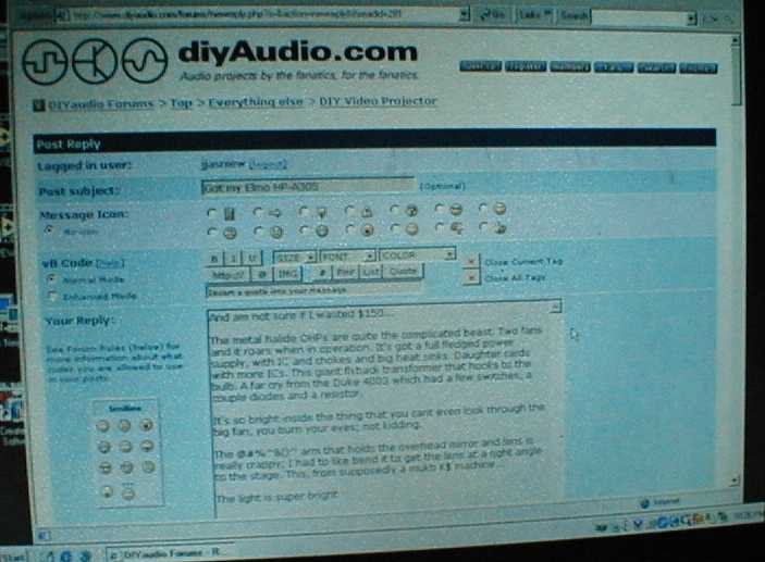

Got my Elmo HP-A305 8K Lumens
And am not sure if I wasted $150...
The metal halide OHPs are quite the complicated beast. Two fans and it roars when in operation. It's got a full fledged power supply, with ICs and chokes and big heat sinks. Daughter cards with more ICs. This giant flyback transformer that hooks to the bulb. A far cry from the Duke 4003 which had a few switches, a couple diodes and a resistor.
It's so bright inside the thing that you cant even look through the big fan, you burn your eyes; not kidding.
The @#%^&()^ arm that holds the overhead mirror and lens is really crappy; I had to like bend it to get the lens at a right angle to the stage. This, from supposedly a multi K$ machine...The Duke, in contrast, has an adjustment to set this.
The light is super bright in high intensity mode, but not perfectly uniform. We'll see if that gets better after a good cleaning.
Aside from this, I did have a bit of luck. The place I bought it from just happened to have a broken Nview Z350. I had em send it along for an extra $40. Only 2/3 of the screen had active pixels when I turned it on. So, I opened it up, poked and prodded and was lucky to see some changes in the LCD when I pushed on this circuit card off to one edge.
I was even luckier when I removed the LCD, took the EMI shield off and noticed that a couple of flex-print conductors that looked like it was connected to a driver chip had desoldered from this PCB. (I could just see the flex print move when touched. The driver chips must get really hot) So I reflow soldered each connection back down, cleaning up my solder bridges with the chem-wick, retouching 15 or so connections. So, soldering these kinds of tiny connections can be done. It's just somehow easier to do on a $40 panel than a $300 panel, you're not quite so nervous.
Even luckier was I when I put this back into the panel, hooked it all up, powered on and the entire LCD now shows an image! I reversed the panel fan, so it blows in the same direction as my other unit. I think this was a problem on these panels, because the fan on my other one blows out through the air filter element, which the manual says to keep clean, so dust doesnt get on the inside panel glass. That's not logical, so they mustve reversed it because the panels were all burning up and maybe that fixed it.
The thickness of this LCD element was appx 1/8". I'd think the newer ones would be even thinner, but, who knows?
Anyway, I'm writing this on a 50" screen, using my new Elmo projector and the repaired Z350.

Nice pic!
Hey.
jjasniew -
Nice screenshot!! So did you just get a spare panel the same as your existing one? The color looks a little off, but the contrast looks pretty good! I _highly_ recommend a capture card+dscaler to send TV/composite/s-video to your projector. I've been experimenting with it for a few days and it can make TV look better than I ever thought it could. ONly problem is I can't get stereo sound from my TV tuner.
