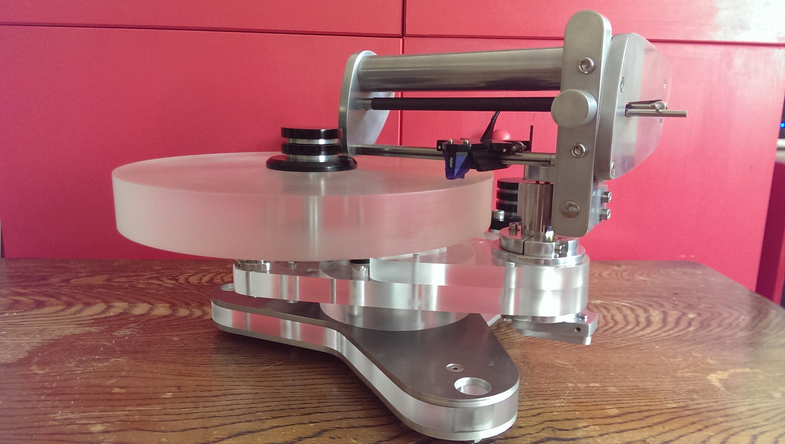

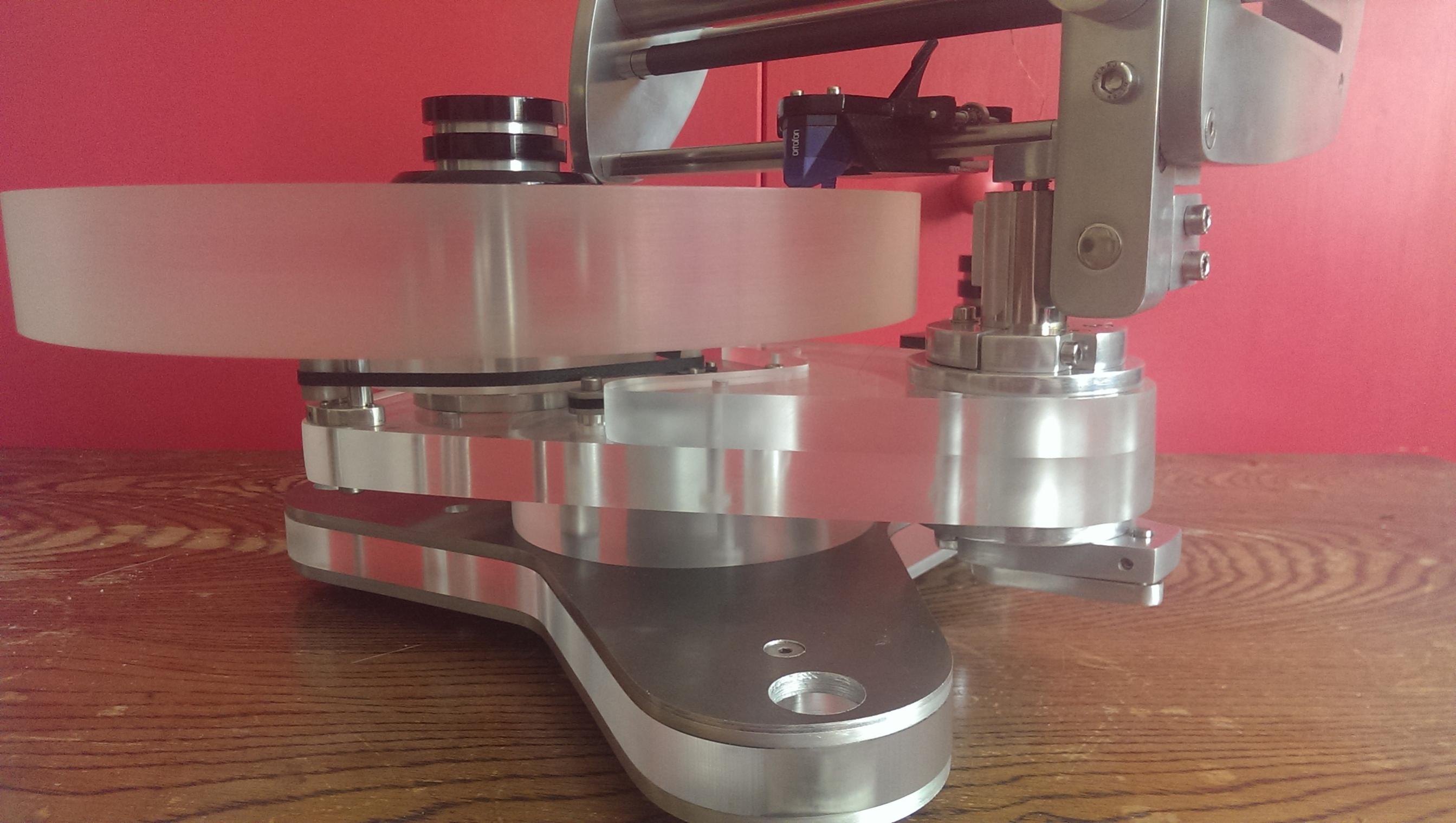

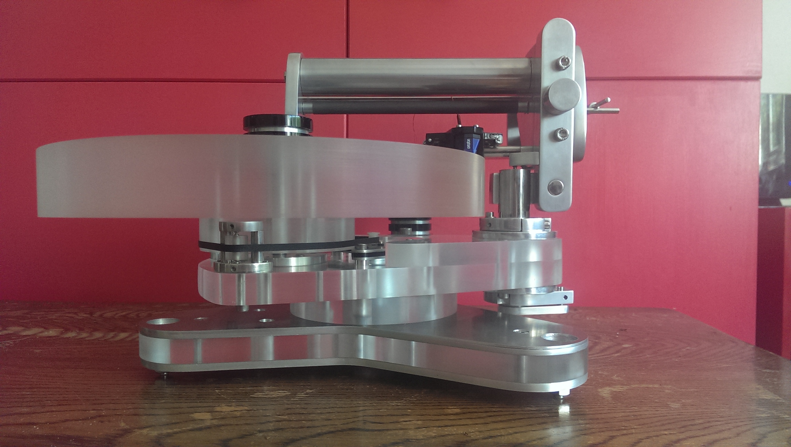

Still Building
Hi All.
I seem to have resolved my skipping problem, fingers crossed. I washed out my bearings but also noticed that I had a small bit of gak stuck to my stylus. I had been suffering a slightly recessed midrange which I had atributed to excess bearing friction but was probably the dirty stylus. All is singing sweetly now.
What with the tracking problem and a percistant head cold I haven't had time to cosmetically finish the sub-chassis as hoped. As I had the deck out of its cabinet for bearing cleaning I took some pictures of it as it is.
The photos don't really do it justice. At the moment the deck is being used as medium mass solid plinth deck. The suspension and main plinth are to follow, hopefully soon. One unforseen bonus to the look of the deck is wife approval. My wife is not a fan of the appearance of most hi-fi so I've had to compromise on a lot of my projects. Luckly she loves the look of this deck and has INSISTED that I get it out of the cabinet and build a dedicated stand for it. Yipee. I wonder if I can bring her round to the idea of some electrostatics. Wishfull thinking.

Beautiful work!
Niffy,
As always, awesome work!, that is a beautiful piece!
Super,
I didn't realize that was a suspended plinth, that explains the micro detail issues. The more rigid between the platter bearing and arm I had made this design the better the detail became, the nature of the design makes it even more rigid than the Clearaudio and Cantus so it benefits from being locked well to the turntable.

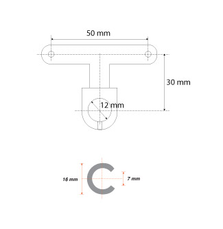

I am about to try a two tube version using twin 6mm tubes. My bearings IIRC are 10x5x5mm. I am wondering the distance between the bearing and the T brace... how long should the axles for the roller bearings be? I've some plastic pieces that snug fit into the inside of the bearing and just need to cut to length and fit to my T. Thanks.
Hi Mortron,
I am working on my 2nd version of arm now. Please see attached image for the dimensions. I use a 7 mm spacer for the bearings.
I think I find a way to make same kind of glass track as Clear Audio’s now. See the image. And, I will try it out in two weeks. If it works, I think it is definitely better than twin glass tubings.
Hi Mortron,
Hi super.
The 50mm spacing between bearings should definitely help lateral tracking. I think the drop of 30mm might be a bit excessive. The arm tube only needs to just clear the bottom of the track tube. Your current design will put the pivot about 40mm above the record surface. Combined with your sub-50mm arm length warp wow may prove an issue even though you have excellent record clamping. Although having the COM below the pivot is good for stability having it too low can have 2 negative effects. Eccess tracking force variations on warps, though in your case probably not a major problem. As everything is further from the pivot vertical effective mass will be dramatically increased. You could easily have a vertical effective mass of 30grams.
I think the two rail version (thanks PDR) is probably superior to running inside of a tube as movement other than lateral is prohibited. It would be much easier to twist the carriage laterally as the bearings can slide up the inside of the tube different amounts. As the load inevitably has a torsional element this is likely to occur. With the 2 rod design it cannot.
Hope this helps.
Niffy
