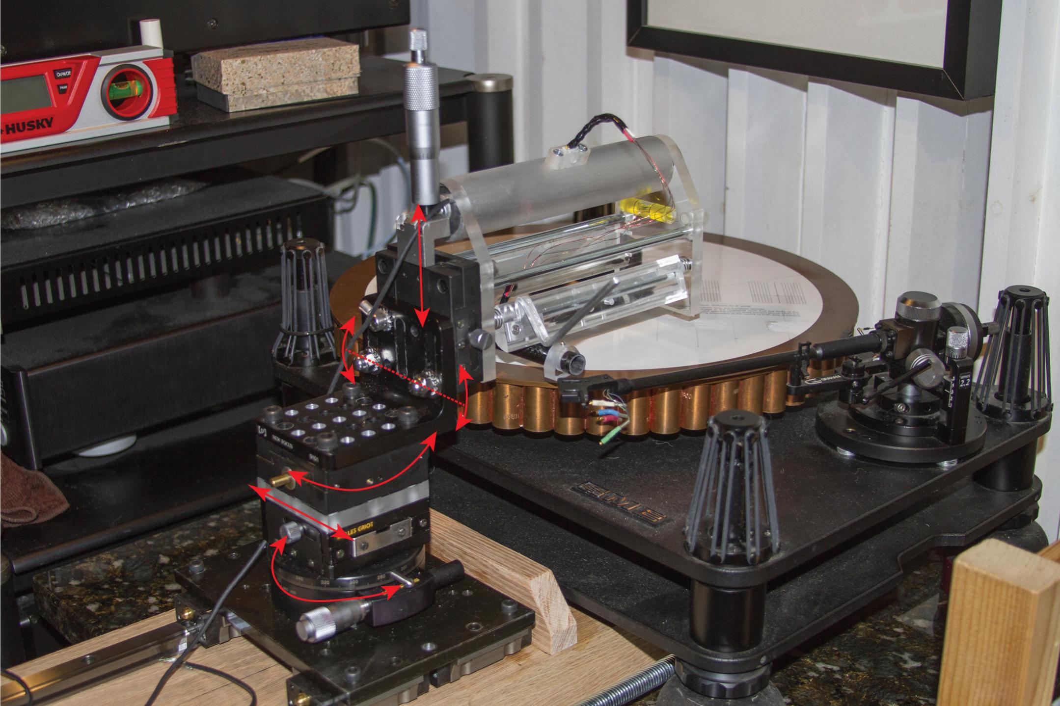

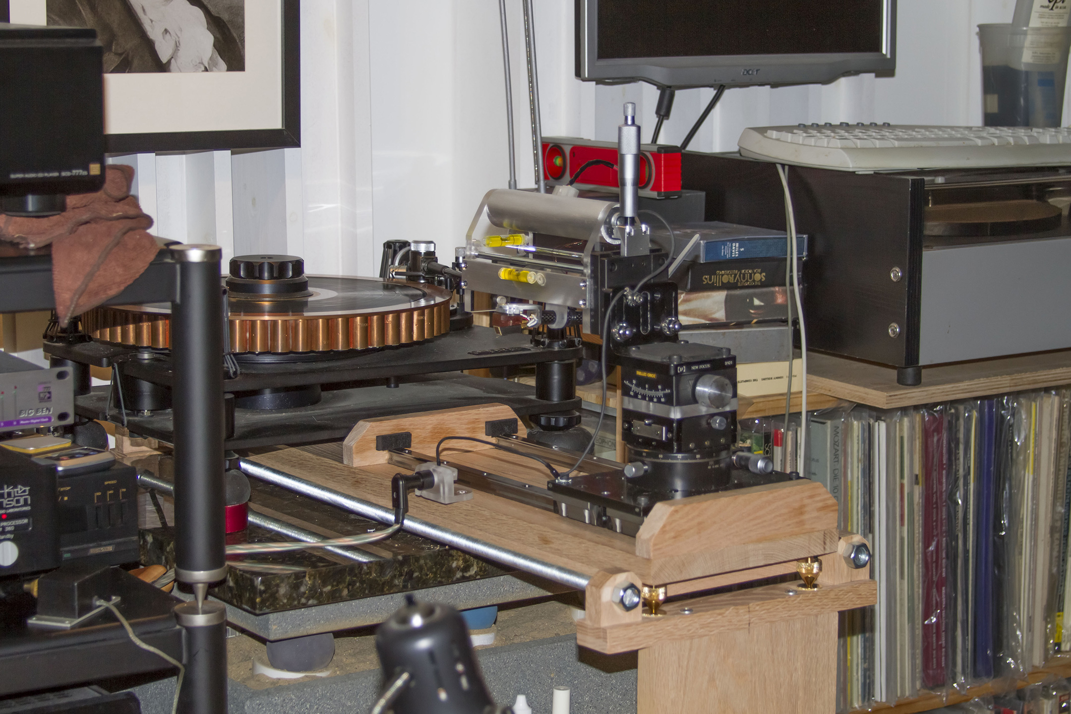

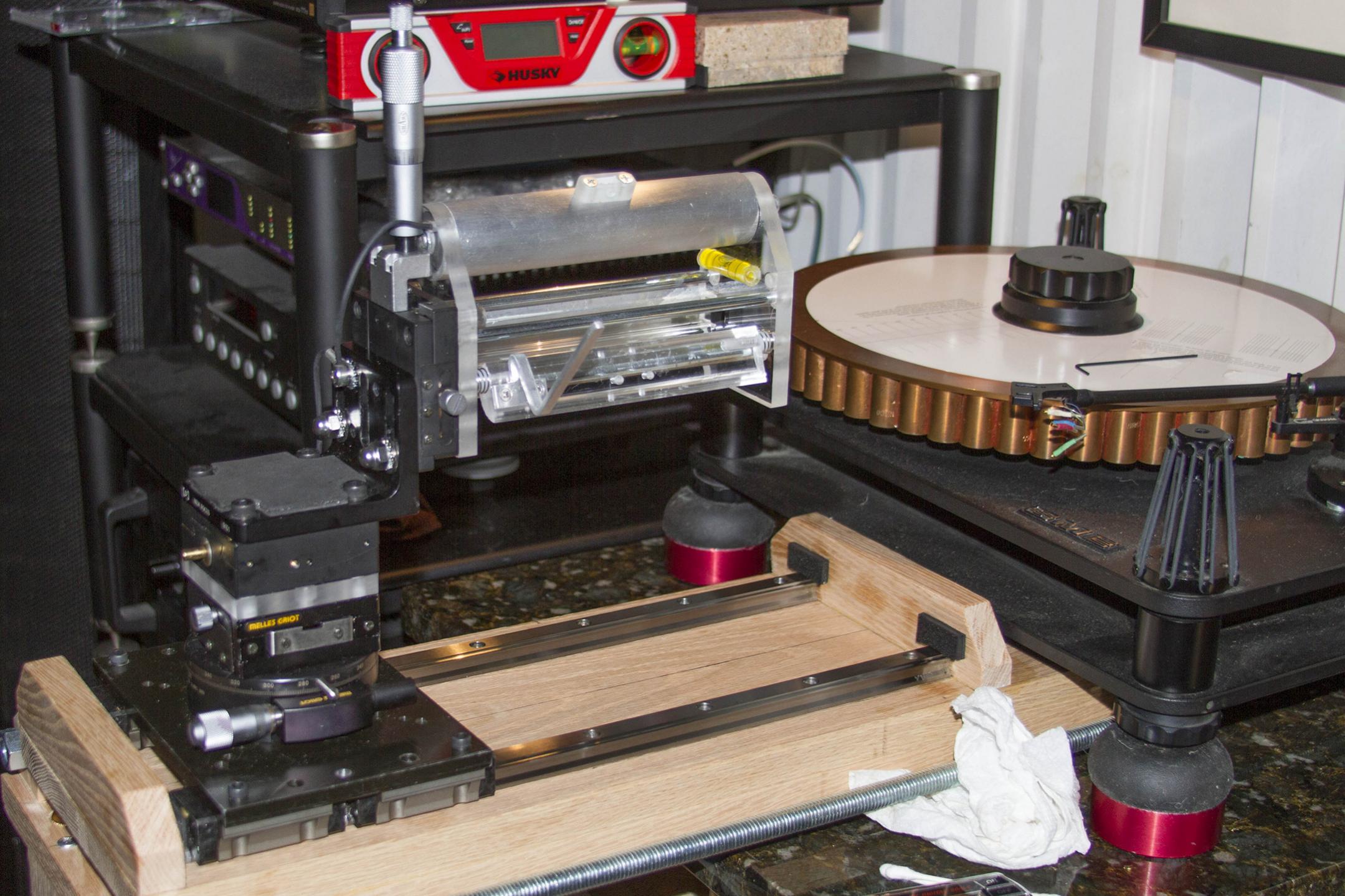

All the stages are bought off ebay. I use two micrometers. One is for height, VTA and one is for rotation.
The arm base doesn't swivel but slides. Please see attached photo. I use two linear slide rails. These rails are used in automation. It can do exact repeat action. I bought two from a surplus web site for $149.00.
I changed my mind. It is a two glass tubings and two bearings linear arm now. However, it is very easy to change the bearings and glass tracks now. I may try different designs later on. I really want to try two ceramic balls and four glass tubings as in other linear arm thread.
The deck is SME 20. I made an outer ring.
Hi AuroraB,
These stages are about $150 each on ebay. I got some cheap ones. The total cost for four stages, two linear, one rotary and one goniometer plus a angle and a base plate is $355.00. I don't have access to a machine shop except a band saw and a drill press so I think it is worth to pay more for stages.

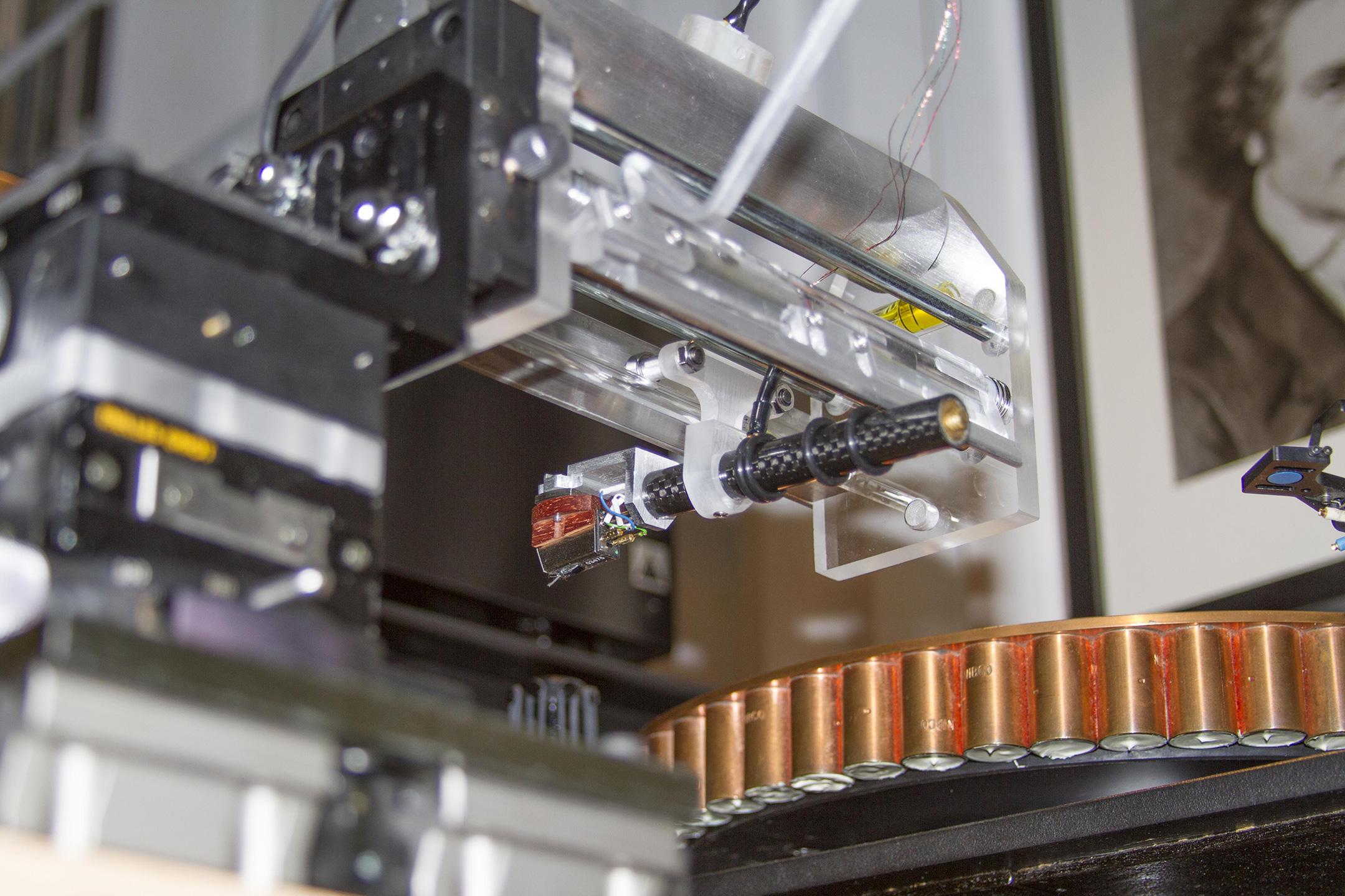

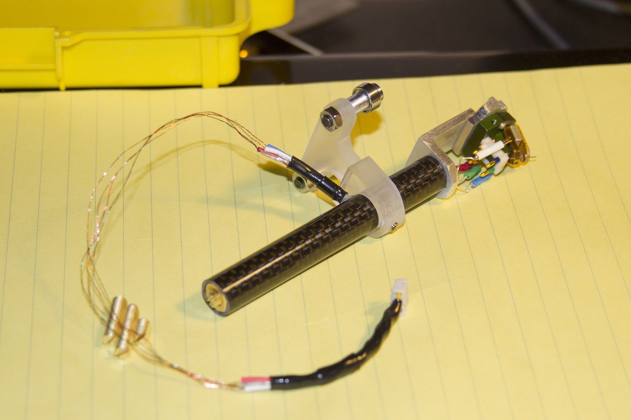

I designed my own head shell so I can adjust zenith if I want to. In the meantimes, I don't need to install cartridge on the arm. The counter weight is hiding inside the carbon fiber wand. I also made some extra weights for different cartridges. Please see photo. The wires from arm wand are made from my old Sennheiser HD600 cable. The plug attached to arm is micro mini JST 4 pin connector for computer.

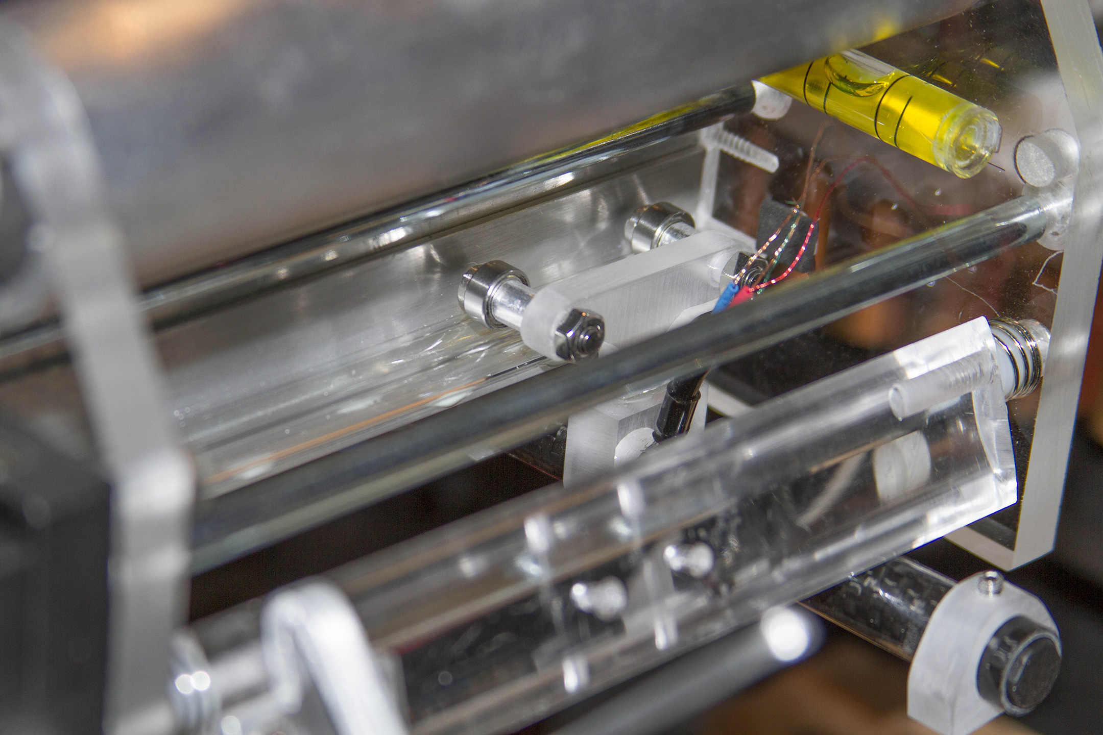

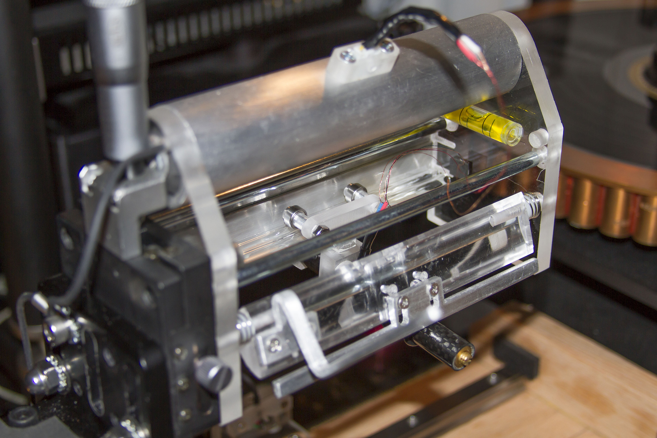

Finally, I complete the line arm. It took me three months to plan and to get all the parts together.
I was amazed by the sound from this arm. Here are some of my experience and thoughts.
This arm works well with low and medium compliance cartridges. I tried Zyx airy 2, $3000. It totally killed the cartridge. The cartridge I am using now is Clear Audio Aurum Beta S, a $400 mm high output cartridge. It seems to me the arm works well with low priced and low or medium compliance cartridges. The arm with Aurum beats my Graham 2.2 and Zyx Airy 2 combo in term of dynamics and bass but somewhat lacks in micro dynamic and detail area. I think it is because Aurum is an mm cartridge. The diy arm also has excellent image.
For everyone who may be interested in building this arm, you need to find your own best balance of the combination for the arm. I mean wand, head shell by the word, arm here. The right balance means the all the factors; weight distribution, size and material should be in the state of right combination. I have the feeling that the arm moving mass should be little heavier than 30 grams in order to maintain good track ability. I use a cartridge weight for my VPI arm. The arm mass now is 44 grams, including cartridge. I may try not to use cartridge weight later on to reduce the arm moving mass. My arm did skip from time to time at beginning. It works fine now after I spent considerable time to adjust weight distribution.
The higher moving mass arm requires a low compliance cartridge. I checked online. Denon D-103R may be a good match for the arm since it has low compliance, 5x10-6 cm/dyne and is a low output mc cartridge.
I set VTF about 2.0 gram. However, I am not completely sure about VTF because VTF is not stable. I kind weighted VTF many times and averaged it out. VTF also changes while the arm is moving.
I used a wood stick to lightly tapped the arm wand and everywhere else including the arm base. I could hear sound only while I was tapping the arm wand. So I added four o rings on the arm wand. It helped but it didn’t completely eliminate the ringing. It may work to use insulating foam sealant to fill inside of the arm wand. But I am not sure. It is just an idea.
Here are more photos and a youtube video.

super10018:
You could try 2 fairly simple things.
1. increase the distance between the bearing as this may cut down possible twisting torsion at the cartridge.
2. make your counter weight with most of its mass close to the level of the cantilever
Your arm seems very stable in the video's. These are just some suggestions that may help. It is disappointing to hear an expensive moving coil bit the dust, since they generally sound much better overall then moving magnet cartridges. I hope you find a solution so you can get the full potential out of your arm. Again, excellent work and good luck !!!!
Thanks for your suggestions, hottattoo!
I don't mind personally if the arm can only work well with certain cartridges. I already placed an order for Denon DL-103R. If it works, I will be happy to just use DL-103R.
One thing I find is background noise is louder than my Graham and Zyx combo. It seems to me the cartridge on the diy arm picks very dust on the surface of record and amplifies it through speakers. I have no idea why.
Anyway, I am back to the drawing board and going to design 2nd arm wand. The 1st one is a success but I would like to improve the track ability.
Jim
I wonder why? The record in Post 1807, is disgustingly filthy.
It is partly my fault. I should clean the record before I played it. Anyway, the background noise of diy arm is still louder than Graham and Zyx combo's.
One thing I have to point it out. The phase of two channels is much better than Graham and Zyx combo's by listening to the 1st and 2nd tracks of Hifi News Test LP. Musical instruments' locations are very well defined.

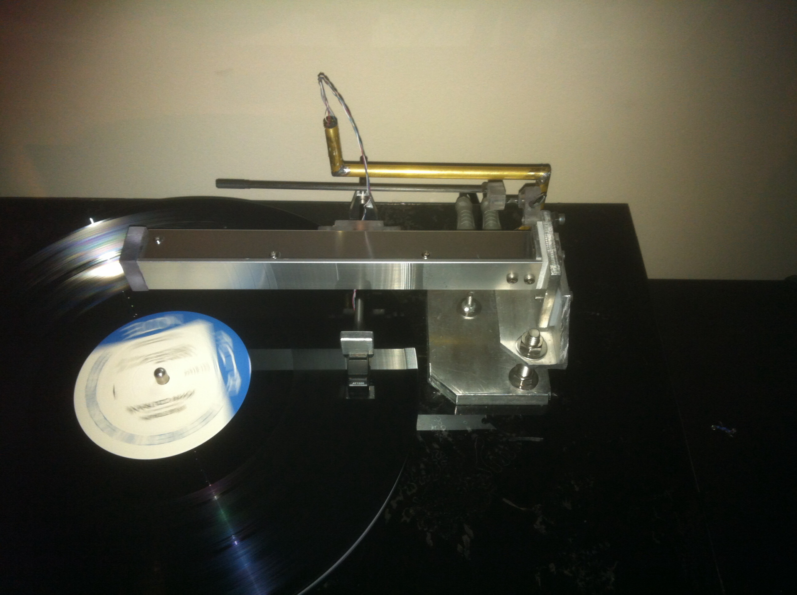

Dimensions are critical most definately. I have set it up with a 40 mm bearing spacing and length of approx 2 5/8" from pivot to stylus tip, this seems to work well. Because of the length and weight arrangement I get no more than 1/10 tg of a gram variance when checking tracking weight. The part that makes this design work well is because of the pendulum effect vtf increases slightly on a warp which helps tracking rather than the teeter totter effect of adding a pivot to the wand.
Colin
