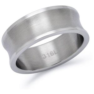

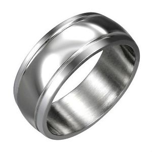

For linear arm tracking, you may use either convex bearing inside glass tube( Clear Audio) or concave bearing outside glass tube( my plan). But it is hard to find these special bearings. You have to make your own.
Here is an idea.
You may buy convex or concave stainless steel rings. They are cheap and come in different sizes. Then, you can put the ring on regular miniature bearing. You get your special bearings!
Jim

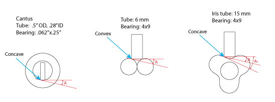

I am not surprised if two 6 mm tubes and wider width bearing is better. I did some analysis.
On Cantus arm, the angle between bearing and inner tube is A. If using two 6 mm tubes and 4x9 bearing, its angle is very close to Cantus'. If using 15 mm iris tube, the angle will be A1, which is larger than A.
But on Cantus, since the bearing travels inner tube. It travels on a concave channel. See blue arrow line. The bearing travels on a convex kind of channel if using two round tubes. The bearing travels on a concave channel same as Cantus's if using iris tube.
In theory, I am not sure which one is better. Two round tubes or one iris tube?
Maybe, use 5x9 bearing and 15 mm iris tube?

Hi Jim.
Sorry, I didn't release the iris was a shaped tube, thought it was a brand, I should have checked the link first.
Regardless, two tubes/rods will allow the pivot point to be kept closer to the record surface thus minimizing warp wow. Which ever tube type you choose try to keep the contact angle at about 20degrees.
