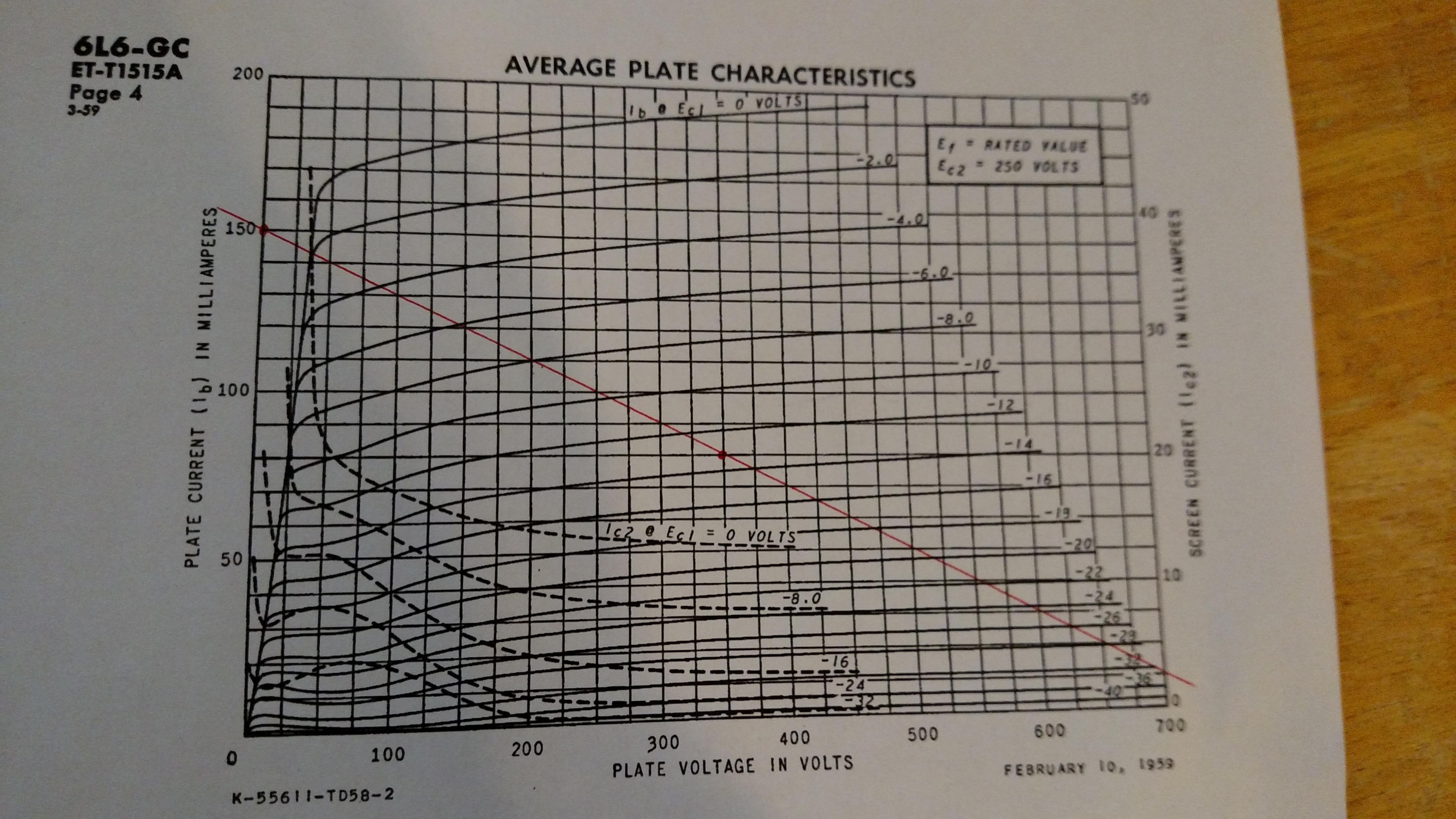

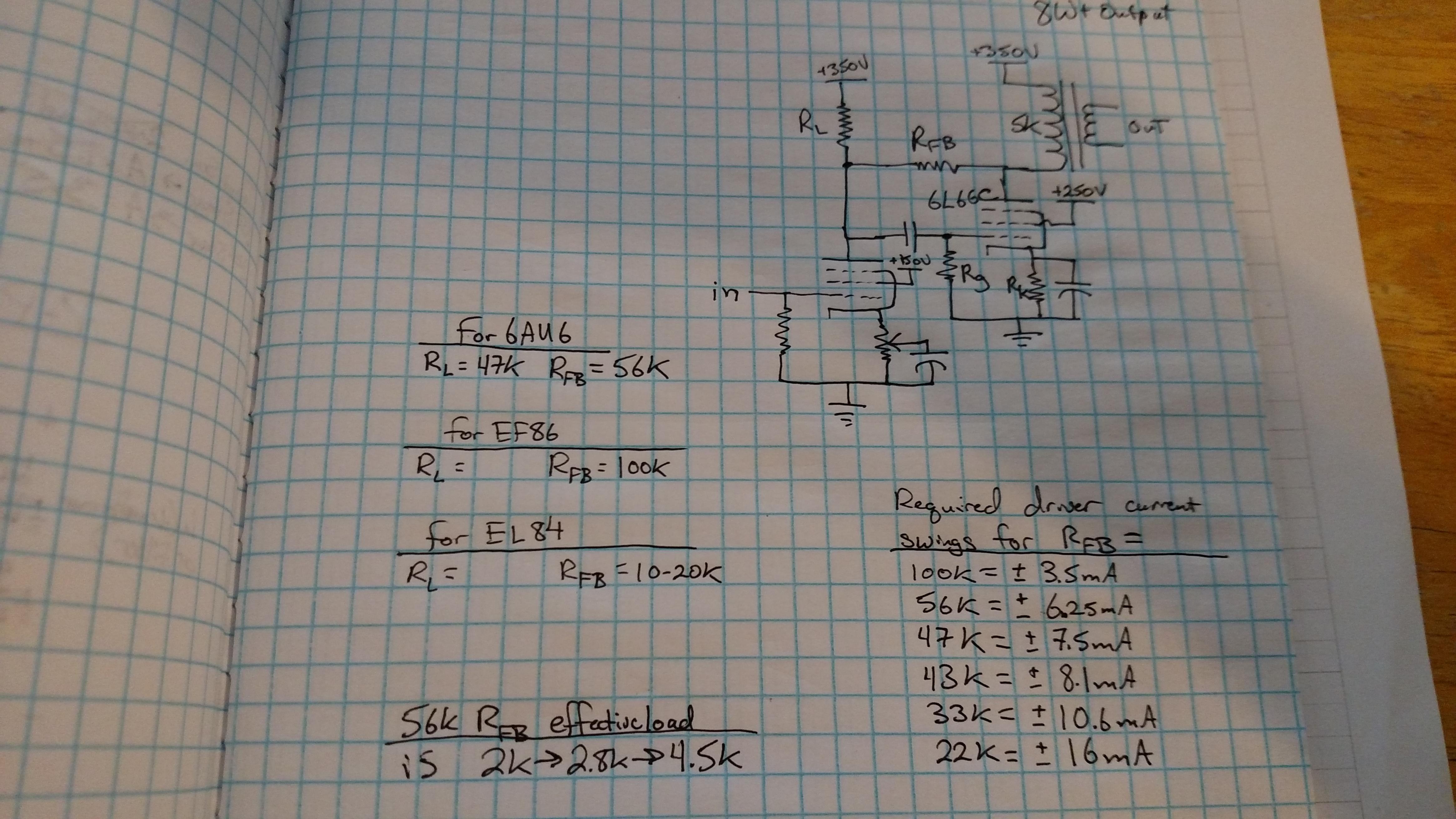

Here's what I worked up. I chose 6L6GC as output tube run as pentode since you said you wanted something approaching 10W output. This will do about 8W
Since you said you wanted good low impedance drive to the transformer primary, I figured you would want to maximize the feedback. The amount of feedback possible will depend on the current swing that the input tube is capable of. I chose a medium-size pentode for the input tube (6AU6) for the initial cut. The input tube could be made smaller to use the tubes you already have or you could purchase something in the same class as 6AU6. Of course, you could also go crazy with feedback and use an EL84, but you would probably have to add another gain stage to the amp to get better input sensitivity.
I thought it might be fun to have variable degeneration in the input stage and put a pot to do that in the cathode resistor of the input stage. If I were building this, I would like to see what effect this had in a breadboard version and would probably use fixed components in the end product.
If direct-coupling is desired, this output stage could be reconfigured like BinaryMike's design, although I don't think that direct-coupling offers any tangible benefits here and will just produce extra heat, especially if you use a 6L6GC.

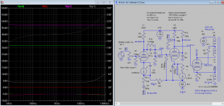

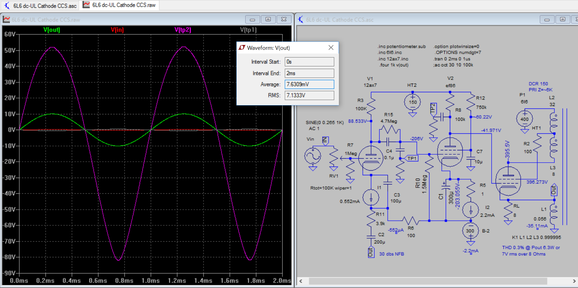

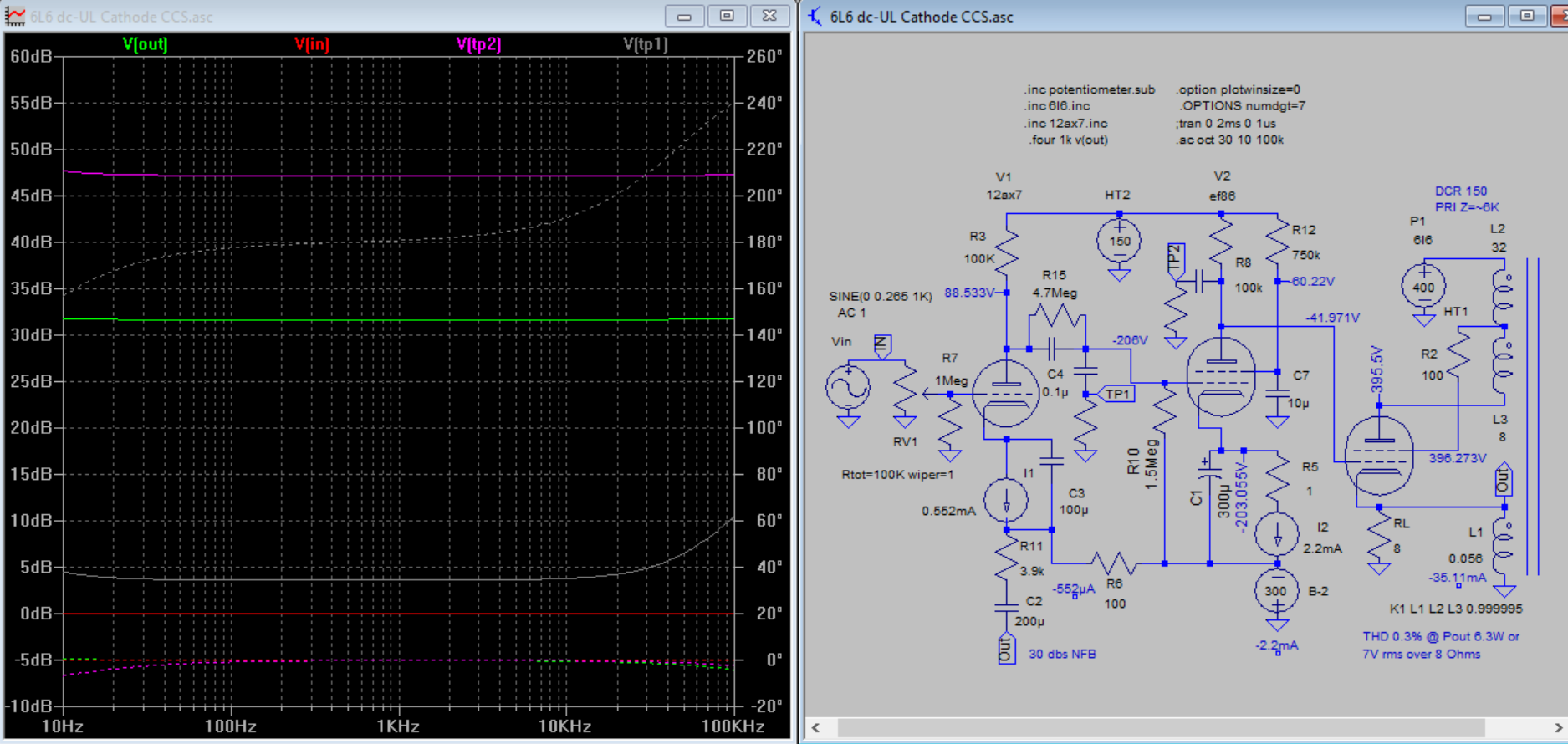

Hi there, I sim this schematic with output stage consists of both UL and Cathode feedback through speaker winding, it appears that the drive requirement is much reduced, like you said, lot of feedback to go in for low distortion 6.3W rms from 400V HT. Attached link has cathode feedback in the output. See also this thread.
Hi there, I sim this schematic with output stage consists of both UL and Cathode feedback through speaker winding...
What does the sims have to do with SpreadSpectrum's design?
Thank you so much for taking the effort in design this schematic. Could you be so kind to provide a version of the schematic that use a i.e. 6sl7? How lower the output wattage will be using this type of tube? Secondly what is "variable degeneration"? Thank you again

6SL7 will make a very poor input tube for this type of design. If you want to use one of the tubes you have, use the 6SJ7. This will make it impossible to use as much feedback as I had shown, so the Zout of the amplifier will be higher and damping factor will be lower as a result of using the 6SJ7. It will probably be still pretty good.
If you want to use the 6SJ7, you might as well just use BinaryMike's design. It seems pretty sound to me. It could be tweaked to use a 6L6GC as output tube or you could stick with the 6V6. I know you said you wanted something close to 10W. How would you feel with 4W or so? The 6L6GC can get you above 8W.
And to answer your other question, degeneration is what happens when you have a cathode resistor that is not bypassed. It is a type of negative feedback that raises output impedance of the stage and linearizes it.
Variable degeneration is what happens if you were to use a pot as a cathode resistor and connect the wiper to the bypass cap. You can adjust the amount of degenerative feedback.
I thought this would be a good idea since it might be possible that there could be some distortion cancellation between the output tube and the input tube at some optimal point. If I were building this amp I would breadboard the first version and play with that adjustment and see what happens.

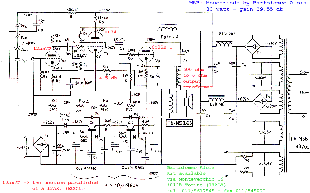

But, the thing that I'm not seeing in this amp is why the 6k primary impedance on the cathode?? That ought to want to see a low Z impedance. And then where is its return to ground??
One might expect a 600ohm to VC type xfmr?
Looks like it is through R3 & R5 = 1300 ohms??
Often the means for getting driver swing for cathode follower outputs is a bootstrapped driver...
The tube wants to see about the same load (2-3x Rp) regardless of whether it is in the anode or cathode. Think of a 12AU7 cathode follower. We don't use a 1k resistor in the cathode; we usually use 15-20k.

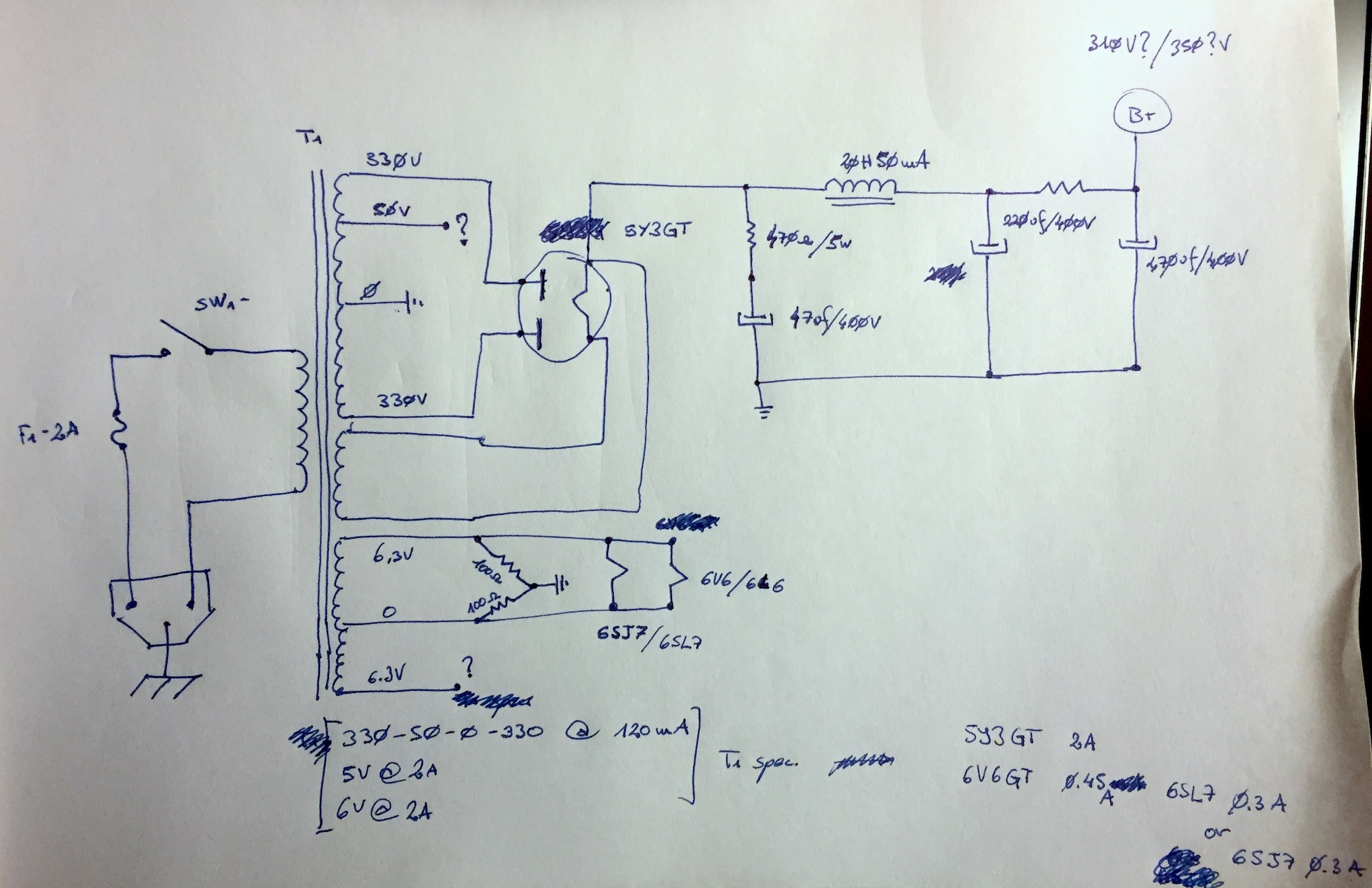

Firstly thank you all for the valuable information provided. Secondly I attach a schematic of a PSU that I had designed. Is this PSU suitable for the RH RH807 (with 6sl7 or 6sj7 and 6v6) design and for the BinaryMike's design (6sj7 and 6v6 - I'm not sure about the b+ am I right that this amp requires two 320V b+?)? Could anyone be so kind to test it on PSU (I have no clue how to use it) in order to get the value of the B+?
The power transformer is 320-50-0-320V @ 120mA - 5V*@*2A - 6.3V @ 2A.
