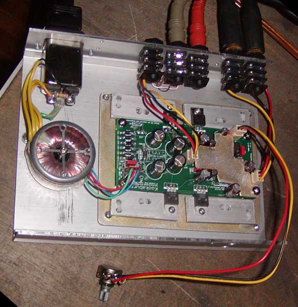

Its alive.
it works very well nice little project and great service when the PIC wasnt programmed i got a new one in the mail right away thank you..
even though i did not put the relay in yet so i have to remember to turn the powered speakers off first (event 20/20 modified amps)
the only thing is for my application it clips a bit soon. the opamp inside the PGA2311 limits the output. it is driving a +10 db line input and runs out of headroom.
It doesnt matter if the output drivers are at +- 12v since the signal is allready clipped.
i am going to do a bit of surgery and use a PGA2310 instead it should work if i just move the analog supply pins 12 and 13 to the plus and minus 12v rails instead of +- 5v? i know it has a tiny bit worse distortion figure but I can live with that
by the way you might wonder why the pot is not mounted. it is just for testing. i am going to have the pot on a remote wire in another small enclosure. by my desk. thet was the whole point of building it so i do not have audio wires running all over the place picking up noise.

neutron7 said:the only thing is for my application it clips a bit soon. the opamp inside the PGA2311 limits the output. it is driving a +10 db line input and runs out of headroom.
I had the same issue with my Proceed AVP driving my Alesis pwred speakers. I did sugury on the pwred speakers and changed the input gain. Now they work like a charm on "consumer" gear.
its just a bit of grounded aluminium that covers the top of the chips and signal circuit area. i dont know if it actually made any difference but it cant do any harm.
This thing is In a very electrically noisy environment with light dimmers, computers and lots of other stuff close by. so it needs all the help it can get.
it only took a couple of minutes to make. i found a tool i forgot i had
makita JS1600. lots of fun
