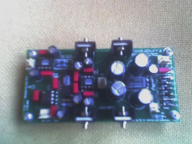

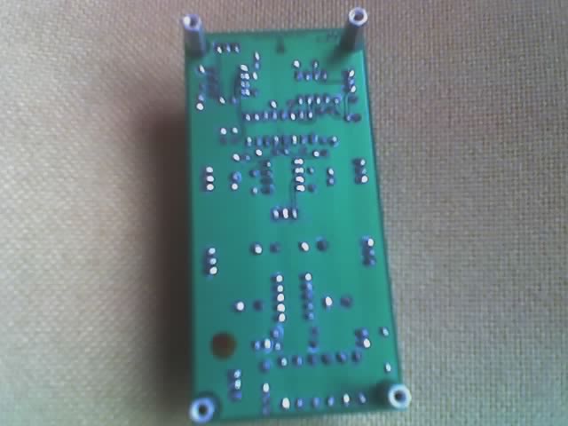

Is it possible for you to post some pictures of the top and bottom of the board? Close up would be great.

I had some problem's doing the PSU board there was a mix up for one of the parts But i figured it out. Would you like me to post the small broblem ?
Oooppss...Maybe these are better...
The short circuit on the output is even when circuit is powered.
However I have a doubt on my trafo wiring (for 230v) : I linked together Black and Red, violet/yellow to AC--and secondary (as picture on diyaudio forum) on connector from left:green/red and brown together on center/blue. Is it right?
So,here attached better picture of my kookaburra::bawling:
Okay, I think you have two unrelated issues.
First, the short on the output isn't really a short. I think you have a bad PIC (no code) and the outputs are just at ground potential (no signal). New PIC on the way.
Your trafo wiring is also wrong for 220V primaries.
You should tie the black and red primaries together (and to nothing else), then connect your AC to the yellow and violet. The way you have it, you are providing 24V to the Kook. The VRegs shoudl handle that okay, but the relay is before the regs, and may have been damaged.
