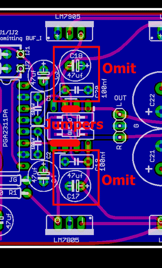

Hi Russ and Brian:
Here I am, still waiting for the TX's to arrive.
While I wait, I want to ask you a question (I'm sure I saw the answer somewhere but can't find it now).
To connect Kookaburra to My-ref the output buffer from Kook could be obviated, right?
If so, where do you connect the outputs or where do you put jumpers?
Thankz
Mauricio
Thankz
Mauricio
maxlorenz said:Hi Russ and Brian:
Thankz
Mauricio
Yes it can, You really only need the output buffer for loads less than 600ohm.
I will post a photo of where to put the jumper as soon as I get home where I have them. I am at work right now.
Notice that on the PCB silkscreen there are two white lines between two pins on both sides of the output buffer. Just use a piece of wire or discraded resistor lead to jumper those two holes on each side.
Cheers!
Russ
maxlorenz said:OK, Brian, that helped too.
Can I let the SMD opamp in place?
Sorry
M.
No you should not leave it in place.
:EDIT: unless you want to cut the power supply traces at the buffer pads. Which would eliminate the posibility of using the output buffer later.
