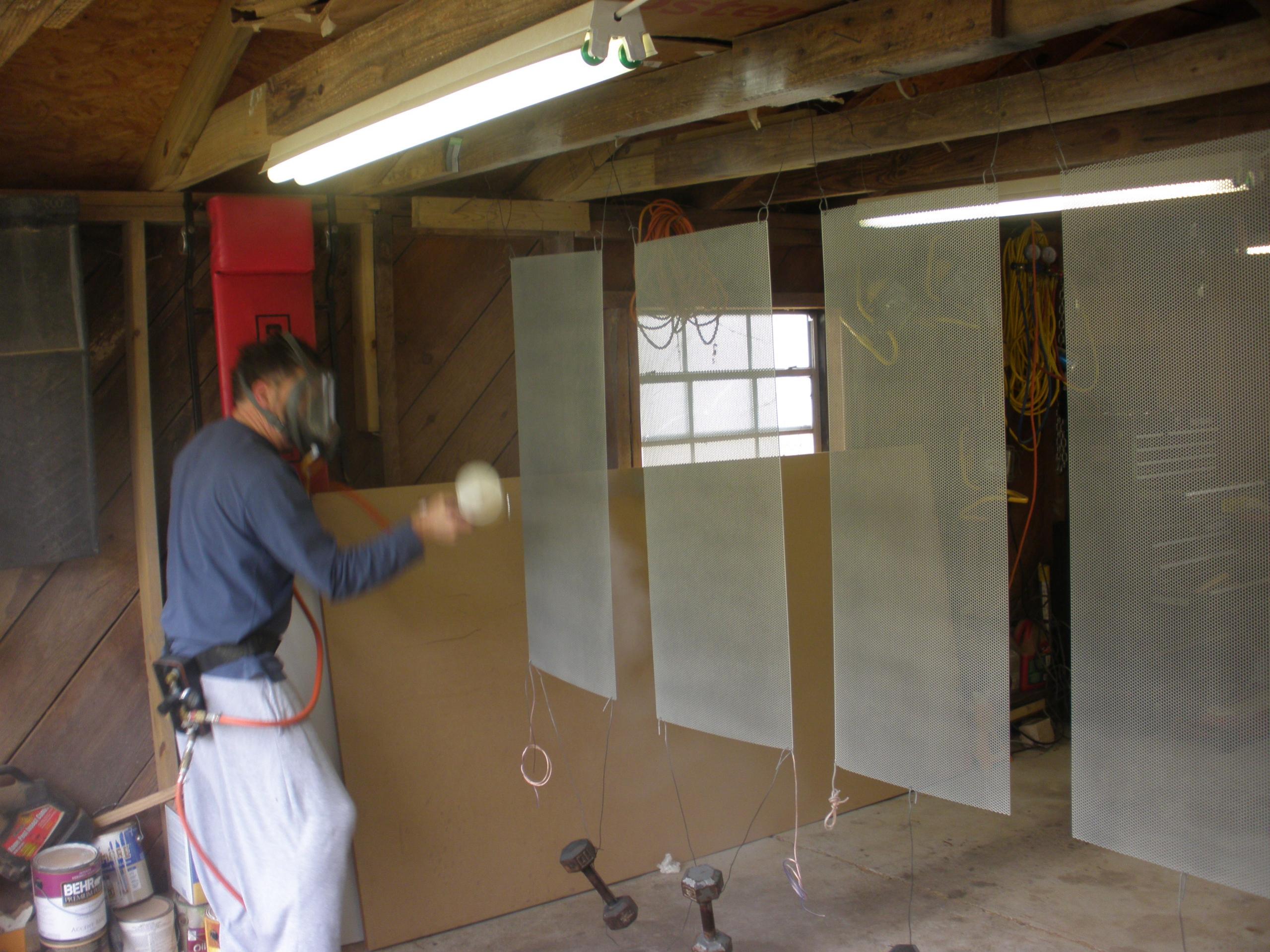

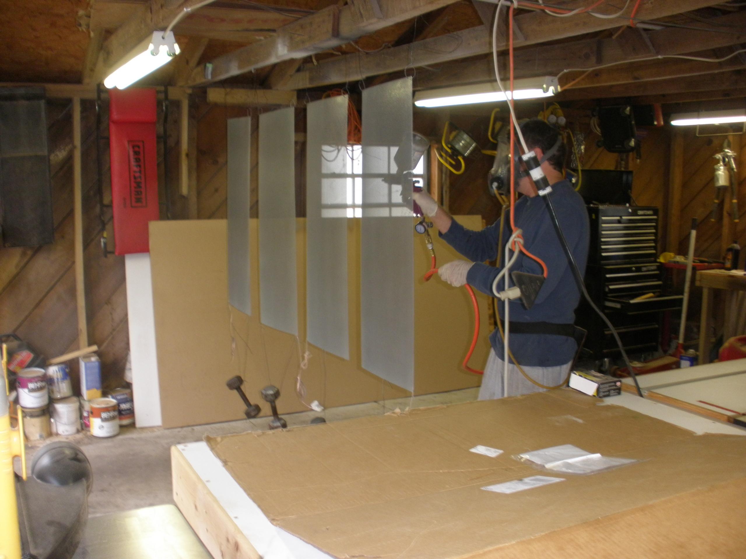

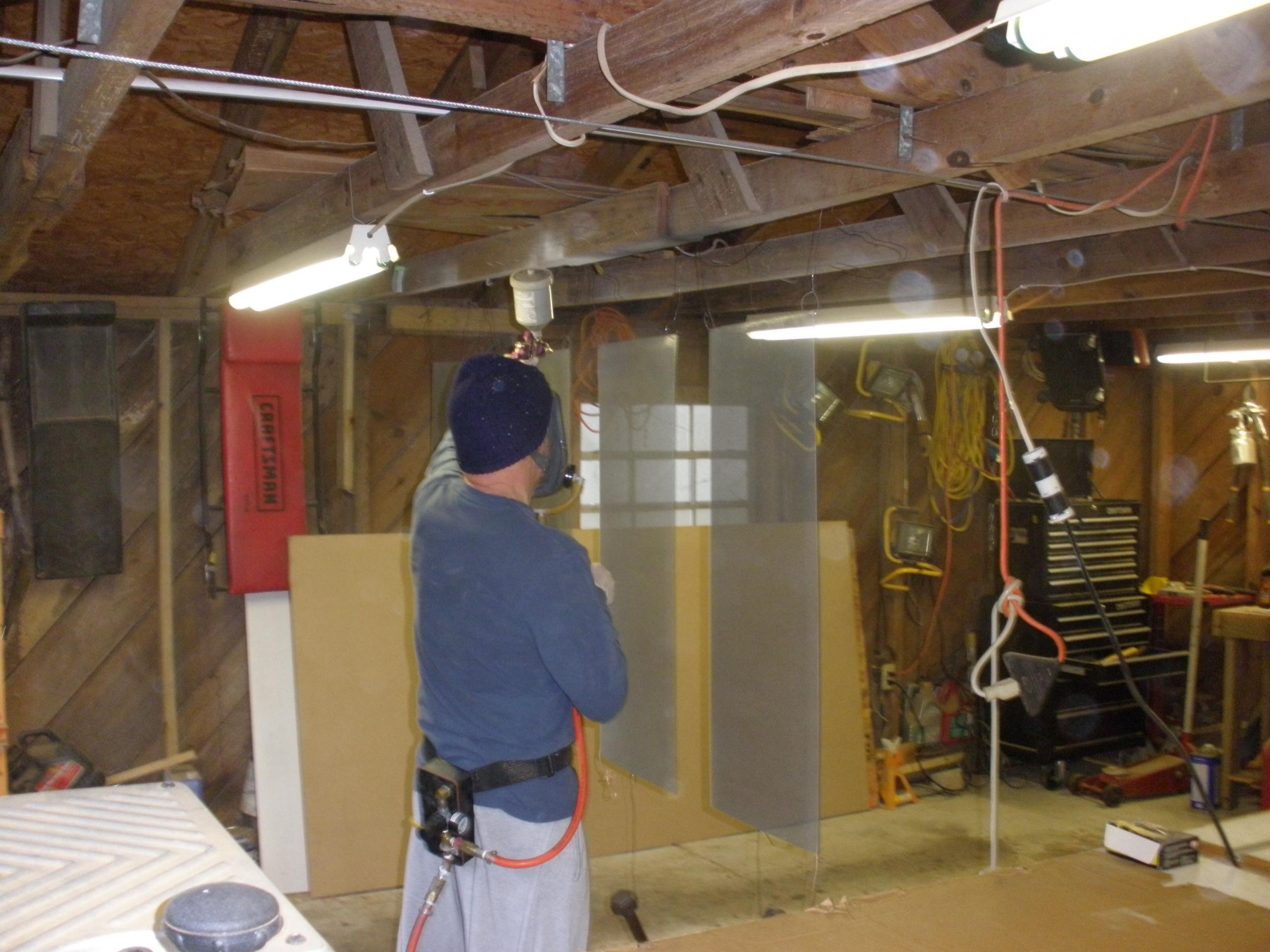

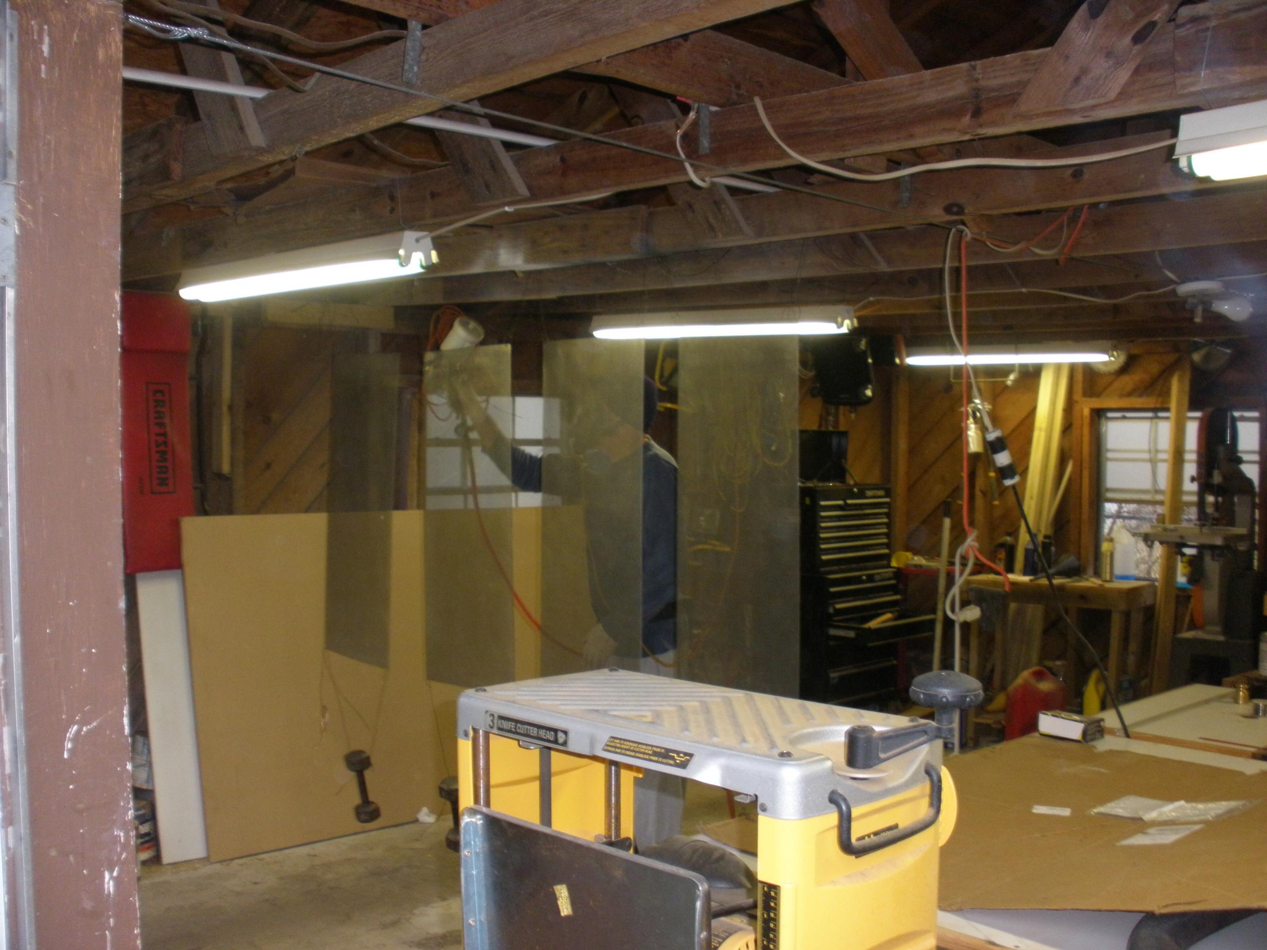

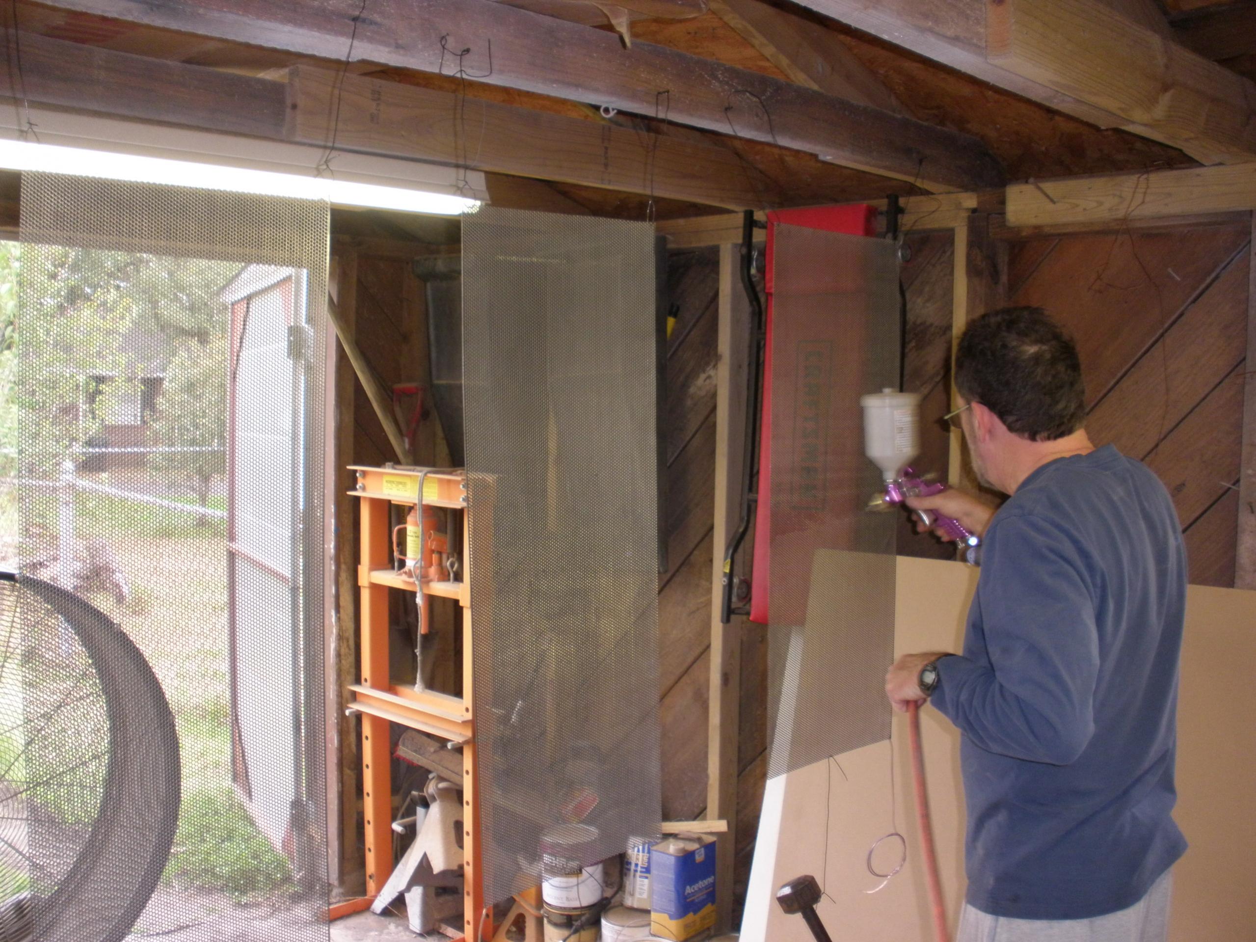

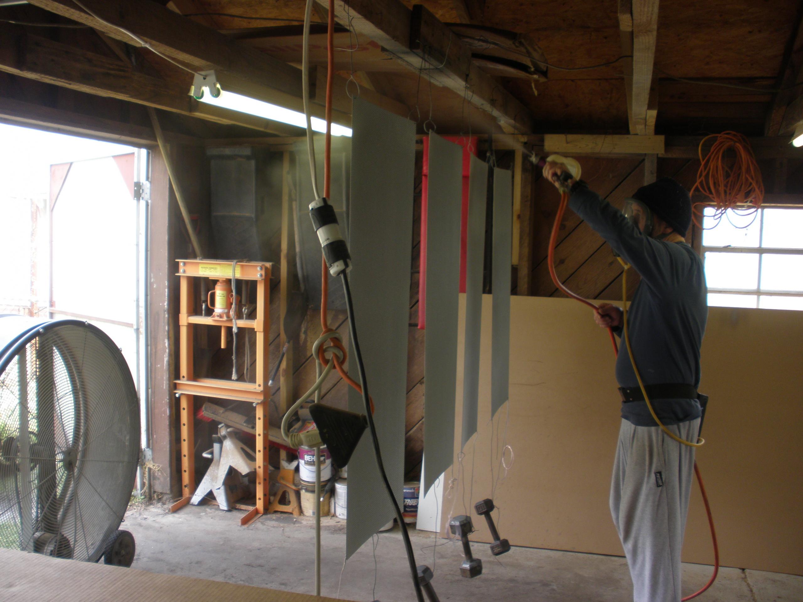

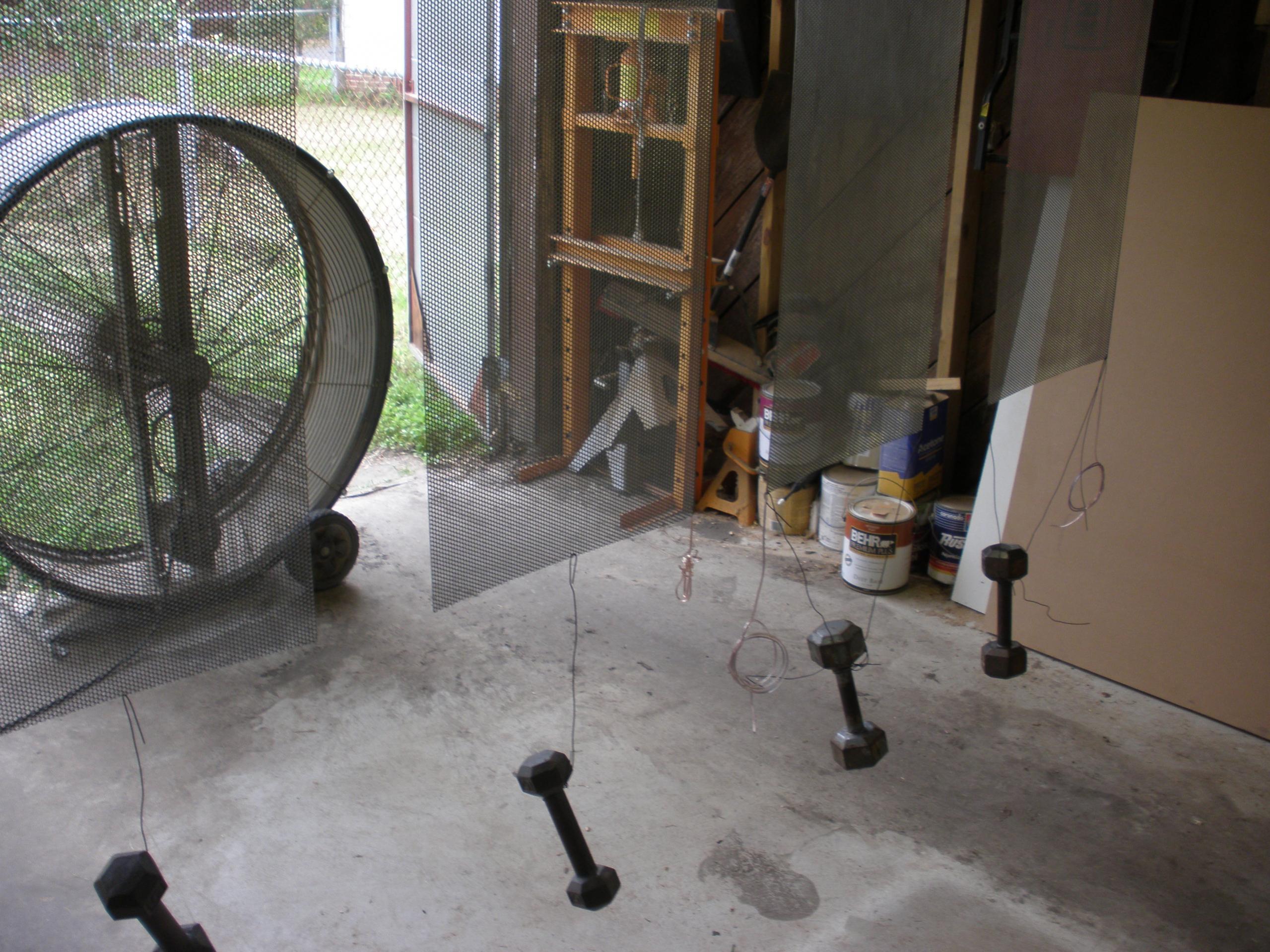

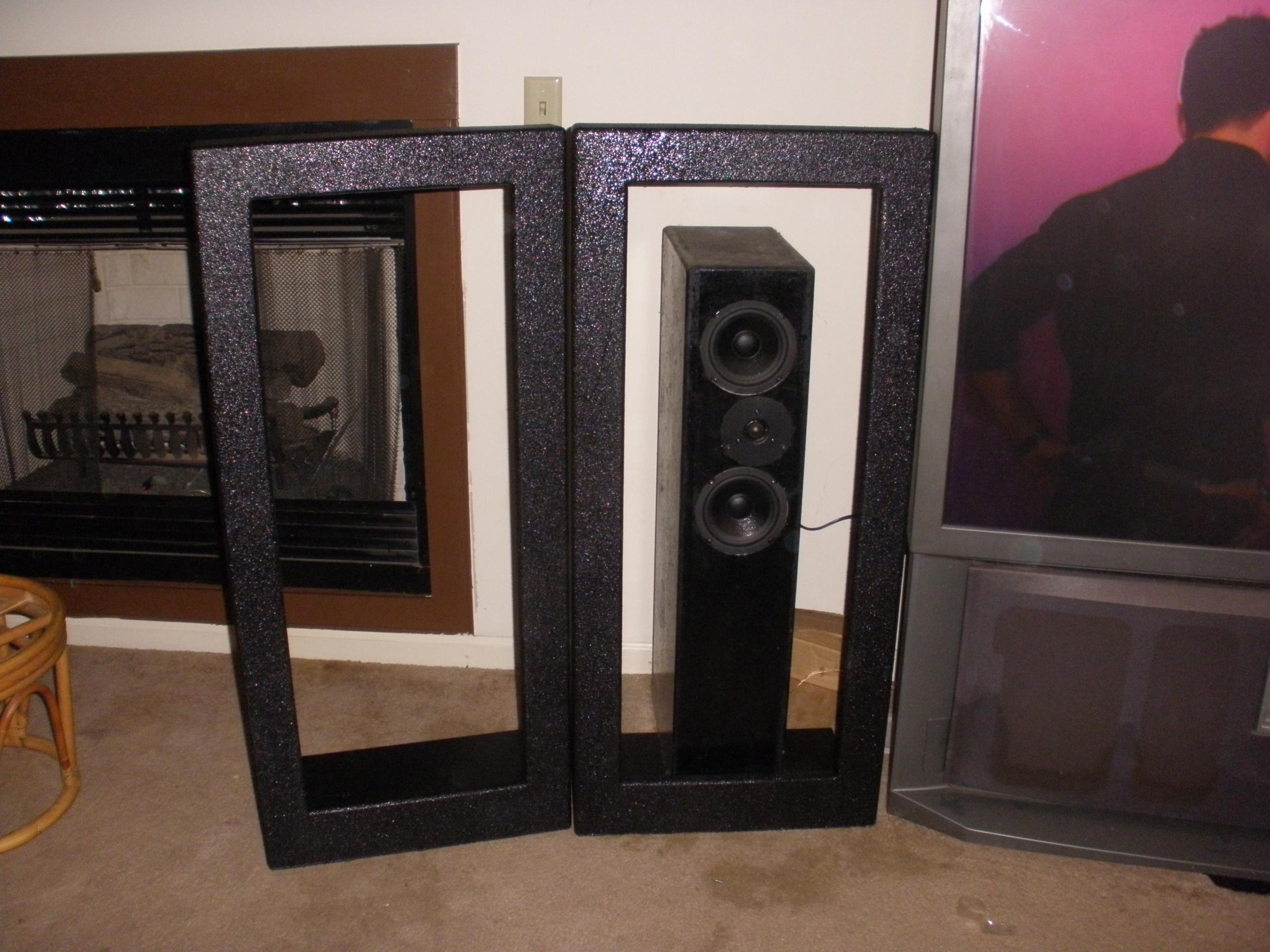

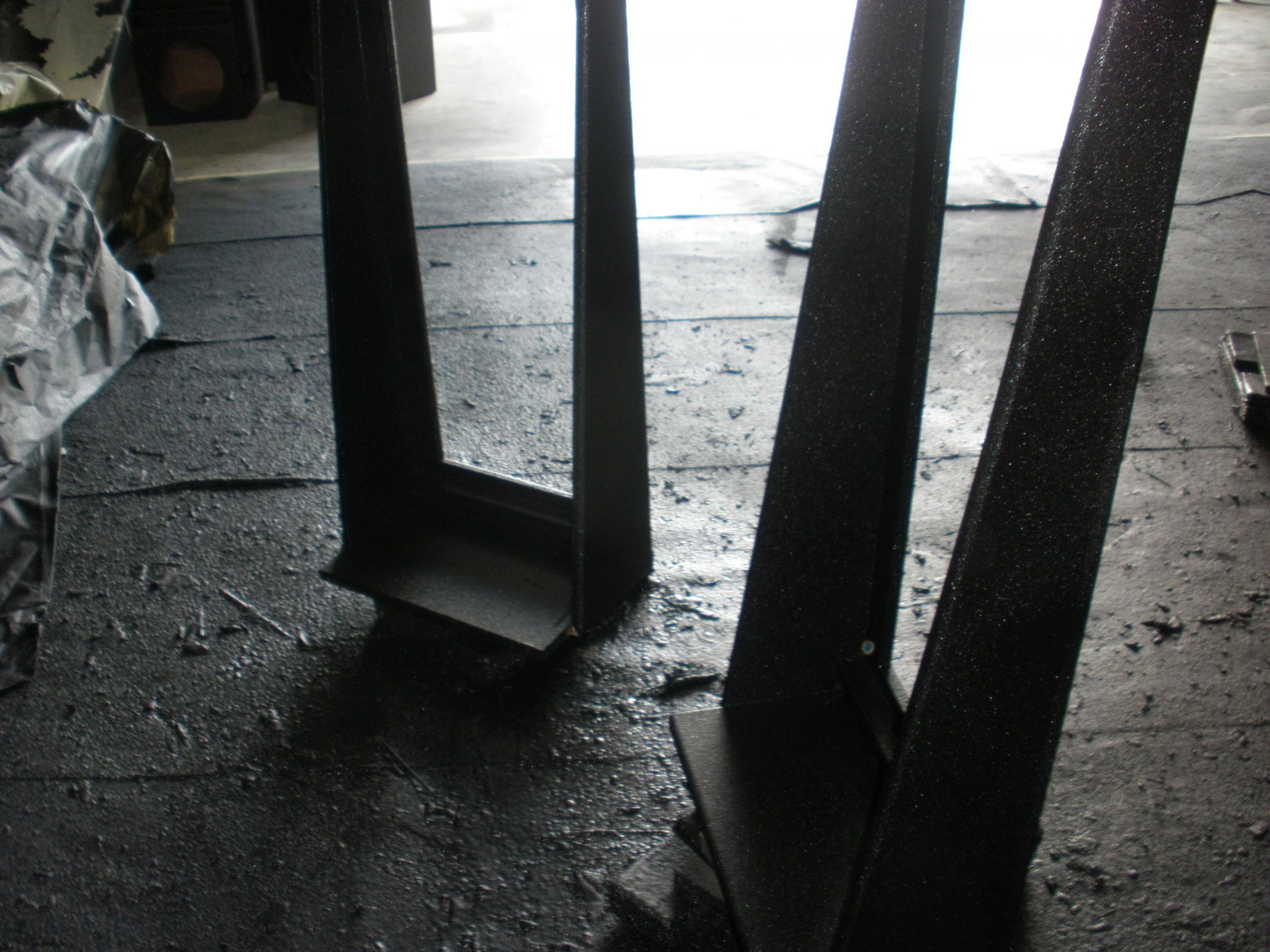

Cleaned and coated, here are some pics, of course Charlie did most of the work, it is his shop you know, but many thanks. The rhino spray went a little further than exprcted, however had to use some polyurethane to achieve propper thickness.
next weekend i will be able to assemble, finally.

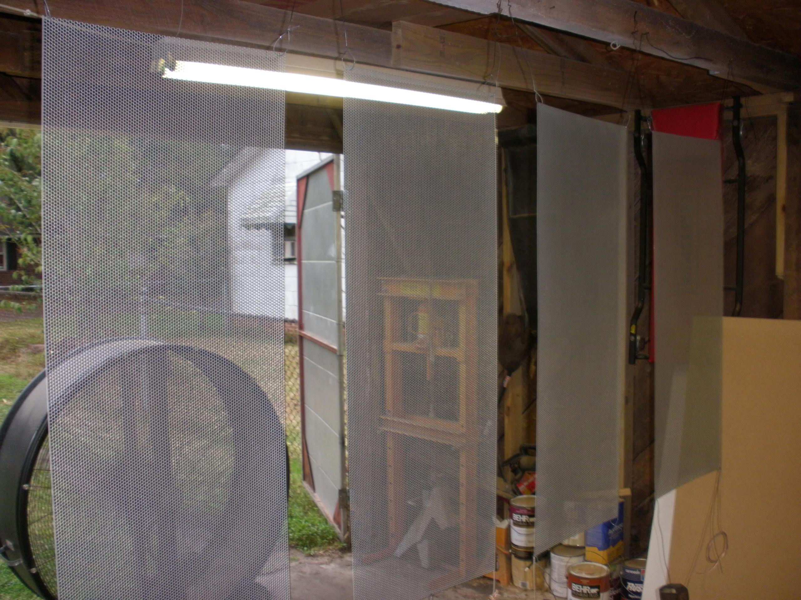

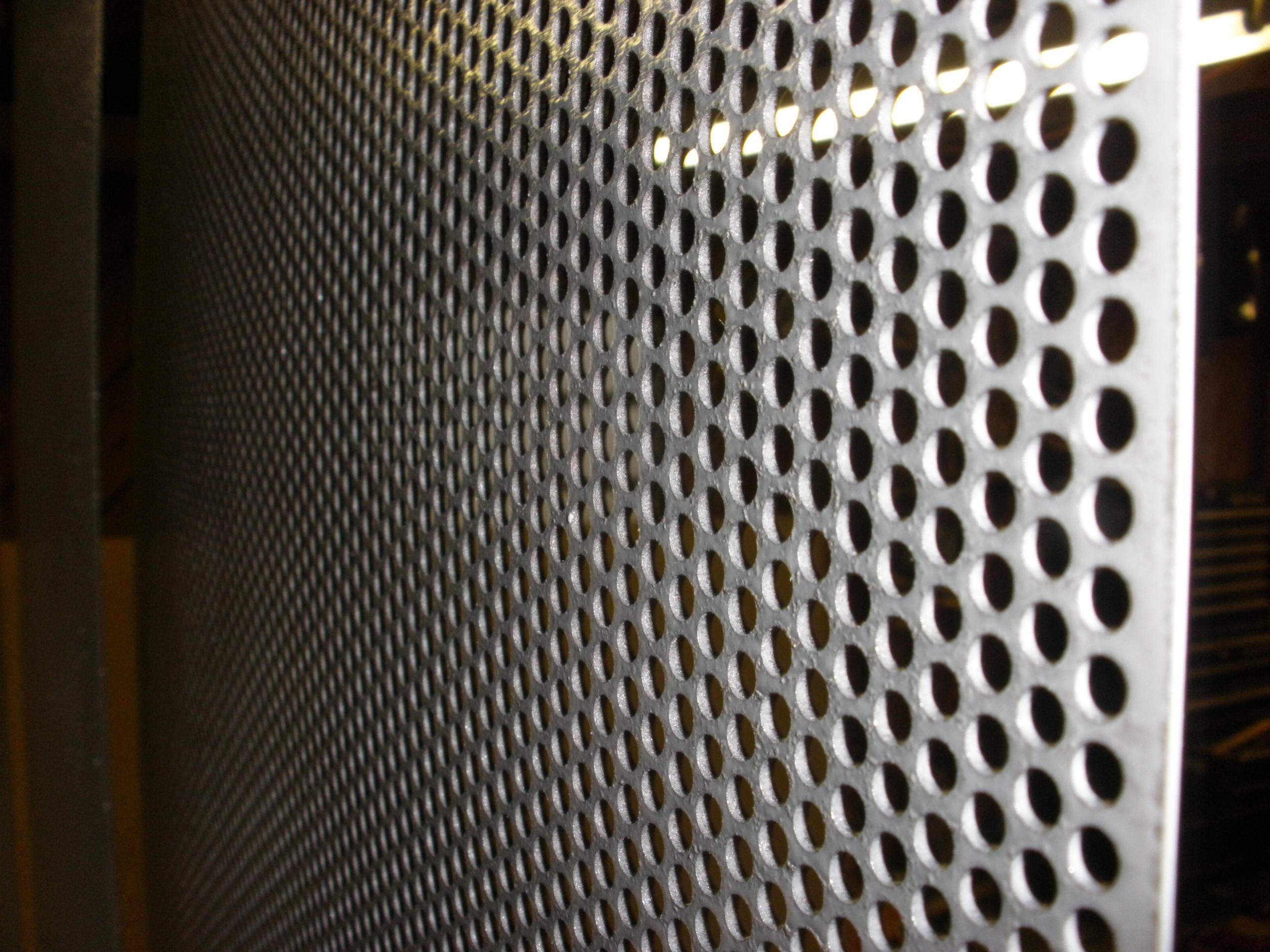

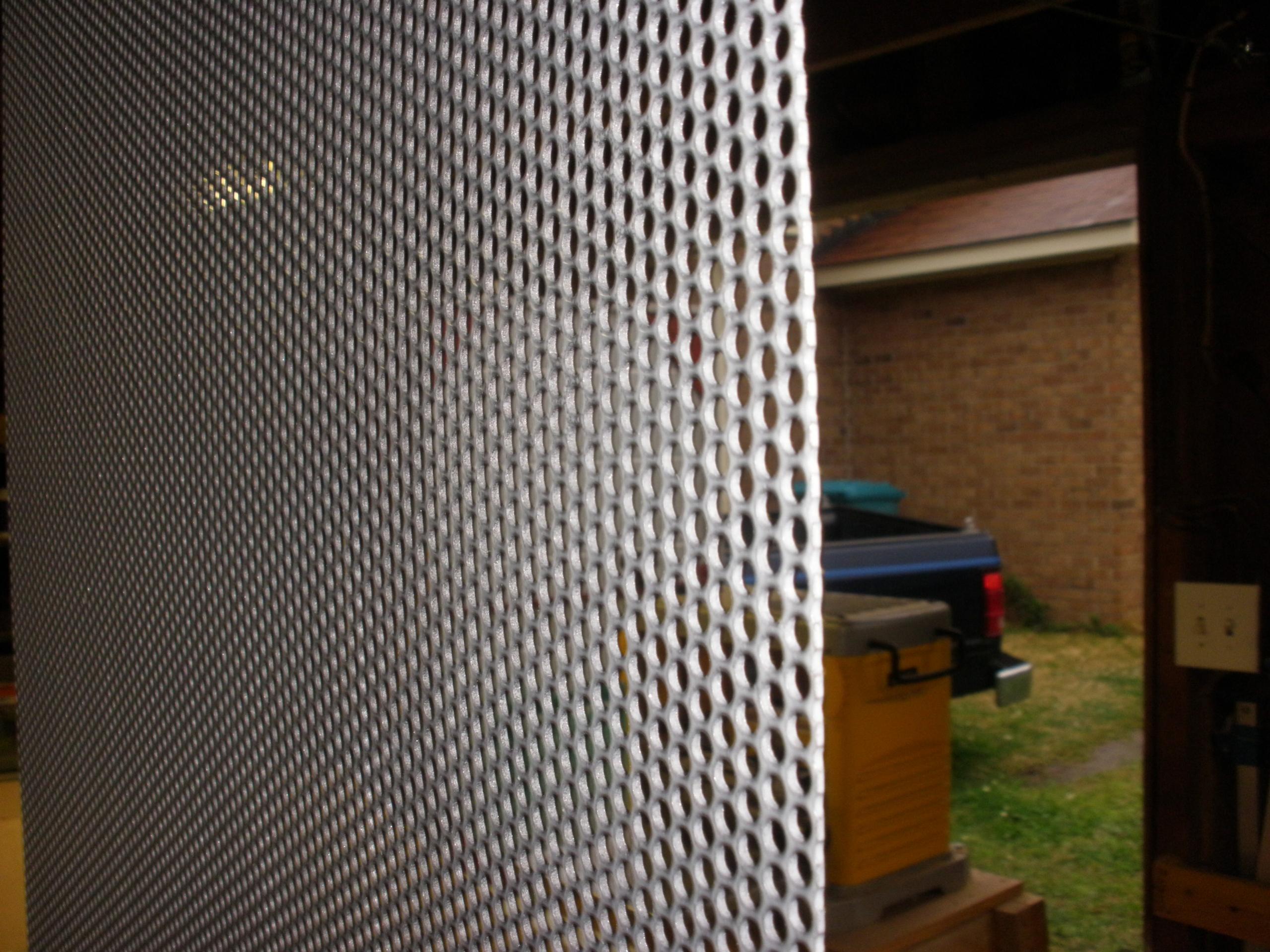

some more pics.ending at 15 mills +-1 mill, no color added, they are silver and very, very shiney, should look good in a black textured panel with a small puck light behind them. i will just stay tuned.
still bumbed i could not listen to them today, i guess patience is a virtue, that i have plenty of.

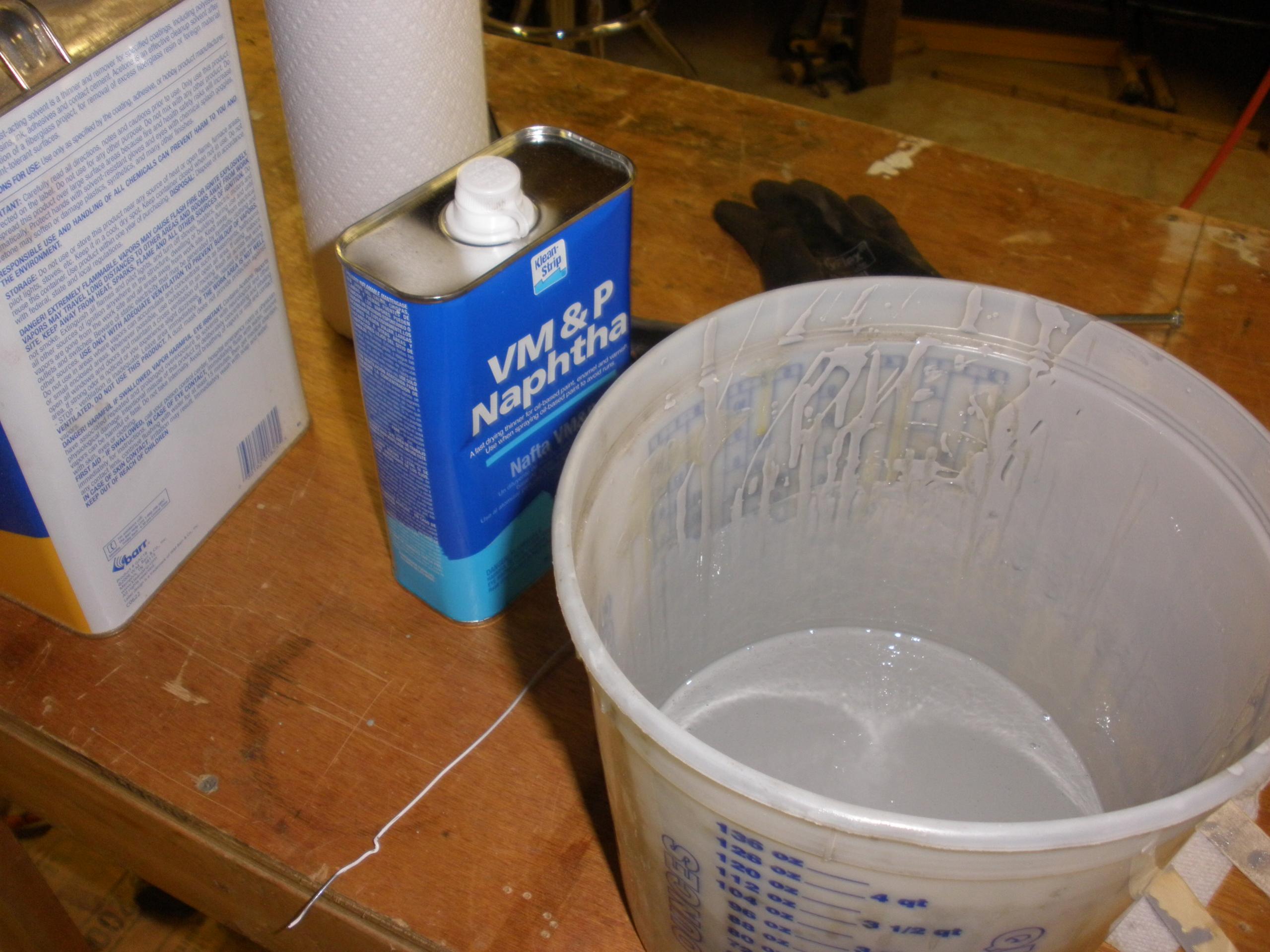

I wish i would have taken more pics. those show only cleaning and one coat of rhino, we coated them about 10 times as the mixture was dilluted with acetone to be able to spray. I guess alot going on and a couple trips to Lowe's ruined the time i or we had to finish. I will make sure i take pics on the next adventure.

>now i guess i need some sand paper, on the other hand, i have not seen the finished product.
maybe no sanding at all.Charlie is a very experienced body work/car repair person, and many others, those panels were sprayed so evenly, you would have to have been there to see with your own eyes, thats why i wish i could have taken more pics.
right now, it is what it is, perfect to me, no corners cut.

Here are the stats, coated and very beutiful. they are only missing some metal and electonics, bummer. this weekend i hope to have what i have been working on finished and complete this post. from start to finish.
The tl's are too dang heavy to pick up by myself, but those will be sprayed as well, hopefully this week too.
I dont even think i going to use the grill cloth, the stats are a shimmering silver, with that and black, awesome look, different.

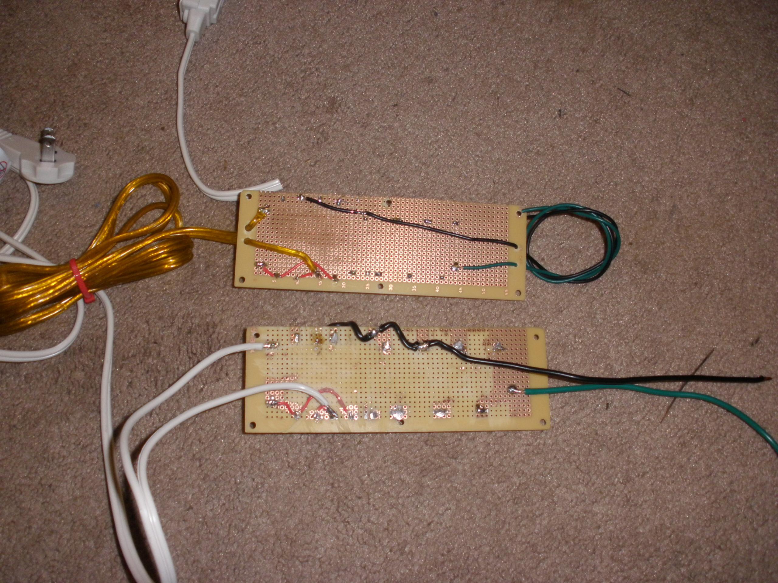

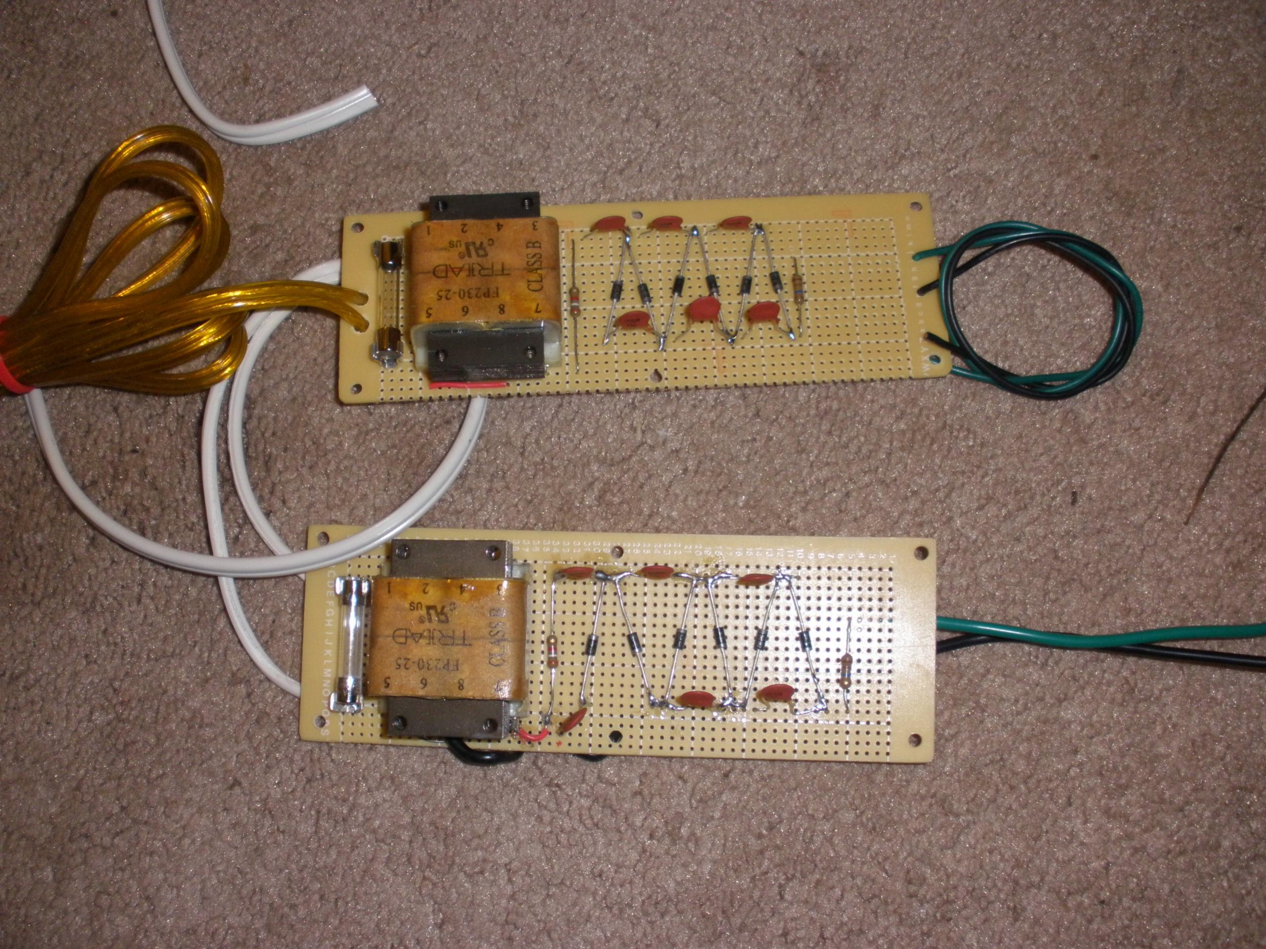

checked the placement and joints, all is fine, jusst have to find someone to hold on to the green and black leads and make sure it works.
without the schematic, i think it turned out well, ugly as all get out, but it will work. nice critisismin Charlie, noted and appreciated.

not meaning to criticize good buddy... just amazed you did it with a tip as big as your thumb on that soldering iron!
