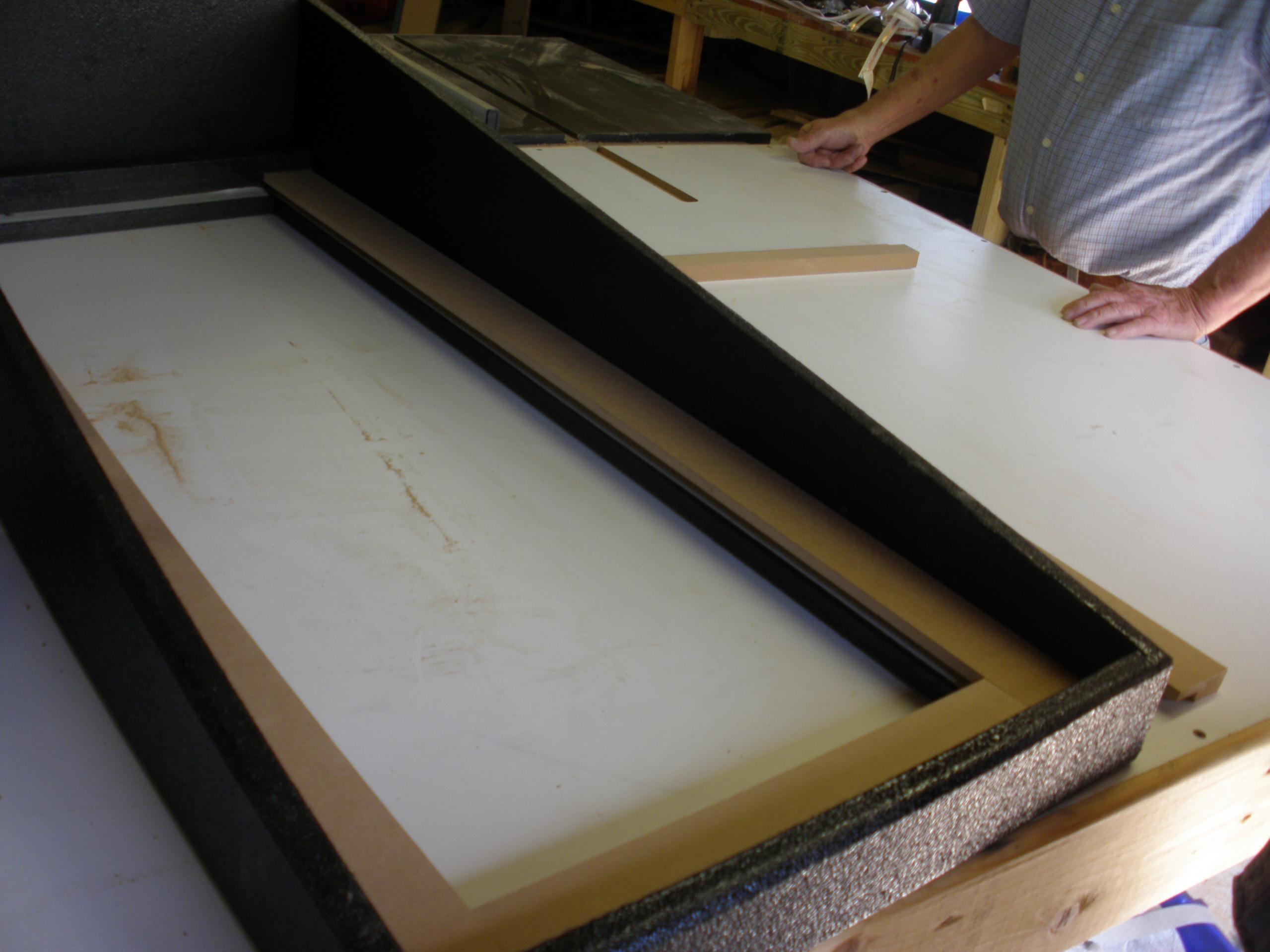

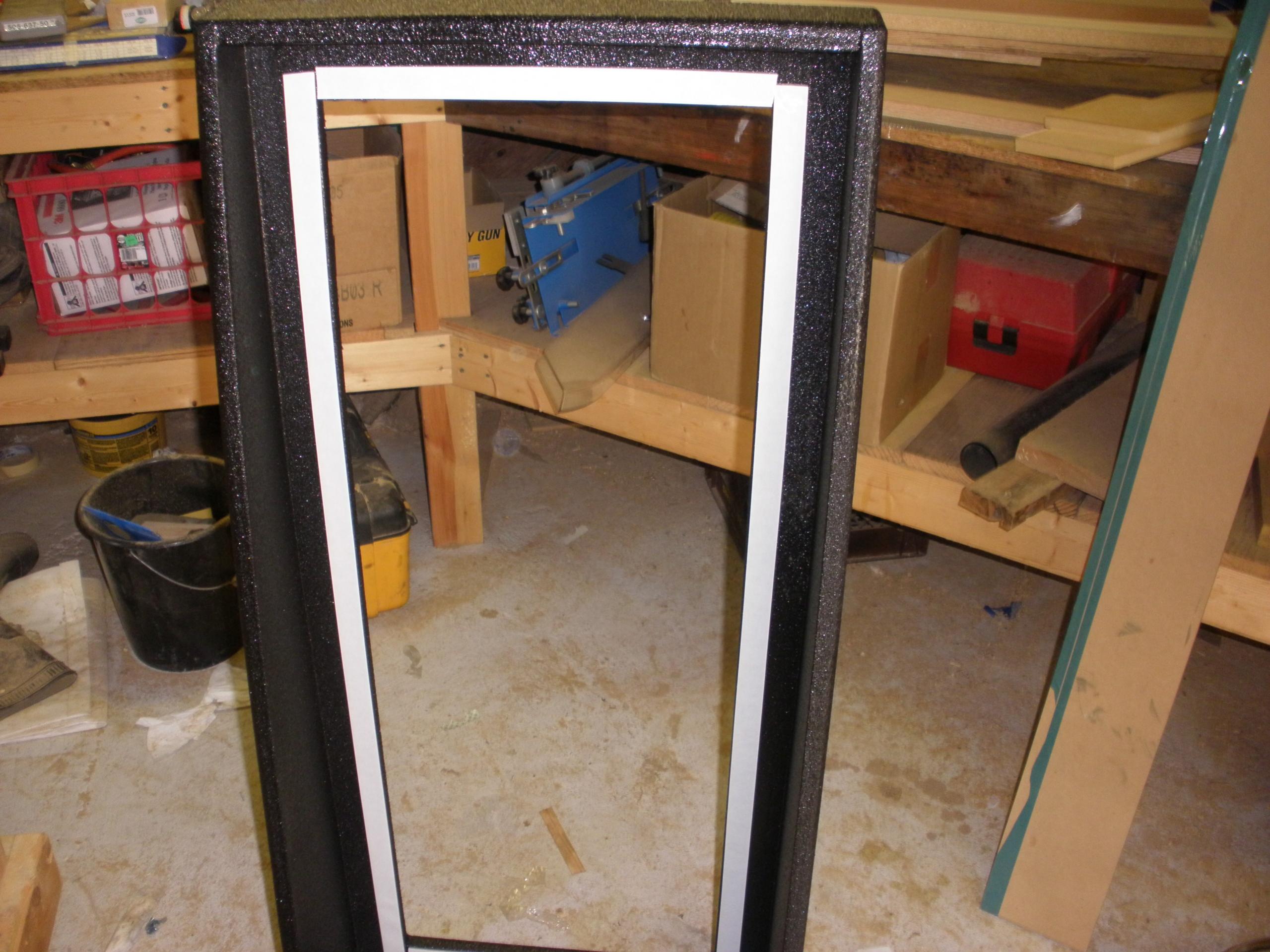

This is something Charlie had with him, pretty neat stuff, plyable, insulating, and well, kinda cool looking.
We first spayed the rhino coating followed by coats of poly eurothene, so shiny, smooth and silver. the blue tape is from what i gather an insulaing tape, not sure its primary purpose, but we were able to hold the panels on every edge and corner on full charge with no adverse effects, no archs, not even a worry, thats why that question was posted"too thick". no, just fine, dont know what perfect is yet, never will.

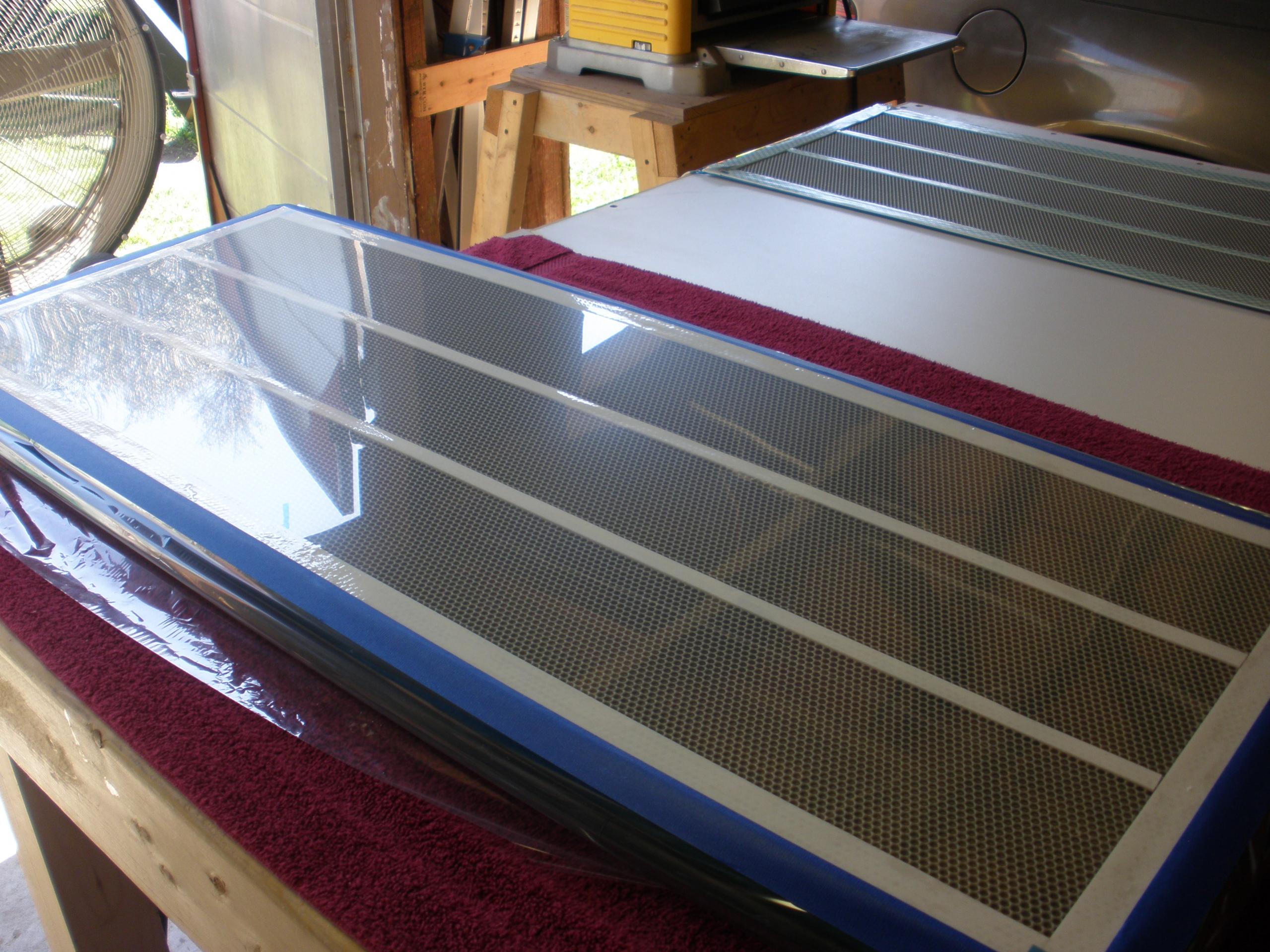

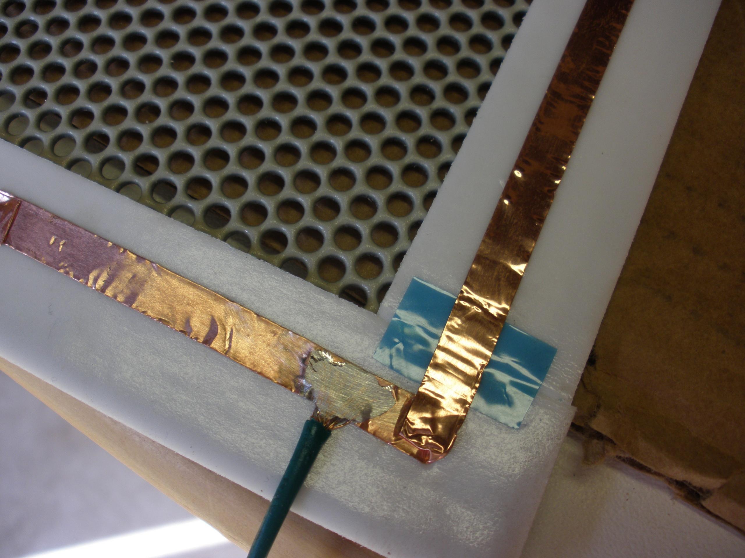

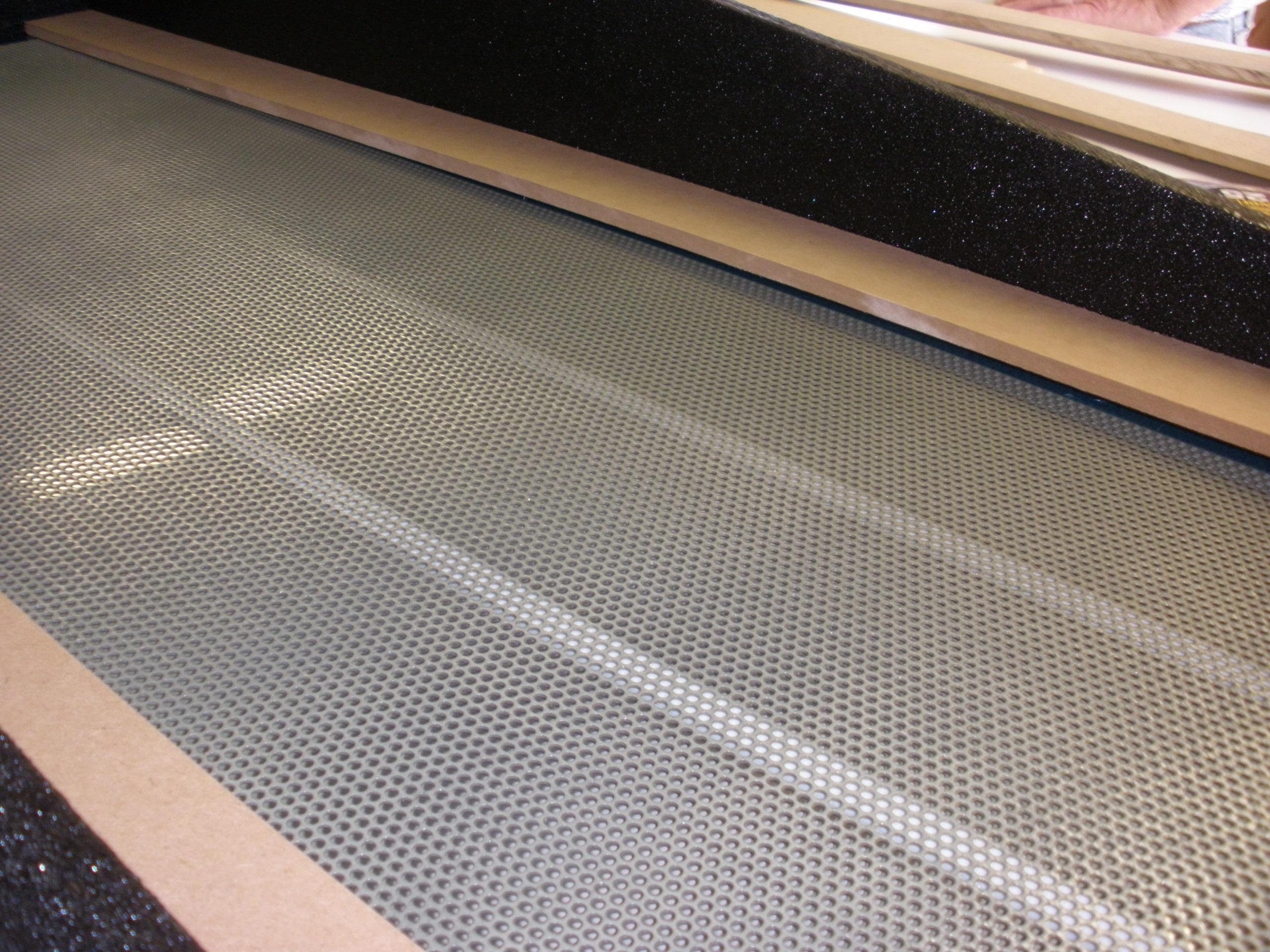

We've replaced the diaphragms with fresh clean 6-micron Hostephan and ready to apply the Licron Crystal when it arrives. Did one light coat work for you?
jer
this question is for you, i have ever heard anyone or read anywhere what coating thickness and application procedures. please let us know as soon as you can.

I plan on redoing the diagphram on my little white panel,hopefuly today.
Now that I know that it works, I will try some more test samples today.
So that I can write a detailed report for everybody on diyaudio. jer

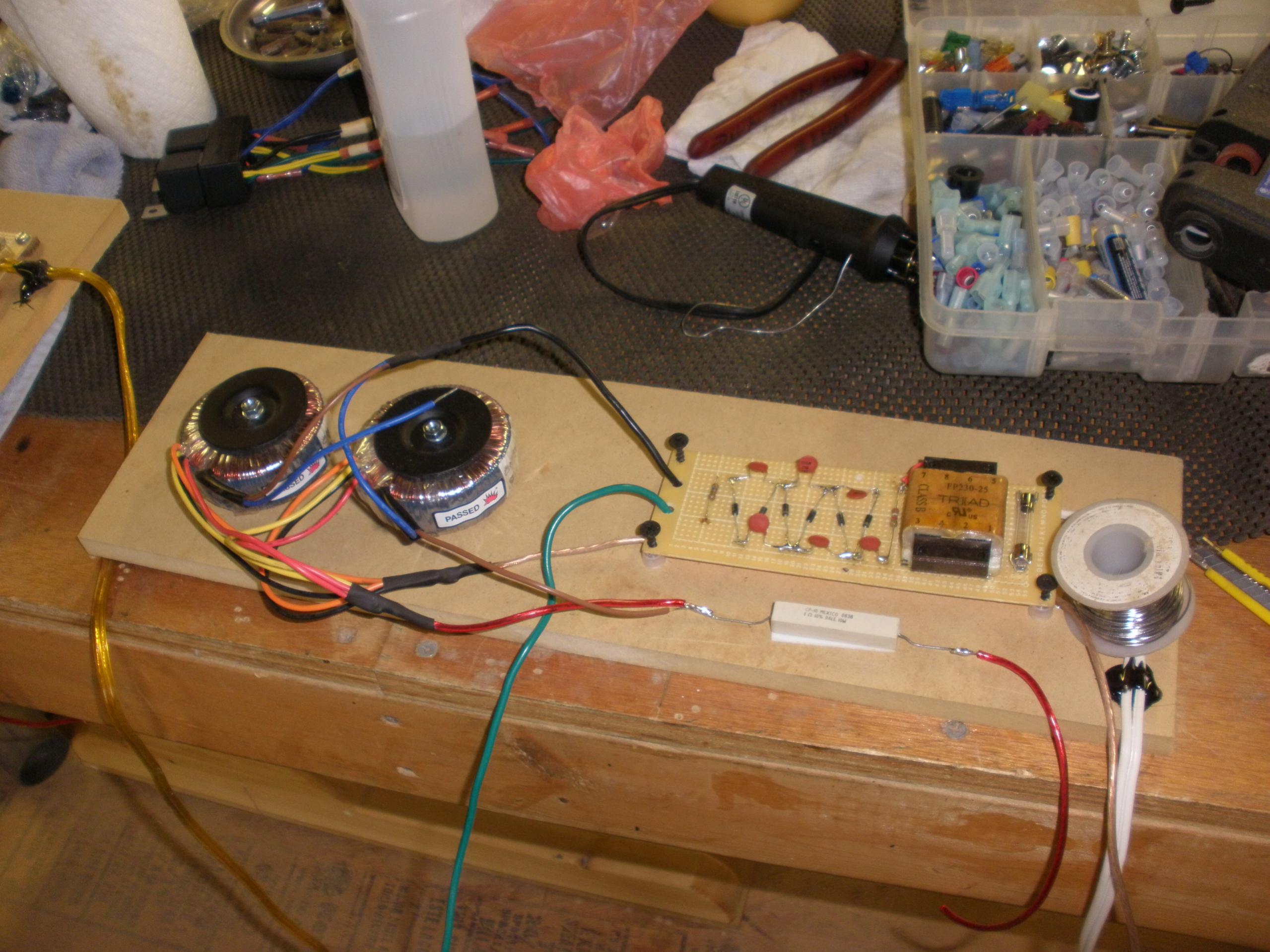

colored stat coating

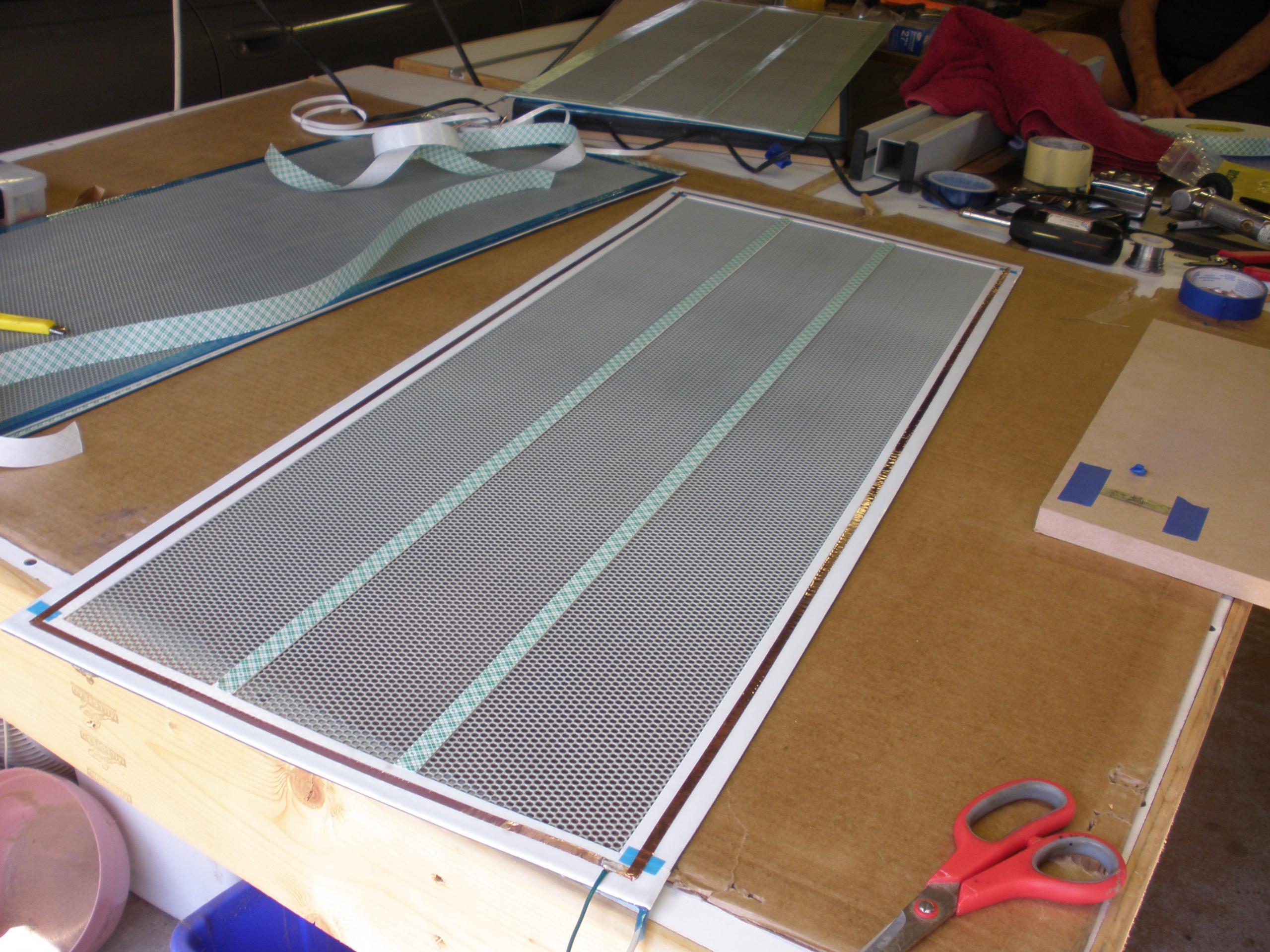

I found some neat two part insulating material at work today, meant to take some pics. When i finish the weekend after this, i plan on spraying, using a regular spray, to apply it. I have indigo blue, emerald green, and yellow. sorry Charlie, no pink.he he he.
Jer, i do have plans on building small panels similar to yours that i heard over the soon. I think it would look neat with color that matches my decor around my office area using the lexan as panel. Just keep that in the back of your mind. A parts list would be great. i will use the 51% O/A perf, d/s thickness and diaghram thickness will have to into play as well, i have alot of black two sided tape left over,i think, dont know how much Charlie used on the diagphram stretcher, which i say is coolest thing i have ever seen, simple, elegant, perfect.

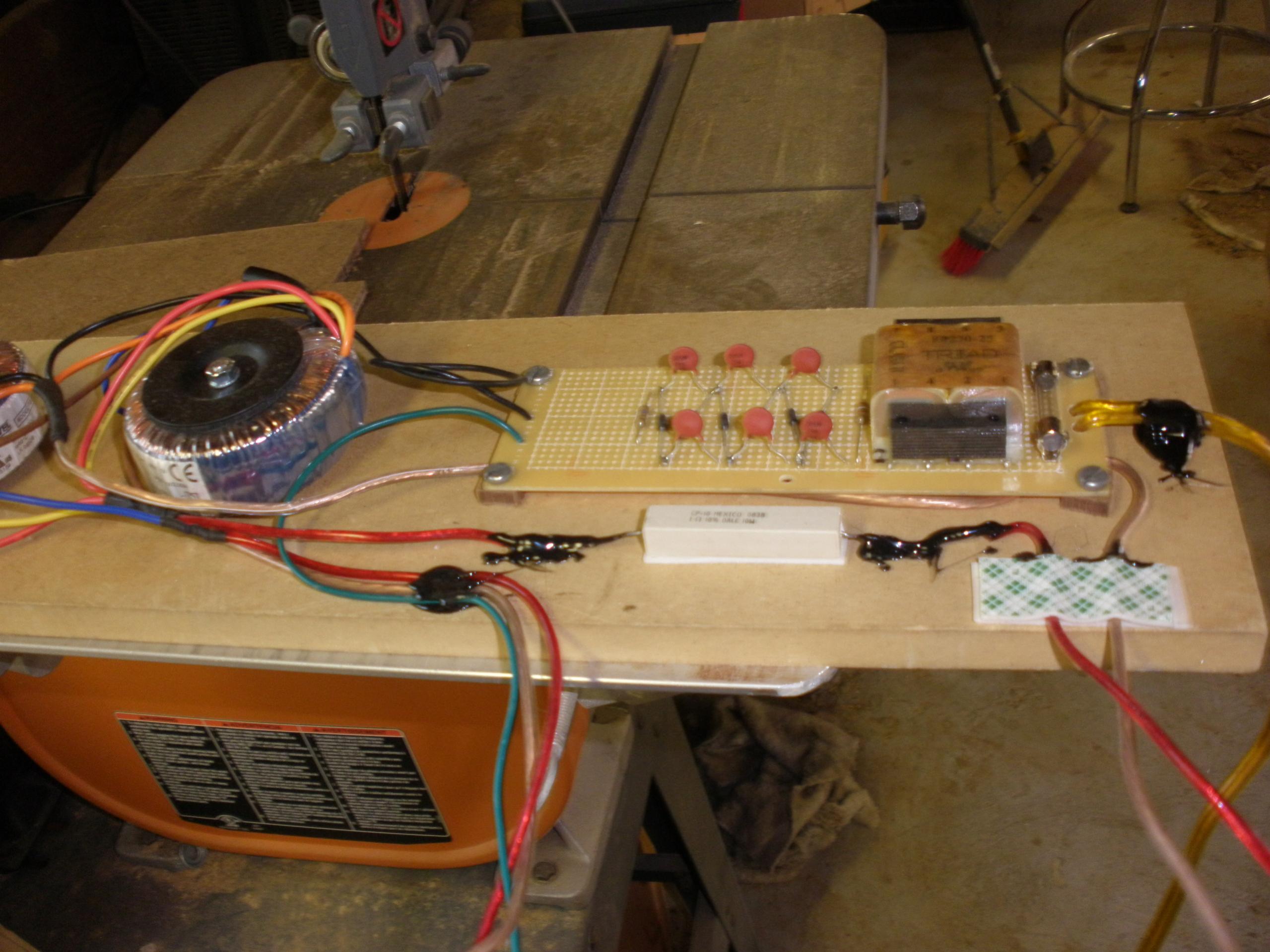

another project
Jer, i will send some information very soon about our conversation on the smaller esl's. this will include funding and research money. a DIY kit. I will as soon as i can put together the procedure and contacts to obtain that funding. This will take a little time, however, i am not in a hurry, just get the idea idea out of my head, that everyone can build a or AN esl at home, i will leave at that, you know where i am going with the idea.
thats why i posted "differnt ideas for ESLs" I have all day at work to thinnk and process my thoughts, i will post them, or pm you(or friends) on my ambition. I am very ambitious and will use every resource possable to achieve my goals. rather our goals to make this happen.
If you can, work on a parts list, i will PM you as soo as i get home, the smaller stats is what is on my mind, surround sound, di pole.

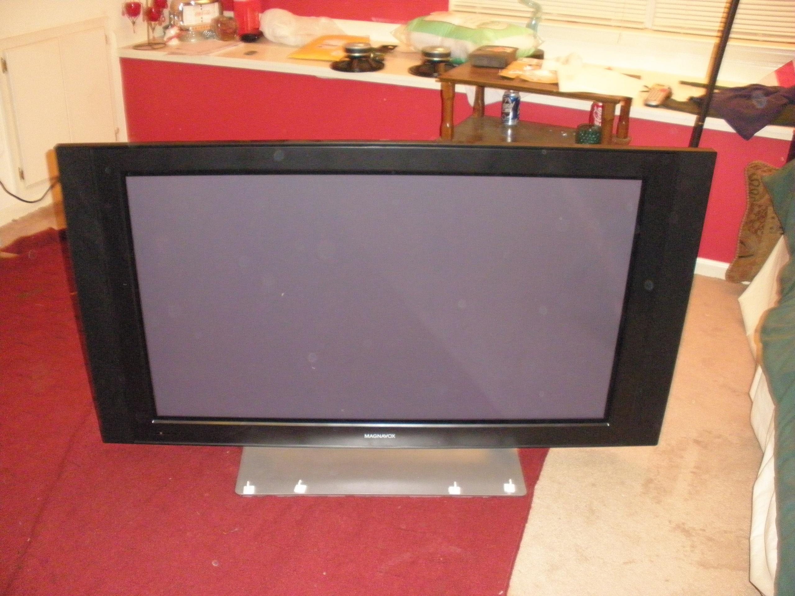

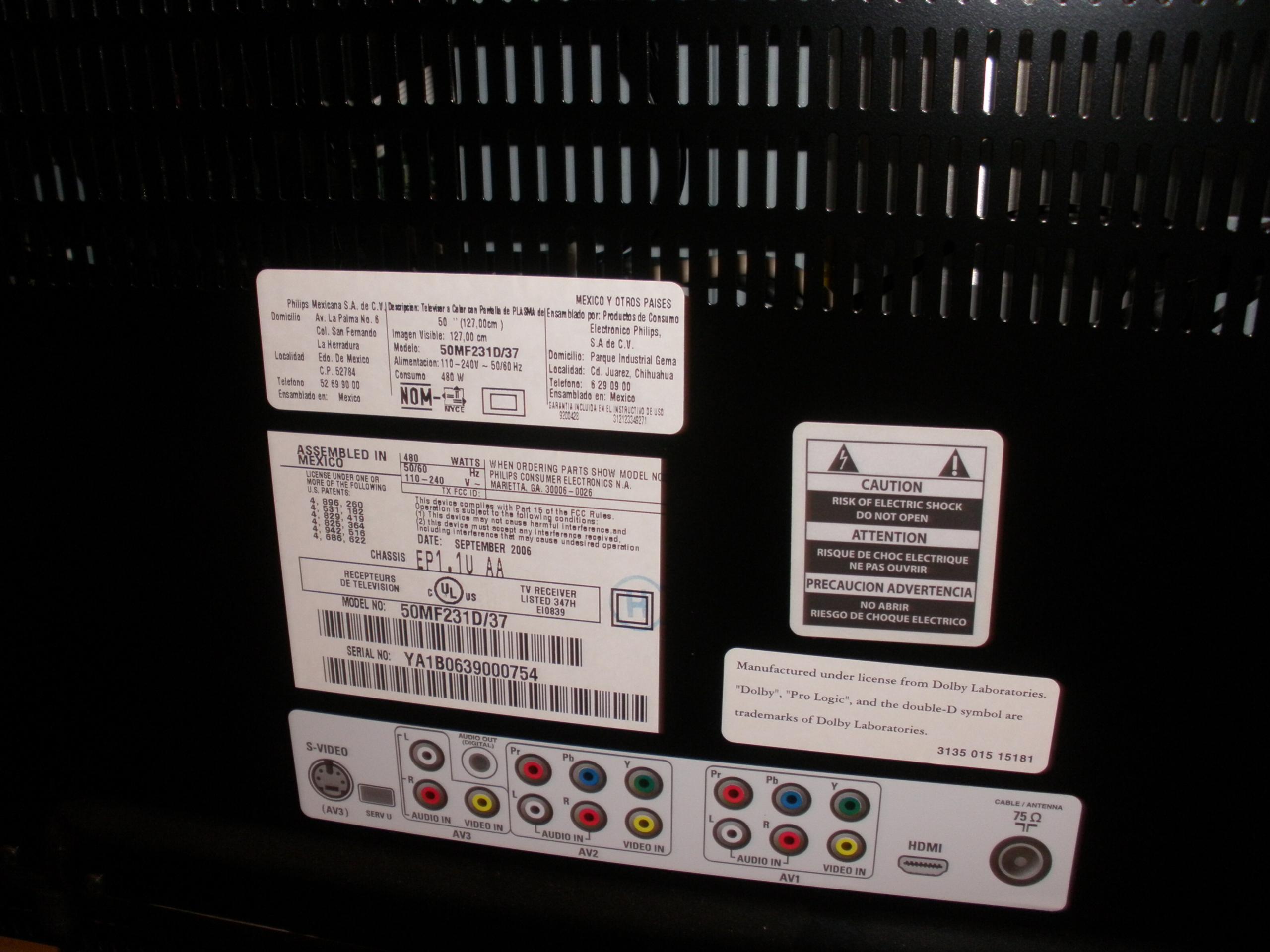

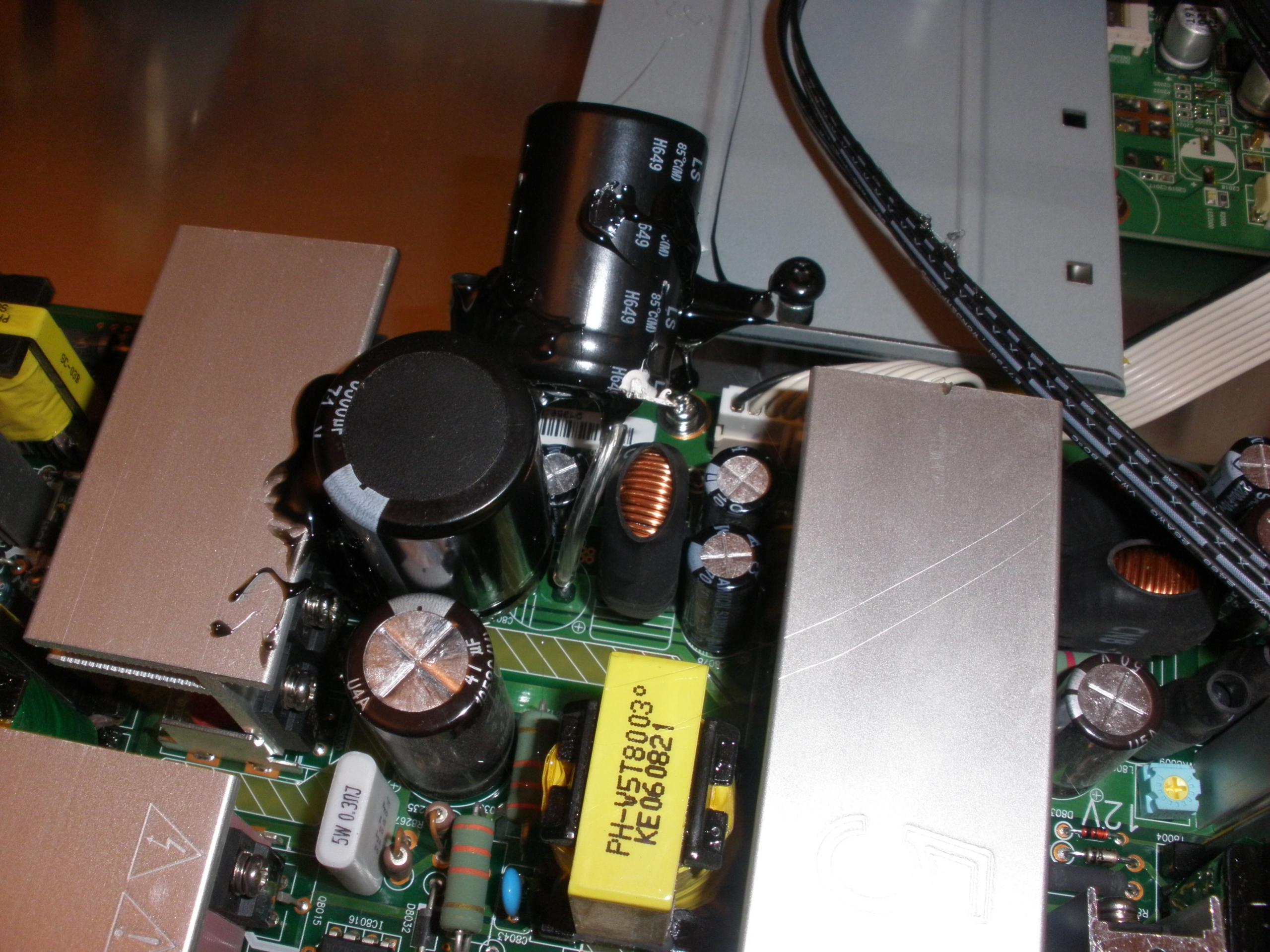

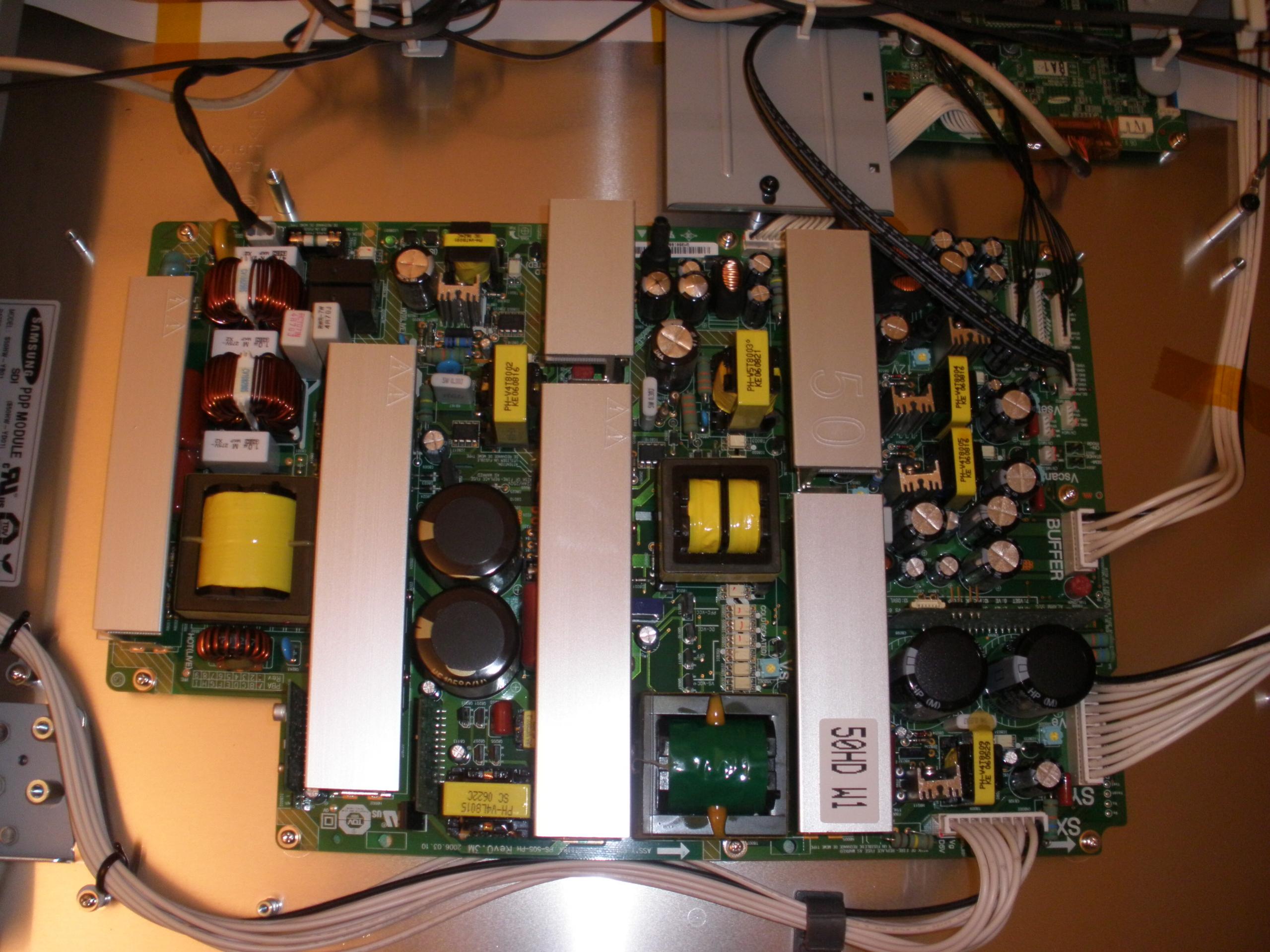

i just obtained a 50" flat screen fro Magnavox, when you power it up, it will humm then shut down, flashing the red light 4 times, like an errror code. here are some pics, i will pull it apart tomorrow as all tools are at work. you are very smart and the first person that came to mind.

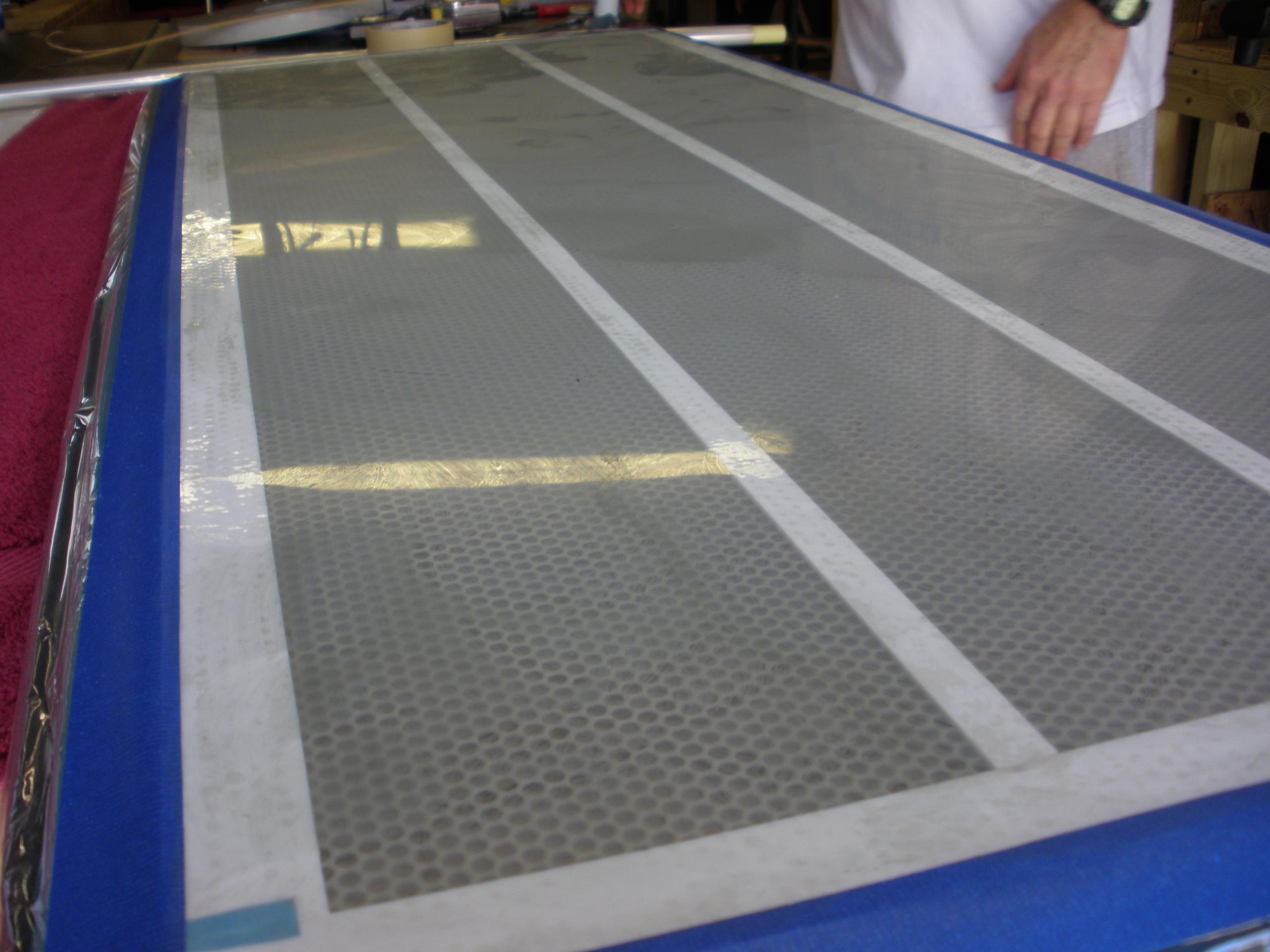

Great news, Sunday will be done day, the licron worked perfect! Due to you and Charlie. I was told that it looked thick as he sprayed, let it dry over night, and the thickness was around 2 micron. used the home made trannies and said they sound wonderful. Cant wait to mate them to the panels, wire up the other tranny, my self this time and post some pics.
The TL's still have to be sprayed so, not finished yet.

pics, it looked bigger than i thought, 37".
Thanks Jer for the very insightful information, wished you lived a little closer. I got it to power up up! but will check caps on power supply. this will complement the stats perfectly.

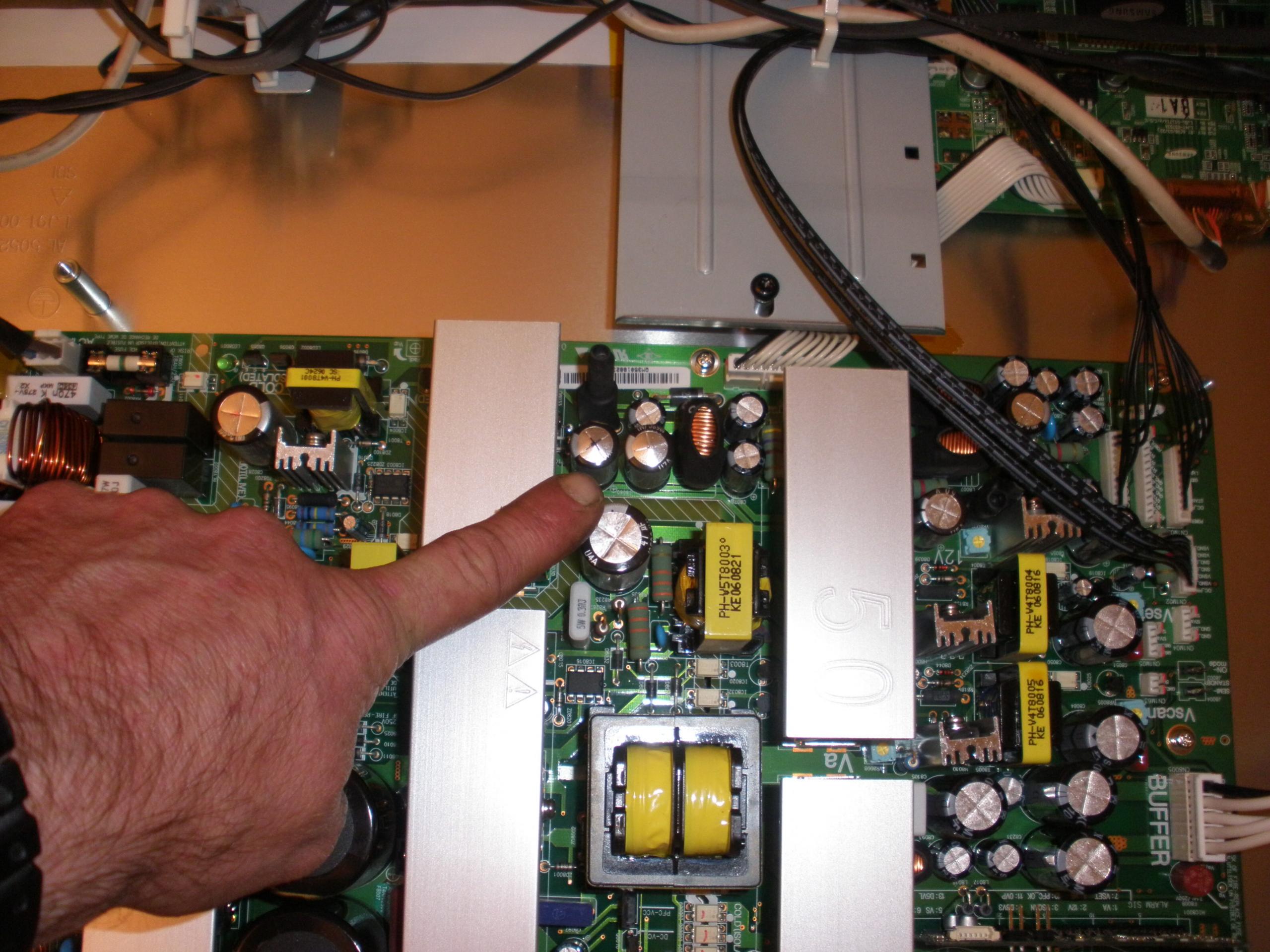

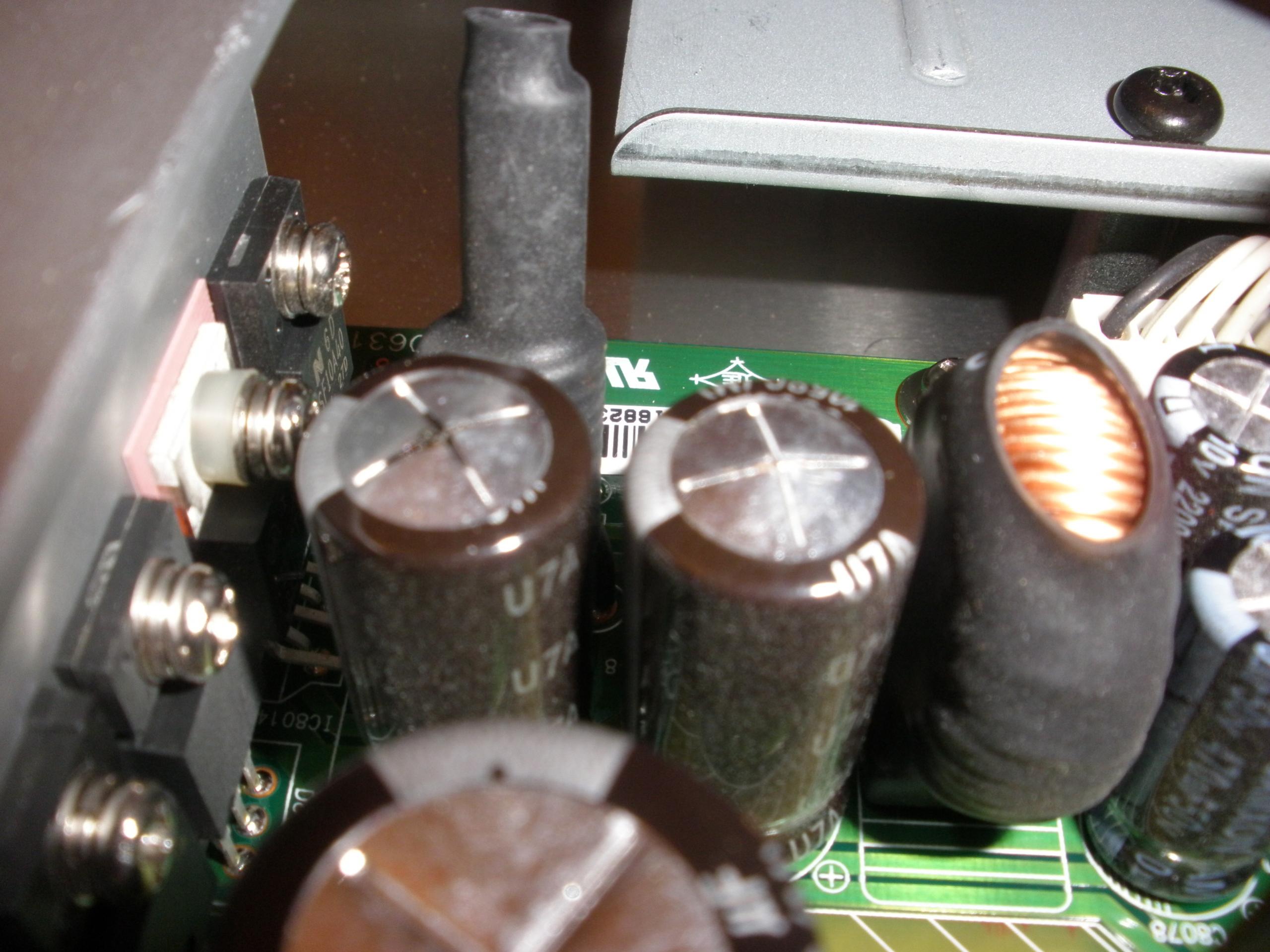

no one had those caps except and old amp laying around. took some speaker wire, pulled all the copper out, used some spare caps with longer wire, soldered the extension, used the insulation from the wire to cover them and presto! plasma tv works new. I hade to use 75v though, but will still fit in the case. I think this mifgt be better in the long run as Jer and I discovered the same problem posted with other people.
Jer, there is a great job for you here, please think about it and give me a call. this simple repair was estimated at or around 800usd, took me an hour, and i do not work on tvs.
heres the dirty pic, have to buy a pencil solder iron soon.

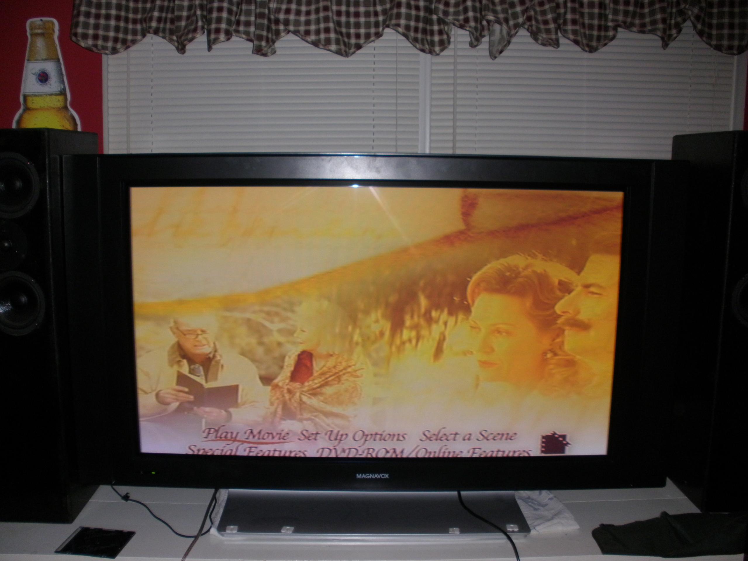

rough pic of the tv, my wife wanted to watch a movie.
