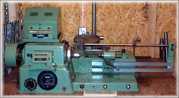

things like the winder shown (stock photo) show up on ebay and in local ads all over the place fairly often. You have to keep looking.
I have one of these Meteor 301 and a newer Meteor that has TTL digital control, with automatic acceleration and de-acceleration, turns counting... got that one from an outfit that sold welding supplies. They had been using it to spool welding wire! It was semi dead when I got it. Turned out to be a fried Vreg. Lucky in that regard. Had the schematic which was very good - the machine came with the original manuals, very good. So, it was obviously long term thermal excess that killed it. Re-did it with a 3 pin Vreg and put in a nice little outboard heatsink on the back of the controller chassis that I "borrowed" from the innards of a CRT computer monitor. Runs dead cool now.

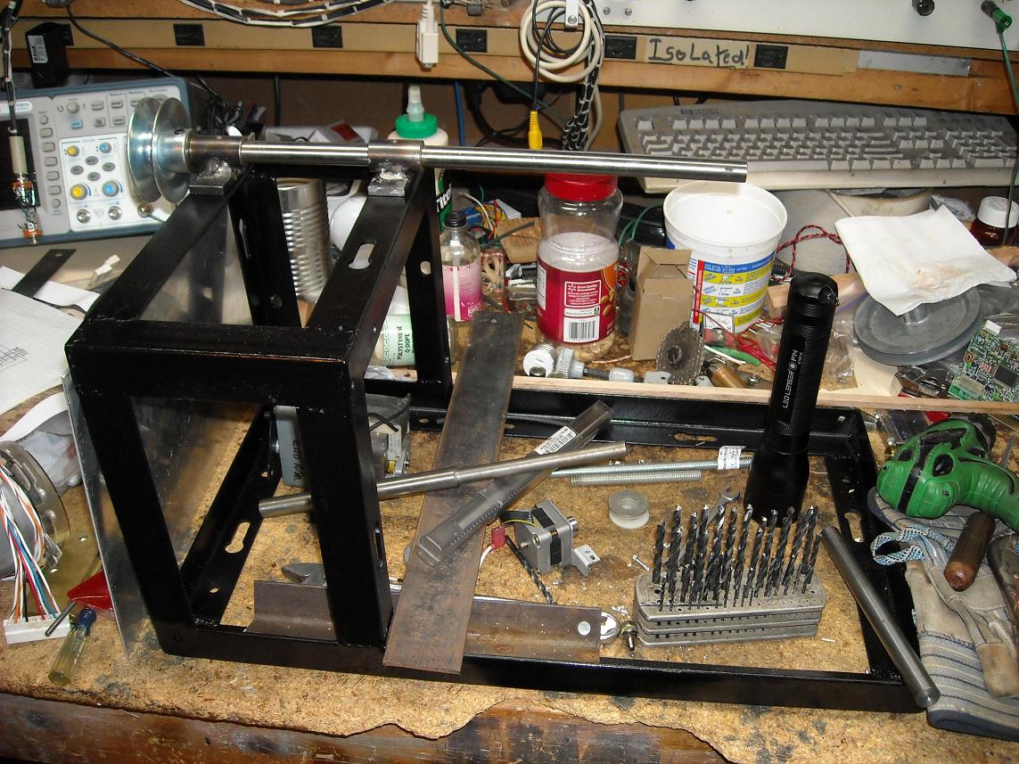

If this works out, I hope to add steppers later and an Arduino to control it.

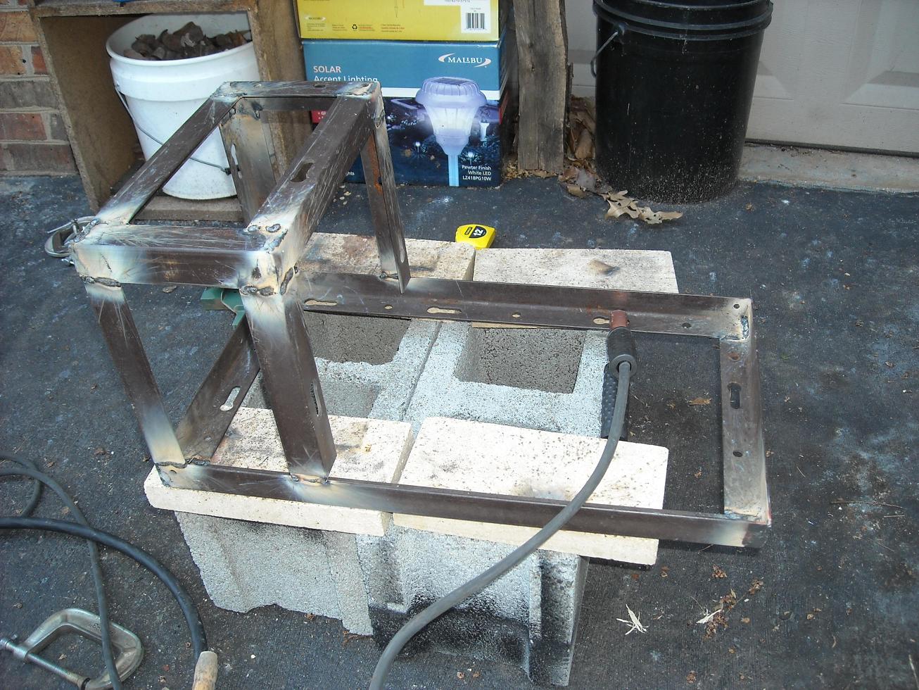

I welded the basic frame welded this morning and need to do grinding clean up now.
Unfortunately for the project, nice weather is here (supposed to hit 65F/16.3C today) and the sun is out so I will have to work in the yard.
How big of a Stepper?
I've been thinking about driving the spindle and was originally going to use a 240r/m gear-head motor.
However, I have was rummaging through one of my bins and found a stepper that appears to be a NEMA34 size motor.
It is a Step-Syn by Sanyo Denki rated at 1.7V 2/4A, 2 degrees/step.
Measured inductance is 2.35mH.
It has eight leads which ohm out to four pairs so it is most likely could be configured as either unipolar or bipolar.
Does anyone have experience with stepper motors that can tell me if this looks like an appropriate size motor to drive the spindle?
