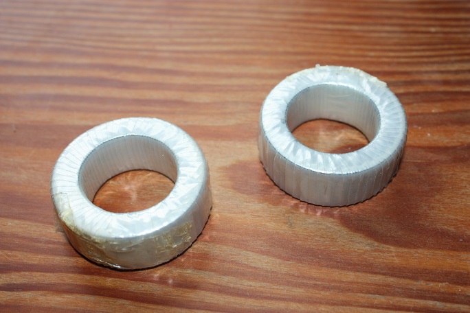

the reason I posted about it is that I just rewound a small crosover toroid
it was 'scatter wound', as usually used with toroids
I carefully rewound it using the same wire
looked quite neat, but ended up with only 2mH, instead of the 4mH it had before

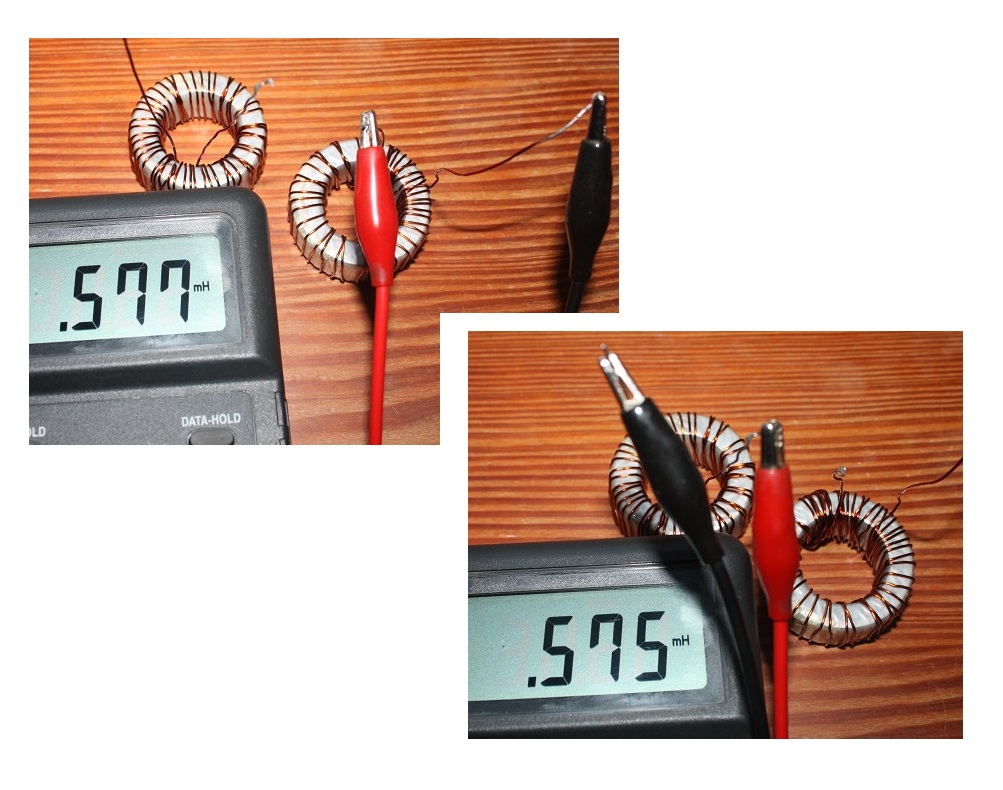

I now decided to forget about close nice looking winding, but instead focus solely on tightness
first 'layer' is now actually two 'rounds' of winding
but no doubt a toroid is different
a tighter winding raised the bar from about 0.50mH to 0.57mH
doesnt look like much, but is still 14% higher
but only need to squeeze it with two fingers to get it to 0.6mH,
so I expect the first winding will increase further once the second winding comes on

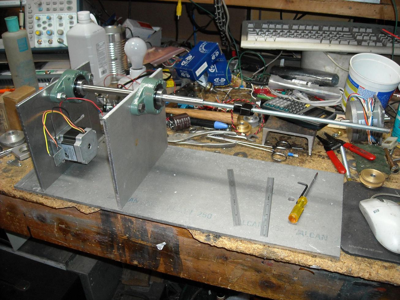

Work on Coil Winder
I've had a little time to get back to the coil winder. I completed machining the main (belt) drive mounting plates and bearing support. Next will be the angle brackets to hold the vertical walls to the base. Then the wire feed traverse. I hope to have enough room for the power supply and electronics inside the housing.
Warning that it also increases parasitic capacitances and proxi effect, both of them prejudice high frequency performance. :-D
