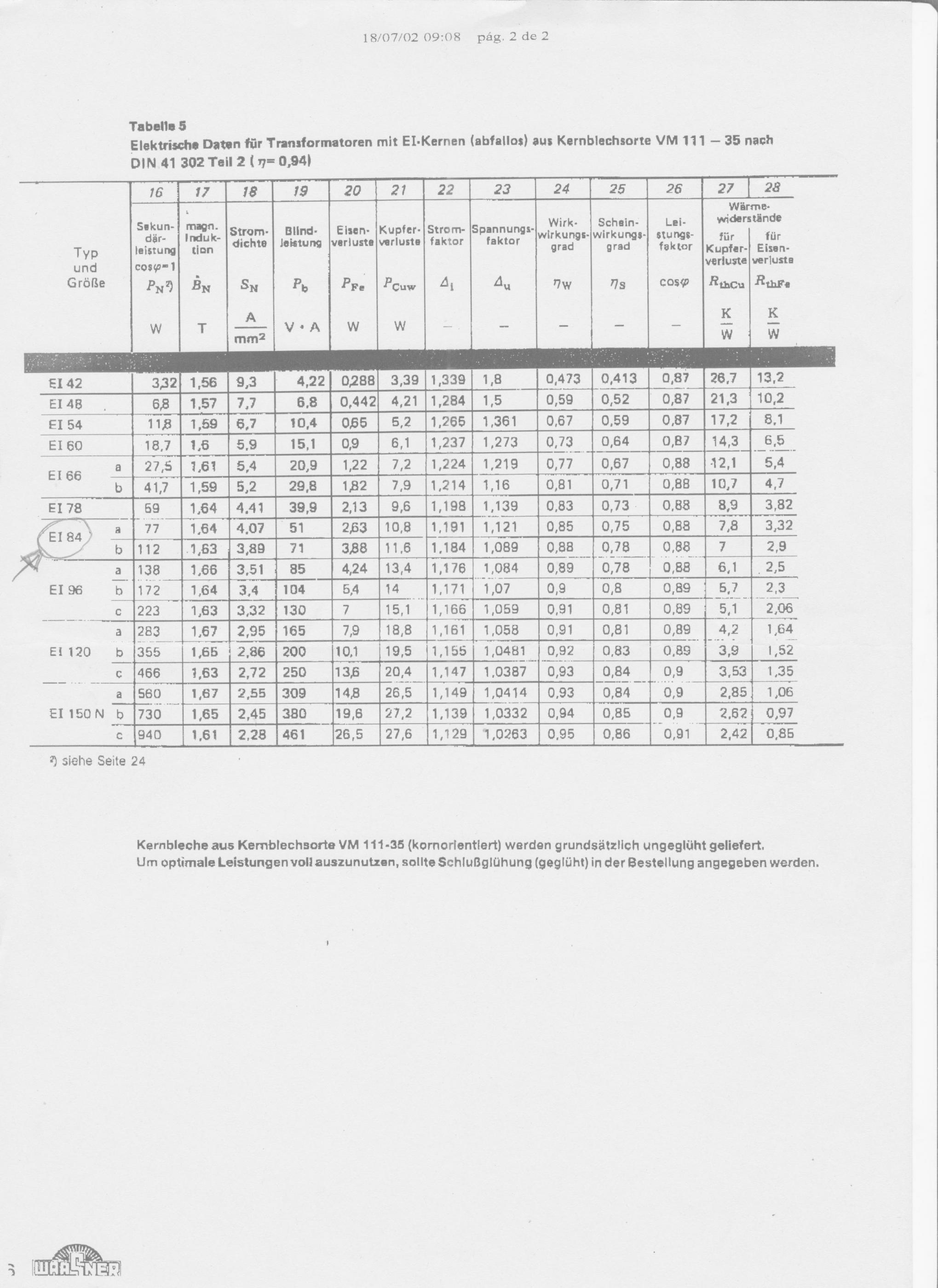

Well, this is my core...does it help ?
Your core seems excellent, I think to have an almost win-win design, only copper loss a little bit high, but don't count our chickens before they hatch...

Here is the complete calculation, counting on performance of your core
Uac = √(P Zp) = √(10 x 3000) ≈ 173 VRMS
For your core, stacking factor is 0.95, so
S = 2.86 x 4.3 x 0.95 ≈ 11.7 cm²
l ≈ 17.2 cm
Supposing now Bac=8000 Gauss, Bdc=6500 Gauss
Np = (Uac x 10⁸) / [√2 π fo S Bac(max)] ≈ 2080
Ns = Np √(η Zs / Zp) ≈ 102
Bdc(max) = [4 π μ Np i(DC)] / (9 l)
We have i(DC) = 80 mA, so
μeff ≈ 481
Lp = (8000/6500) (4 π μ S Np²) / (9 l x 10⁸) ≈ 24 H
Mean turn length, with correction for rounded corners is about
lm ≈ 188 mm
Then, for Φp=0.25mm Φs=1.05mm
Rp = ρ Np lm / (π rp²) ≈ 135 Ω
Rs = ρ Ns lm / (π rs²) ≈ 0.38 Ω
So
Ploss [%] = 100xRp/(Zp+Rp) ≈ 4.3 %
Sloss [%] = 100xRs/(Zs+Rs) ≈ 4.5 %
Not bad after all

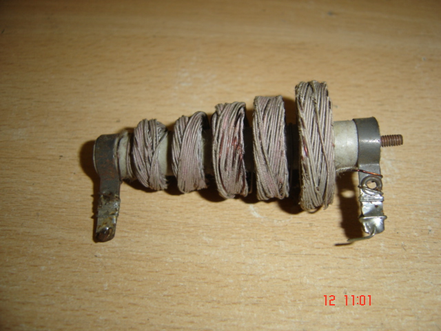

Yes, but in the next time I'll also use horizontal partitioning, say, like the RF choke in the photo.
