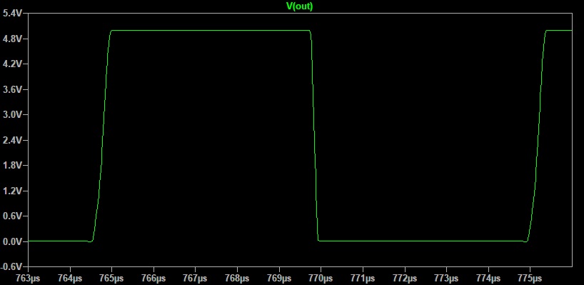

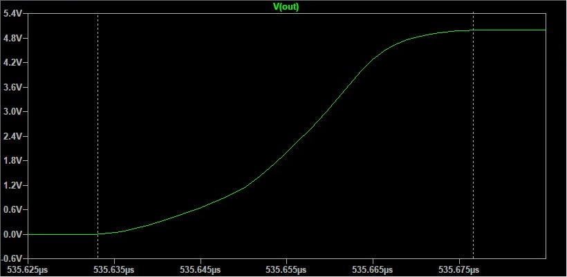

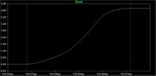

15 mA current spike is not reflected to the output and 40ns to get the output stable is fast switching for 192kHz sample rate.

That plot of yours don't show the current shoot though, so it's worthless....
And those 40nS of yours is a looong time, errors in the time domain also creates distortion....

Those 40 ns are not time domain errors, they are a constant delay at switching time, simply a smoother output wave, easier to be integrated, that's a benefit.

Different rise and fall times plus noise on the mosfet drivers power supply equals time domain errors. Basic knowledge.

Again, there are no time domain errors as you can see in the output plot, nor ground bounce (typical of CMOS tiny gate) neither ringing. It's almost a perfect square wave with rounded angle, that's a benefit.
