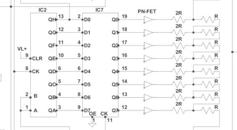

Another difference in the resistor network is Soekris use LVC shift ic with 4V and Ares uses VHC with 6.9V. I wonder if that gives a difference in sound.
The LVC types have lower output impedance and are faster, while the VHC can tolerate a little higher voltage, although 6.9V is pretty close to their absolute maximum.... Can't see that by itself it should affect the sound much....
Do you know the resistors values on the Ares ? Probably higher than mine.....
It's all a question about compromises, higher R-2R network resistance means more tolerance to driver impedance, but also higher noise and higher switching feedthough.
How about adding a mosfet after the LVC logic? Like FDS8958...

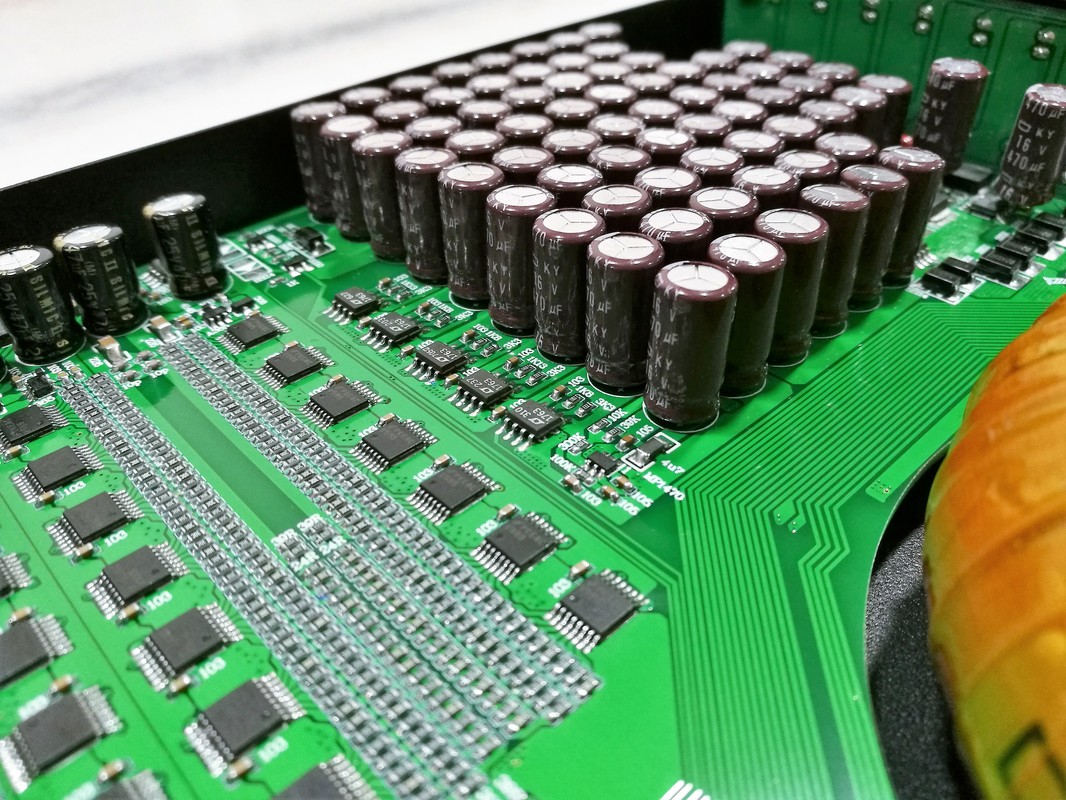

So what is the function of the large capacitor bank? Is it for vref?
I did a quick check of the inside earlier, some of the rolls of cap bank are for each of the five lt1763 (1.8v, 3.3V, 5V) post decoupling. I think there is one rolls for pre decoupling into those lt1763. And one roll for pre regulator of the resistor network.
Note image is from Ares homepage. If you check the lt1763 from datasheet, you can almost tell where Vout goes to.
