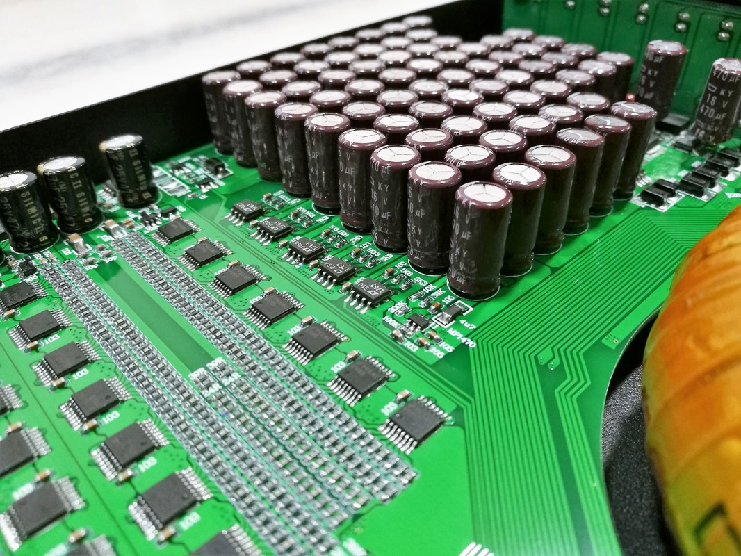

Agreed, I don't think I've seen any DAC with an isolated supply for its clock oscillator no matter what the price. This Denafrips looks like a bargain, the cap array certainly impresses me :D
damned, they did the babel tower caps on an horizontal plane:D ! Sacrilège !:eek:
Seems all those caps are more for the photographs and audio porn than mandatory for the sound !

According to someone, the Denafrips is a 31 seg. 5bit string + 11bit R2R design. However, it has considerable glitches. On low level signal, the glitches could be as high as 10mv.
That doesn't looked like the Ares as it has 7 shift register on each row while your photo shows 6. The Ares spec also claim to have 20bits. Could it be the older version of Denafrips dac?
" Ares employees 20BIT R2R + 6BIT DSD (32 steps FIR Filters), native PCM & DSD decoding with 0.01% precision resistors."
Could be others. The designer has several similar products. A 20bit R2R DAC is not easy to maintain its linearity due to insufficient resistor accuracy.
