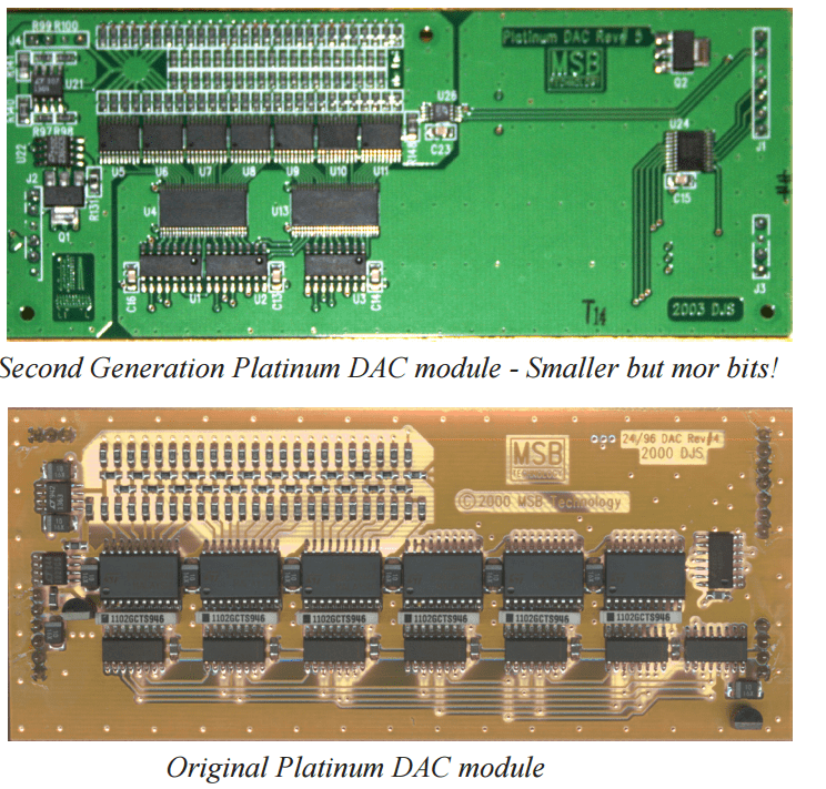

I did not know that MSB uses mosfet pair as the switch, the only picture I saw shows a battery of 374 or similar (attached).
I have a picture of a board, no labels, though it was MSB, it seems to be Rockna, which started out using MSB modules, then designed their own, their RD-0 use mosfets, their RD-1 use logic chips....

Btw, can't we agree on that MSB Tech is the reference ? And they use logic chips. And btw, Rockna is using the Si570....

Don't remember, just remember I have seen them.... I wouldn't use the EM6M2, find one with a higher Vgs to reduce the shoot through.
Yes, MSB should be the reference, although I have not yet listen to one of their DAC.
The problem using tiny logic, IMHO, is that they are too fast, with a serious risk of ground bounce and ringing, that finally means noise.
