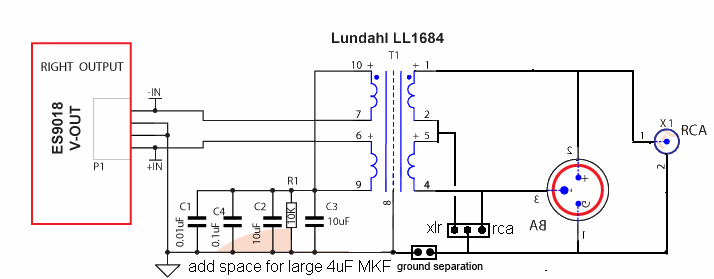

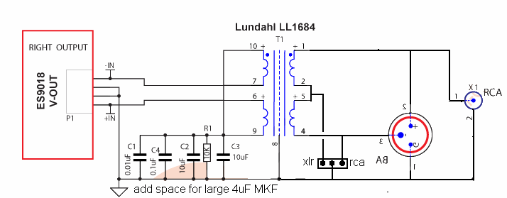

Also the ground should be connected in a different way
Please tell us wich way then .
see previous
Pin 1 on XLR connects directly to chassis - always.
Pin 2 = + hot transformer
Pin 3 = - cold transformer
Let the secondary of transformer 'float'.
Z
see previous
thanks but I am not sure I understand that Square painting marked XLR and RCA.

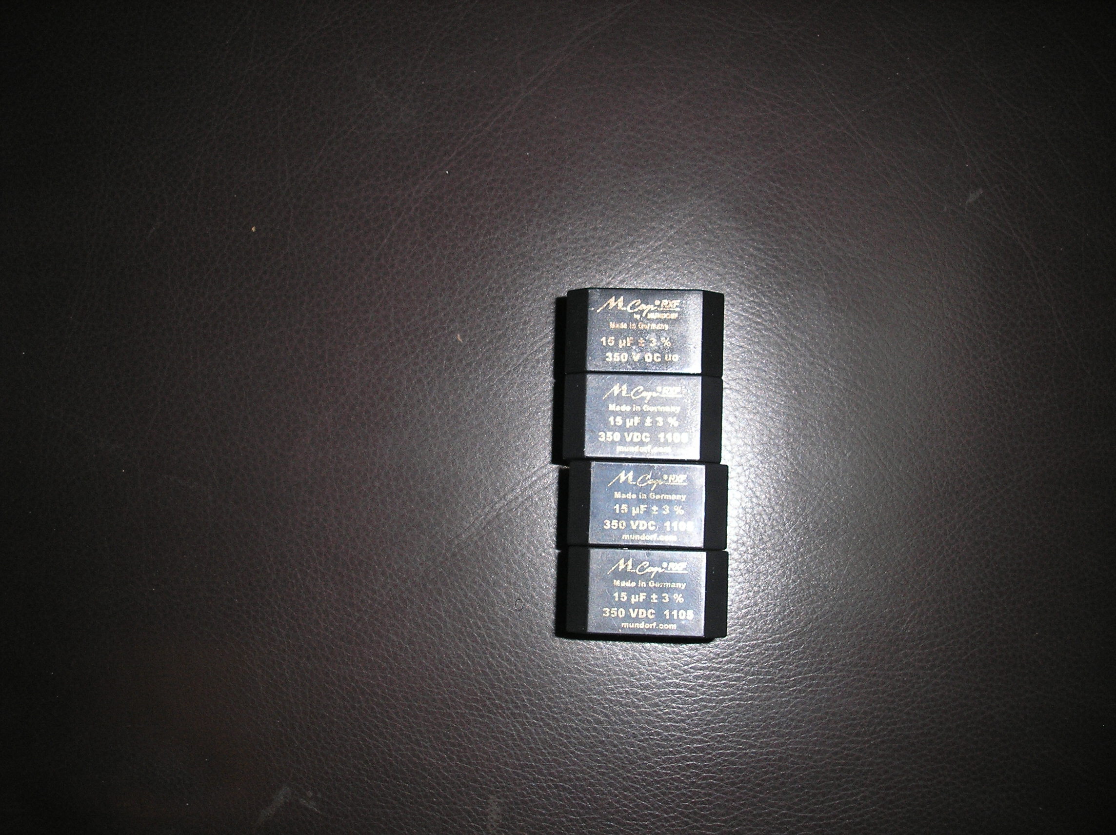

I have tested bandwith with lundall ll1684 and 2,2uF Jantzen +10k to ground.
Input 192khz coax, output 47k resistor.
8Hz to 35kHz +/-0.2dB
Nice, if you add 10uf it will probably go lower.
Yes, see this postYou say the original lmv7219 is not good ?
Was not stupid when I bought this after all
Mundorf MKP is not stupid
I still need to play around with different caps and bypass caps with the LL1684.
