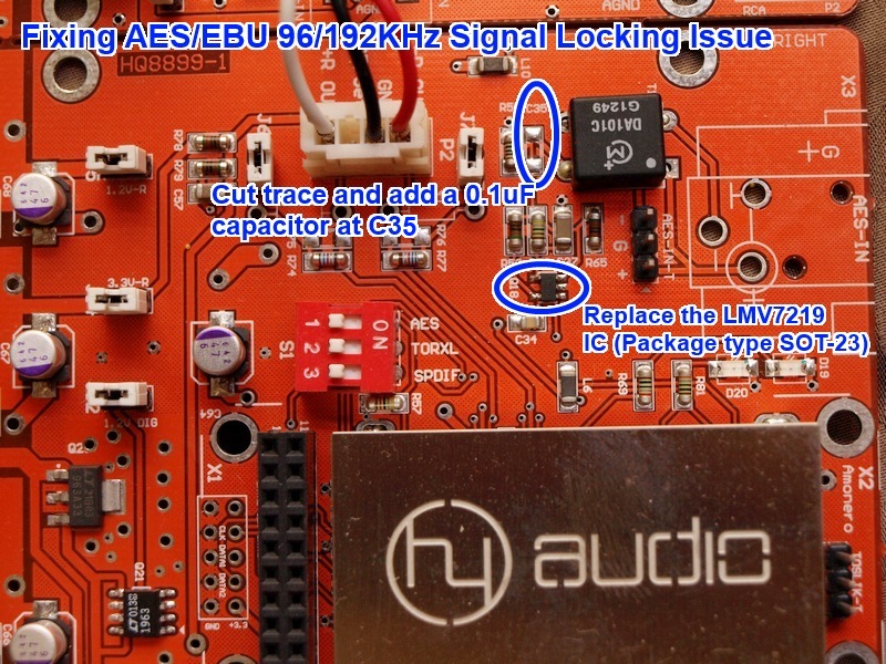

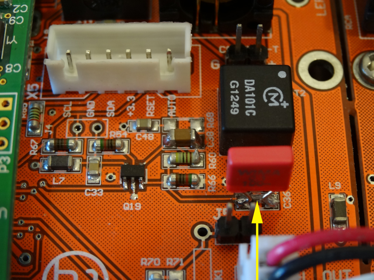

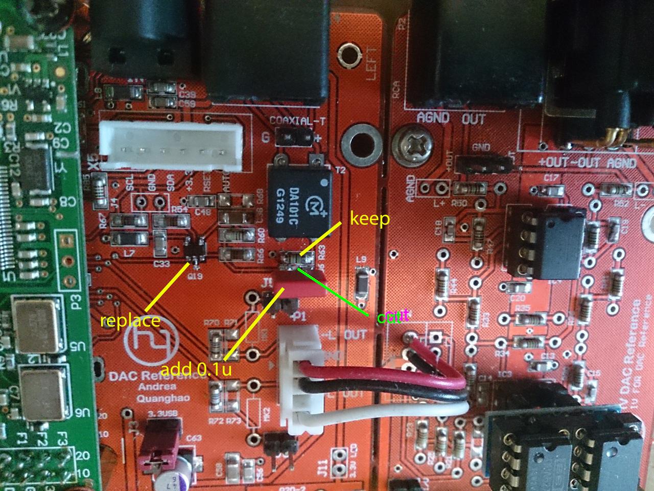

- Do not not forget to cut the layer before placing the 0.1uF capacitor....Replace the tiny defective onboard LMV7219 with an authentic LMV7219 (keep the 75R resistor and add a 0.1u capacitor after the input transformer) will solve the problem. You may also replace the LMV7219 on the AES input as well.
Hi Guanhao and Andrea ,- Do not not forget to cut the layer before placing the 0.1uF capacitor.
It might be interesting to have changes (cut , capacitor , .. and picture ) for AES input (Q18).
Yes, I did
Based on misterwolf's findings, the solution for AES/EBU stated in this picture should work.

If you are using the DAC module without I/V jump you can follows my suggestion to eliminate one op-amp on the signal path- Do not not forget....
I have received today the DAC module and I have the same problem.
Lock only until 48KHz on COAX and AES/EBU input.
I have ordered a new pair of LMV7219 chips.
