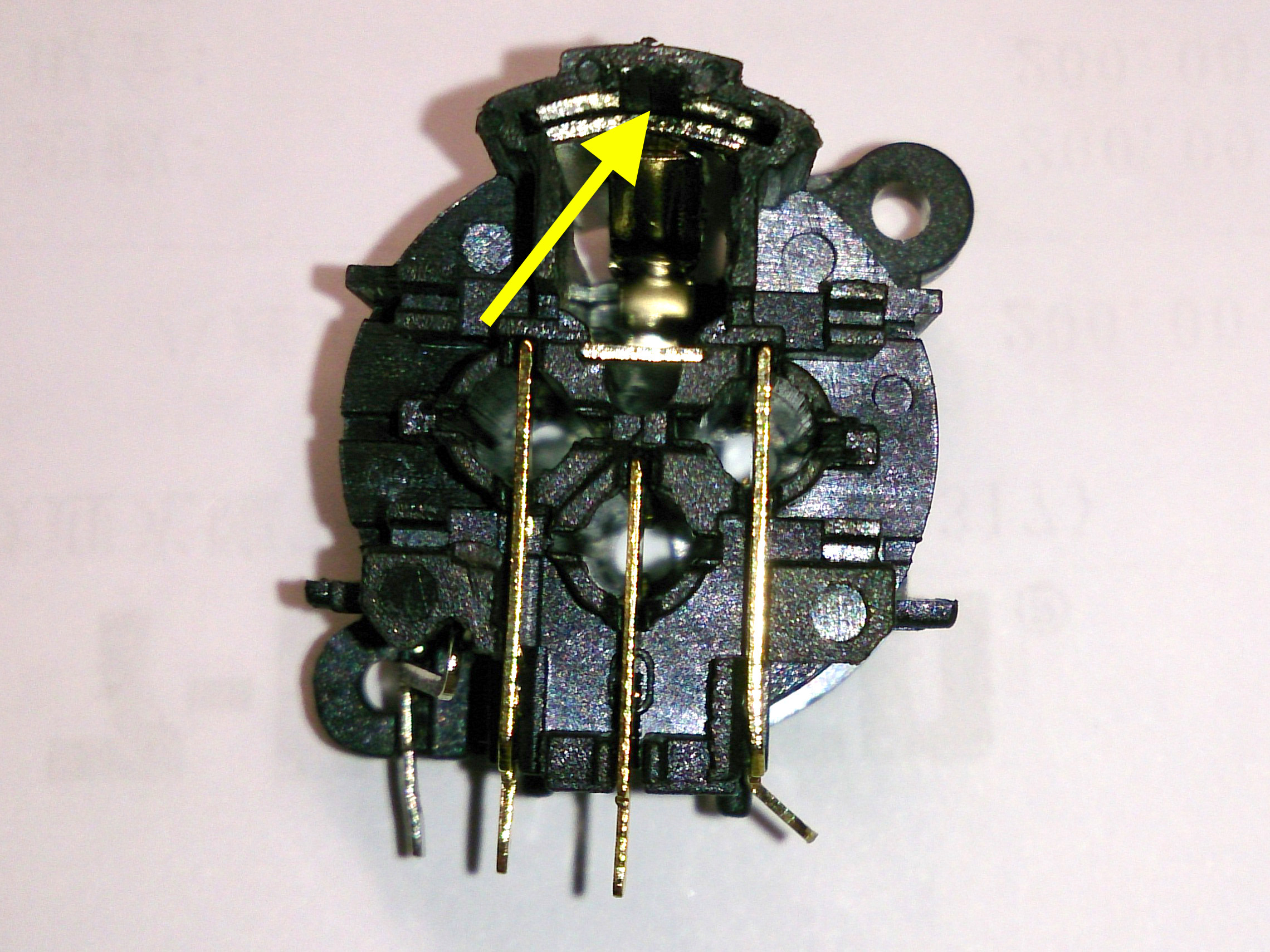

Noticed that you have cut the AES push pin... without the designated tool, it really is a pain to take out! I've decided not to put it back after it was out.
Consider using an EMI filter to suppress power noice?

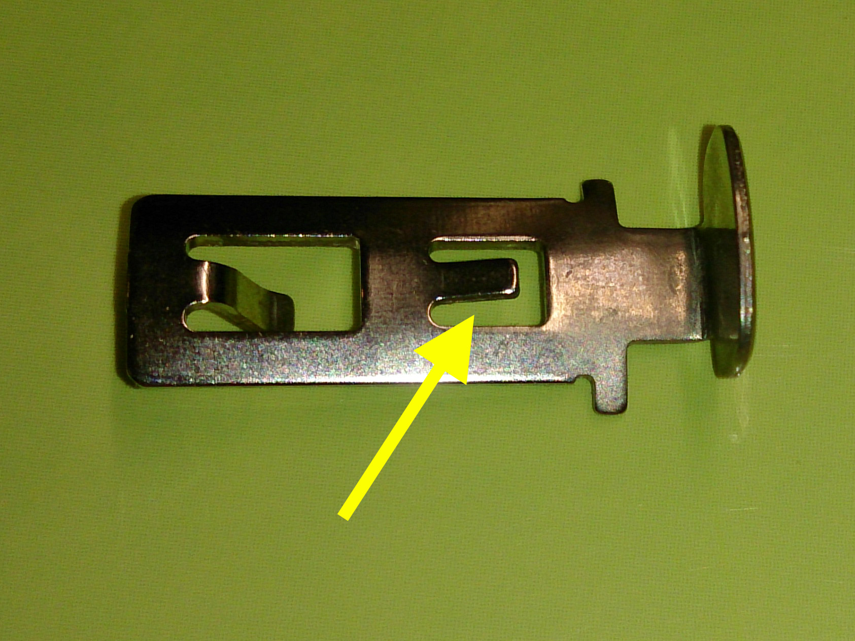

I am thinking of some mods but will require the back panel rremoving. I presume I would need this "tool" to remove the AES push pin if I want to remove the back panel? Where can I get this tool? Thanks.
Insert a small flat screw driver here and keep pushing downward, then pull the pin out from the front.
Thank you.

You have to insert the flat crew driver deep until you reach this ledge and press it downward so that the pin can be pull out from the front

Just try-in only, the AES pin shall be put back once the wiring is complete. Some folks say EMI filter does no good to SQ, may try compartmentalization later.
