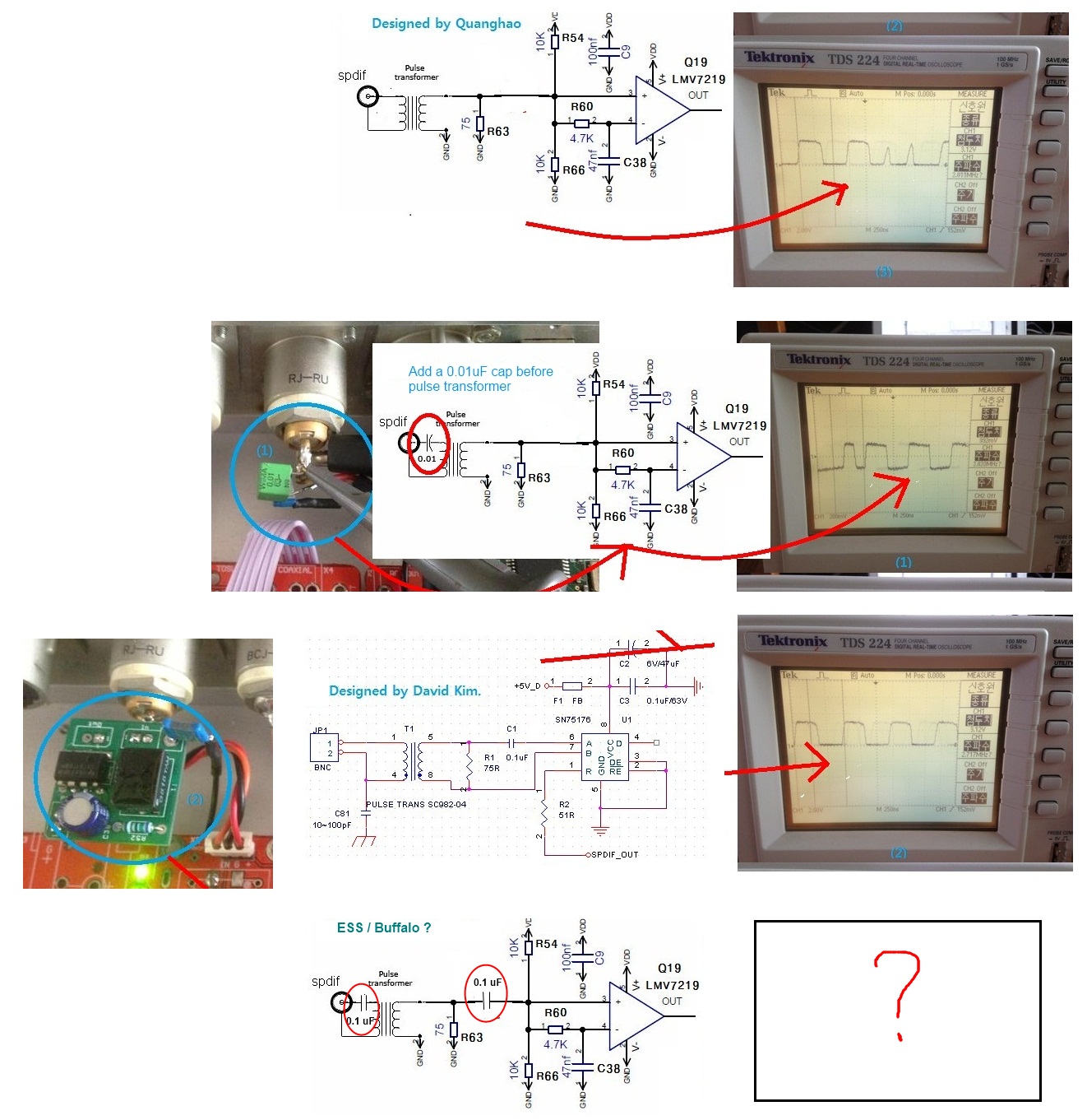

Regarding the S/PDIF >48KHz locking issue, I think kgkim has found the reason
#1070
Through oscillator, it seems the stock circuits does not produce proper TTL pulse pattern for ES9018, causing widespread of incompatibility issue. Probably the production board was not thoroughly tested with 96K/192K S/PDIF source before mass production.
Can someone verify the output of LMV7219 with oscillator, with various passive components combination? This might the way to figure out a working solution.
#1070
#1070

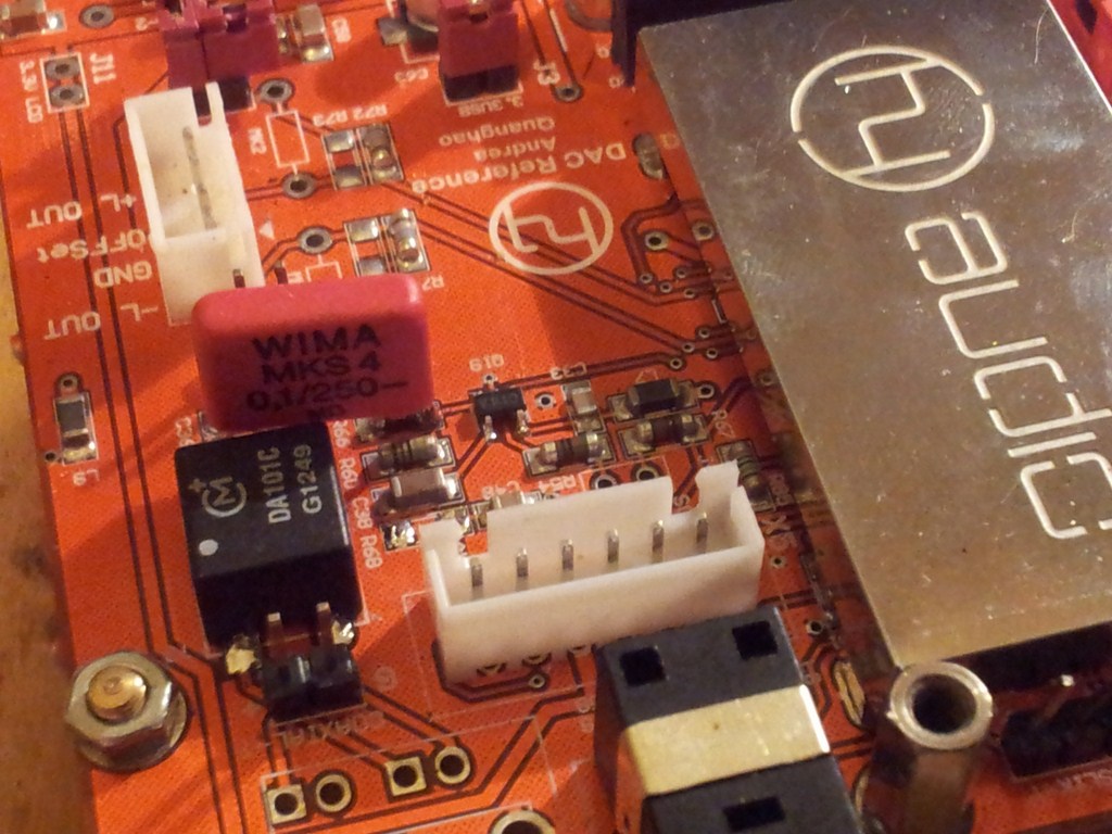

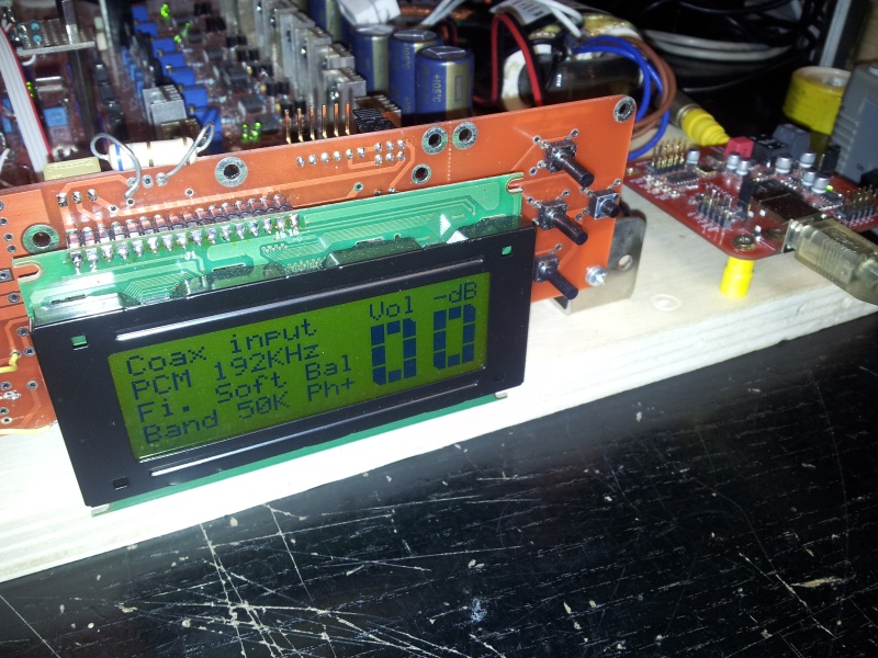

So you say a 0.1uF before the spdif transformer will solve the problem for any source ?
coax spdif at 192KHz
Actually I have only the first release of this DAC, I should receive soon another board.
In this first release was present only a capacitor before the op-amp on spdif signal.
Here is playing with XMOS USB-SPDIF source at 192KHz without problems.
I am using this old DAC module to test the new firmware and controller working with 4x20 LCD.

You need to add for both these input the capacitor after the spdif input transformer.
2uF MKT is good, there is a pcb jump to cut called Cxx, I don't have the DAC module now to indicate the xx numbers.
Based on kgkim's findings, the TTL pulse looks slightly better but I'm afraid it is still not enough. Otherwise he would not design his own circuits to overcome the issue.
I'm also wondering would substituting Murata DA101C pulse transfo with Newava S22083 make a different? Seems unlikely as DA101C works in other DACs.

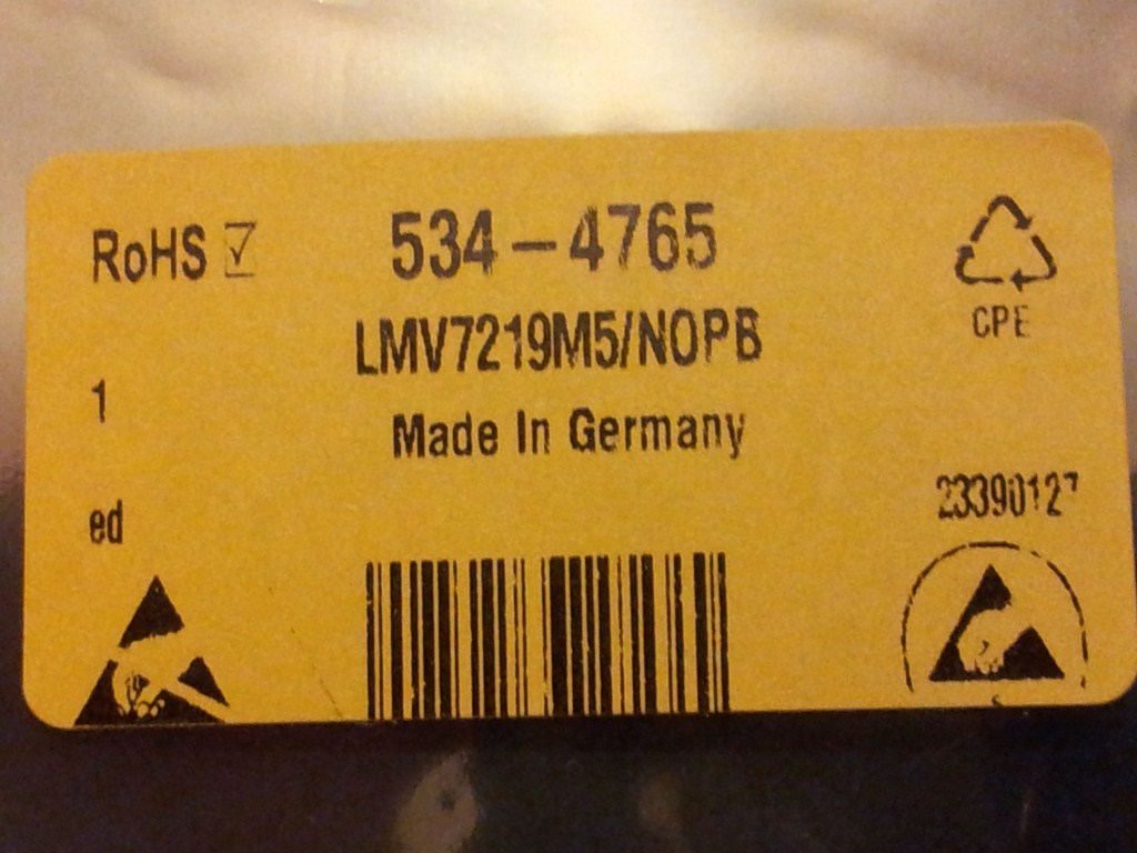

Hi guys!
Problem solved
Lmv7219 replaced with that acquired from rs-components.
Now locked from 32khz to 192khz without any glitches.
Tried with two input configurations:
1) input transformer + 0.1uF and 75r to ground
2) no input transformer + 0.1uF and 75r to ground
Tried both configurations with 1mt TV cable and 0.5mt tasker c123 cable.
Tomorrow I'll replace Lmv7219 of AES/EBU input and go to recording studio for the test...

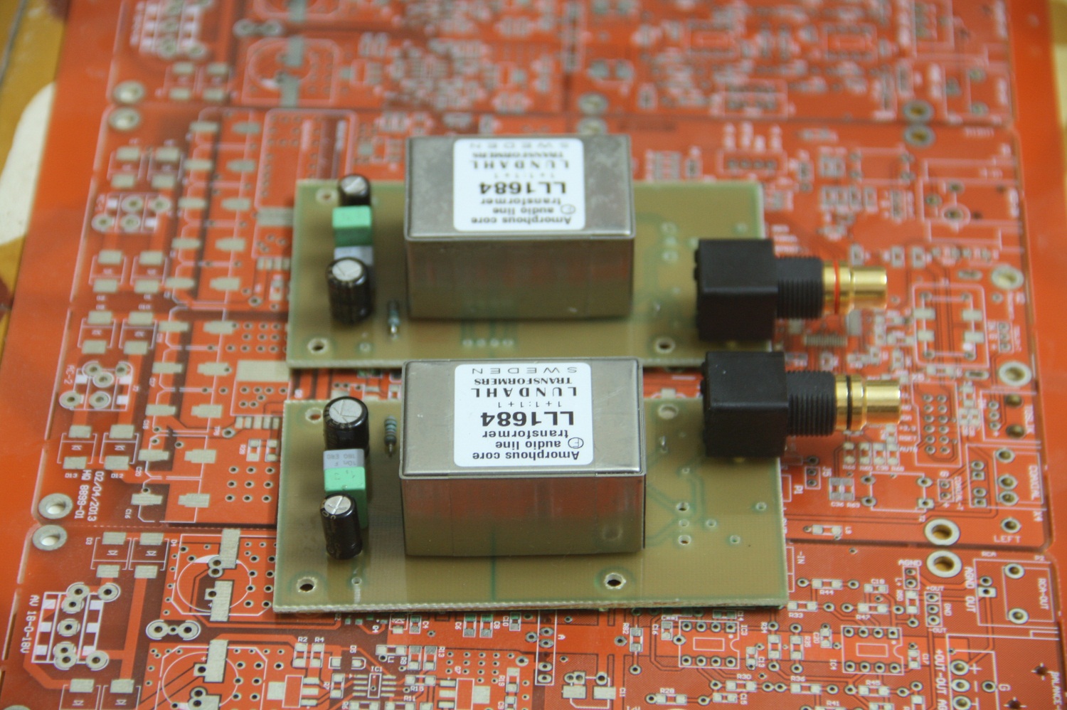

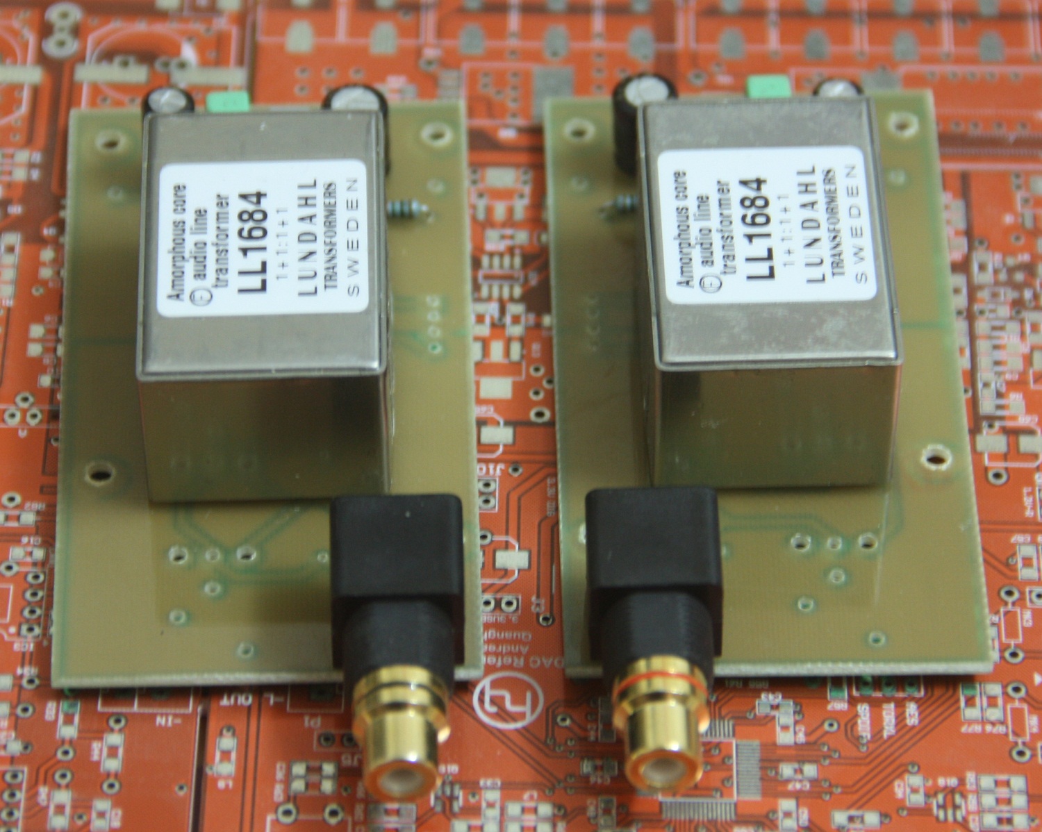

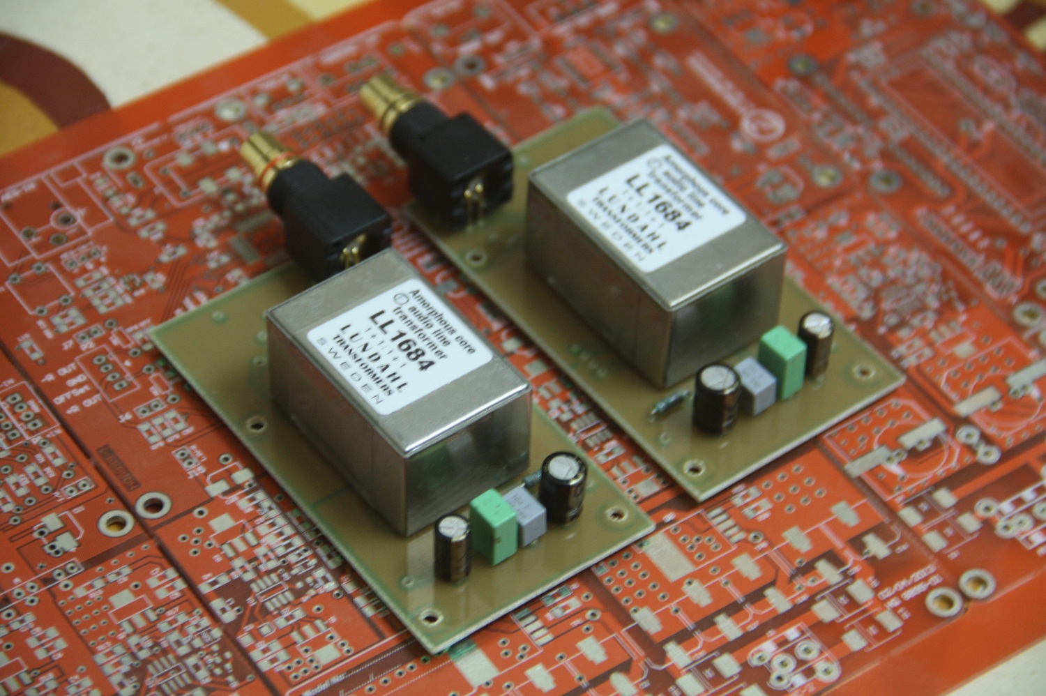

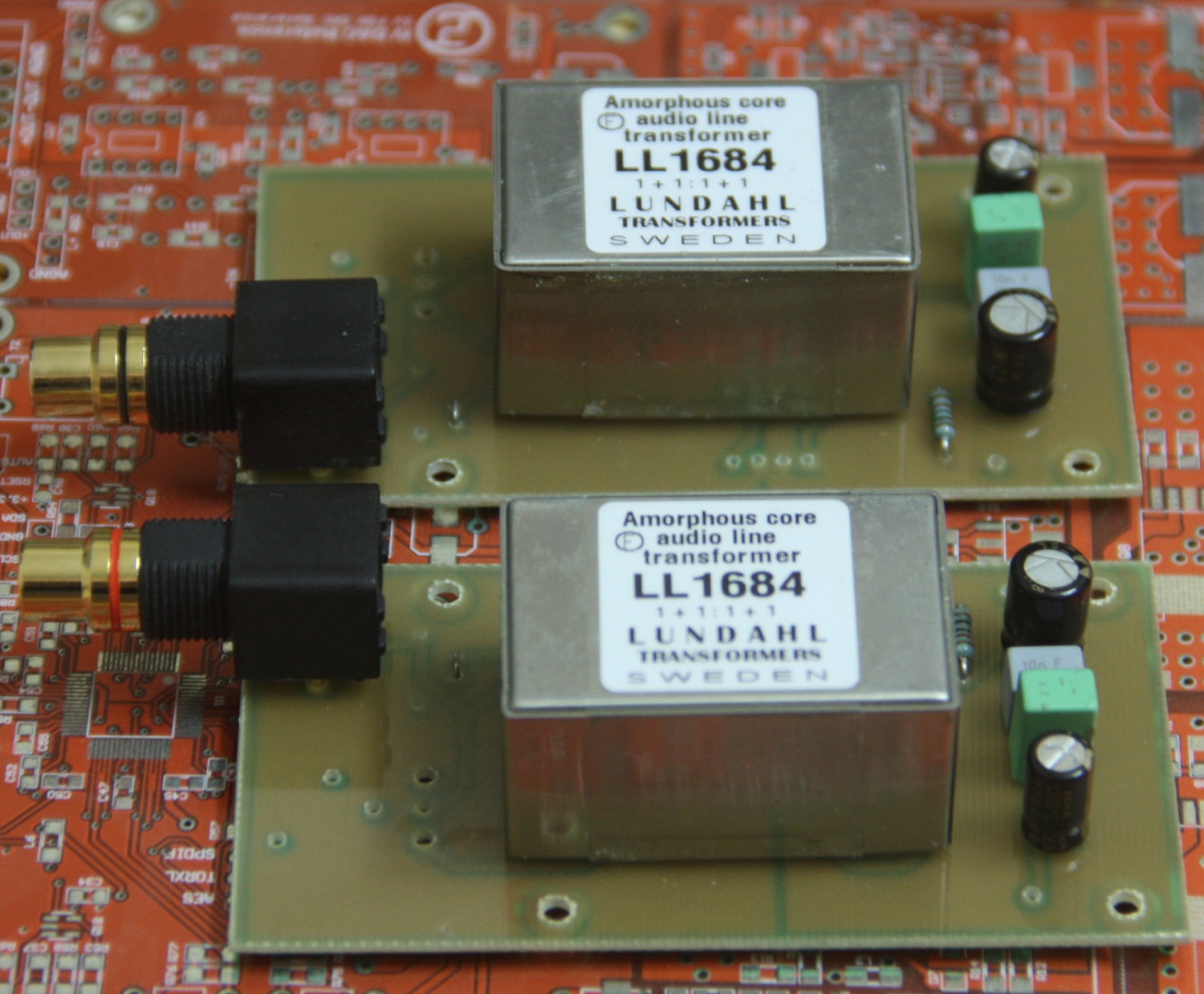

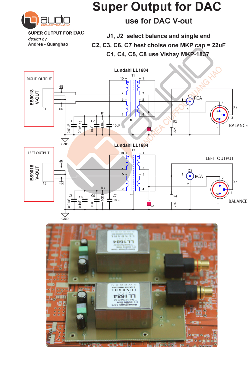

Super Output for DAC
below is the circuit diagram for DAC output, use the LL1684 transformer, can use the V DAC output. For example: ES9018 .....
And some PCB pictures, invite you to watch!
