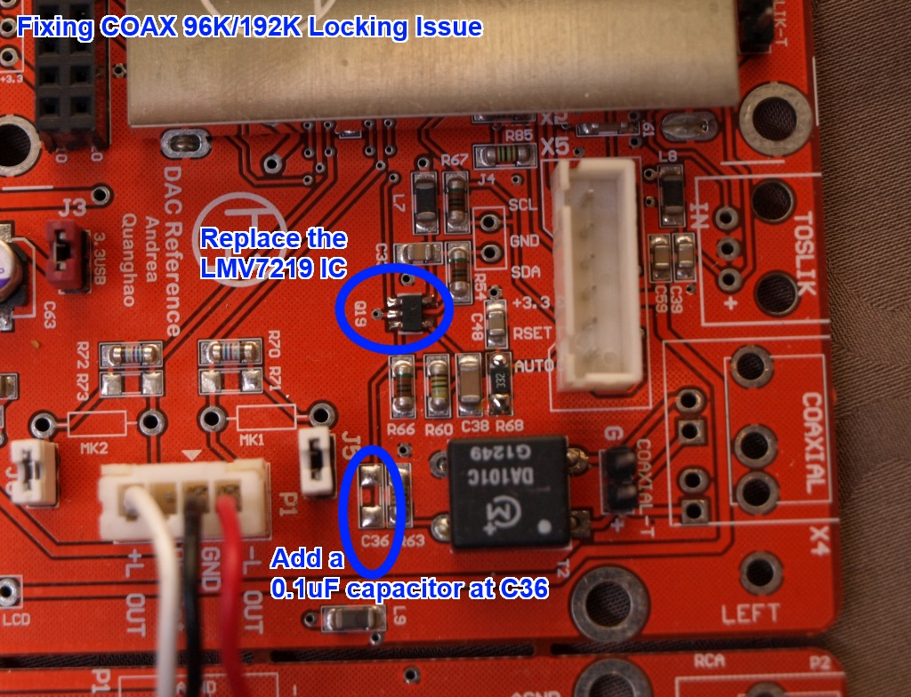

Problem solved :D
Lmv7219 replaced with that acquired from rs-components.
Now locked from 32khz to 192khz without any glitches.
Tried with two input configurations:
1) input transformer + 0.1uF and 75r to ground
So the conclusion is...
To solve the S/PDIF 96K/192K locking issue, we have to:
1) Replace the defective LMV7219 comparator IC.
2) Add a 0.1uF capacitor at C36.
Am I right?

I'm back from the recording studio.
I confirm, after replacing the lmv7219 and the addition of the 0.1uF capacitor, the excellent locking of AES/EBU input up to 192kHz.

So in addition to replacing the Lmv7219, do we need to do one of the following?
2) no input transformer + 0.1uF and 75r to ground
