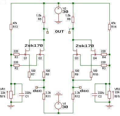

stefanobilliani said:Yes , the jfet in parallel increases the S/N ratio .
I was meaning "does the use of Jfets bring particular advantages over the original Mosfets?"
Cheers
Andrea
stefanobilliani said:This is how I modified the cascode stage with Jfet :
Very nice Stefano,
has you tried this circuit already?
I would omit R1-R4 and going to 2SK389 for better symmetry.
Regards
Adam
acaudio said:has you tried this circuit already?
Adam
Of course both .
I have forgotten to mention that IMHO the circuit plays better
with a load between the outputs, say 10k ohm .
Cheers
Andrea
They are quieter.

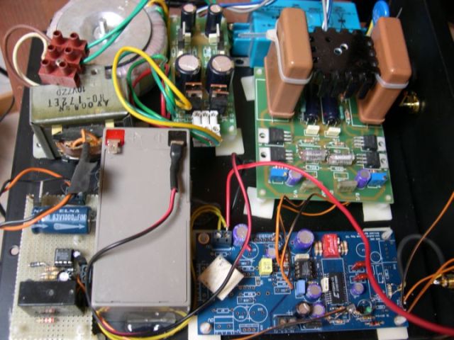

I used four big silver mundorf caps (2,2 uF) parallel with four 2,7 uF Hovland musicaps in the output.
These big caps are spread all over the cdp because there is of course no room. I didnot expect much from it with the 16 long leads all over the player. The layout is a mesh but the sound is good and I hope will become better if everything has "burned in".

commstech said:My DAC consists of 2 x TDA1541 in parallel. With the Idac of two TDA1541, is the D1 a suitable candidate for IV stage? Any adjustments to make?
IMHO the D1 doesn't care that much about the DAC's current.
Provided you trim it for the correct voltage on the iout pin of the DAC (0V for the TDA1541A) and use a adequate value for the drain resistor of the "sensing" Mosfet (where the I/V conversion is actually made) you should have no problems at all.
Cheers
Andrea

Dear Andrea, would u be kind enough to point out to me this drain resistor that i have to take note of? R6 (1.5k) in the schematic?
I can confirm to you that the D1 works perfectly with the 1541A .
Just trim the mosfet source point to O volt before connecting the dac and than do the final adjustments .
