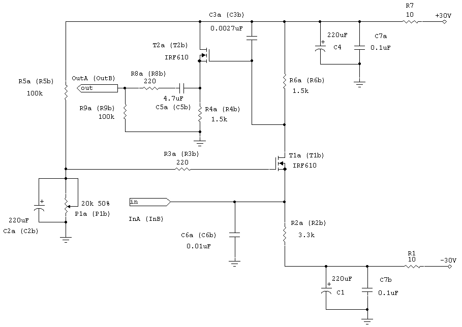

D1 I/V Stage Finished.
I already have a parts list, the schematic is from pass D1 DAC and the pcbs will have a parts print on top in white for the placement.
Parts list for D1 I/V
16 x Resistors are low noise 1% .25W
2 x 20K vertical multiturn trimmmer
2 x 220uF/50V Panasonic FC
2 x 220uF/16V Panasonic FC
2 x 27nF silvered MICA
2 x 4u7, MKP-QS Audyn Cap
2 x 10nF MKP WIMA
2 x 100nF MKP WIMA
4 x IRF610 IR
Parts list for PSU
4 x diodes schottky or normal
4 x 22n ceramic caps
2 x 1000uF/50V Panasonic FC
4 x 22uF/50V Panasonic FC
LM317
LM337
4 x Resistor
This is the schematic of the D1 I/V Stage I use.

up and running
Thanks Promitheus. The thing is working but still i don't want to judge it as it's assembled with scrap components, just to understand its potential.
At this moment i cannot understand where the lackness of bass that i can hear is coming from the Digital side of my converter or if it's a signature of this output stage.
Probably a mixture of the two !
Bye and thanks.

Re: up and running
Paolo
Probably for the lack of feedback , but the bass is all there . BTW with a great clock generator the bass changes its face.
Usually the op amp with great feedback loops , pumps up bass and high ( as a perception ) and it takes more than a biscuit to feel a clean and extended bottom end
