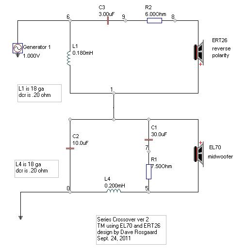

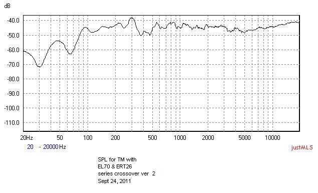

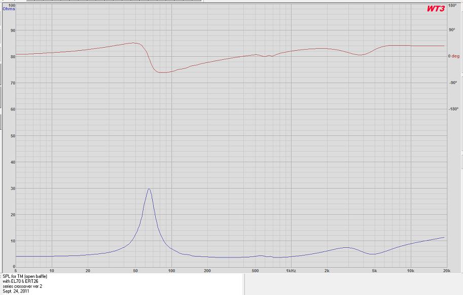

Apparently, the stock of EL70 is virtually depleted. After contacting Bob at CSS, he agreed to making the crossovers which use the EL70 and ERT26 available.
Here's the series crossover, impedance, and spl for the TM.
The impedance plot shows the woofer on open baffle (no box loading)
SPL measurements below ~500 Hz are affected by floor/room bounce, and are far field only.
(I'll post the TMM version in a following post)
Very interested in hearing more about the availability of this crossover! (Bob?, are you out there? )
Any chance this will be shared? Any MTMs as well? I've been wanting to build some kind of 2-way with Mark's drivers.
(Previous post has details for TM.)

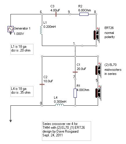

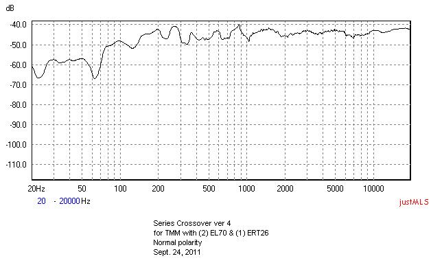

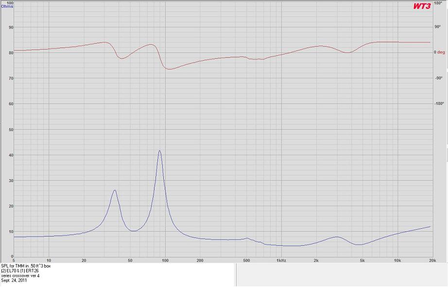

Here is the TMM (or could be arranged as MTM) using (2) EL70's and (1) ERT26
The impedance was measured with all drivers mounted in a .50 ft^3 vented box tuned to around 55 Hz.
Again, measurements made in room, floor/room bounce below 500 Hz or so.
Enjoy!
