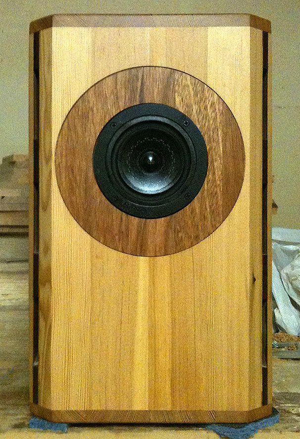

PS: we should be testing Mar-Kel70WT next week (WT = Wide Trapezoid). This box is the result of a situation similar to how PAWO for FE127 came about. Bernie had built me a beautiful surprise pair of Mar-Ken12T. Promblem was that i ended up with 1 more pair of boxes than i had Alpair12. Struggling with how to deal with that, i realized that at 13 litre i could convert this box to fit either Alpair 10.2 or EL70 as long as the slot ports needed were smaller than those for Mar-Ken12 (ie tuned lower). Turns out this is the case for both drivers.
So Bernie has done surgery on the MK12, i'm doing up a custom set of EL70eN, so we should have box assembly this next Sunday.
attachment.php
Teaser picture from Bernie with 1 coat of finish and a fill in driver.
This box can be considered a pre-sage for MT, and NT versions for EL70, and 2 sizes for A10.2.
dave

The trapezodal boxes are spreading out thru the entire miniOnken range.
The original was a necessity of fitting Alpair12 into a 13 litre box. The next one, the uFonkenSET, was a bases-loaded out-of-the-park sucess performance wise.
WT, MT, NT? Wide, medium, narrow. Each successive design trades narrower width, for more height. Obviously the larger drivers won't fit into the narrowist box format.
The basics for the prime size boxes (13 litre, A12, A10, EL70, FE127) are done. A 17 litre for A10.2 (and a 34 litre for 2xA10.2) also done (Don, aka Doorman), is doing beta of the Mar-Ken10.2TT). 9 litre based boxes are next (A7, CHP, CHR, CHBW, FF125wk). An A6P variation should be doable too.
