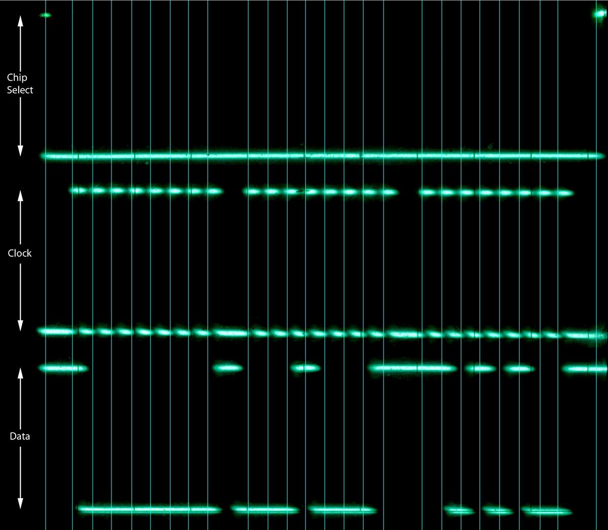

Dr_EM, I will be very interested if you find out what the SPI bottleneck is. My scope seemed to indicate perfect data at the CS3318 pins.
I don't have any experience trying to attach probes to individual pins on parts the size of the CS3318. How is that done?
When I get some time, I intend to find out the maximum SPI clock that works for me. I'm thinking about using the rotary encoder to vary the clock frequency.
mikealanlee, I have not listened to the board yet, but Dr_EM's impression is that it is pretty much like a straight wire. If so, I don't suppose things can get any better. Yes, it is a great project thanks to Dr_EM.
Seems to me to be a SPI timing issue, so you do not want an logic analyzer, you need a digital storage scope trace, so you can zoom into see the clock/data setup/hold timing and compare against the specs.
I have to look at the code, but I think the code is bit banging. Not sure why one would not use the SPI HW features of the Atmel AVR?
In order to probe the chip pins, try to get to via, if you have to use the pins, use a short peice of 30AWG solid wire. I used to do it under the stereo microscope.
The most common reason for avoiding using HW features of uProcs is the difficulty of debug. Very often such features require an exact code sequence to initialise them, that may involve the choice of register values which is not straightforward or other problems really only soluble to an experienced eye, or a laborious 'scattergun' procedure where numerous different values are tried, one after the other.
The more complex and versatile the HW process, the more problematic in use.
Very often a 'bit banging' process, while less efficient than using a HW feature, can be debugged, up and running before the HW's got its shoes on.
Sure I have to agree bit banging can be easier to debug in some cases.
I have used xmega hw spi to control a pga2320 using BASCOM-AVR, it worked first time.
This is the beauty of a compiler with a good & well tested/supported library. Designed so that one does not have to configure at the asm/register level.
Padding wait states is not a recommended way to code certain things, as it does not allow for portability.
One way or the other, having the proper instrumentation (digital scope) can find the problem in short order. You can waste lots of time guessing what the reasons are in your code, for a straight forward hw problem. Of course, having a scope with a protocol decode package, just makes life that much easier. Anyone have one for my Tek DPO4034 (DPO4EMBD). Oh it is only $1,893.19. Have to do a l lot of debugging to justify this s/w.

Just for fun I tried out the Atmel hardware SPI interface again at the lowest speed possible: 125 kHz. Again, as before, I got no sound out of the CS3318 using the 125 kHz clock and the Atmel SPI interface.
I checked the timing for chip select (SS), clock (SCK), and data (MOSI) signals to see if everything is within spec for the CS3318. And, as far as I can tell, all the timing looks fine.
There's about 11 uS from chip select to the first clock leading edge. Data is setup about 4 uS before a clock leading edge, and data does not change for another 4 uS after that leading edge. The final deselection of the chip takes place about 15uS after the final clock pulse.
All this appears to be well within specs for the CS3318 SPI input.
The next step is to check the timing right at the CS3318. The physical precision here is a bit more problematic for me, though not impossible, because I'm using just a standard soldering iron with a fairly large chisel tip and no magnification.
I think I'll wait for Dr_EM's results before attempting to solder 30 gauge wire to pins on the CS3318.
