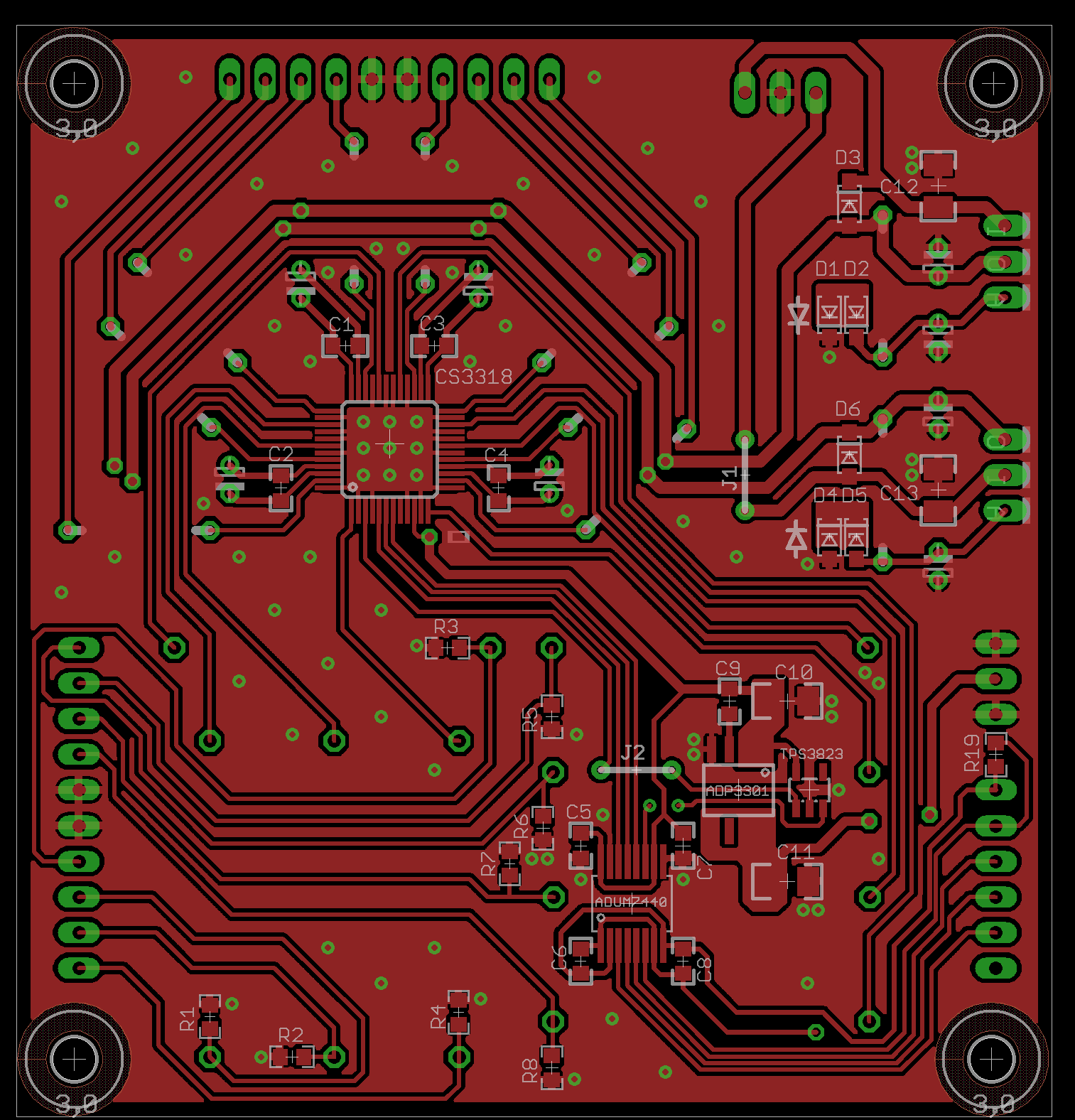

CS3318 PCB Layout
Hi dhalbakken, the final version has the error corrected and works fine when assembled as per the BOM, no modifications. I still have the 2 spare PCBs and attach the final artwork.
The only aspect I'm unsure about is the speed of control over SPI. I've now tried it with hardware SPI from a PIC microcontroller as well as bit-bang and I cannot deliver SPI faster than about a message every 50mS, only the slowest SPI setting (clocked by TMR2 module) works with any of the 4 available clock relations (CKE and CKP bits). I don't see how this can be a hardware/PCB issue and looking on the scope at signals arriving at CS3318 pins the clocks are perfectly defined, no overshoot/ringing, so I'm still stuck on this issue. Even stranger is that my DAC PCB uses the same control with the ADuM isolator and works flawlessly at all SPI rates. :confused:
Hopefully someone can shed some light on this so I'll attach the PIC code I'm using with a DIP PIC18F4520 on breadboard for now. This code configures the DAC and CS3318 then sends volume settings to it from a rotary encoder (Bourns optical type).

Otherwise, I can confirm the analogue audio measures and sounds very good and is much more impressive than the PGA2310 which often seems to exhibit hiss in practise. This board is silent even with tiny input signals and all 22dB of gain :)

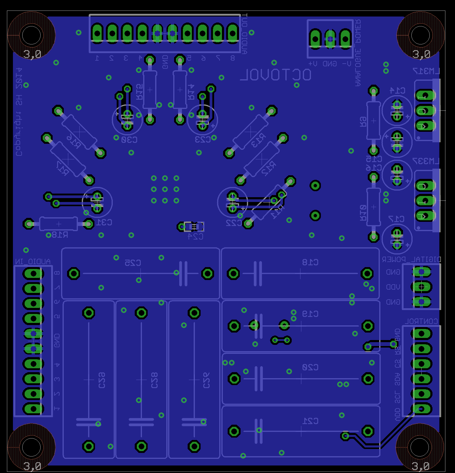

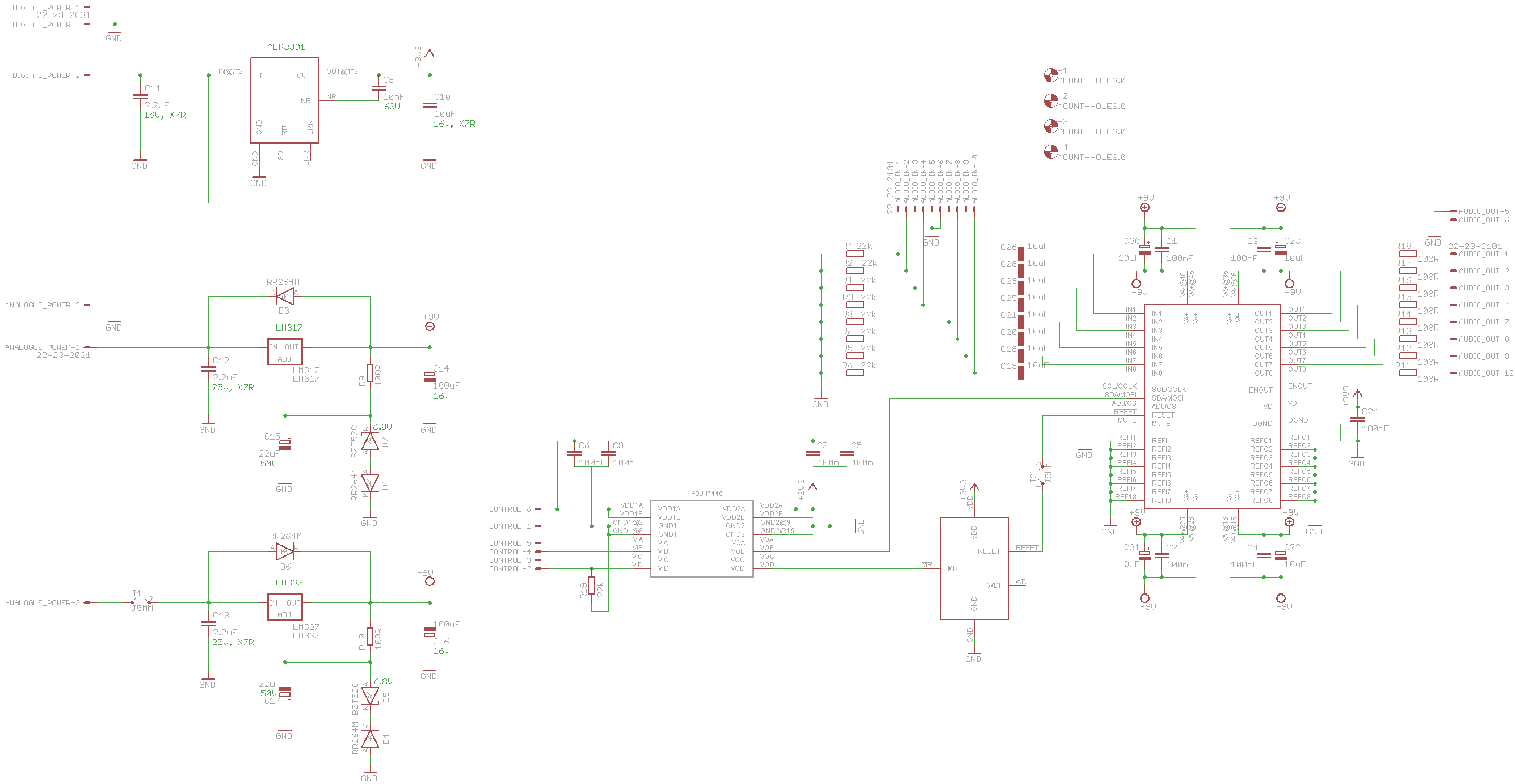

Hi, yep that's the correct part. It should protect the CS3318 in the event that digital power is lost but analogue power remains by putting the CS3318 straight into reset mode. Otherwise the device can overheat as the analogue gain stage oscillates from loss of valid control signals.
PM me if you need a PCB. They were made through OSH Park, who I've used several times since and have always had great quality results. I also still have 2 of the CS3318 ICs if you need one, I know they can be hard to obtain :)
Regarding the ADuM7440: I see there is a 1 Mbps part and a 25 Mbps part. I thought I'd order the 25 Mbps part. Did you use the 25Mbps part?
I am pricing it all out to compare to a resistor/relay based volume control. The highest priced items I've encountered so far in your design are the 8 film capacitors. Too bad the WIMA brand MKS4 (which are quite a bit less expensive here than the Kemet ones I'm looking at) won't quite fit. The WIMAs are 9 mm deep, and I think your board has 8.8 mm max depth for side-by-side capacitors. Do you think I could squeeze the WIMAs in?
Anyway, I'm not sure it's fair to include capacitors in my price comparison because the resistor/relay board would not provide dc blocking in the signal path.
Have you thought about what the hazards might be without DC blocking on the input? I am now using a DAC that does not have blocking on its output. It is driving a switch-based resistive stepped attenuator followed by a Borbely DC100 amp. I now have millivolts of DC on the power amp output, but maybe I'm living dangerously.
I've sent you a pm.
Hi, I looked at my order invoice and I used the 1Mbps part. Either should work though, not certain if the 25Mbps part has faster rise/fall times, that's the only thing which may upset it. Most likely the 1Mbps is just as fast, only the isolation barrier is slower.

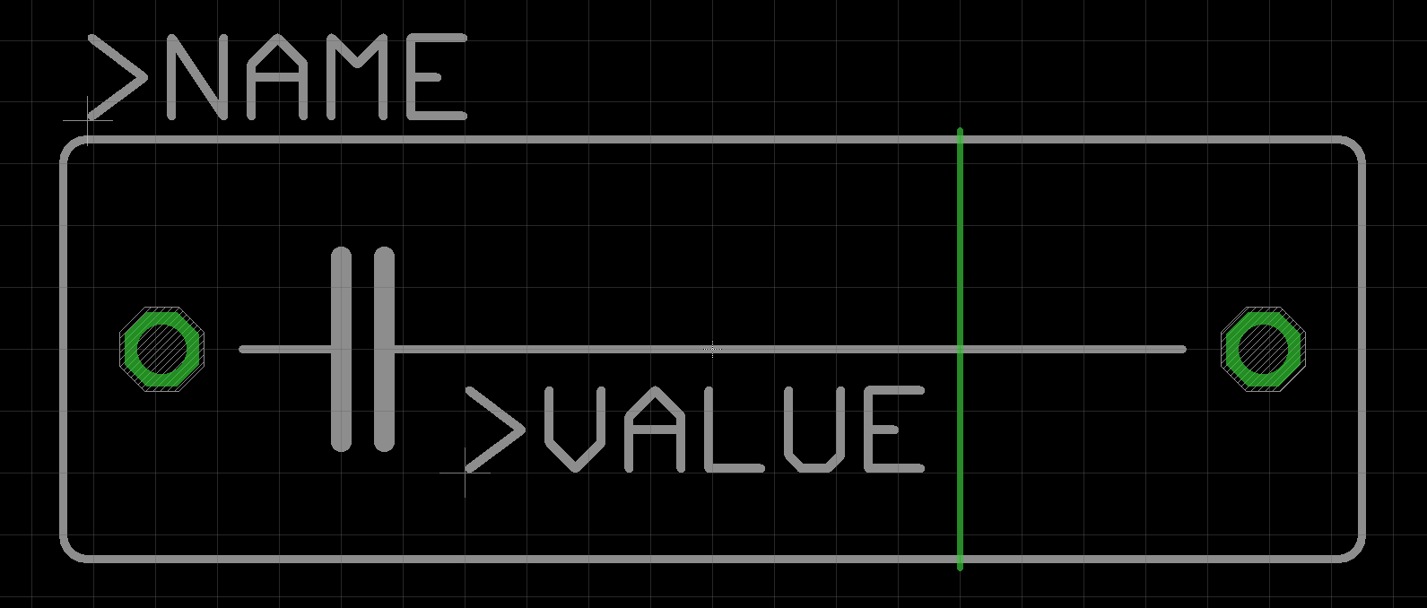

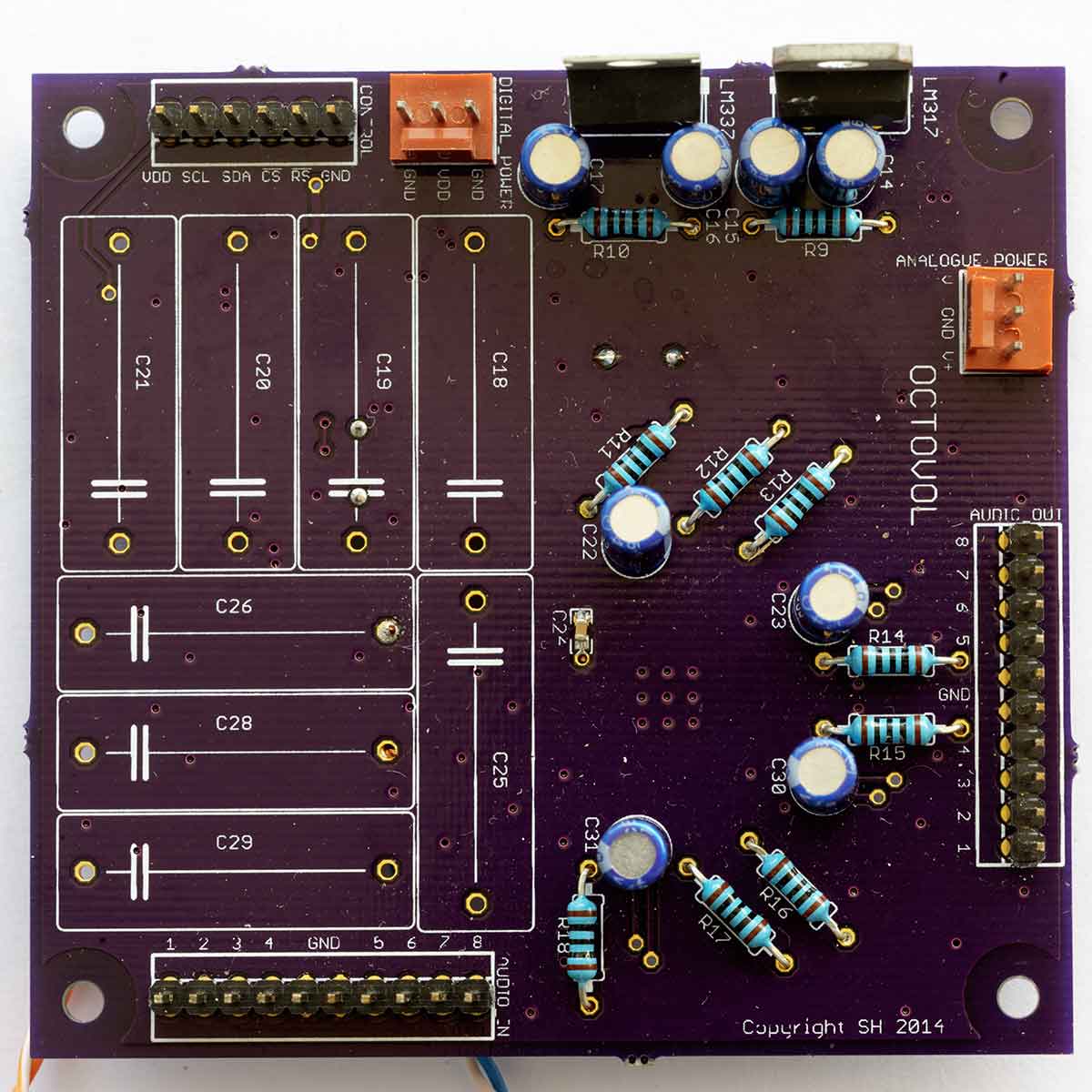

I attach an image of the capacitor package. The green line is 9mm long and you can see it extends slightly beyond the silk screen outline, but the caps aren't quite touching how they are located on the PCB. I reckon it'd be tight and ones toward the edges might not fit flush to the board, but if their leads are thin enough I expect they would all sit flat, it'd give just enough play.
DC blocking is important for a stepped volume controller like this (or a relay one) as you can get clicks during volume changes otherwise. The zero cross detector helps of course but it won't see a few mV of DC offset, however with high gain you could hear it as it shifts. A few mV of offset on the poweramp output is OK, over 50mV and I'd be concerned, but there's no reason it shouldn't be able to be kept below 2-3mV.
Thanks, Mr Dr_EM.
I misread the WIMA datasheet. The dimensions I was looking at were for the 50v part. The 63V WIMA part should fit without problem.

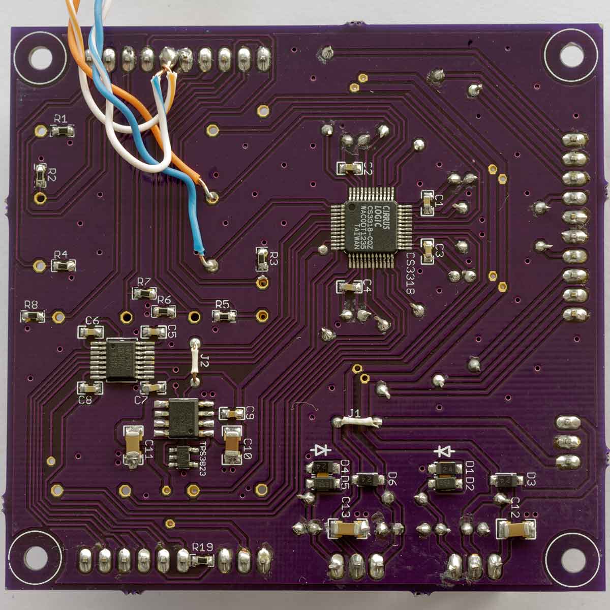

I built the board, but so far I have been unable to get any audio through it. Soldering looks good. All voltages and SPI signals to the CS3318 look right when checked with an oscilloscope. I've tried various SPI signal delays, SPI library speeds, and so on, but with no luck.
Perhaps someone would be willing to review my Arduino Uno code. I've posted it at
https://gist.github.com/anonymous/9fbcb97cd83466f07da3
I hope I haven't fried the CS3318, but that's my only idea now. But I don't have a clue as to how I might have done that. I was pretty careful with the board.

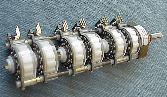

But if I added 6 more gangs of switches to the stepped attenuator I now use, I think I'd have to steal the power steering out of my wife's car to turn the darned thing. She might not be too happy about that.
Mmm, those old fashioned potentiometers or rotary switched attenuators are not so bad after all.....No programming, no possibility that it fries, no power supply necessary, no predefined power up sequence, no SPI, no Arduino, no Adum necessary...
Just joking.
Disabled Account
Joined 2002
Oh that does not need to be so bad...
Just look here for another solution, even suitable for remote control. It saves you from time consuming matters around CS3318 like a PCB, programming, trouble shooting etc.. Not to mention that turning a stepped attenuator feels way better than any other solution IMHO. Did I say it also sounds way better than any electronic potentiometer too ?
http://dandini.wordpress.com/tag/6-gang/

Hi, sorry to hear it isn't working for you yet. Are you able to post up any photos of the assembled board to review?
I had a quick look at the code, I'm using PIC so it's a bit different, but it looks like you have a 125kHz clock line and 2mS between commands? Have a try with a super slow clock, like 1-10kHz and see if it behaves any differently. It's possible you're having the issue I still need to resolve about the device not responding to fast data, which would be unfortunate as it'd suggest it is a hardware issue not software like I had thought.
It's unlikely you've fried the device, apparently it glows and cracks open if it fries! I heard it happens if you remove digital power with analogue power remaining, but the watchdog chip should ensure it is reset if this happens and no damage can occur.

Many thanks everyone for all the suggestions. The board now works! At least, I get audio through it, and I can change the volume with my rotary encoder. I suspect slowing the SPI clock down to 333 Hz was the trick. I guess I'll have to experiment more to see how fast I can run the SPI bus.
Anyway, here is the revised Arduino Uno code:
https://gist.github.com/anonymous/36ecbc9ac1d7e43e36d4#file-cs3318_arduino-for-dr_em-board

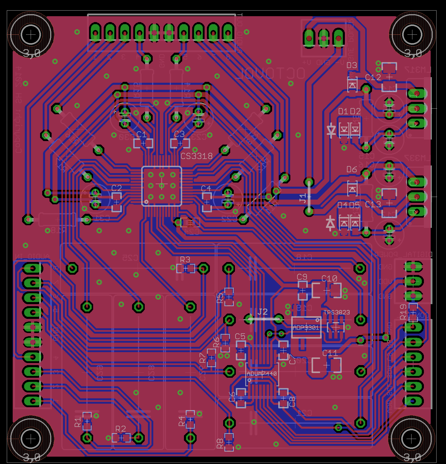

Here are photos of the (nearly) completed board. I haven't decided yet whether or not to use the input caps. I get no ticks or pops when changing the volume with my stepped attenuator, so I see no reason to install caps here.

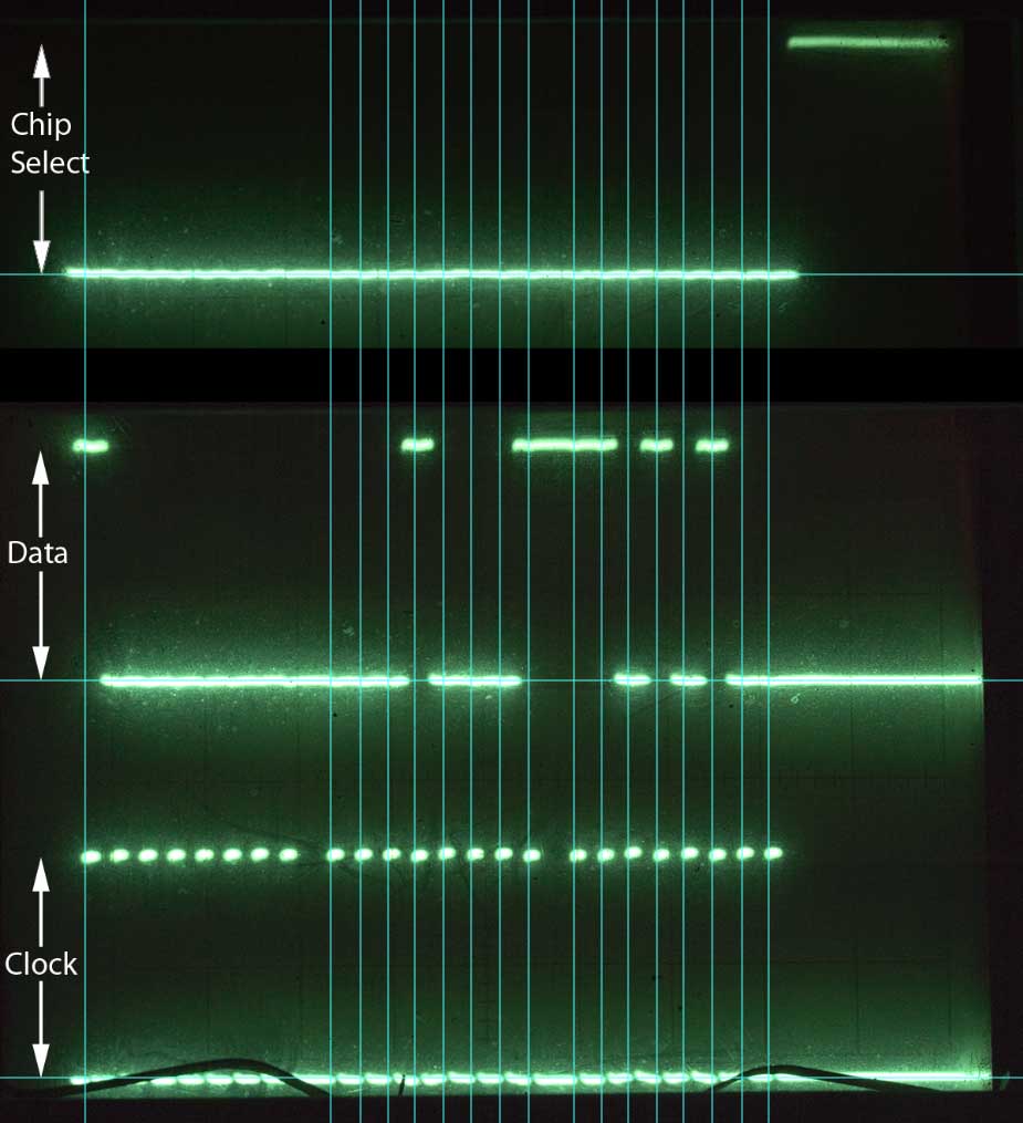

Also, I used a poor-man's logic analyzer to watch what happens when I change the volume. That analyzer consists of an old 2-channel scope, a camera, and Photoshop. I superimposed two shots in Photoshop to arrive at the attached image. It shows that writing a new volume to the master volume register is working correctly. Interpreting the photos of the scope, I see that the sequence 0x80, 0x11, 0xD4 is being sent correctly out of the Arduino.

That's good news that the board is working now! It is however concerning that we're both having the issue of needing to send data very slowly for the board to understand it. I can't think of a reason for it, there should be nothing that bottlenecks the SPI in this design, certainly not to that extent.
The caps are most important if you use the Cirrus to provide gain as well, or if your source isn't very low DC offset. They can't hurt if you have them though, they produce a very low break frequency so virtually no AC at audio frequencies appears across them, i.e, you won't hear them!
You're right about the software so I'm going to grab that analyser, maybe it'll reveal something about the data at different points between PIC and Cirrus device, but I suspect like your oscilloscope analyser technique it'll reveal perfect data right up to the Cirrus pins.
