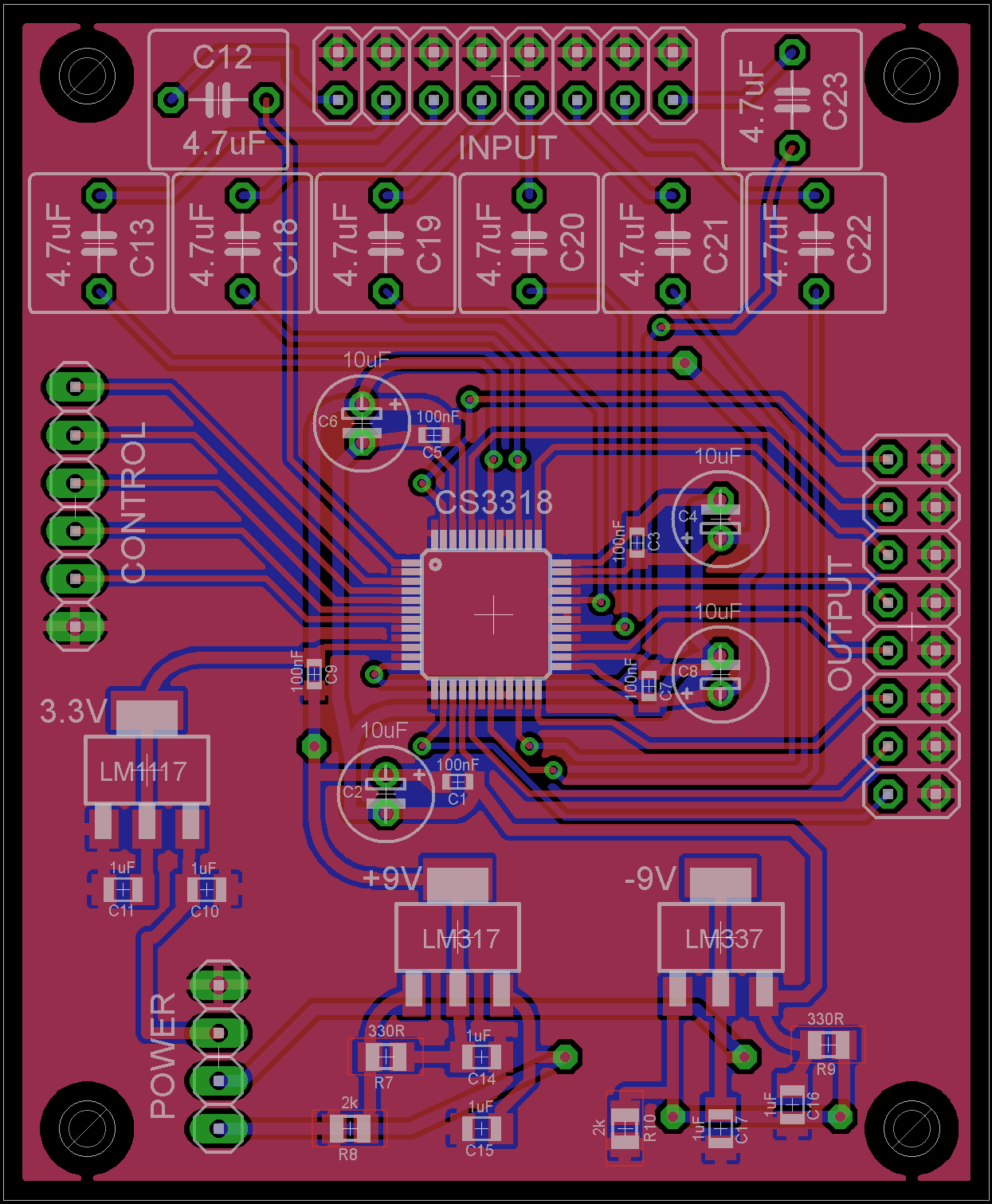

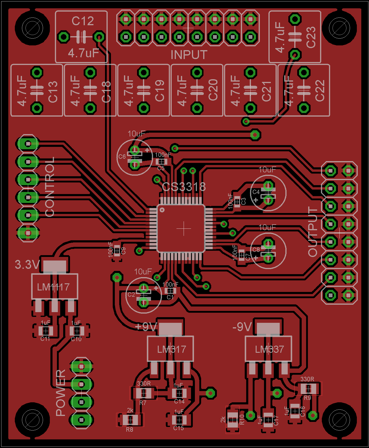

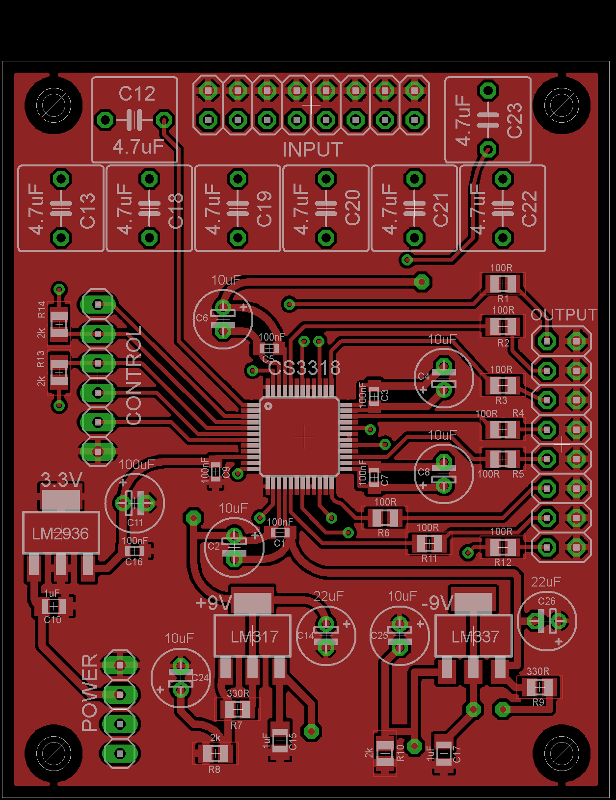

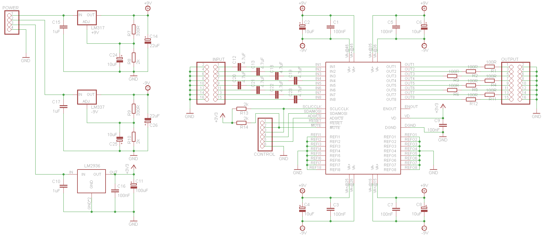

CS3318 PCB Layout
Hi all, I've been hearing about the CS3318 a fair bit recently, and how it's supposed to exhibit lower noise than the PGA2310 in use. Well, I've found the PGA2310 does have some noise and I'm not sure why that should be, but I may well have an application for a 6-8 channel volume coming up and am learning PCB layout, which the CS3318 certainly requires!
So, here's my attempt, it's my first real design in Eagle other than a practise board so it's probably far from optimal. The IC package is from another device in the database and wired up according to the datasheet. Voltage regulators are adjustable since a -9V fixed couldn't be found, they should produce a little under +/-9V.
A couple of things:
  • The coupling capacitors are perhaps a bit small but I wanted film and not to make the board too massive, they can by bypassed with wire links if preferred but maybe a double-hole mounting which could accept electros would be useful?
  • Will the ground fill under the IC suck too much heat while soldering? Perhaps it should be more isolated but I'd need to draw a seperate polygon for this I think, and if I did that, perhaps a hatched fill would make sense.
Otherwise, it's pretty much a standard application with on-board regulators. Any input appreciated!

Hi some tips:
- Please use 10 µF bypass caps on R8 and R10. Explanation would be an insult ;)
- Use a better 3.3 V regulator. Won't cost more than the current one.
- Place the 100 nF decoupling caps much closer to the chips pins.
- maybe the input pins should be referenced to GND by means of 100 kOhm resistors (so before the caps) ? It will avoid clicks/plops when plugging cables in and out ...
- don't you need the pull up resistors on pin 5 and 6 (check data sheet) ? Adding the pads won't cost money and maybe you will need them in your application later on.
- I would use standard electrolytic caps or SMD tantalums for C11, C14 and C16. I am not so sure if LM317/LM337 like MLCC ceramic caps with very low ESR at their outputs.
- what about output caps ? The CS3318 has max. 5 mV offset so maybe I am overcautious. I would definitely use 100 Ohm stopper resistors on each output
- mmmm, just googled this and I think some of my comments are justified : http://www.cirrus.com/jp/pubs/rdDatasheet/CDB3318_DB2.pdf
Keep the film caps, you won't regret it. Electrolytic caps won't bring better performance, on the contrary.

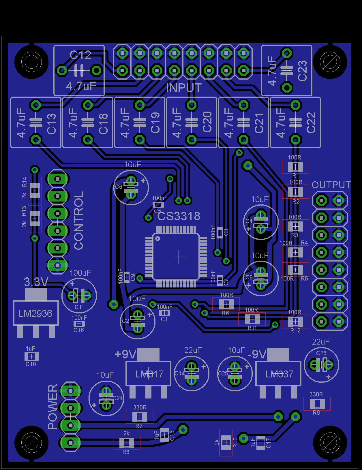

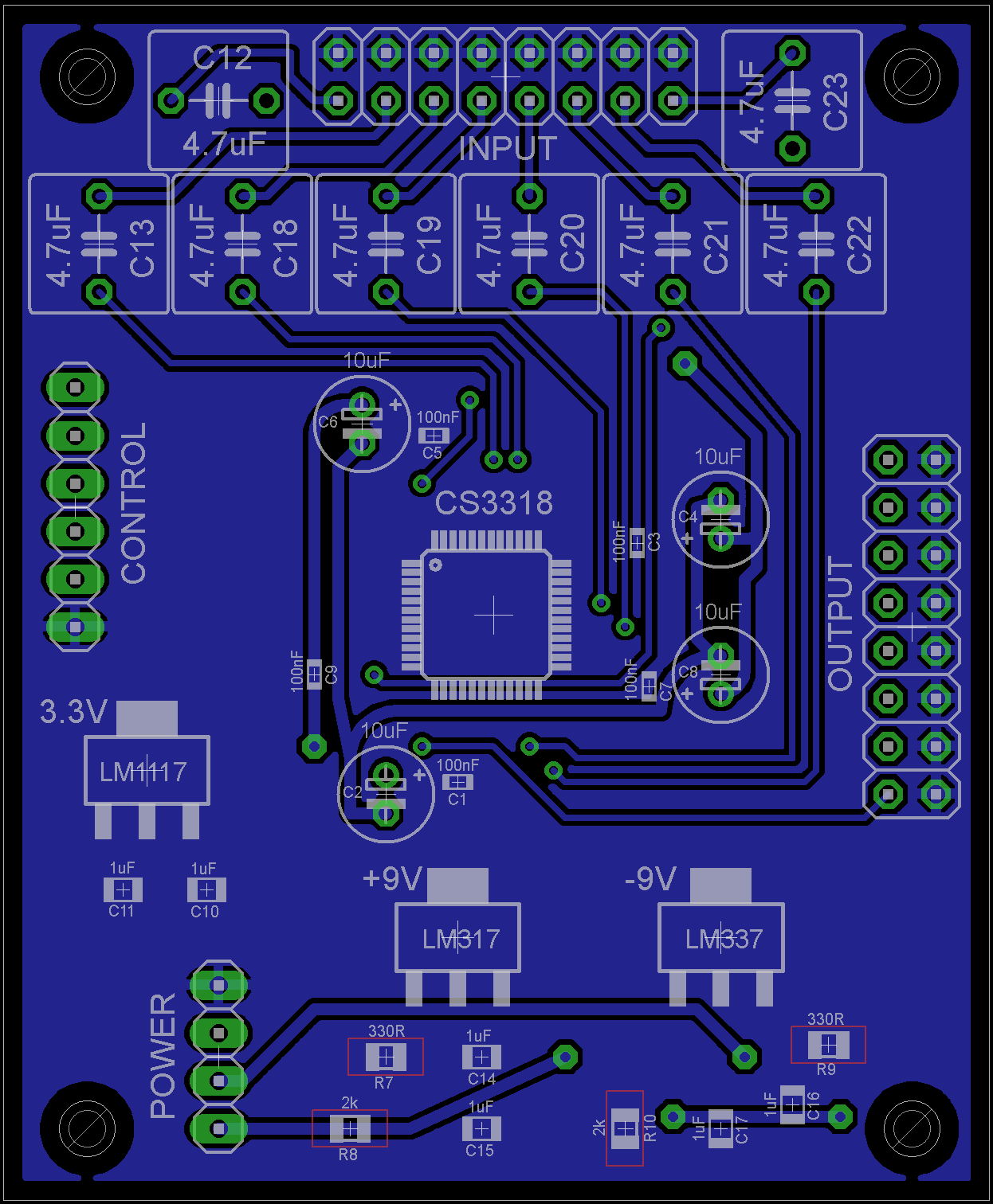

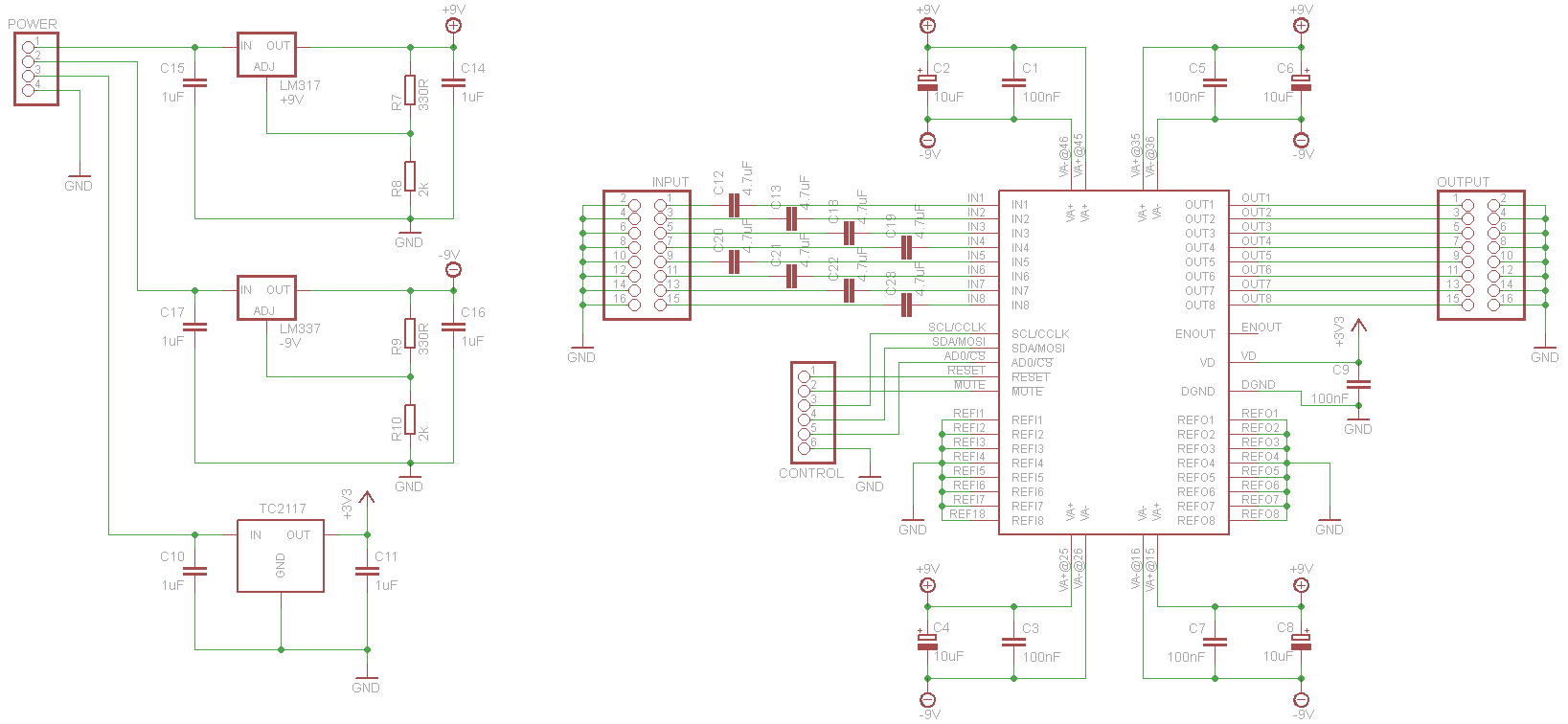

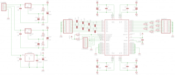

Great suggestions, thanks!
I've implemented most of them. To be specific, I plan that this might get used in a multi-channel audio interface to create a system which can use PC based DSP crossovers. The signal chain would be:
USB-I2S - Multi-channel DAC - CS3318 Volume - Line drivers
With a microcntroller board too naturally. For this reason, the the input resistors and output coupling capacitors can be unused since the line driver would remove DC offset and the DAC will be permanently linked. Power on/off muting would occur on the line driver board, as far upstream as possible. The 100 Ohm output stoppers are a good call regardless of whether you directly drive a coax or not so I included them.
I'm not sure if the new 3.3V regulator represents much of an upgrade but it should do the job of providing the 1mA or so the logic interface needs. The 100uF electro easily satisfies the ESR requirements and at 10V rating is quite compact. I had planned to use SPI interfacing but you're absolutely right, why not include pads for the 2k pull-ups in case, so they're added.
I moved onto the PCB design quite quickly as this was mostly an exercise in learning PCB design in Eagle and so I missed out tricks like the feedback filter for the LM317/337 but they've now been added. I managed to add these without increasing board area at all, though the silk-screen might benefit from some adjustment. +/-9V Regulator output caps are now just 10uF electros.
I would hope the CS3318 100nF bypass are all close enough now, I've certainly done far worse and never had stability issues with op-amps.
Thanks again and any further comments are welcome!

Disabled Account
Joined 2002
Much better but at least one of the 100 nF can be closer.
Getting away with it = not going for optimal performance.... Better do it right at once and chances are likely that you will indeed never have stability issues ;)
If you add GND reference resistors and a control board I would not be surprised if some members will call for a Group Buy ....
You're right, it's a high performance chip and if I'm going to the trouble/expense to get boards made I may as well get it as refined as possible at the design stage. I will move those screw holes outward too Nisbeth, thanks! Easy to forget how tiny this is really!

Looks very good. Might I suggest that you move the screw holes closer to the sides of the board - especially the top ones look like they might be difficult to access if the caps are populated.
/U.
As a mounting hole fundamentalist I can only agree in astonishment (that I hadn't noticed it) :)
I have been playing with the CS3318 and had some issues with it:
1. Do NOT let it run without the digital powersupply, the analog circuits start to oscillate and burn..........:bomb:
2. The mute input must be terminated to ground or VD, otherwise crosstalk from the control lines will cause a severe distortion in the analog outputs.
3. Analog powersupply decoupling as mentioned in the datasheet is done wrong, should be caps from rail to ground... and not between rails.
Disabled Account
Joined 2002
On the contrary: this is correct. Cirrus decouples rails and between V+ and V- which is both old fashioned and good but you don't see it much in reality as it is a forgotten technique it seems. Data sheet also mentions decoupling from Va+ to Va- in text. Please check their reference board where they did it like that on a real PCB. Their engineers would not make the same "mistake" twice I hope:
People using OPA627 and OPA637 know the caps from + to -. It is the only way to keep those opamps doing what they have to do optimally...

As a long-time user of the 3318, I urge you to also bring out the reference (or ground) pins of each input and output next to the particular i/o pin.
If you lump every ref pin together to a central ground, you get much less performance from this chip then possible.
Keeping each i/o paired to an actual input/output signal as long as possible improves the S/N ratio and the distortion performance.
There is a very good reason why they went to this expensive route to almost double the number of pins!

Good discussion here, it certainly shows how much more sophisticated a 'universal' design can need to be compared to an application specific one.
To implement these changes we will need to accept a larger board size and eventual higher cost but I will try to be as efficient as I can with it. Here's what I propose:
  • Input discrage/terminating resistors, probably around 33k to avoid degrading performance with Johnson noise.
  • So is the decoupling used acceptable? The decoupling to ground is back at the voltage regulators so is it too far away? However there is no analogue ground pin as such, only signal grounds, so I'm assuming this is the correct location for it.
  • I'm doubtful about output coupling capacitors as I think few will need those and as you say, if the pads are added we all need to use jumpers, plus additional board area.
  • In/out connectors I think I'll change to two sets of 8 2-pin Molex style, rather than the IDE/cluster type, which needs ribbons ideally. RCA on-board would easily double board area and personally I wouldn't want that as neither input or output would be directly interfaced from the chassis. Panel-board wiring is always possible with the Molex.
  • I could integrate the control board to it, certainly most manufacturers do this, but for DIY people may prefer the modular approach. It'd even be perfectly acceptable to produce your own control boards using veroboard if people prefer to save money and roll their own. Depends if people agree that my control board offers all the functionality they could need? I wasn't particularly planning to include menus for multi-channel level balancing (rather I'd set it in the firmware) but certainly some people might like this?
  • A watchdog chip shall be added to monitor the 3.3V rail, and if it fails, put the CS3318 into reset, disabling the analogue systems. Good call ds23man!
  • The MUTE control input shall be linked to GND with a resistor, say 10k?
  • It's a challenge but I can try to bring out the individual GND references to those input and output Molex headers since you say it can bring about improved performance.
Thanks all, I will update you when I have made the changes!
