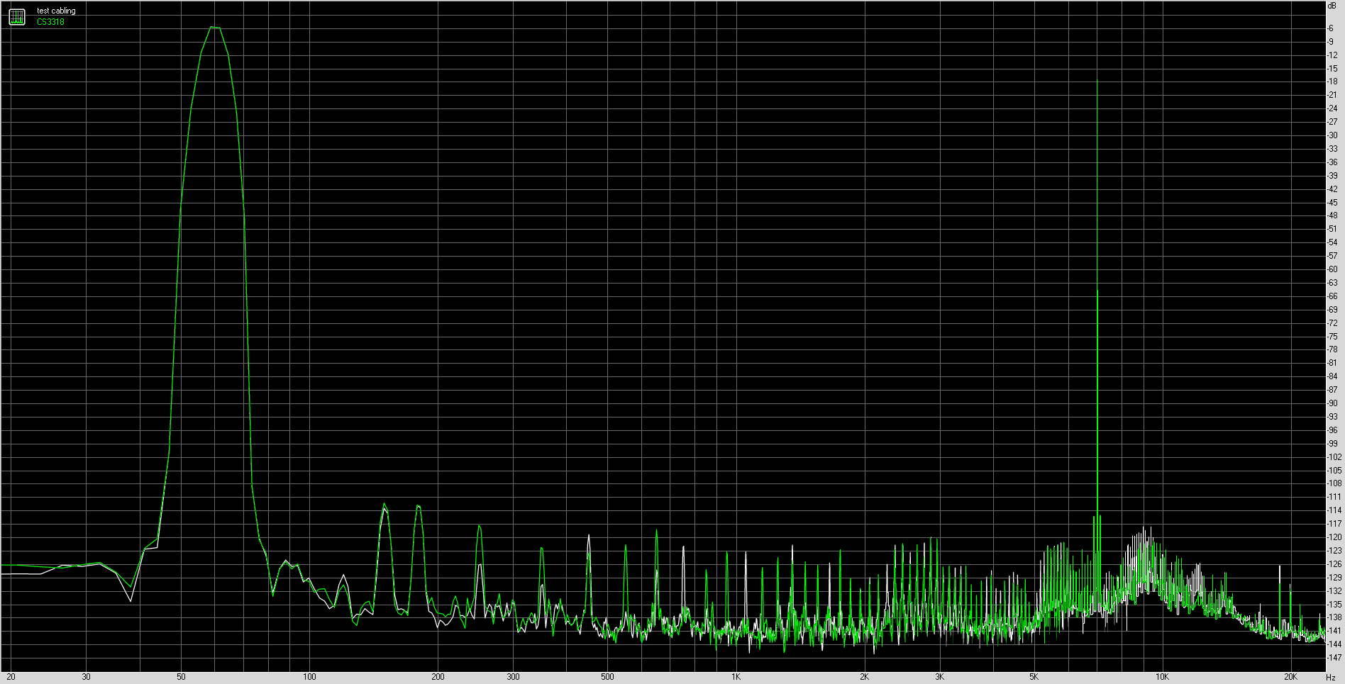

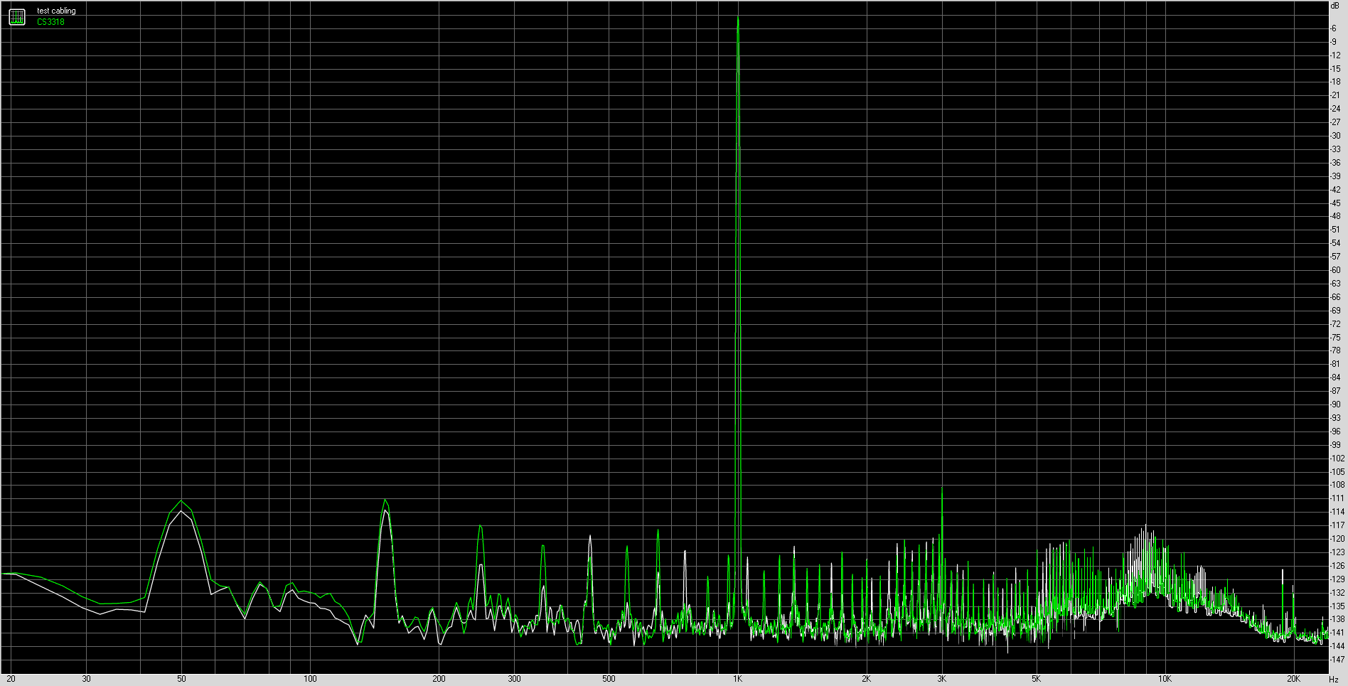

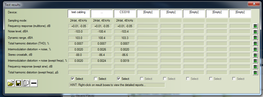

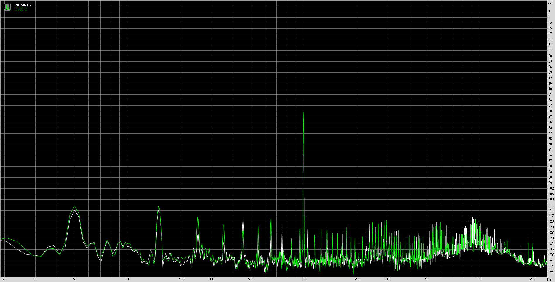

I can attempt an RMAA. My soundcard is 112dB SNR in loopback theoretically, but I measured 'only' 106dB with a 1m cable, so it might be very sensitive to noise pickup. In theory we shouldn't see any worsening of the quality by adding the volume controller in the loopback but I will try it out. I may be able to make use of an AP alternatively, in theory it's no better as it's an old System 1, but in practice I think the result is more accurate.
I have performed some listening tests. I built a simple headphone buffer using an NE5532 per channel, so 2 op-amps in parallel, 56R current share resistors. This is still a very low noise op-amp and it worked well here. In testing as a buffer I could not hear any noise at any setting, a signal at full output would have been deafening but still no hiss. Setting the CS3318 to max attenuation, 96dB, and giving it full output from my soundcard the signal is still clearly audible although very quiet, so this shows it must be well above noise.
I then tried adding a 20dB gain stage after the CS3318 and before the headphone buffers. Using this some noise can be heard at full setting (input connected to ground with 100R) but it's just benign hiss. If I were to apply a signal at this setting it would destroy the headphones almost immediately, but again, winding the level down no noise is heard and music comes through clearly (probably putting a bit too much trust in the code at this point!).
So anyhow, it seems promising. 2 small issues; a clicking sound when making adjustments at the very top end. I strongly suspect this happens exclusively when GAIN is applied as I believe it is DC offset from the internal op-amp being shifted around. It occurs with the headphone stage AC coupled or DC coupled and of course the input is AC coupled so it can only really be an internal gain stage causing it. Certainly it wouldn't be audible with a signal passing at this level. To absolutely rule out the potential that it's digital noise passing into the analogue outputs I will be setting the Master 1 mask on all channels so that the exact same data can be passed to the Cirrus but without any volume changes. I don't expect to hear any clicks in this setup, even with gain fixed at +20dB, but we will see.
The other small issue is a 'shimmering' when making volume adjustments. I believe its a combination of being able to make very rapid adjustments with that single turn pot along with the slow SPI which takes longer to send data than the zero cross timeout period! Still want to get that SPI up to speed, pretty sure it's a code issue.
I gave it a shot anyhow. I think it only really shows that the CS3318 board surpasses my measurement setup (which I only really expected to be good enough for power amps). Still good to see some numbers though!
A slightly better result should be obtained with the CS3318 all boxed up and shielded and using shorter, better shielded cabling. The drop from my previously posted 106dB SNR comes from now using 2 sets of 3.5mm jack-jack leads and short unshielded sections connecting to and from the Cirrus PCB. The test lead measurement posted here should be your reference point as it includes both leads. Cirrus is set to unity gain, default at power on.
EDIT: Ignore the '...' response, I put the cable right next to the bench PSU on that one by accident!
