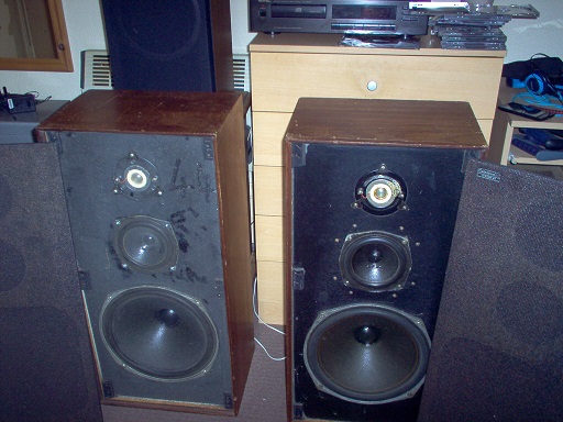

Continuing about replacement Inductors for 44
I received a request from a member which I Copied and Pasted here-below and will reply to here ,
because it is relevant to this thread , following earlier discussion about replacement Inductors earlier in this thread.
I recommend all owners of 44s who are upgrading the Inductors proceed as below the ***** enclosed insert:-

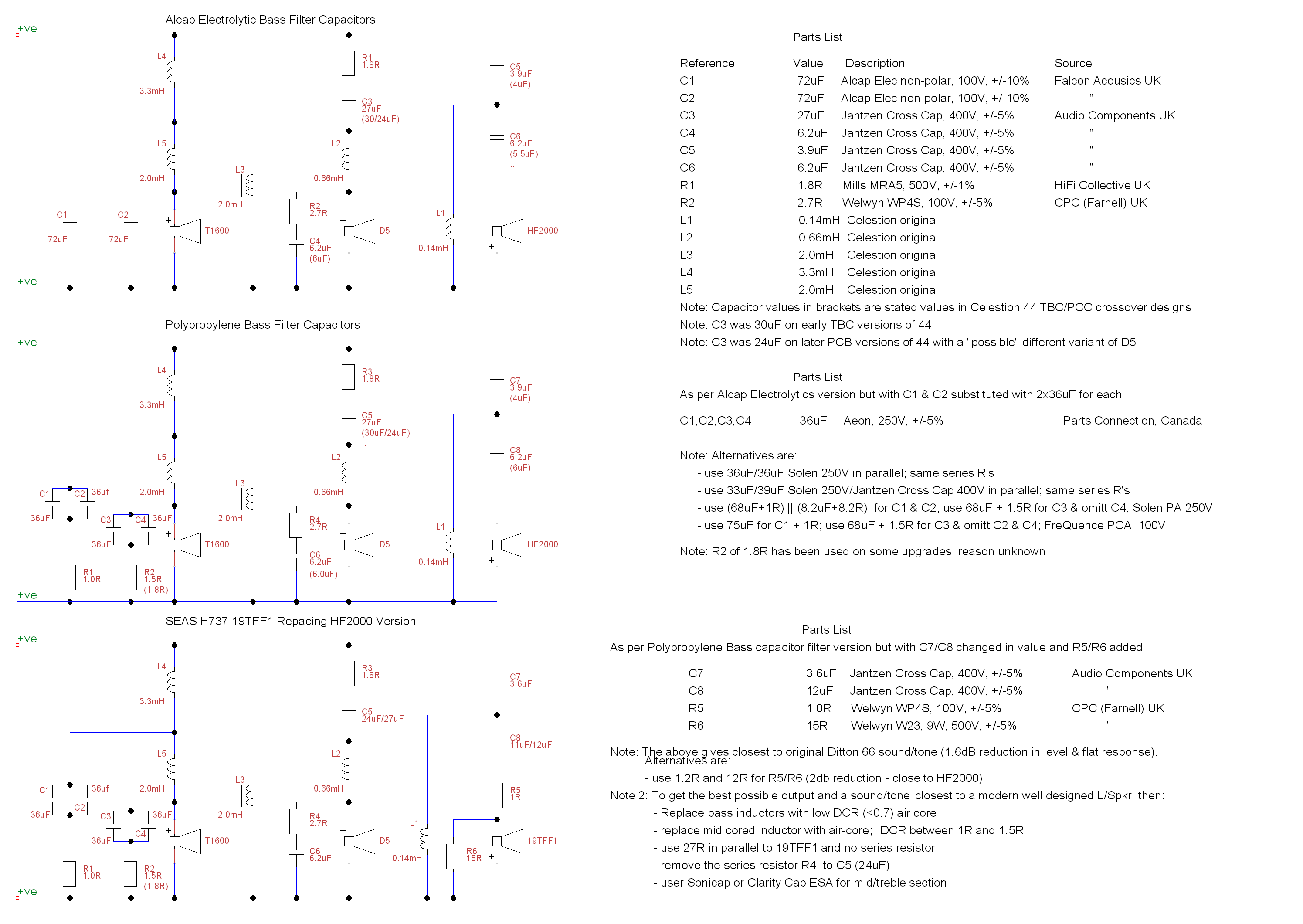

'ullo Lucas ,
I strongly recommend you do not buy the 1mm wire Inductors , nor even buy the wire and wind them yourself ,
because you will be wasting your limited money.
The original Ferrite cored inductors are significantly lower DCR than the new ones you propose ,
thus whatever audible gains you achieve with less Saturation with the Air-cores ,
will be offset by loss of output level and Transient Response as result of the significantly higher DCR of the Air-cores you propose for the WOOFER filter.
I refer you to kayelem's measurements in the File attached to #143 on Page 15 of this thread ,
and remember that these resistances are with respect to the 4 ohm Woofer ,
that you propose to add almost 3 ohms in Series with !
I refer you also to rwtomkins attachment of the original Celestion data in #188 on Page 19 of this thread.
See there the difference between the two versions of 44 for both L2 in Midrange and L5 in Woofer circuits.
As you have 30uF for the Midrange input capacitor I recommend you use 2.2mH for L5 to the Woofer for a more even crossover transformation.
To get the best from the Woofer with the Jantzen inductors I recommend:-
000-0034 , 3.3mH , AWG14 , 1.6mm , 0.482 ohm ,
000--0028 , 2.2mH , AWG14 , 1.6mm , 0.385 ohm.
If you absolutely will not buy those large sizes , then buy not smaller than:-
000-1199 , 3.3mH , AWG15 , 1.4mm , 0.615 ohm ,
000-1246 , 2.2mH , AWG15 , 1.4mm , .473 ohm ,
or :- 000-1338 , 2.1mH AWG15 , 1.4mm , 0.46 ohm.
Where you can save money is for L2 in the Mids' filter ,
because some resistance is useful there as it reduces the onset and magnitude of Resonance within the mids' filter itself.
This will not reduce output level , it will increase clarity/transparency.

I recommend strongly that you continue to save money until you can afford the low DCR inductors.

My 44's and their crossover upgrade
Hi All,
I found this thread a few months ago after acquiring a a pair of Ditton 44's off EBay. My intention was to use the 44's as a backup for my existing Ditton 66's and as a supply of some of the drivers for the 66's should any fail. I also wanted to see what I would need to upgrade in the 44's to get them to perform at their best.
I have also read all the "Ditton 66 needs mid-range" thread and the "Custom Ditton Project - need expert opinions" thread.
I think the depth of knowledge and the help given to Ditton 44 and 66 owners on how to upgrade their speakers by some of the main thread contributors has been oustanding. I can only thank them for all the work and help they have put into this forum that has permitted me a relatively easy path to upgrading my 44's.
I hope to add a little to the overall knowledge base on upgrading Ditton 44's and 66's based on my recent upgrades to my Ditton's which has been based primarily on the information in these threads.
Celestion Ditton 44's were my first set of non-DIY speaker's in 1975 after completing a Electronic Eng degree. After much auditioning along Tottenham Court Rd listening to B&W's, IMF's, JBL's KEF's etc I was blown away by listening to Celestion Ditton 66's. I couldn't afford those unfortunately but ended up buying Ditton 44's.
I moved with my job to Ipswich around 1976 and via a colleague, whose sister worked at the Celestion factory, got a set of factory Ditton 66 "seconds" (a small imperfection in the veneer) for a real knock down price easily recouped by selling my 44's. The 66's have stayed with me since then. The only problem I have was a blown HF2000 when my home built amp blew its outut transistors in one channel. Got a factory reconditioned replacement for the princely sum of £8.50.
Anyway sorry about the diversion and back to my 44's and their upgrade. Having read and re-read all the threads my 44's are the "blackie" versions and on opening them up one had the manufacture date stamped inside under the crossover: 24th September 1974. This speaker has had its mid-driver remounted 45% round...not sure why and I havn't investigated further as its working fine and the job seems well done with the old mounting holes well filled in, levelled and painted. The other speaker is "standard" but didn't have a date inside.

My 44's and their crossover upgrade - continued
Firstly I apologise for the number of typing errors and mis-spellings in my
previous posting. I really need to get a good spelling checker and a proof
reader as I seem to be incapable of doing it properly myself :(
I also managed to forget to attach my design variants file including the
crossover version information for the SEAS 19TFF1, so have attached it here.
I hope I have correctly gathered the information from all the various posts
regarding the possible upgrade paths depending on whether the up-grader
wants an "original" 44 sound or what may be termed a "best possible modern" sound (from suggestions made by Alan-1-b).

'ullo Andy ,
two very interesting Posts you have made , describing your 44s' and 66s' history , and upgrades , etc ...
I hope of interest to other owners reading here ...
and it is good that you have read ALL the ongoing Celestion threads ,
as some owners do not , but ask the same questions the some of us have previously dealt with !
Some comments:
Do not worry ttoo much about cutting away a little of the foam inside the cabinets ,
because if you cut the back of the foam - that is facing the cabinet wood - the cavities created can actually assist with sound absorption , if they are fairly small.
It is good to cut sufficient so the resistors are not touching any foam ,
as cooling of the resistors is necesssary.
If you relocate the crossover boards , position them away from the backs of the Woofers especially ,
because the large magnets have sufficient field to affect the Inductors in the crossovers , and load bass frequencies into the mids and tweeter inductors.
Effect of improved sound after moving the crossover was reported in the 66 midrange thread by a listener a couple years ago.
Do not expect to get acurate measurements of electrolytic caps with a meter ,
and especially not with old electros , nor even the old paper caps ,
because the meter will read a leaking charge cap as if it is a larger value capacitance.
I advised 1.8 ohm in woofer circiut for one or two owners only as alternate for if they prefered to swap the 1.5 ohm into the midrange circuit.
That is , buy both and swap around , but I think 1.5 is likely better in the woofer circuit.
Following several user reports I now advise NOT the 1.2 ohm + 12 ohm L-pad fro the SEAS 19tff1 ,
but start with the 1 ohm + 15 ohm for attenuation if require noticeable.
That QED "original" 42 - does it actually have Polyethylene insulation ?
{ You typed "polyethalene" }
If it does , that is GOOD , but it may be only PVC or similar ...
do you have any other information about it ?

Having been inspired by this thread and a large dose of nostalgia I have decided to refurb. mine.
I have the earlier TBC. Xover board. However my midrange Cap. (C3 on the Celestion TBC diagram) consists of a 24uF red Pye cap with a 6uF black Elcap on top, in parallel !
Maybe they used 3 midrange drivers ? The driver is marked HJ 17 T1953.
They live! These have gathered dust for a while. :D
I've had a bit of a nightmare with these £60 second hand jobbies. Seems that one of them was wired out-of-phase. Confirmed this by facing the boxes towards each other and noticing that the bass disappeared. :confused:
One of them has a cardboard tube on the mid, one has a chipboard box. I had severe problems getting the tube mid T-nuts off the baffle too. Just put screws in now. One has a bass with a very near broken/frayed lead out wire to the cone. The foam stuffing is all a bit random too. I think these have seen some fiddling over the years.
Sounding more like it wired up correctly. I'd forgotten how detailed the midrange is on a 3 way. These are good, if a bit bright. Does anyone know where I could get the bass rewired?

I read all through this (& the 66 thread) a while back when it was theoretical and again now as I've gone mad & bought a pair of black front 44's which it has to be said when I got them home weren't quite the buy I'd hoped..
So I've been making notes, changing them, then changing them back on the ebb & flow of advice & experience till I'm thoroughly confused..
My 44's have tatty cabinets & grilles (fixable) one dead & one dying tweeter and the caps are obviously well past their best (hard wired crossovers, black Elcaps, 6uf in parallel with the midrange orange 24uf)
So my plan of action is to refinish the cabinets & do some work on the grilles to minimise their effect (they are necessary in my case & I feel done properly they can offset the effects of the raised surround)
I'll change the tweeters to Seas 19TFF with 10ohm in parallel & 1ohm5 in series with the tweeter cap 'bundles' replaced with Solen 400v 4&6uf
Mids I'd change to 30uf Solen with 2ohm2 and 6uf with 2ohm7.
Bass replace the 72uf's with standard 72uf 50v Alcap electrolytics (as being the closest to original)
I know I can get much better polyprops but frankly I'm not prepared to spend the cash, would I be better just replacing like for like with Alcaps & forgetting polypropylene all the inelegant ESR resistors?
To be honest I'd not bother at all & just stick with my B&W DM2's & listen to the music - except even in the state they are & plonked directly on the floor with no thought they have *magic* & so much potential I don't think I *can* go back!
If anyone is still reading this thread I'd appreciate thoughts of comments
All the best
My advice, obvious really, is only to do as much work as is necessary to decide whether you want to keep them, otherwise you could waste a lot of time and money.
So that means replacing the tweeters and the caps. I would go with what you suggested - there's no point in wasting money on fancy caps because in my opinion they're unlikely to make a discernible difference to the sound unless they're of a different value, in which case they could do more harm than good.
It's not necessary to make cosmetic changes at this stage but if you want to, replacing the speaker cloth is very easy - just take off the old cloth, wrap some new cloth around the boards and staple it to the back, trimming off neatly after you've stapled. The cabinets you can just lightly sand down and re-finish as you wish - I did a pair in matt black woodstain once and they came up beautifully. But a word of warning - the veneer is incredibly thin and it's so easy to go through it - don't use an electric sander or you'll go through for sure.
You'll find the 44s are far warmer and far less analytical than the DM2s - a very analogue sound! - with more bass, of course. If you really want to bring out the bass, put the cabinets in the corner of a room - it will make a vast difference but is frowned upon in audio circles.
Hey rwtomkins!
Thanks for the advice & pulling me up short, I am kind of famous for going off half cocked (!) I might just start with a straight restoration job (like Kat Manton) the tweeters & matching resistors obviously & just replace what actually *needs* replacing for the caps then see..
Interesting what you say about the difference in sound between the DM2 & 44's as to my ears it's been almost the opposite. My first reaction was 'my god they've got no bass' but I realised what they have is fast clean bass with definition and no over emphasis. (In my room) In fact I'd put a lot of my overblown bass down to room modes, but they seem to have disappeared with the 44's. The difference is a drum sound thump to someone hitting a taught skin with a stick.. Actually pretty much the same thing with the mids which I put down to a small light paper coned mid unit as compared to a heavy 8"Bextrene cone. Probably coloured, but fast - The treble currently of course I couldn't possibly comment on!
Will post as I do stuff..
