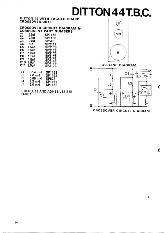

Hi Alan,
I have spent the last few days going through the documentation of this thread to make sure I have the right information. Unfortunately, I can only see the markings of one of the high frequency caps.
Following P3 of the DITTON44T.B.C. there are the following;
C1 72uf50V
C2 72uf50V
C3 2 orange caps of unknown size and a black 6uf50V
C4 6uf50V
C5,C6,C7 are 2 identical caps of 2.2uf250V
C4,C9,C10,C11 are actually 3 identical caps I suspect are 2.2uf250V
On the assumption that they are also 2.2uf, then C5,6,and 7 are 4.4uf where others have a total of 4uf, and 6.6uf where others have 6uf.
Now my dilemma. Do I order direct replacements of what is in my 44? These are different cabinets than I have seen anywhere else, with beautiful bleached rosewood veneer. or do I order what others have been ordering?

I thought it might help to include the document I was referring to above. All three pages can be found somewhere in this thread. I'm coming down with the flu and don't have the energy to search for it.

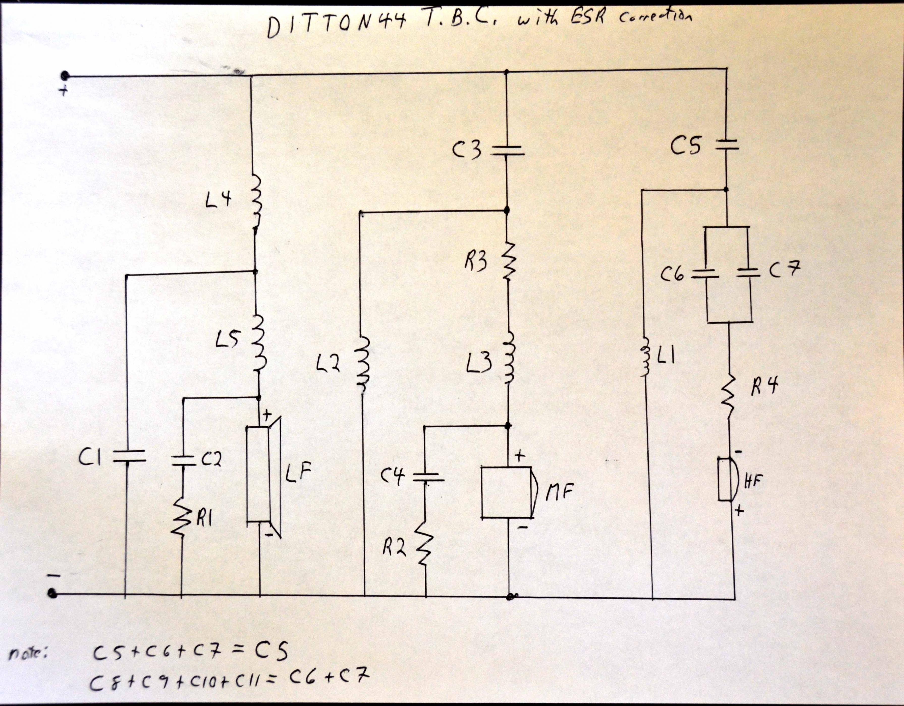

Parts list and Reference Schematic
DITTON44T.B.C with ESR Correction 3766.jpg Parts List
qty part description p/n price inU$S
8 36uf 250V for C1 and C2 Axon-73691 $6.96
8 3uf 250V for for C4, C6 and C7 Clarity-74389 $10.01
2 4uf 250V for C5 Clarity-74842 $10.43
2 33uf 250V for C3 Clarity-74858 $42.06
2 0R5 5 Watt for R4 Mills-71893 $3.95
2 1R0 5 Watt for R1 Mills-64619 $3.95
2 1R5 5 Watt for R3 Mills-71894 $3.95
2 2R7 5 Watt for R2 Mills-64619 $3.95
Total cost if I order these parts right now is $272.34. That is the same as what I paid for these speakers, and yet I am willing to spend this for another 30 years of great sound. I spend much more than this for computer gear that lasts only a few years. I'm not yet sure how I will deal with the much larger sized caps in C1,C2, and C3, but I think if I reorganize the layout, I should be able to fit them all in.

Hi TechnoDweeb ,
from your photos it is obvious that you have the earlier 44s with the T.B.C. crossovers ,
BUT , the problem is , as LucasAdamson posted in several places in this thread ,
there were 3 different versions of this model for the input capacitor of the midrange filter ...
so which to use ?
You could go with Celestion's final decision as shown on the T.B.C. schematic , #188 on Page 19 , of 24uF ...
but perhaps by then Celestion had started using the new mid-range cone ...
and if your 44s have the original mid-cone it may be better to stay with what you found in your crossover.
I recommend you do not use 33uF , because the version with caps summing closest to that may not be yours.
The larger the cap there , the more lower midrange there will be ,
and if 33uF is too large for your mid-cones there will be some lower mids bloating - a resonant excess.
I recommend you stay with what you found - caps that sum to 30uF.

Lucas did a lot of experimenting , and when he used 0.5 ohm to the tweeter he also had 2.0 ohms in Series with the midrange.
The Celestion HF2000 tweeter has less output than the mid-cone , thus does not need resistive attenuation.
I recommend you start with:
no resistor in the tweeter filter ,
1.8 ohms in Series with 30uF C3, and 2.7 ohms in Series with 6uF C4 in the midrange filter ,
1.0 ohms in Series with C1 , and 1.5 ohms in Series with C2 in the woofer filter.
If midrange is then too low , then swap the 1.5 ohm and 1.8 ohm resistors to 1.5 in the mids and 1.8 in the bass at C2.
This will cause slightly greater difference in the midrange than it will in the bass.

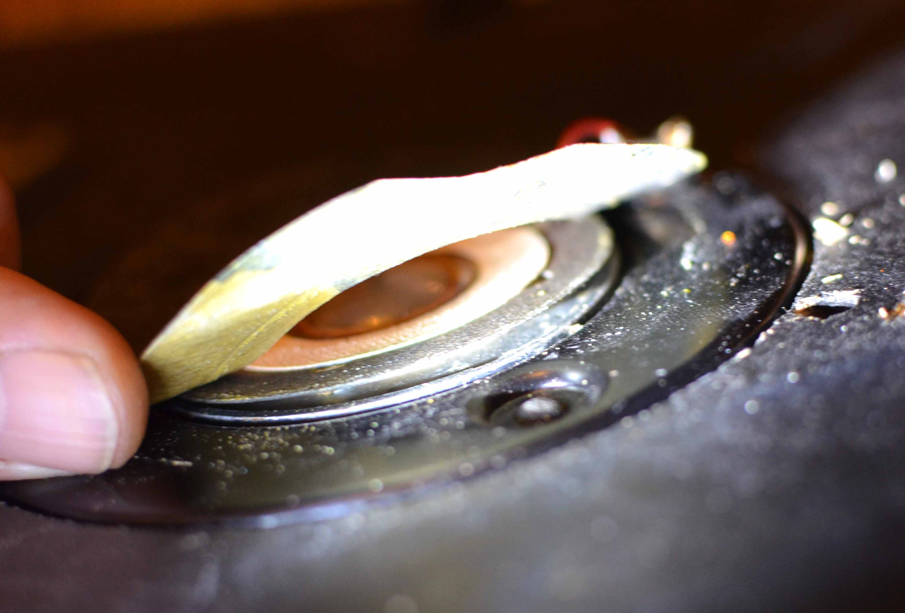

To get the Treble right , apply Felt treatment around the tweeter before you insert any resistor.
{ I have posted more about the Felt application in the Celestion 66 midrange thread , and will be posting a bit more when I have time available }.

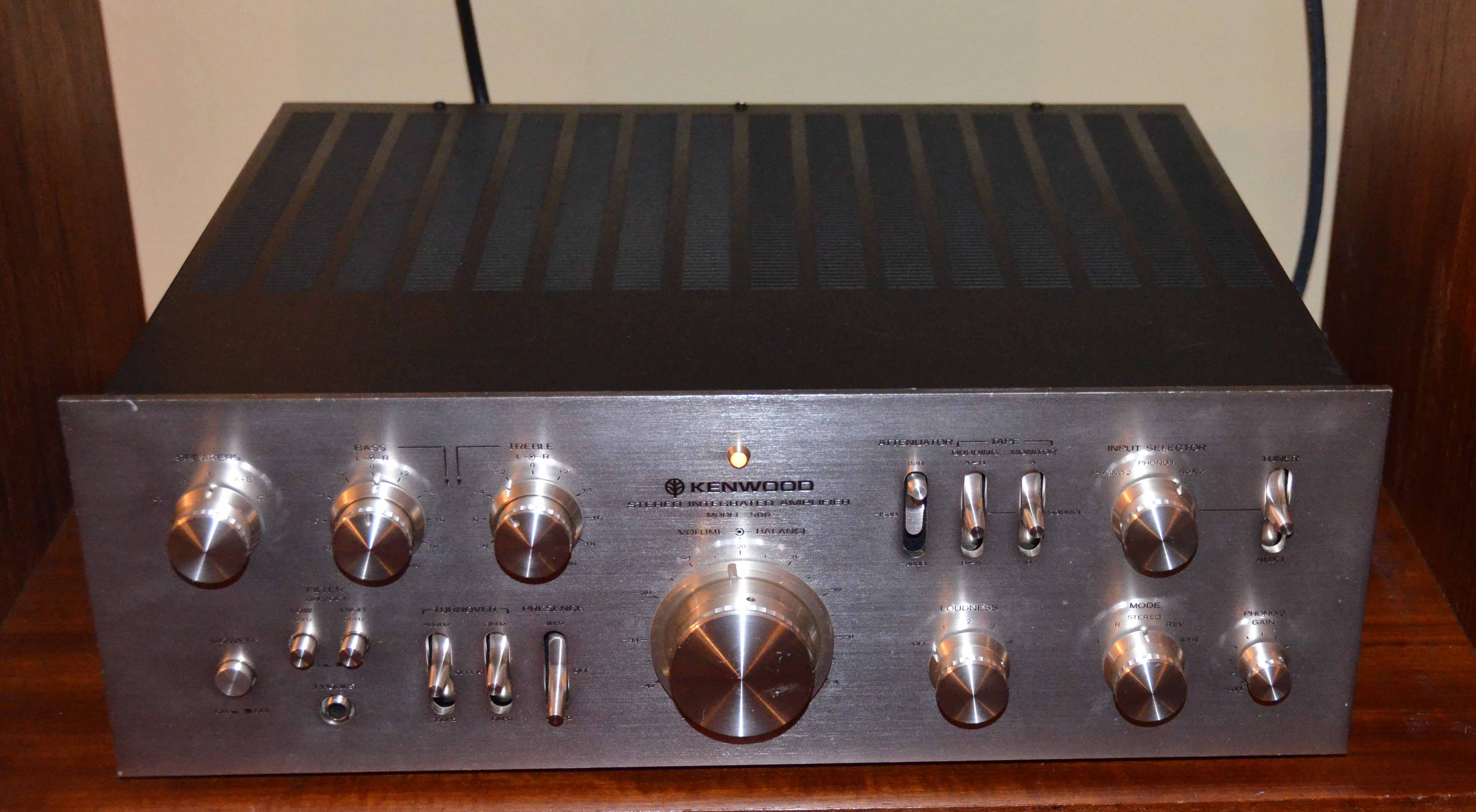

Part , or perhaps all , the sound problems you listed when driving the 44s hard with the Sansui 9090 receiver may be owing to the deterioration of caps in the receiver ,
or , as result of its Bias current having drifted too far from the optimum amount.
Do you have a Schematic for the Sansui ?
If yes , then post it here if you can.
If you cannot post it , then look inside at all its electrolytic caps.
There will be one or two large caps in the first stage of its power supply ,
and probably also two large caps at its output - one for each channel.
These output caps will not be less than 2200uF , and more likely will be 4700uF or more.
If still the original caps there , they will need to be replaced , but do not rush into buying , but post here first ,
because to get the best from a capacitor coupled output amplifier you will have to choose the type of electrolytic very carefully.
MacIntosh did not use output capacitors , but instead used output transformers -{ in all their Solid State amps , if I have been correctly informed }-
and very good transformers , because MacIntosh knew about output transformers from their earlier Tube amps -{ for which they designed their own specialist transformers }.
This is why vintage MacIntosh solid state amps are regarded so highly above the capacitor coupled output amplifiers of that era.
{ Most modern solid state amps do not need output capacitors or output transformers }.

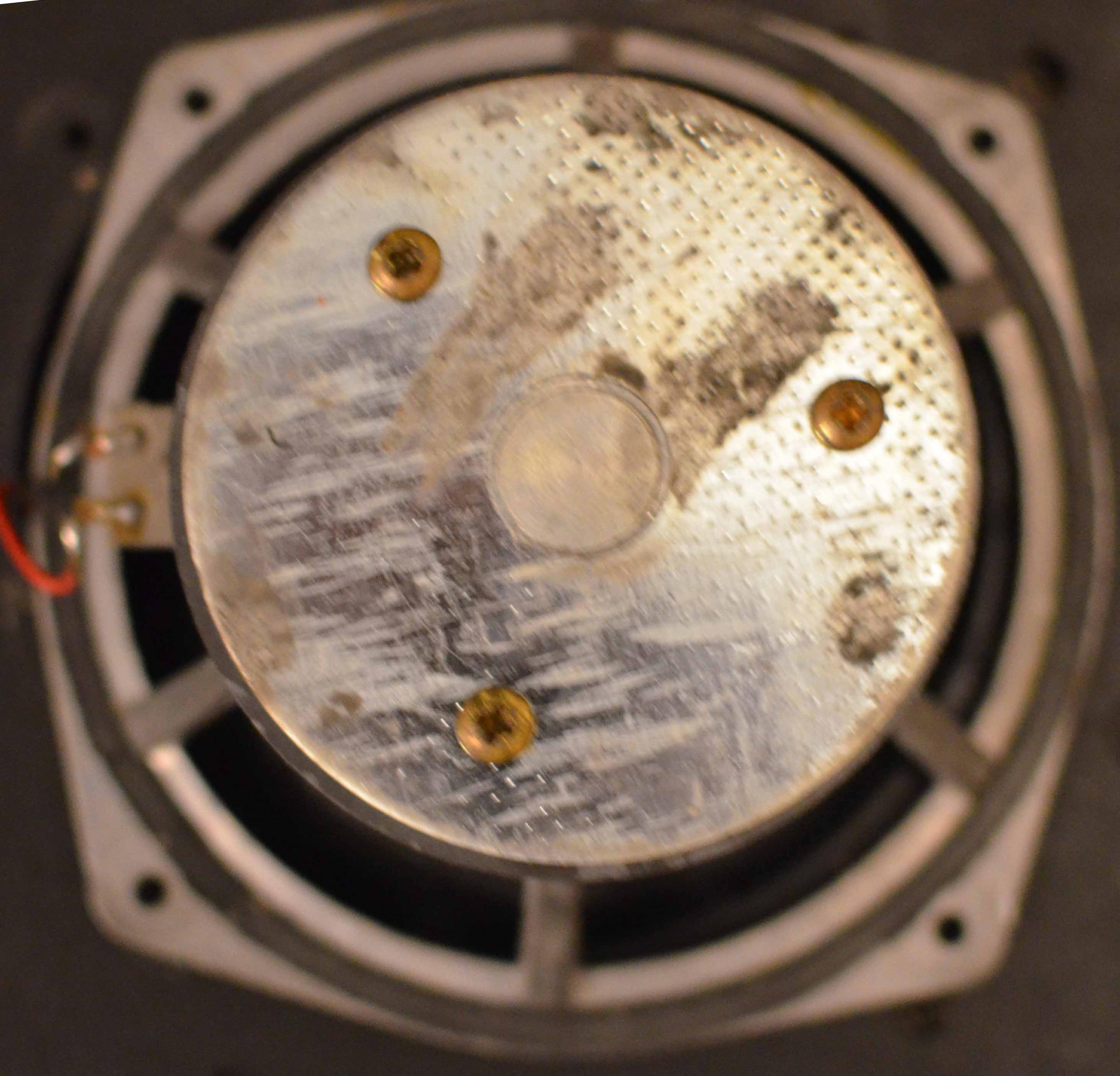

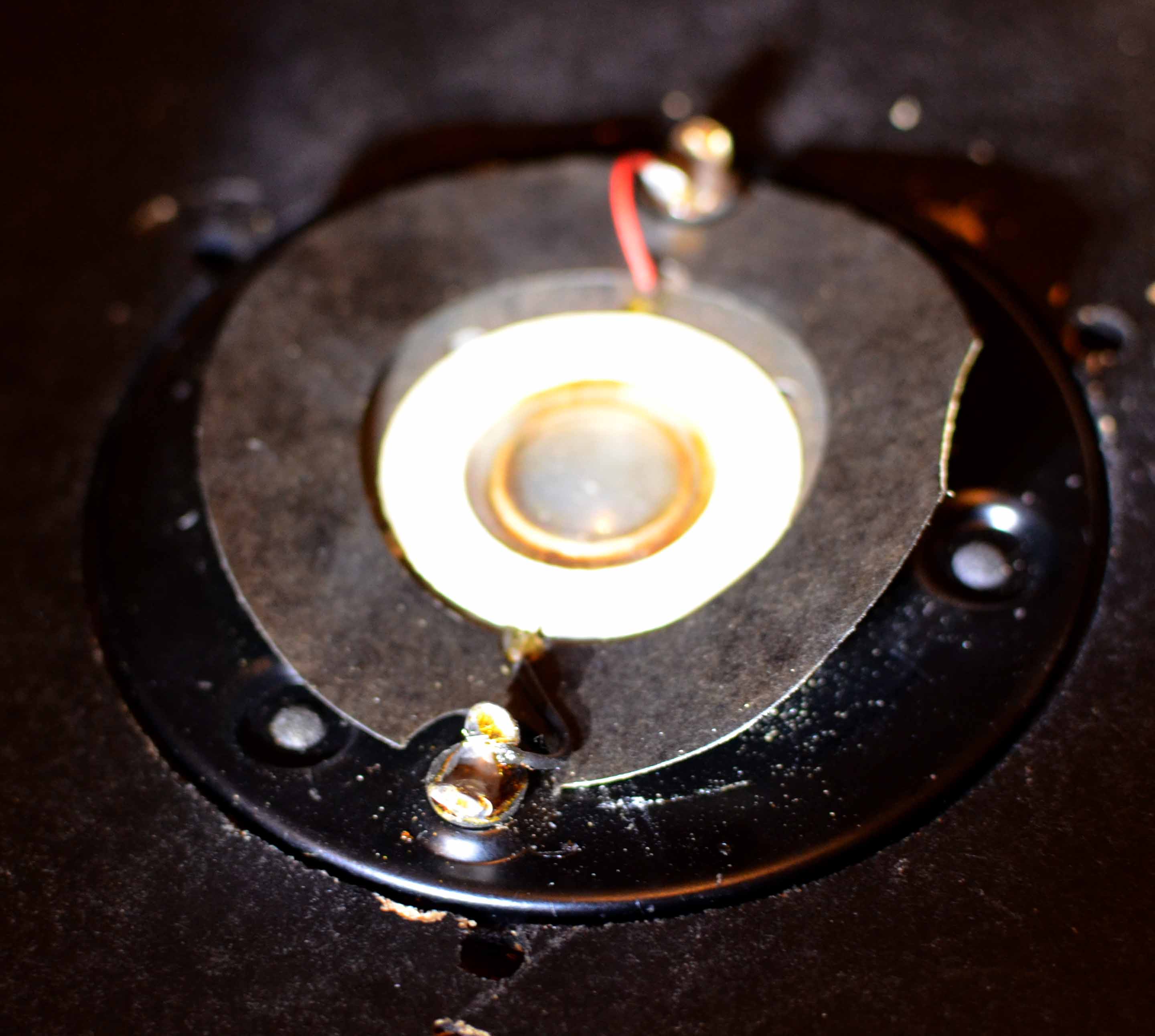

Yes , do post photos of the backs of the midrange drivers from your 44s ,
as that will help us identify and decide which caps to use with which versions of that driver.

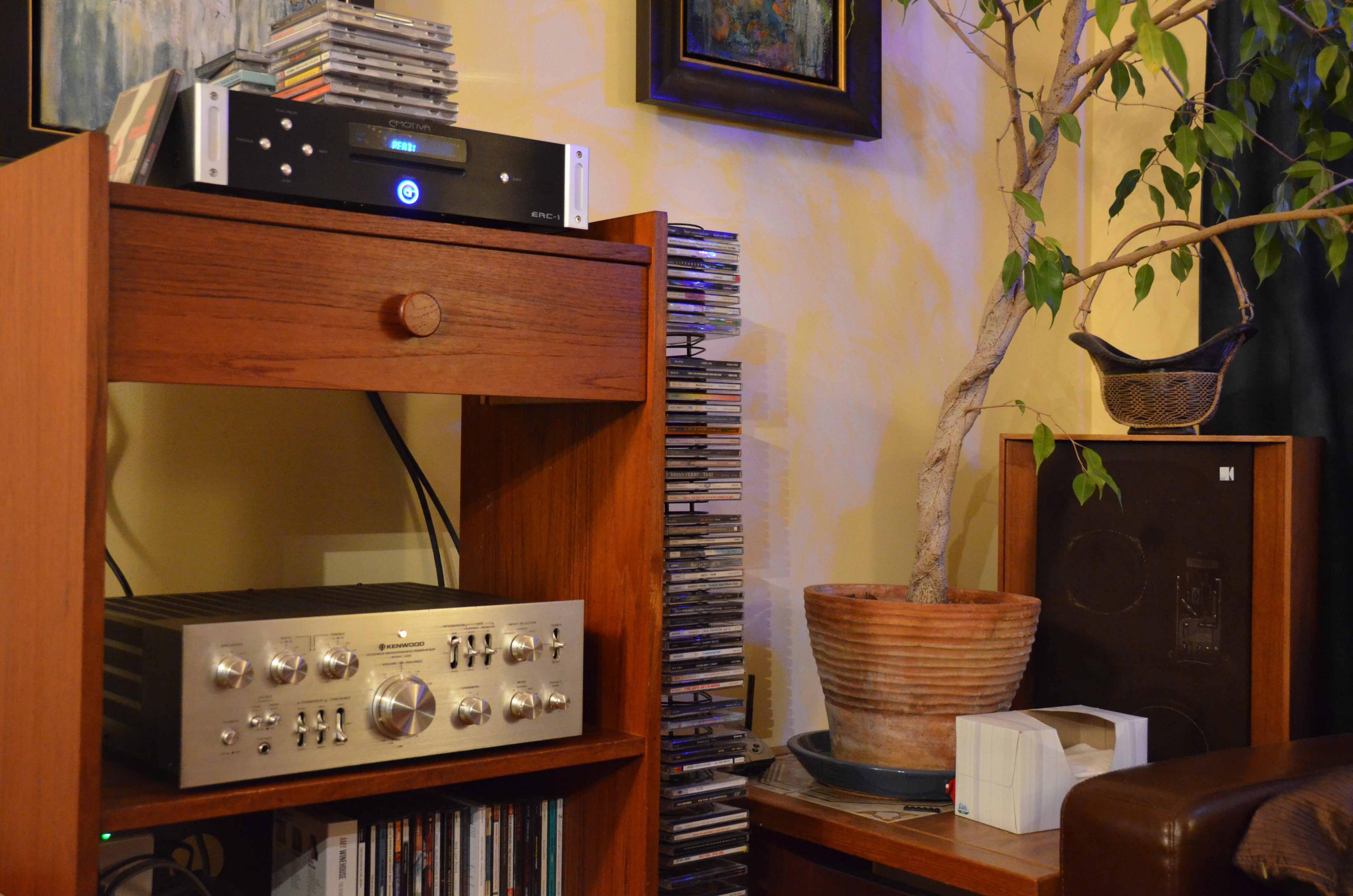

Your advice makes sense. I am poised to order the parts Wednesday evening at the earliest.
Here are some pictures I took last night. I apologize for the poor pictures. I really shouldn't have been doing this in the evening as the flu has still got it's grip on me.
My Sansui 9090 was recapped and calibrated shortly before I traded for it. One of the reasons I went for it, because I didn't want to face another project. Of course, that doesn't mean it was done properly, or with the best components. I'll see if I can find some schematics. For now though, I think I should leave the receiver alone. I'll look at that after I have recapped the 44s and the Kef Concerto's. I see myself slowly moving towards separates.

I agree KMossman. I am replacing the caps. The challenge is to do it at a reasonable price and good results. As for my Sansui 9090, it was recapped just before Christmas with adjustments made. It was done by a local electrical engineering student who is a perfectionist. I do believe he used quality components, but will need to open it up to confirm.
benb, an interesting read. I'm not sure if I want to do that right now. I was quite impressed with the results from other posters of this thread. And I really like the ditton 44s. For some reason, I like them better than the 66s I had. I actually ABed the two sets of speakers and the 44s sounded better to my ears. It may have something to do with the neutrality of the 66s over the 44s.
I am on a quest for the best sound and eye candy I can get without breaking the bank. I think my ear is also getting educated as I go, and the bar is going higher. Maybe what I should start doing is getting the vendor to bring his equipment to my place for the audition. So much depends on the room... I really love the way vintage audio amps and receivers look.

Technodweeb ,
in your schematic in #263 above , move R3 to the other side of the junction of C3 and L3 ,
so that it is located in direct Series with C3 before L2 in the circuit.
R3 needs to be as if an internal part of C3.
It can be connected to either side of C3 , whichever is easier to install ,
but there must be no other components connected to the junction point of C3 and R3.
For all the resistors , leave about half inch of lead straight out from each end of their body ,
then bend the leads in such way as to support the body so that the body is in air above the board , and not touching any components.
These Mills resistors are light weight and their leads are strong enough to support them.
No warm or hot spots can develop on them when they are not touching anything ,
and they will then warm evenly over all their body when you drive to high levels.

The magnet on back of your mid-cone driver looks large enough to be the large type that LucasAdamson posted about ,

Stick that lifted edge of HF2000 carefully with something that will stay adhered to metal ,
but scrape clean the metal first so no surface oxide tarnish.
If you cannot obtain a metal adhesive that sets hard , then use a Roofing Silicone of the type that sticks to metal guttering , etc ...
{ not a Bathroom Tiles silicone , as that may only hold long term to ceramic }.

Last night, when I was supposed to be ordering my parts for the ditton 44, I went to check out an amplifier. Wow! I was really impressed! I ended up coming home with it. Now it sits proudly where the Sansui 9090 was sitting. For me it was an epic moment. I had found that sound. Ave Maria was magical. Shine On You Crazy Diamond was perfect. And Billy Idol hasn't sounded like that since I heard him on my sister-in-laws Quad system with Kef 104s in the 80s. I'm sure Quadraphenia will be awesome again too!
It seems my instinct was right. The McIntosh and the Sansui just didn't have enough current for these 4 ohm speakers. The harshness is gone in the highs and the lows are fuller and have much more depth. It is in the words of someone else online, "as though a veil had been lifted."
It is a Kenwood Supreme 500, recently restored. It isn't minty, but it is in pretty good condition, with 30 some odd years of life behind it.
I know this is all a little off topic, but please bear with me. I am mentioning it because I started with 4 ohm speakers and because of that, I have been going on this adventure.
I hope that other newbies to vintage audio will take this lesson I have had back with them. My speakers sounded great at low volumes, but I was never happy as soon as I turned up the volume a little higher. I was overdriving the amp, but didn't know it because the only symptom I heard was the shrillness or harshness of the highs. The Kef's sound great now. I can't wait to hear the 44s.
Speaking of the 44s, because I bought the 500, I will have to wait 2 weeks until my next pay before I can put in the order. In the meantime, hopefully Lucas A will have seen your post, Alan, and have an answer for us about the Midrange in the Ditton 44s.
I think I will likely sell the Sansui 9090. As for the McIntosh 1900, she is a keeper. I love the way she looks and the sound she generates, and if I need to have it louder, I will play it on the Kenwood.
I am lucky living in Ottawa, because it seems there is more high end audio available in this city than any other in Canada, likely because of the high tech community here in the 70s onwards.

another Correction to Schematic in #263 on Page 27 ; plus a response to #277 above
To anyone following this reconditioning of the 44 crossover:
TechnoDweeb's Schematic in #263 on Page 27 contains another error that I did not previously draw specific attention to.
C1 needs a resistor in Series - 1 ohm/5 watt , similar to C2 which is to have 1.5 ohm/5 watt in the position shown.
As I posted in #265 on Page 27 , the original Celestion HF2000 tweeter does not need a resistor, thus omit R4 ,
and as I posted in #270 , R3 is to be moved to the other side of the junction so as to be in Series with C3 before the inductors.
R3 is 1.8 ohm/5watt.
R2 is correct - use 2.7 ohm/5 watt.
