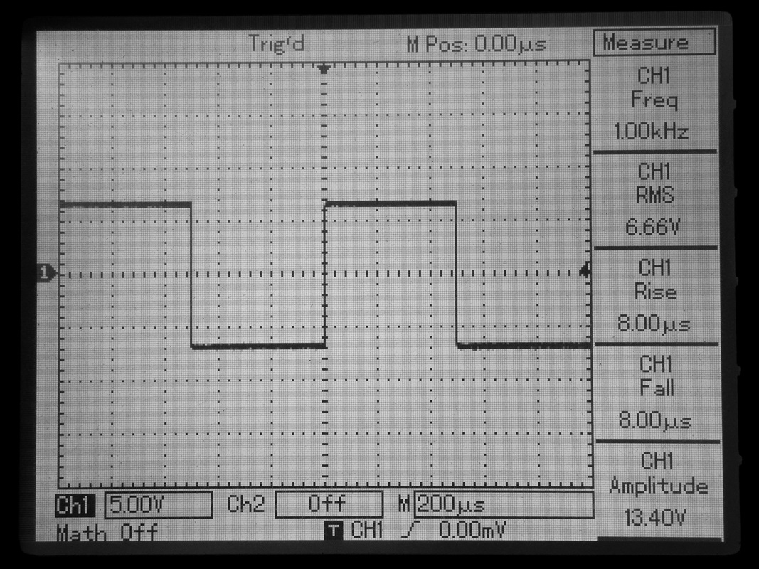

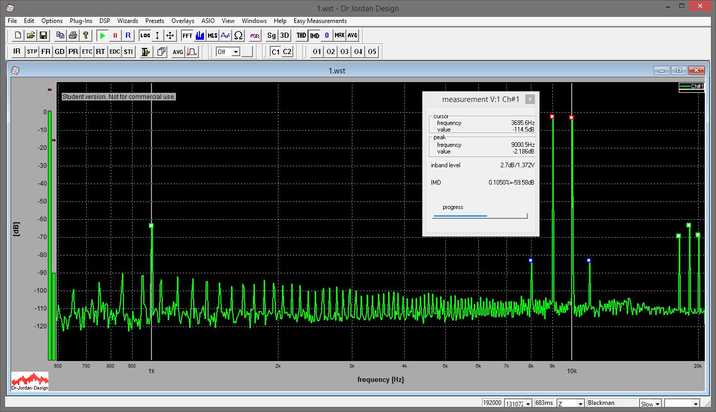

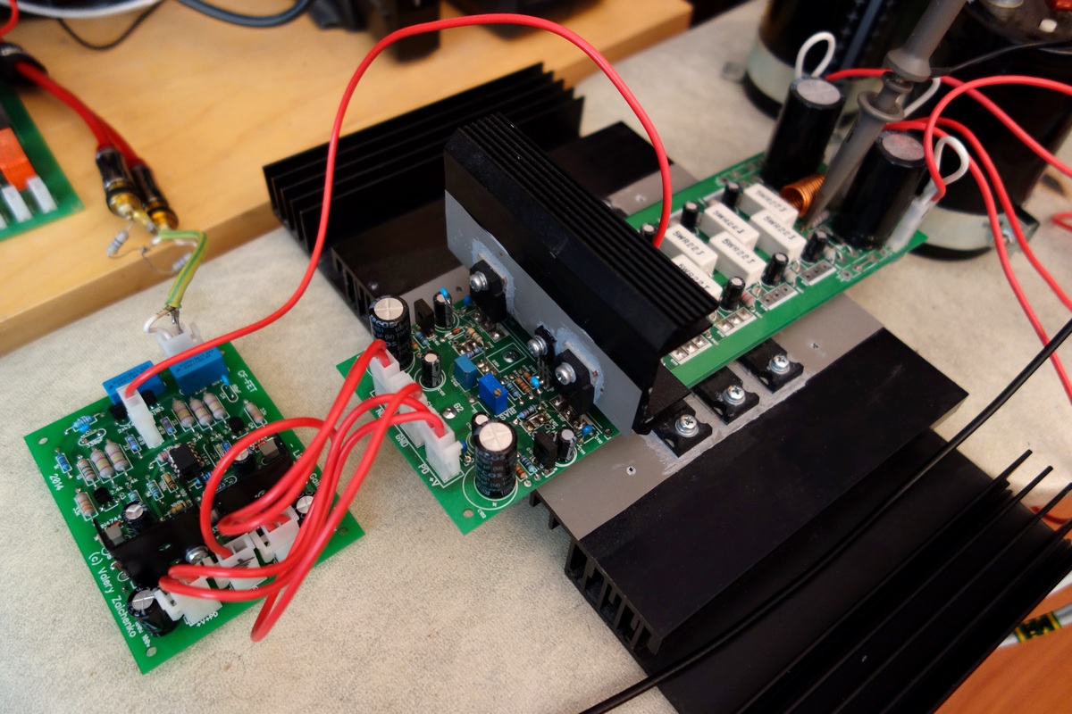

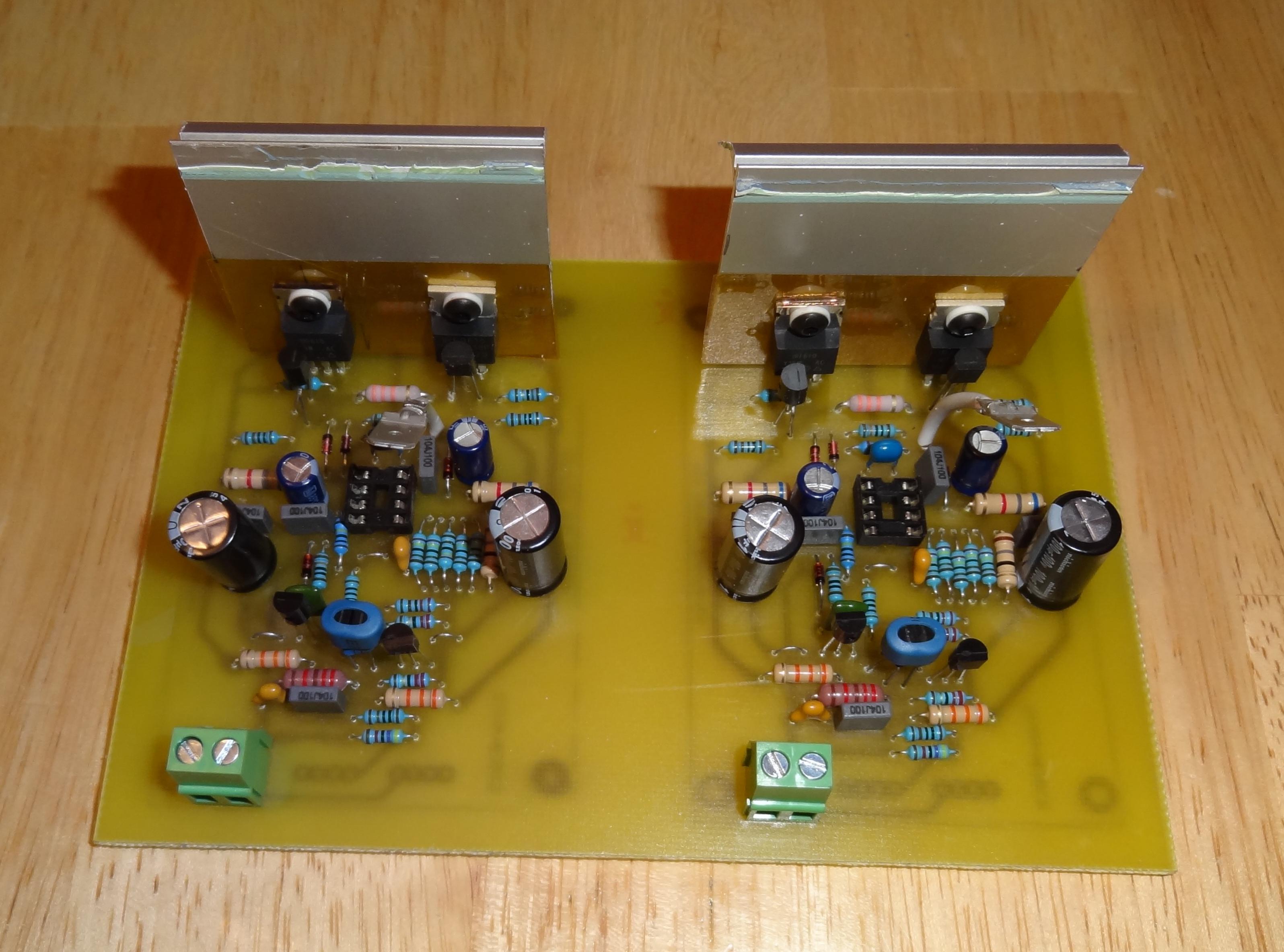

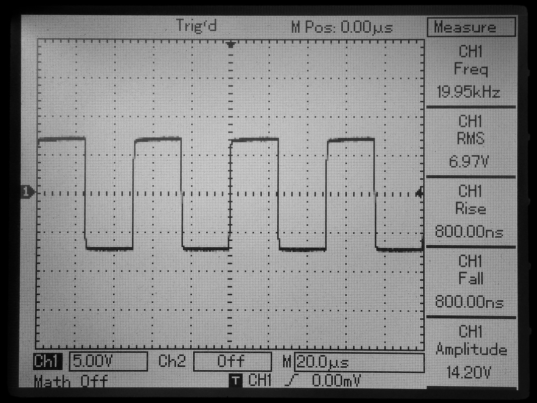

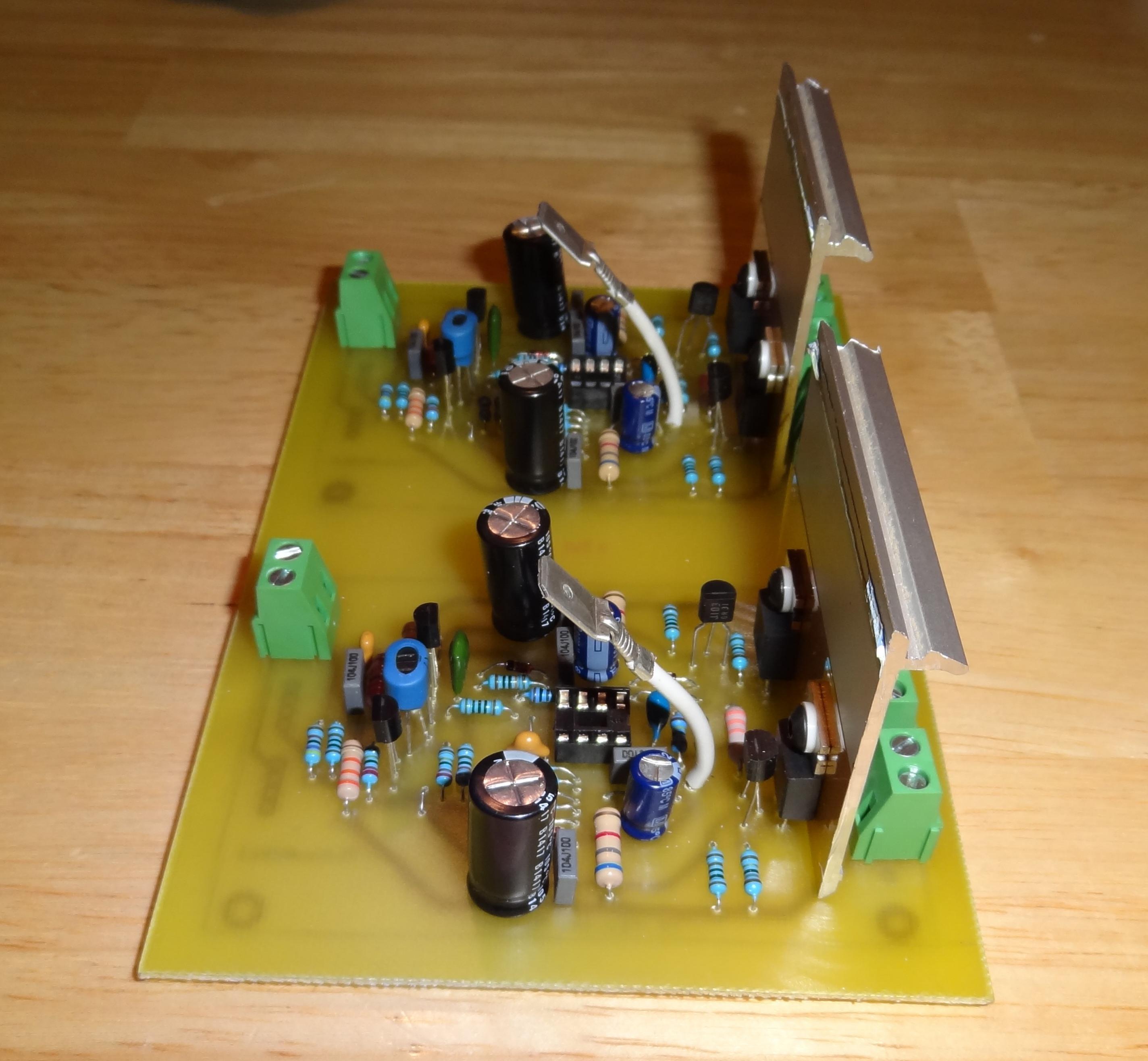

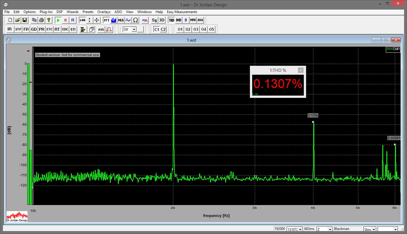

Tested with SlewMonster-based MOSFET OPS (3 pairs) - just had it on a heatsink, easy to hook up.
Some values had to be adjusted - there is a slight difference in currents comparing to the simulation. Set the VAS current to roughly 8mA for this OPS.
Biased to 80mA per output pair. Made compensation a bit lighter.

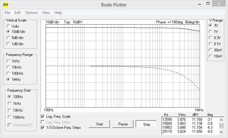

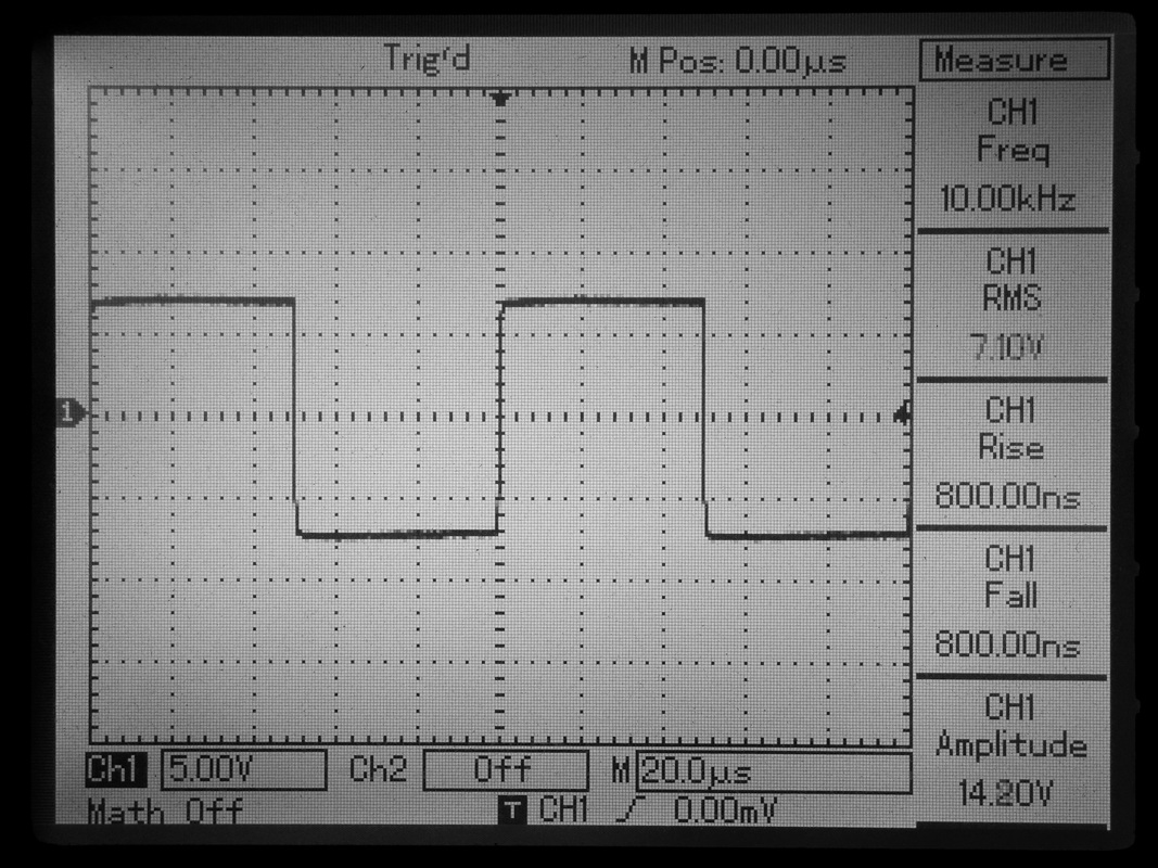

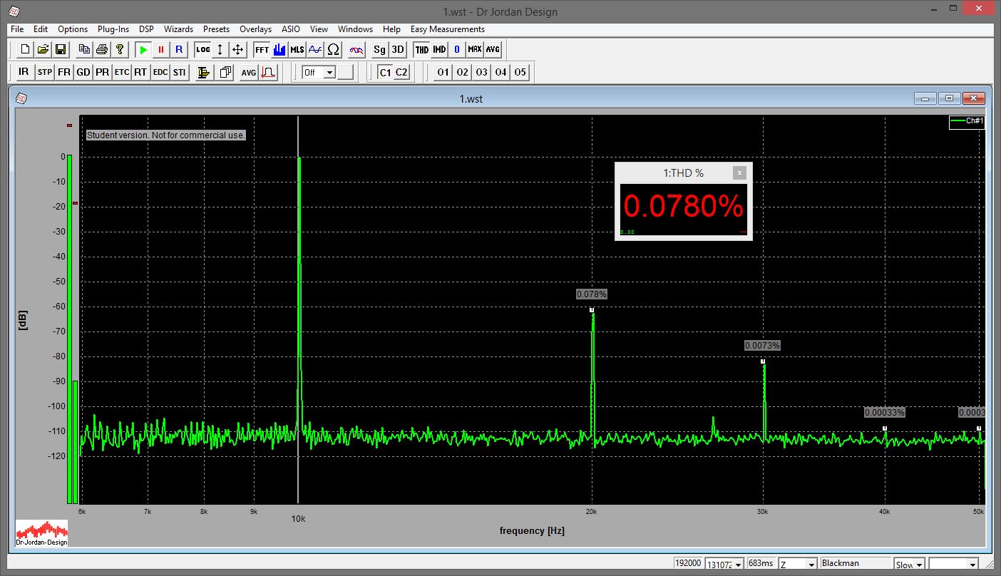

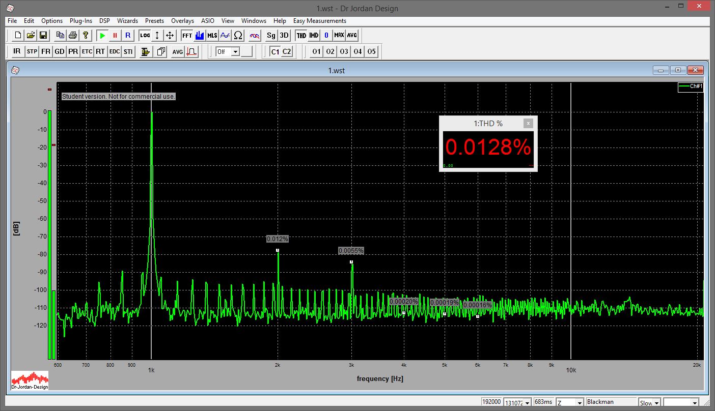

Cool squares, THD /IMD are slightly higher than I expected, but 2-nd harmonic is dominant, 3-rd one is lower and practically no higher harmonics.

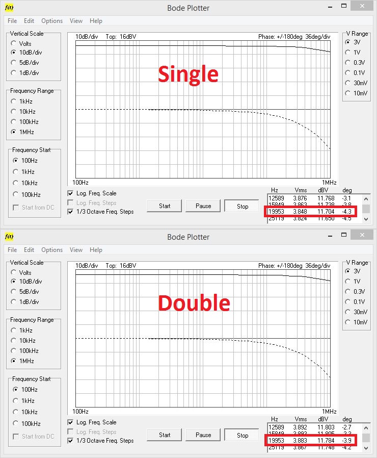

Very good phase response (only 4.3 degrees at 20KHz).
Rock stable. At startup jumps to -2V at the output, having it balanced-out by the servo to less than 10mV.
Sounds very natural and detailed. Need to audition it more, but I like what I hear so far.
I also plan to test it with TubSuMo Lat-FET OPS - need to mount it back to the heatsink.

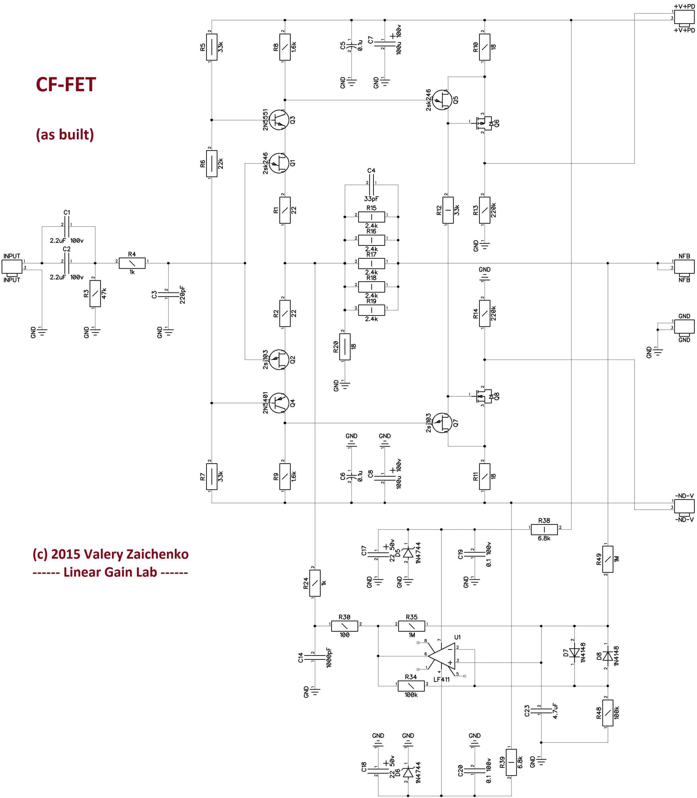

As built
Terry, this is first of all for you now, as you already have it soldered.
"As built" schematic is attached. Sorry - this one is from DipTrace, better presentation, but different numbering.
Leave R1, R2 as is (22R). It's good to set the VAS current with R8, R9.
R8, R9 = 1.6K -> VAS current = 8mA
R8, R9 = 1.5K -> VAS current = 5.3mA
Other adjustments:
C4 = 33pF
C3 = 220pF
That's it. Have fun! Let me know how it goes and what you hear
Valery
P.S. It's cool to have TO-220 hex-fets as VAS devices. I tried to abuse then even at 40mA - they work, getting just moderately warm
I also love the compensation here - one 33pF lead cap in parallel with GNFB resistor

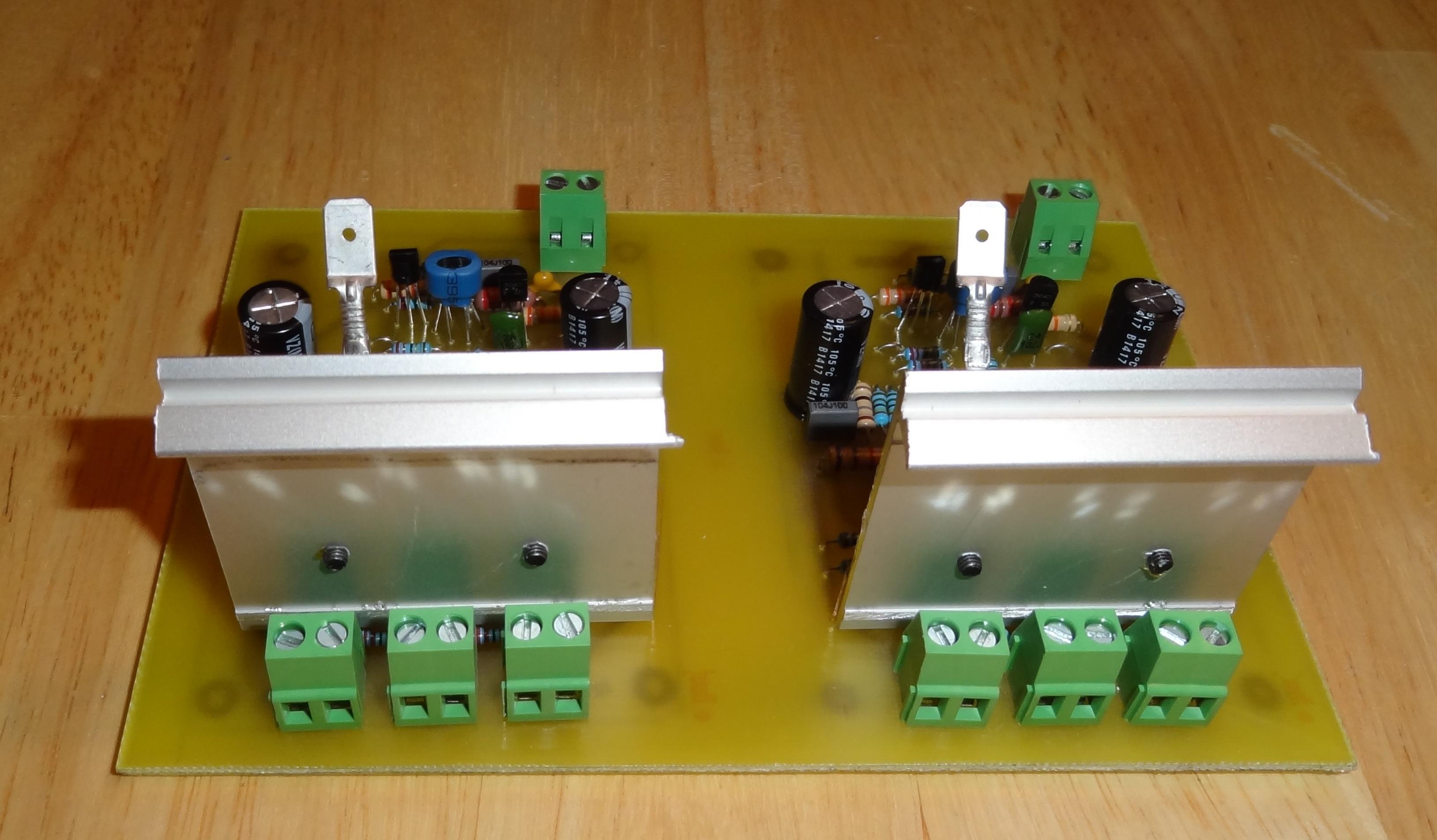

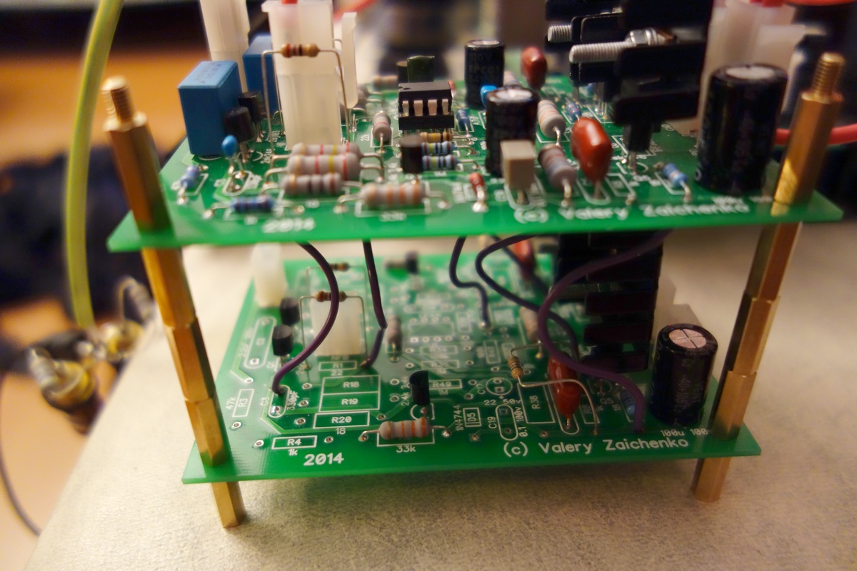

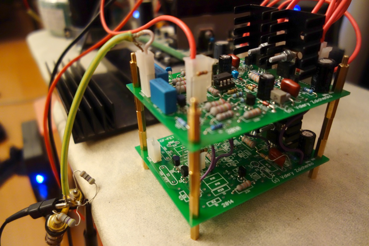

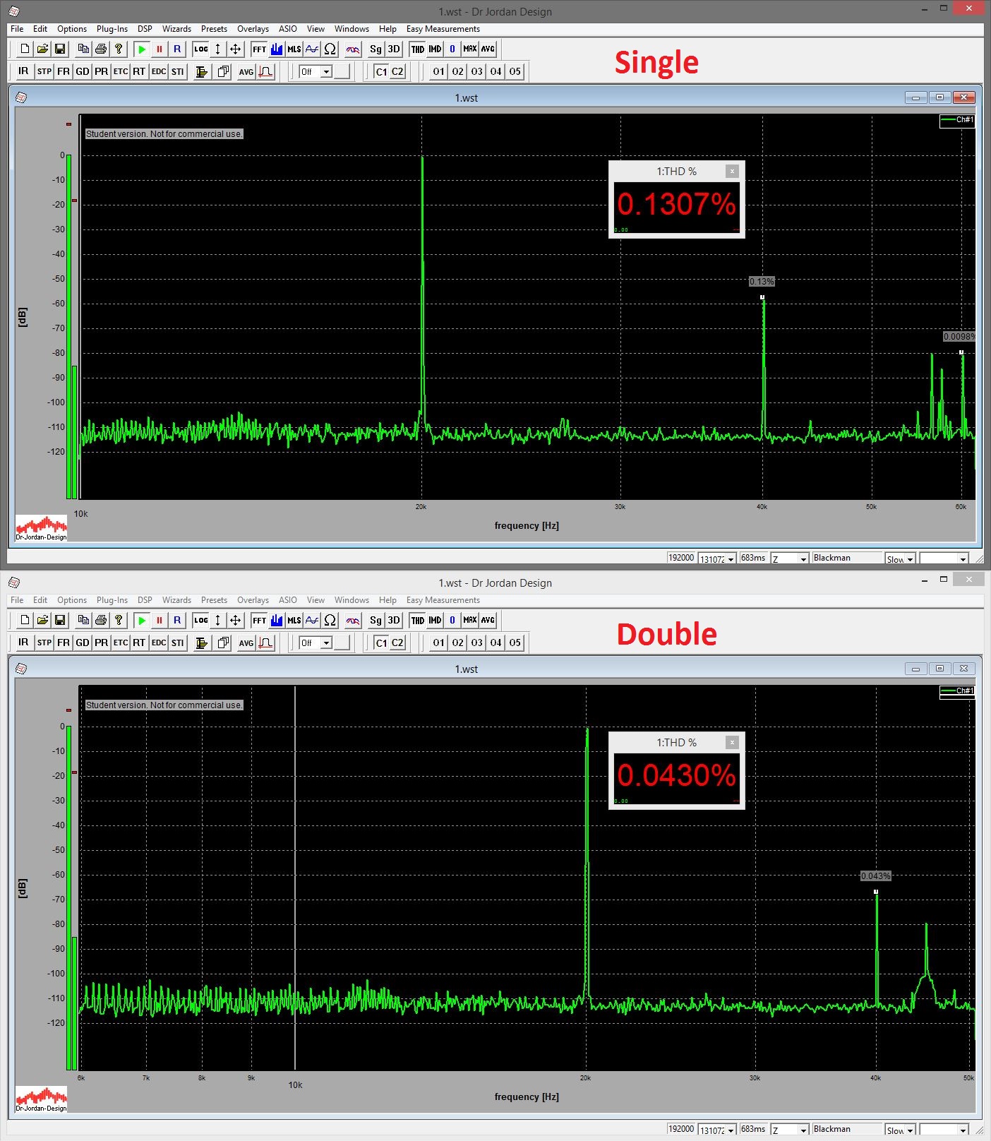

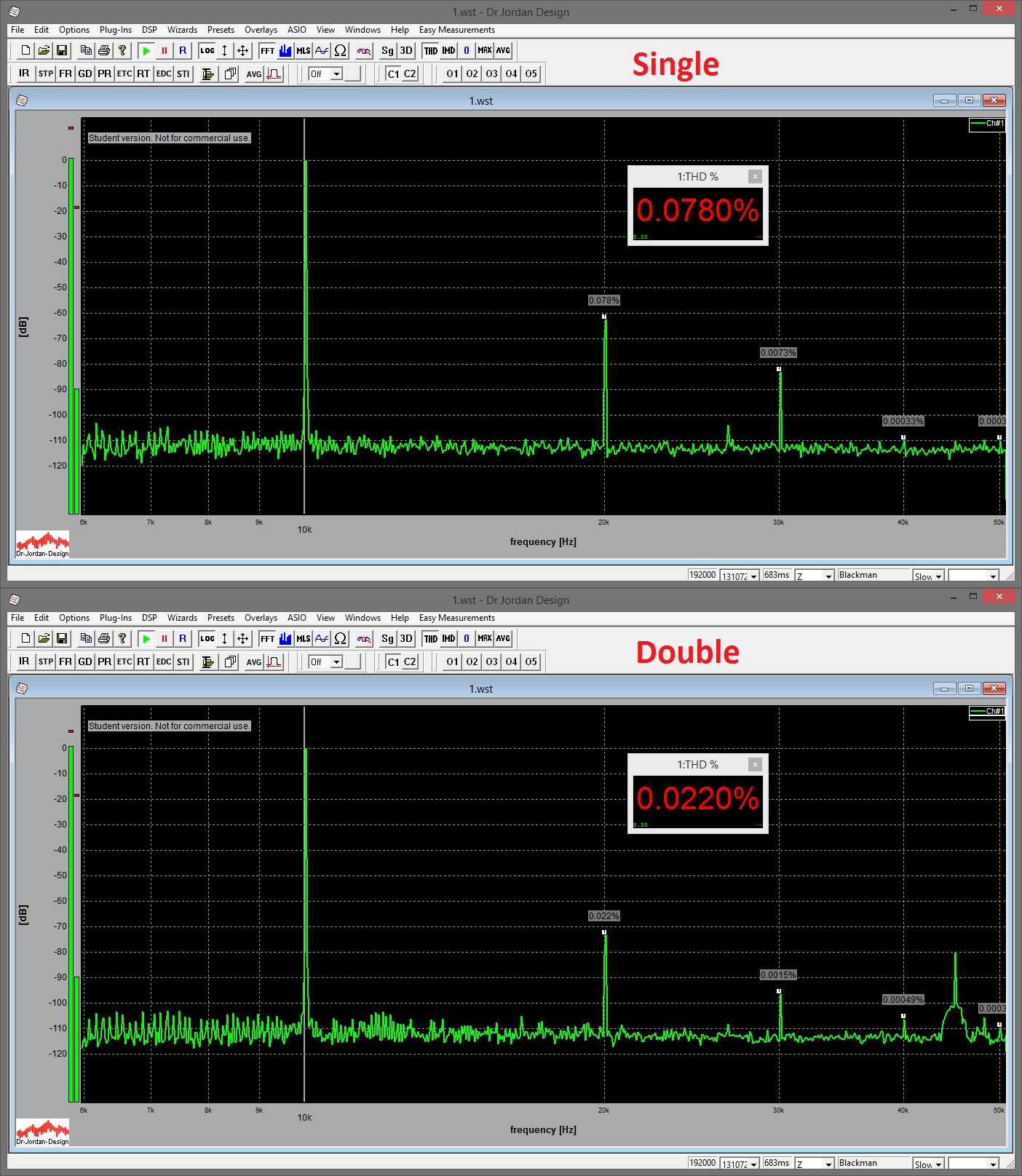

Here comes the Double-Decker
Two identical boards in parallel (positive and negative inputs, both outputs, ground and rails are paralleled). Second board (bottom) is much less populated, as we don't need the second input filter, NFB network, DC servo and load resistors - those ones only present at the top board.
I don't see the difference in noise floor, although it may be limited by my measurement system - it's very low anyway. Some 50Hz products - due to the ground loop in the measurement system - will work on it later.

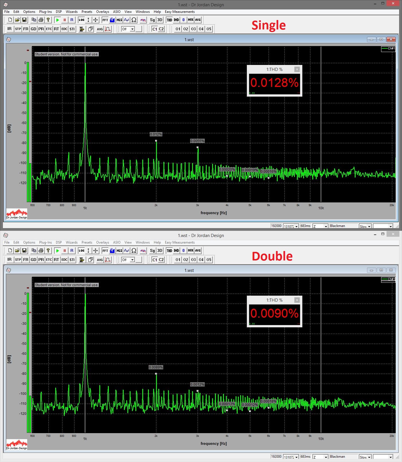

However, THD decreases significantly, especially at the higher frequencies. Harmonics profile is excellent. Again - no matching whatsoever.
Pictures are (after two photos):
1) Bode plot (closed loop) - note the phase response improvement (20KHz);
2) THD 1KHz - slightly lower;
3) THD 10KHz - around 3.5 times lower;
4) THD 20KHz - also around 3.5 times lower;

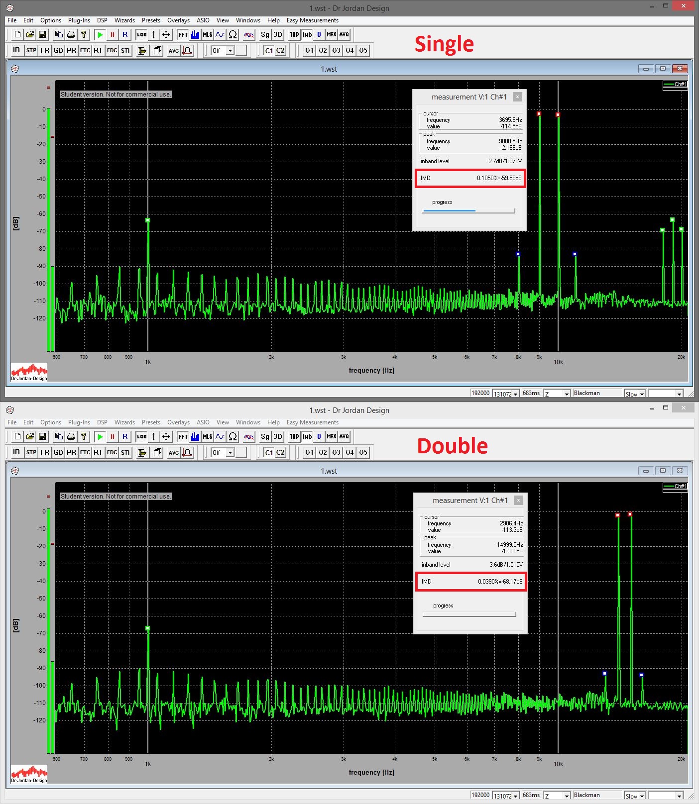

5) IMD 14+15KHz - 2.5 times lower;

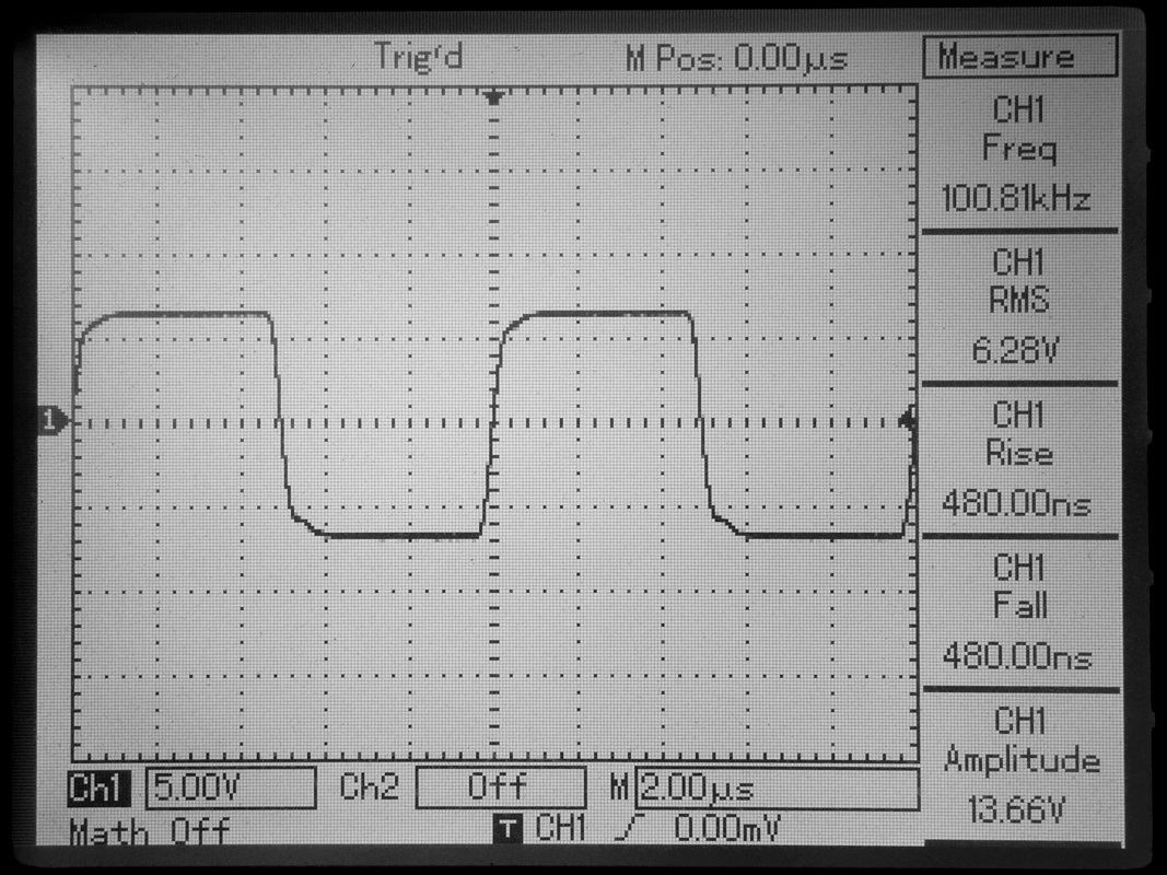

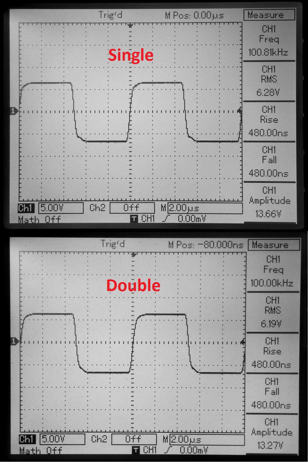

6) Sqware wave responce 100KHz - pretty much the same.
VAS quiescent current is set to 5.5mA per board = 11mA in total.
I ran these tests in combination with the same Hex-FET OPS.
Next test - with Lateral FET OPS from TubSuMo.
Also, more listening will be performed. It's pretty late here now, so I can't listen at any decent volume - although at very low volume it sounds rather cool
I will publish the double- schematic tomorrow. Also, PCB may be updated, so that both "decks" will be placed at the same level - easy.
Valery
