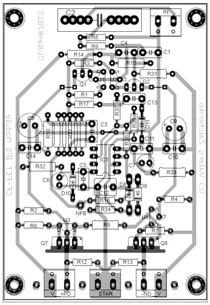

Hi Valery,
I hooked it up to the Tubsumo OPS. I have almost 4V offset. I am looking closely to the pinout of the servo and it looks wrong to me. Can you please have a close look at it and tell me if I'm right? I'm thinking the + leg needs to go to pin 7 and I believe it is going to pin 8. If this is wrong, could that be the reason things are so off? With the servo removed I still have about 2V offset.
Thanks, Terry

Here's an update. I was pretty sure about the servo so I just bridged across pin 8 and pin 7. That worked fine on the right channel. It drops to about 12mv offset after a few seconds. However, the left channel only drops to about .9v offset. I tried pulling both servos and the right channel has a about .9v offset and the left channel is at about 2.1v. Another thing I noticed is that Pin 7 on the left channel servo drops from 14.5V to about 5.6v over about 10 seconds from power on. I tried a few different ICs and they all do the same. Any idea what might cause this? One more thing of note is that with the servos pulled I have +-14.5V on the right channel zeners but on the left I have -15.3 and +14.5. I doubt this is causing that voltage drop but it is interesting. Any ideas are welcome.
Blessings, Terry

Hi Terry,according to what schematic is this IPS?
If it is from post 248 ....yes it is wrong pcb connection.

Hi Thimios,
This one has been a little tough because the schematic for this layout is in post 229 but Valery changed the part numbers as he continued development so the most recent schematic has different part numbers than this board.

Is your voltage drop the same on R38 and R39? Looking at the circuit, the only thing that could cause uneven voltage would be the op amp or the zeners themself. Maybe try popping the op amp out if it's in a socket and see if the voltage gets better. If not, there is a problem with the zener or a copper whisker somewhere.
Hi Jeff,
If I lift R24 pin 6 goes to 13.44v and pin 7 holds at 14.46V.
Hi Thimios,
I'm not sure there are other layout problems because one channel seems to be working. I think I must have a bad part somewhere but I can't seem to find it. All parts read the same from channel to channel with and ohm reading or diode test. It is only under power that I am seeing these issues.
